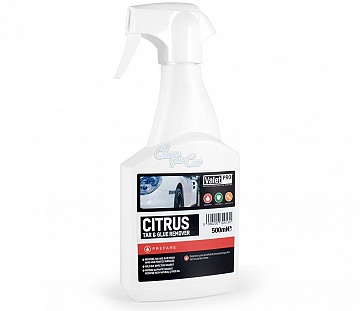

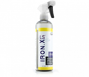

Just wanted to get your advice before I do anything. In the past I have washed the car with something strong like fairy liquid to strip any wax and then clayed it.
This time I have got Collinite 476 on the car since autumn so intend on snowfoaming to begin with with citrus power.
I have bought some stuff which I hear a lot of poeple using:
CarPro - Iron X LS Fallout Remover 500ml
and Valet Pro - Citrus Tar and Glue Remover
My car is black so its quite hard to see any tar splatter. With the above can I spray the entire car , leave for a few minutes then use a microfibre to get it off. It wont damage the paint or anything will it.
I will then wash again quickly and clay with some medium clay.

What would you do with the 2 sprays above, do the whole car with both at the same time or one after the other?
  Cayman S Edition 1
I recently purchased that Tar remover. Have to say I was extremely impressed with how quickly the stuff worked.
