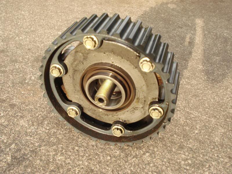

i can't actually see how one could collapse, its verging on the impossible TBH!
i'll take pics of a disassembled one so you can see for yourself
From what we saw when you had it apart theres no way its going to fail
If its oil starve that causes the noise rather than replacing could it not be lubed up or is it actually something within which wears?
Heres the rear side of the pulley to keep you guessing as to whats inside lol
