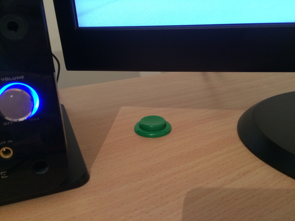

This is just a little project I thought would be cool. To save me from reaching all the way under the desk to turn the PC on, but mostly because arcade buttons are cool :tongueout:

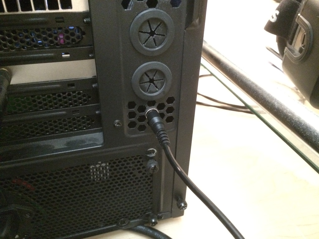

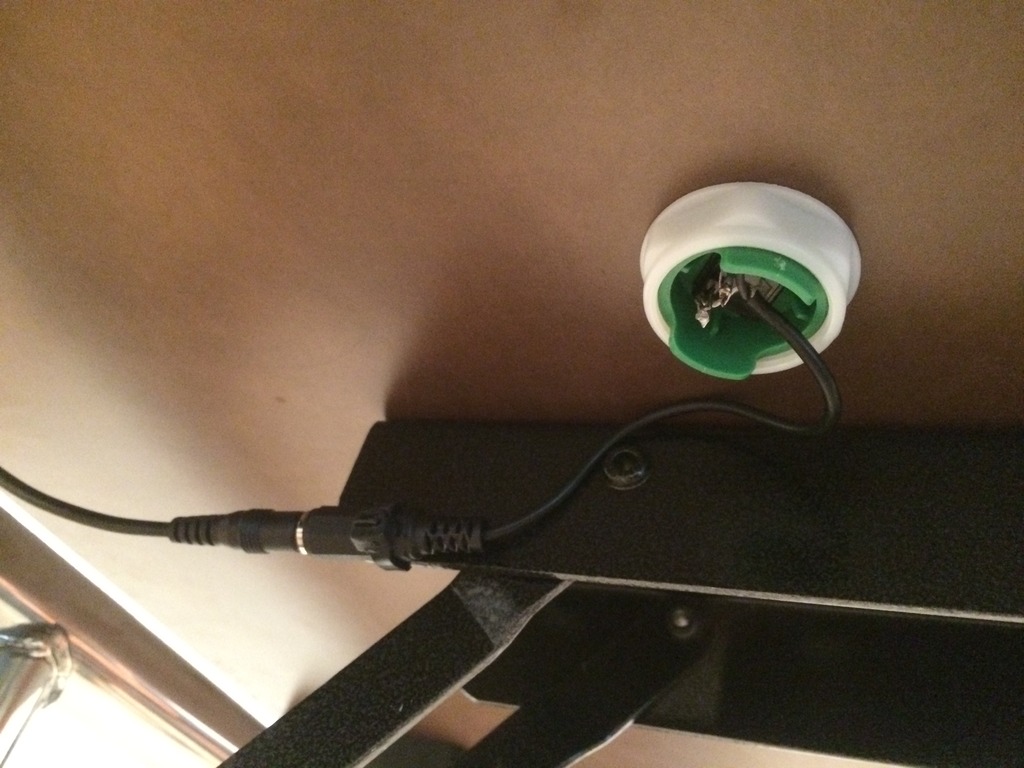

I soldered on some audio cable and connectors so that it can easily be disconnected. I used 2.5mm jacks so that I don't mix them up with 3.5mm audio ones.
The female socket fitted perfectly in a standard grill hole on the tower
Inside the tower I used one of these power switch extensions so that the standard switch works too.

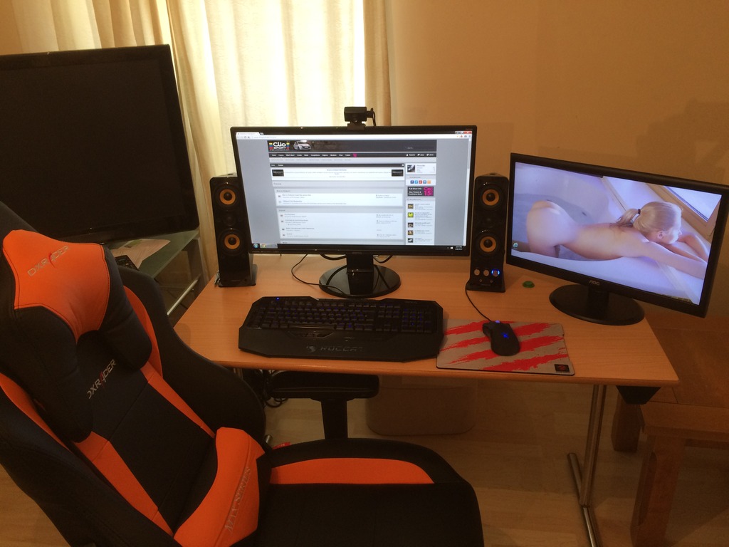

My set up
Oh and I've got one of those extension leads that powers up all the accessories with the tower. So when I press the arcade button, it brings on the monitors and speakers too :smiley:
