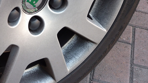

A few befores:
So, on to the wash process, which was as follows:
- Wheels, Tyres and Arches cleaned with AS Smart Wheels and G101

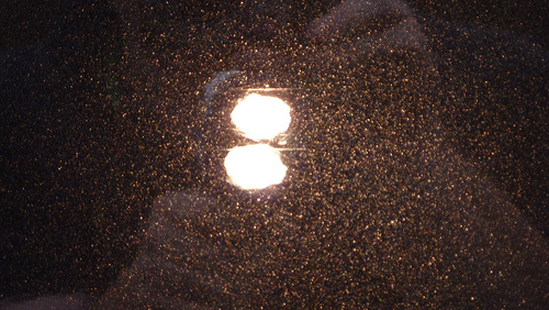

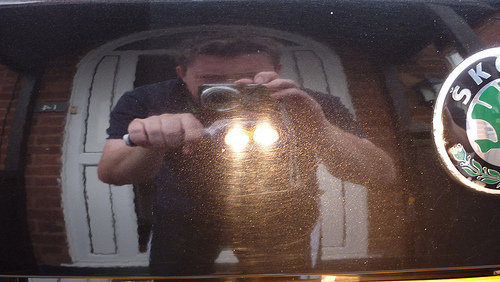

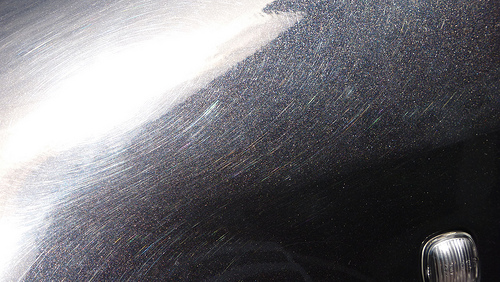

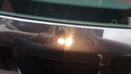

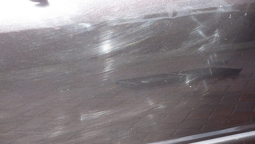

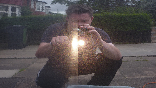

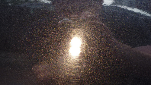

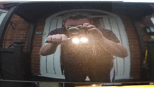

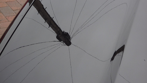

At this point, it was already quite apparent that the paintwork was in a very bad way, covered in hazing, swirls and RDS's:

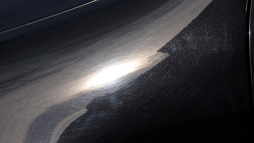

After trying a fair few combinations, I finally settled on the new Optimum Hyper Polish Spray on a 3M cutting pad. These gave me surprisingly quick results on the relatively hard paint. I found it to finish down perfectly too. My work was checked with a wipe down of the new Auto Perfection 'IPA alternative'
Quick 50/50 without light:
Some deeper scratches remained, but a second pass removed these:

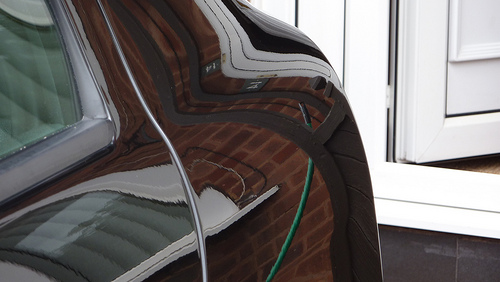

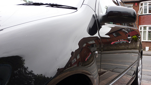

Some post polishing, no LSP pics:
50/50 on boot:

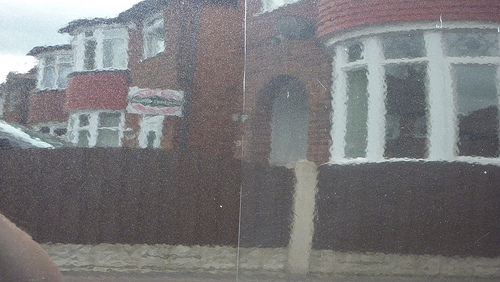

Before:

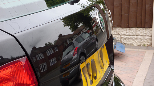

After:

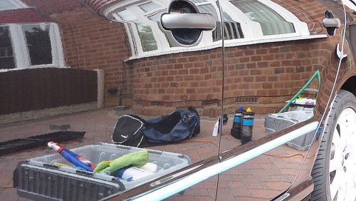

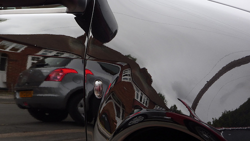

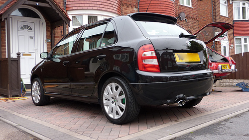

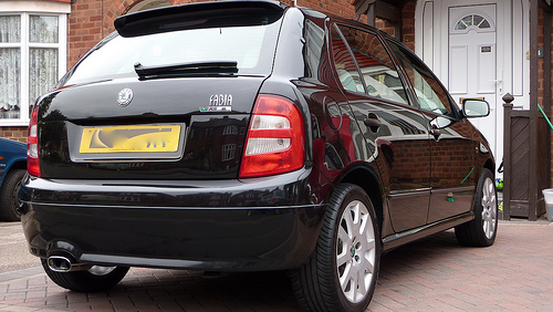

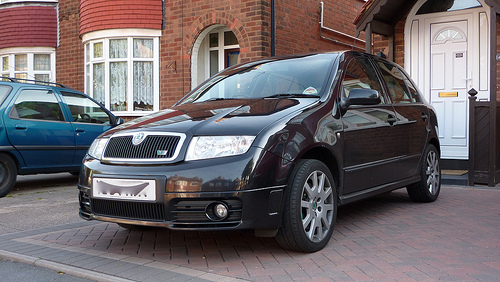

Some quick 'afters'. I finished up with a coat of Opti Seal, followed by OID wipedown, then a layer of R222. Also:
- Wheels with Opti Seal
- Tyres with 3M Tyre Restorer
- Glass with 3M Foaming Glass Cleaner
- Exhaust with Optimum Metal Polish
- Trim with 303
It's a shame about the lighting, it looked a lot brighter before the Sun went in!
It looks well for a 150k mile car though! Remap and Coilovers on the way too :)

The interior is in top condition too, which is a testament to Skoda's build quality! The alloys need a refurb too, but they're not too bad!

that looks mint.love how the paintwork on that has come out
how do you clean up the tail pipe to getting looking like new if you dont mind me asking?

The tailpipe was a bloody nightmare if I'm honest, I don't think it had EVER been cleaned!
I used a combination of Optimum Metal Polish, Megs NXT and some 00 grade Wire Wool. I spent a good 20 mins on that alone and it wasn't close to being perfect, but was a hell of a lot better!

ahh thasnks mate :D its worth it though it looks like new now
