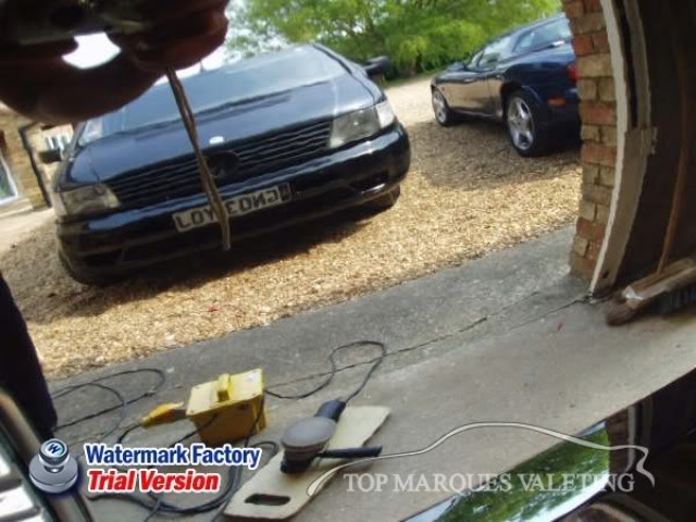

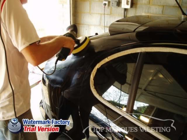

I explained to Dan the difference between the pads and a few of the polishes which I carry and the basic principles behind the PC & rotary and gave him a demonstration on how to use the PC. I then let Dan have a go under my supervision, and after a little while he soon got the hang of it. I then gave Dan the task of PC'ing the plastics and below the bump strips while I worked on the main bodywork with a rotary.

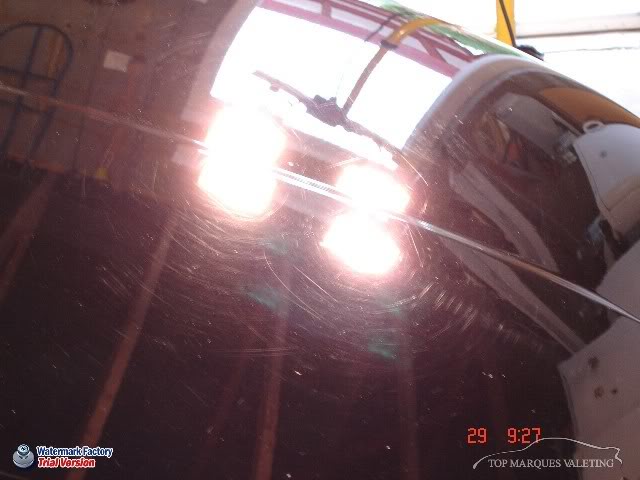

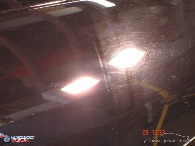

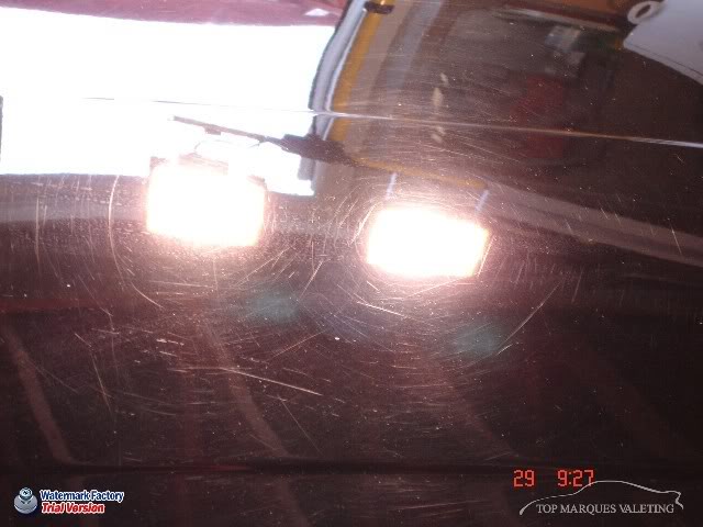

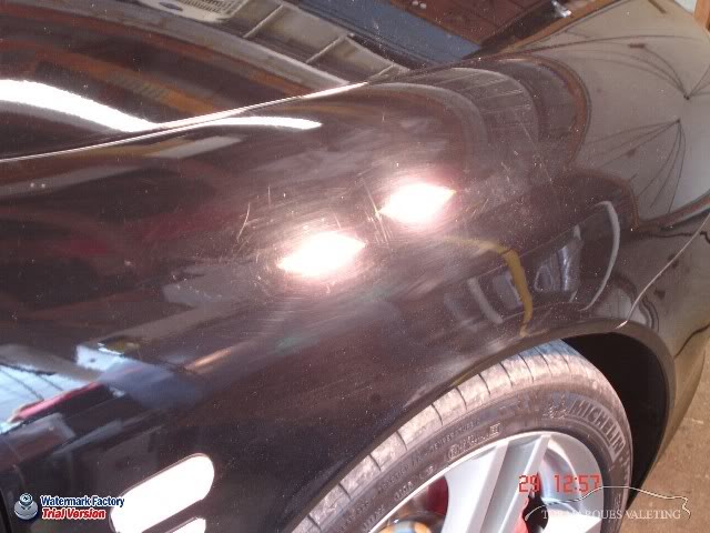

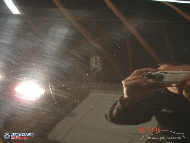

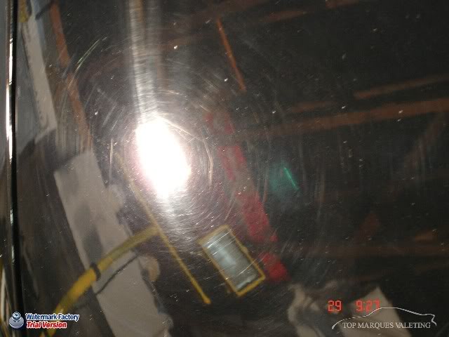

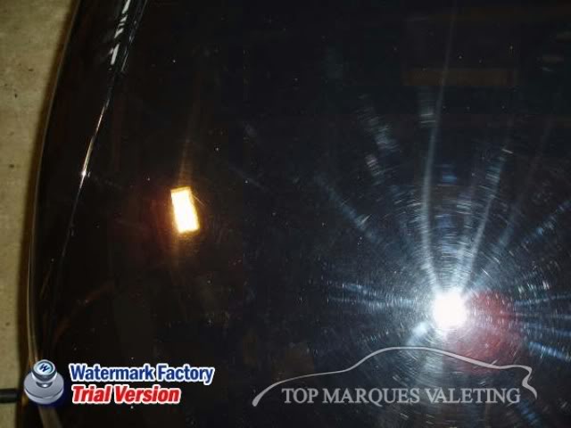

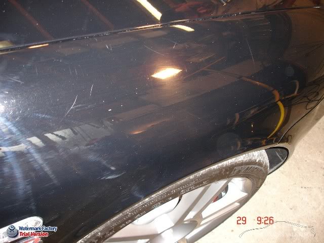

As you can see it was a real mess - loads of swirls and buffer trails from Dans previous unsucessful attempts at the job with his Rotary
under the halogens
and so to work...

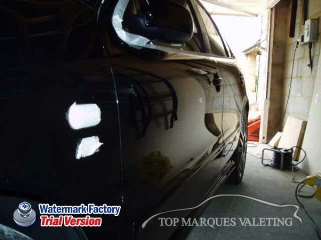

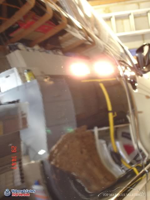

Getting there...

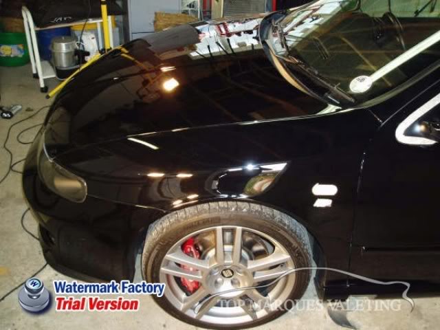

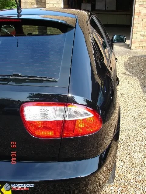

Finished polishing and awaiting wax in the garage

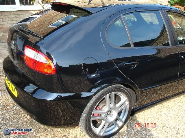

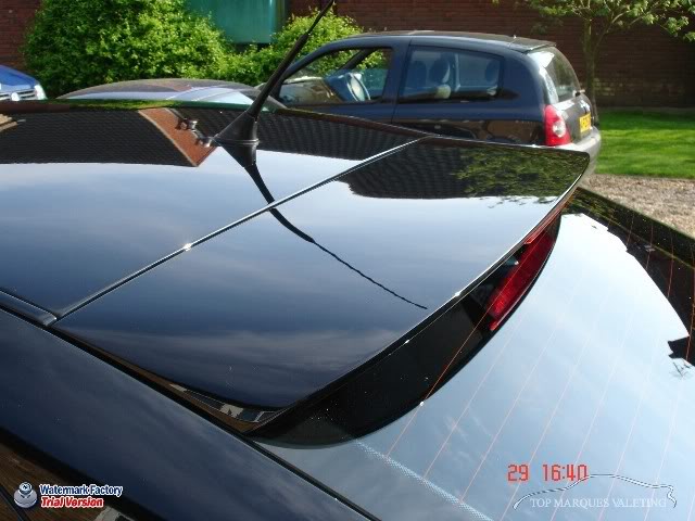

Boot panel after polishing - this was probably the worst part of the car

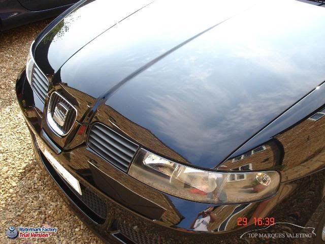

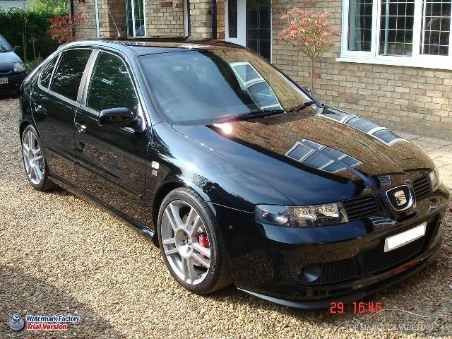

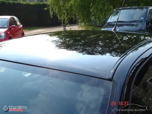

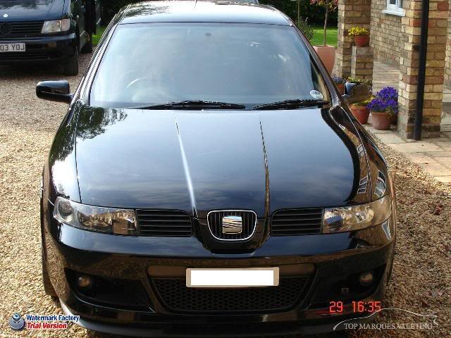

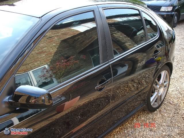

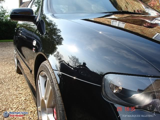

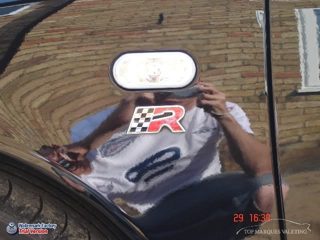

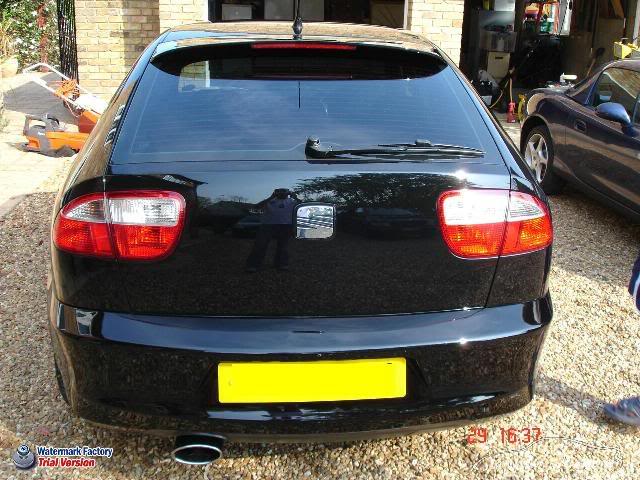

The final result out in the sun after the Zymol Carbon
Total time taken: Approx 7 hours

fook they were bad swirls. comes u pa treat though top worke mate
