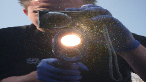

The paint on this one, like most Impreza's (and Evo's!) was VERY thin. Most 'normal' cars read 150-200 microns, but the average on this car was closer to 100 or less!

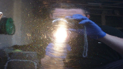

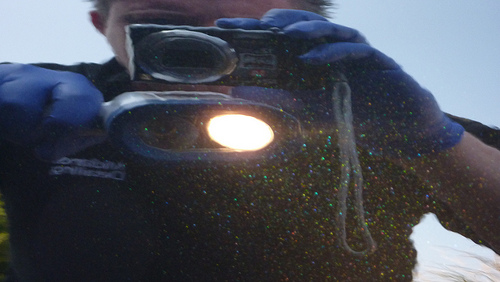

So, not much paint here to play with... need to tread very carefully. As for swirls...

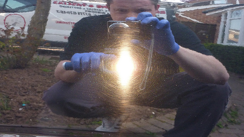

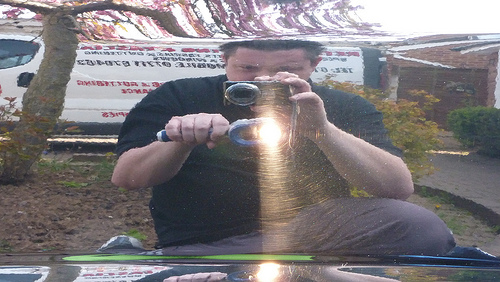

Pretty bad then! So, I whipped out the Rotary, Lime Prime and 3M Polishing Pad...
Not bad for a paint cleanser huh? Only 1-2 microns removed too!

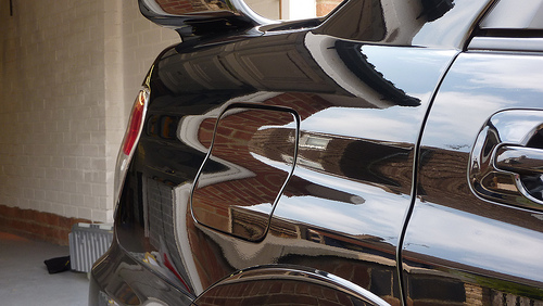

I finished up with a layer of Swissvax's Onyx...
