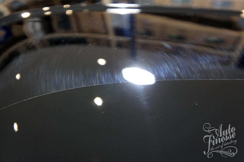

Your car under a spotlight, from what I can see in your pics, would look far worse than the black mini bonnet above, plus you can still see swirls on the treated side.
If you think you can see them under poor lighting, in a well lit unit and sun gun becomes embarrassing!
