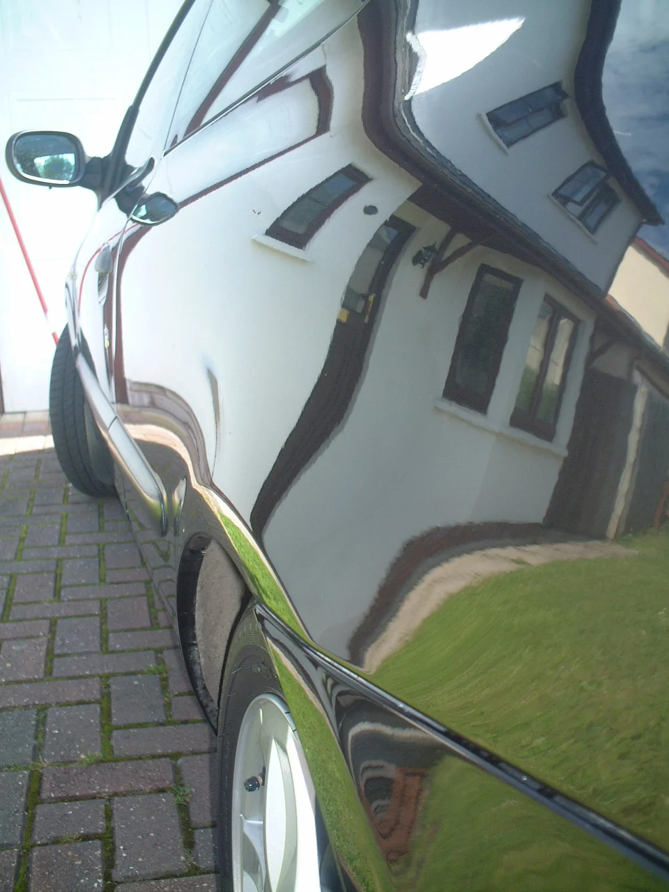

Yeah mate, wasnt as hard as i thought it would be to be honest, just took my time, preped loads, primered, got the right paint, then laquered. Drop me a PM if u need ne more info.
This is the only pic ive got at the mo.
All comments welcome.

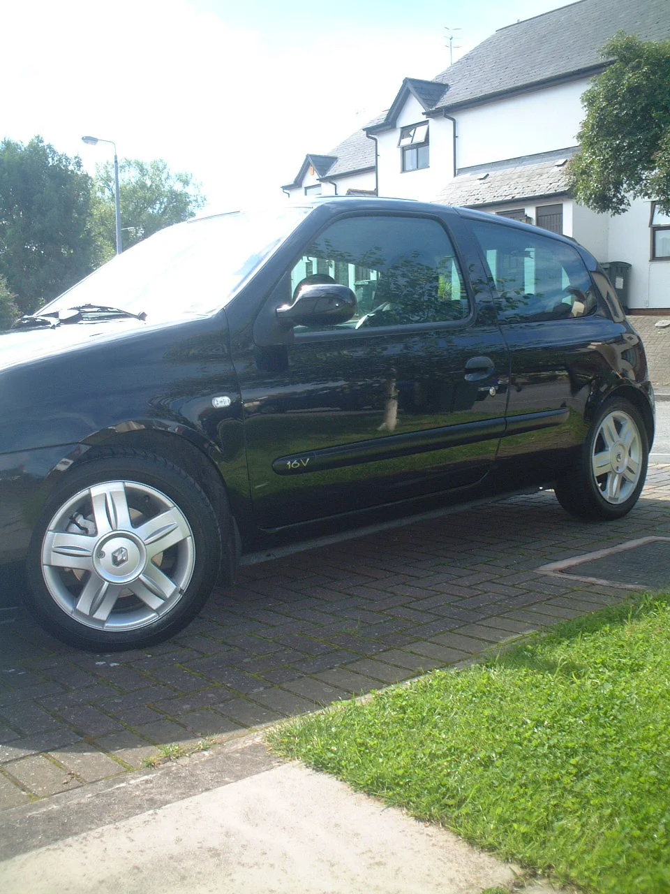

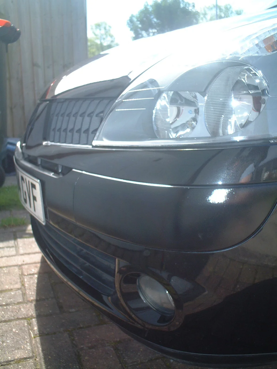

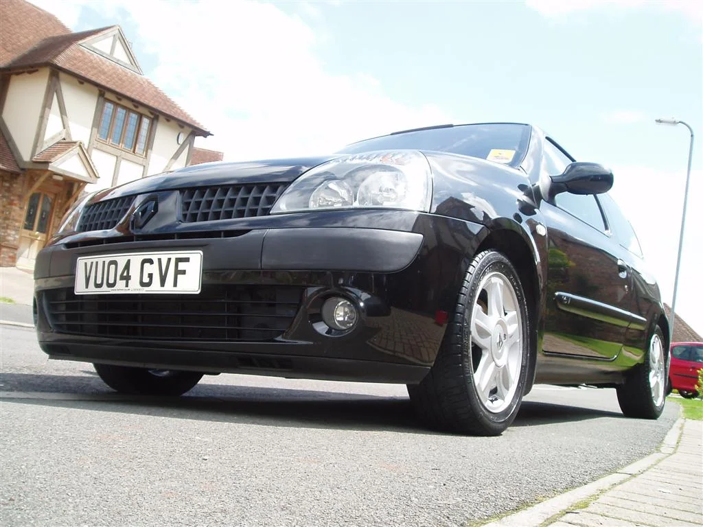

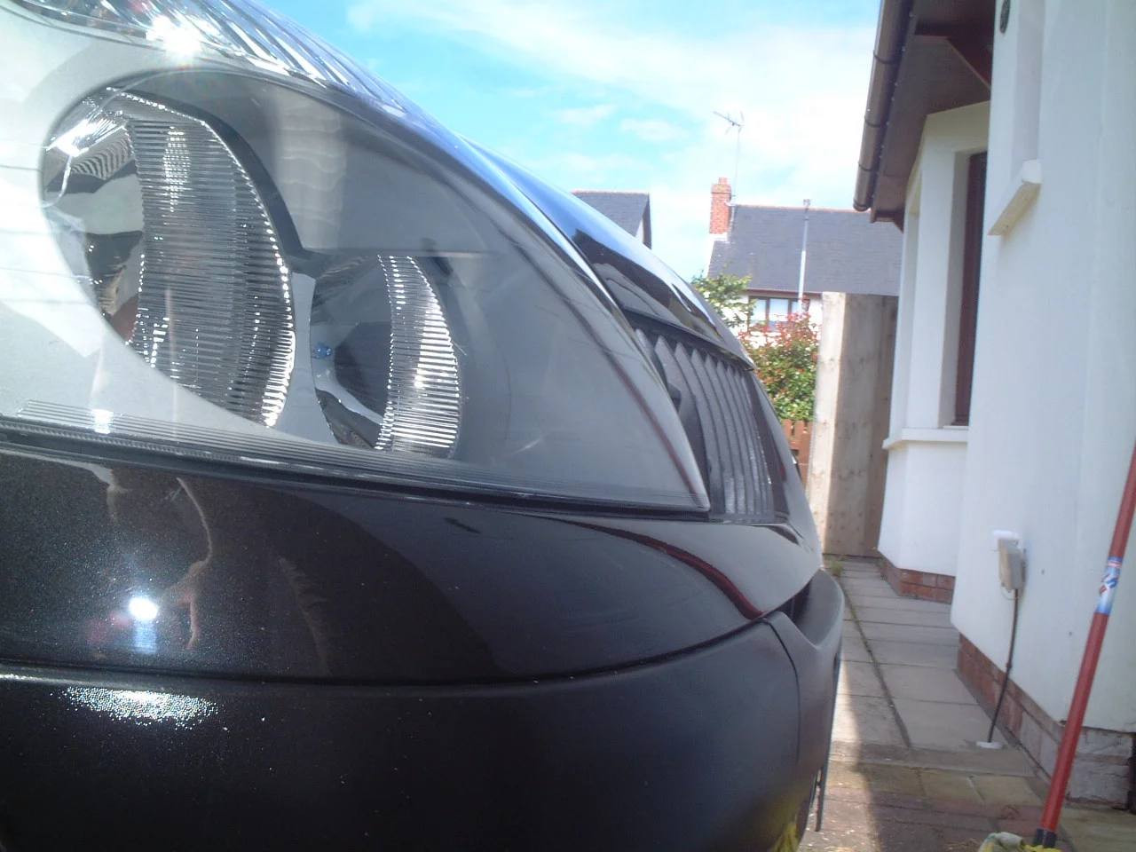

Heres some more pics.
