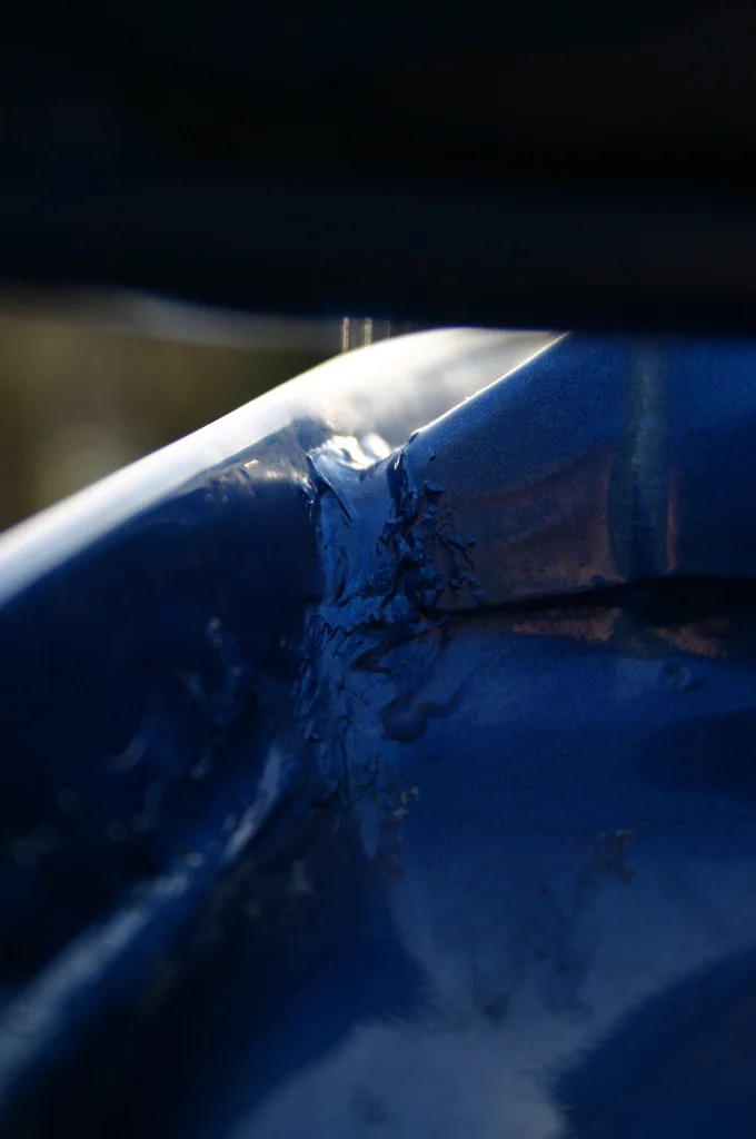

I found it under the strip on the roof:
Note: I know it looks bad in the pic but i have cleaned it up and you don't notice it with the trim on the roof
