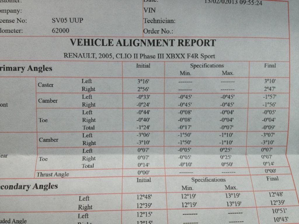

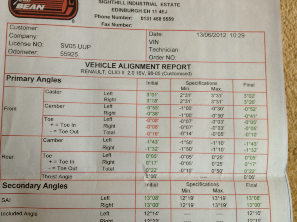

Just went to get my tracking and camber done at CLCM in Edinburgh where I always go as I fitted coilovers, powerflex wishbone and ARB bushes and also new ball joints over winter.
Everything looks good on the print out appart from the difference in caster at the front. As you can see in the second image which was from 6 months ago the caster was about bang on before. Is there anything to worry about with the new difference, should I be trying to bring them closer or are they fine as they are and I should just leave them?

1/3 of a degree isnt really enough to worry about, tiny bit of ride height difference one side to the other can easily cause that.
Plus as demonstrated by your printouts its been the same for the last year anyway!

3 degress camber on the back and 1/2 on the front ? Have you put some shims in the rear?

Its got 2 degrees on the front now mate, you are looking at the before figure not the after.

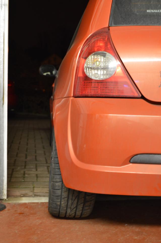

Got any pics of the camber from the rear looking down the quarter panel? I'm trying to decide what degree shims to have on mine.
I started with 1 degree on my cup so 2.2 -2.5 total on the rear....get good even wear with just a tadge more on the out side edge if you were picky...
Mine was even before I started so you may need to measure before geting two 1 degree shims...
Unless you really are going for the look, 3 degrees then, job done...lol. Rather than performance\grip\wear etc.....
