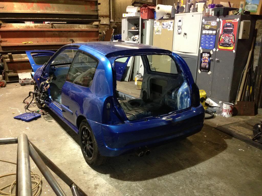

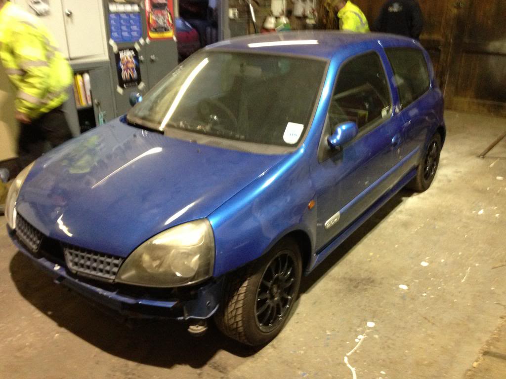

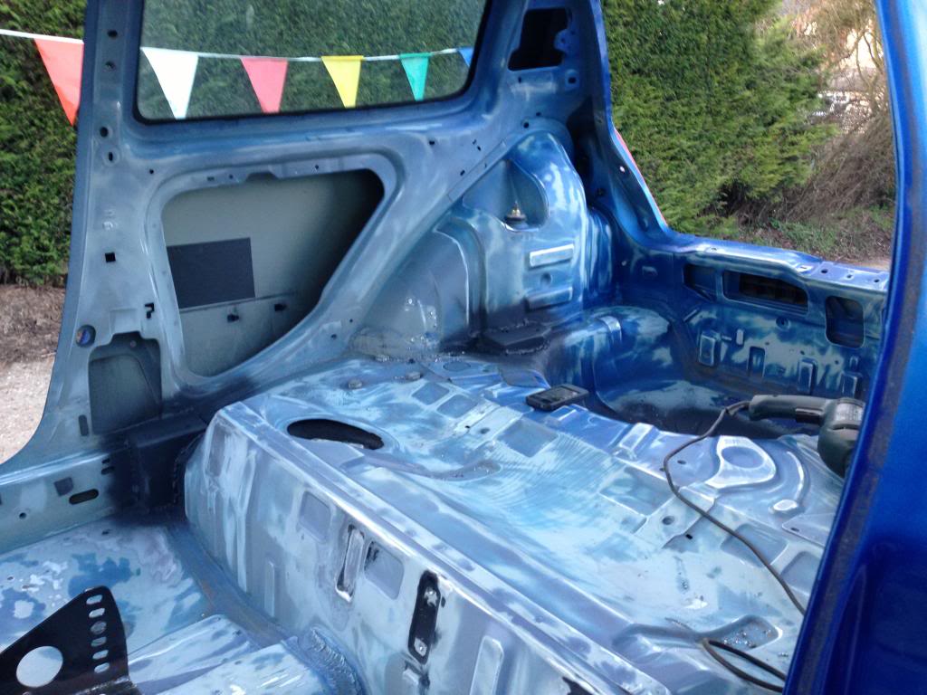

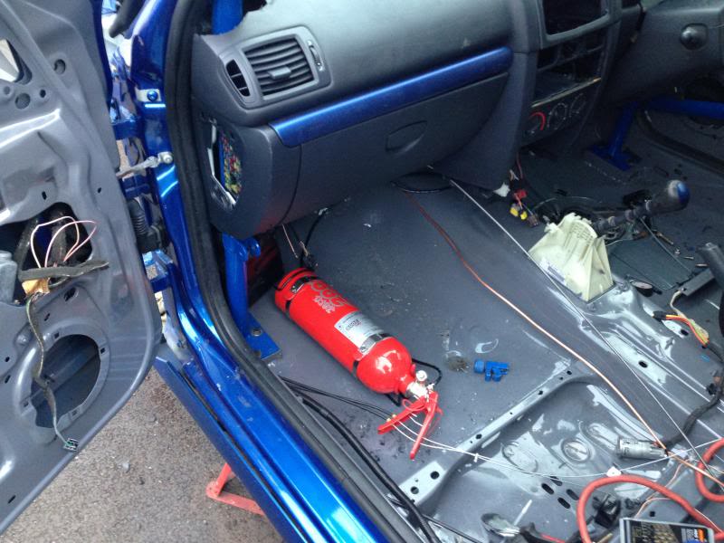

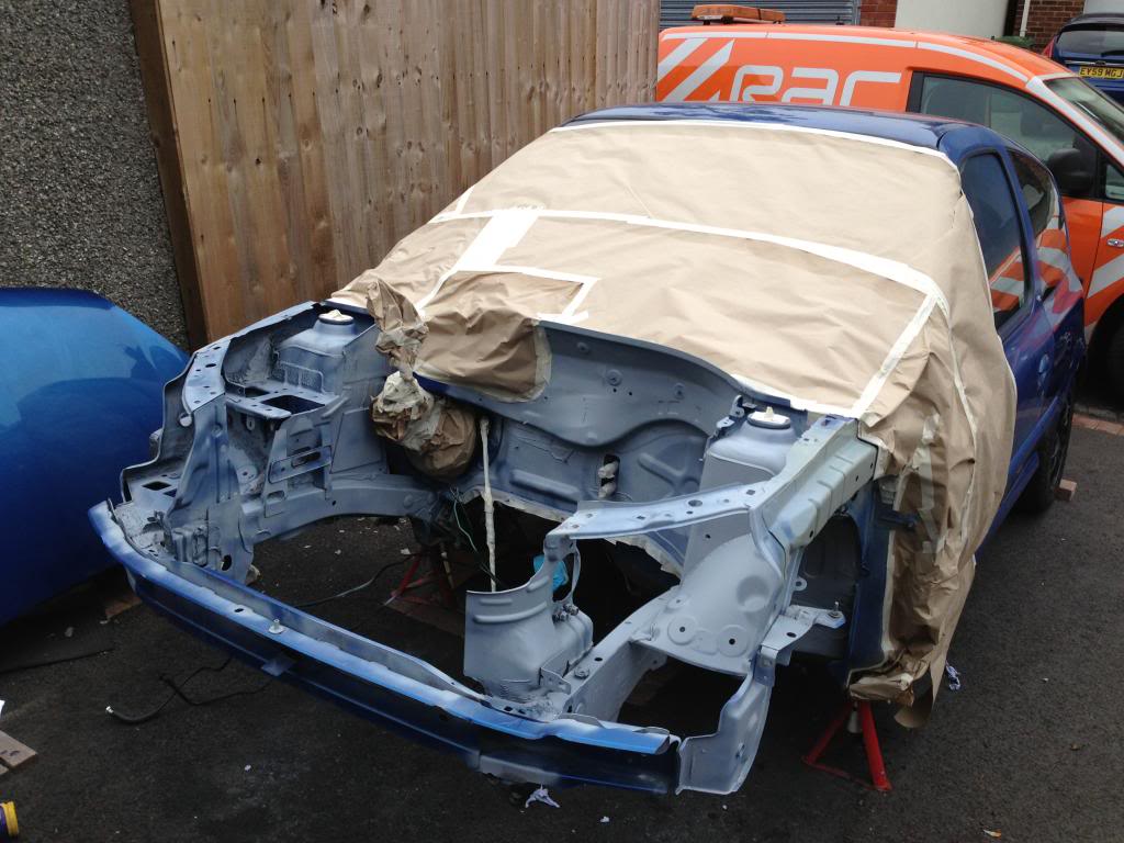

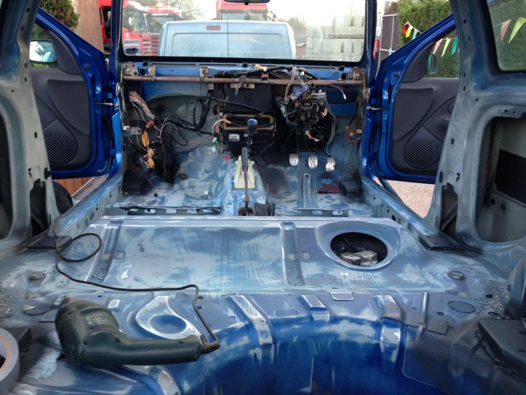

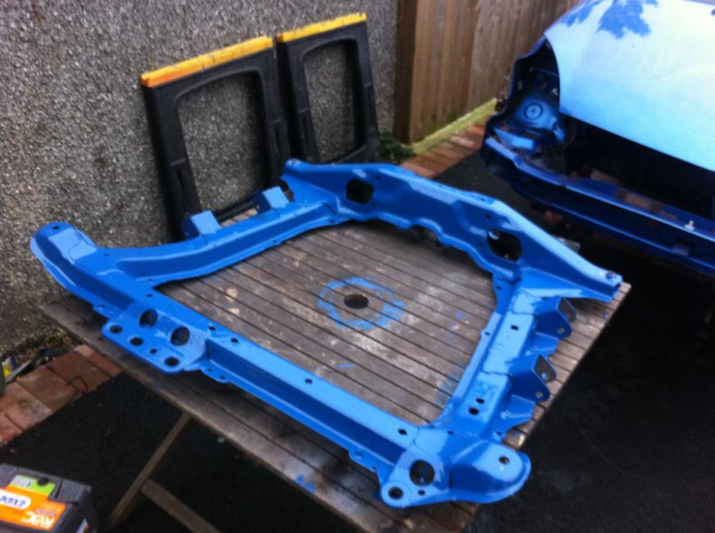

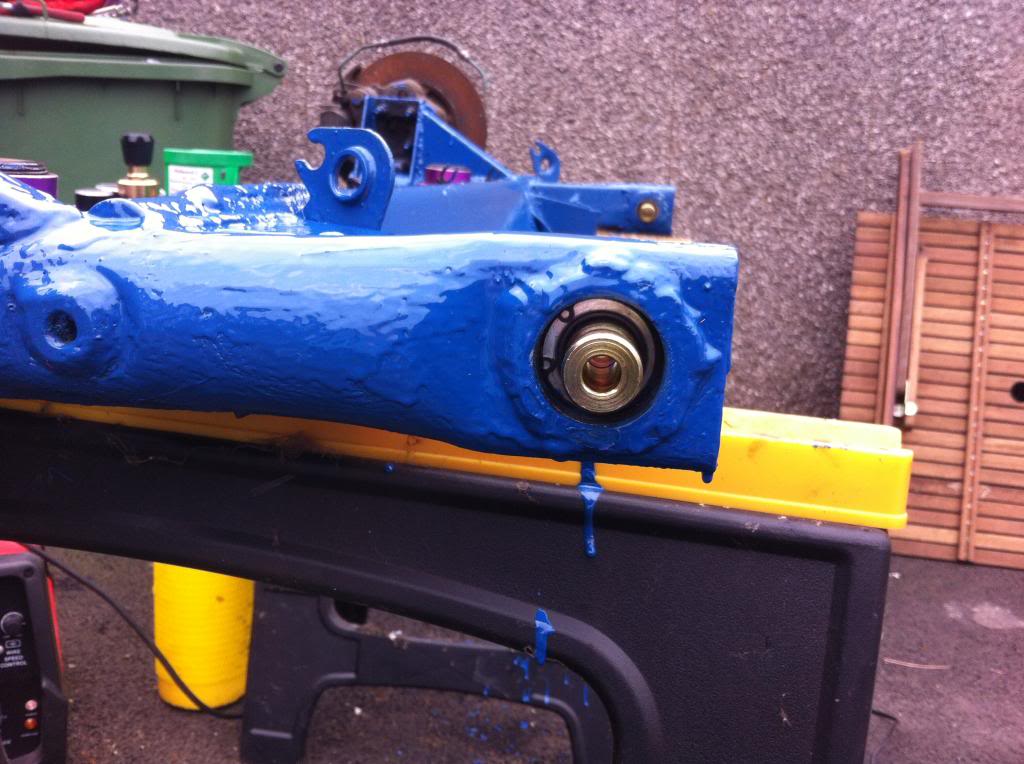

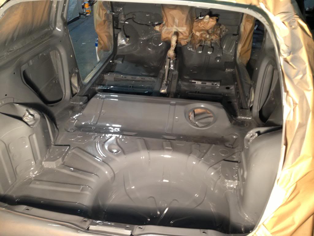

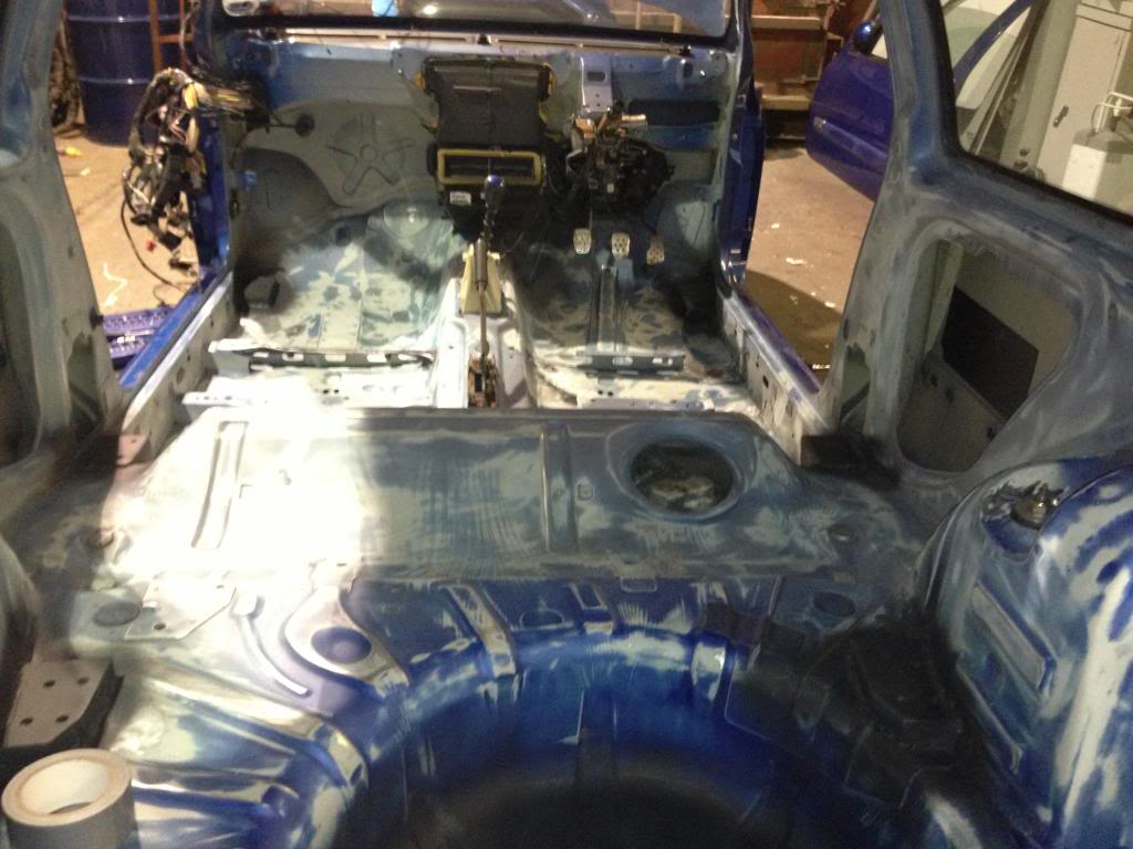

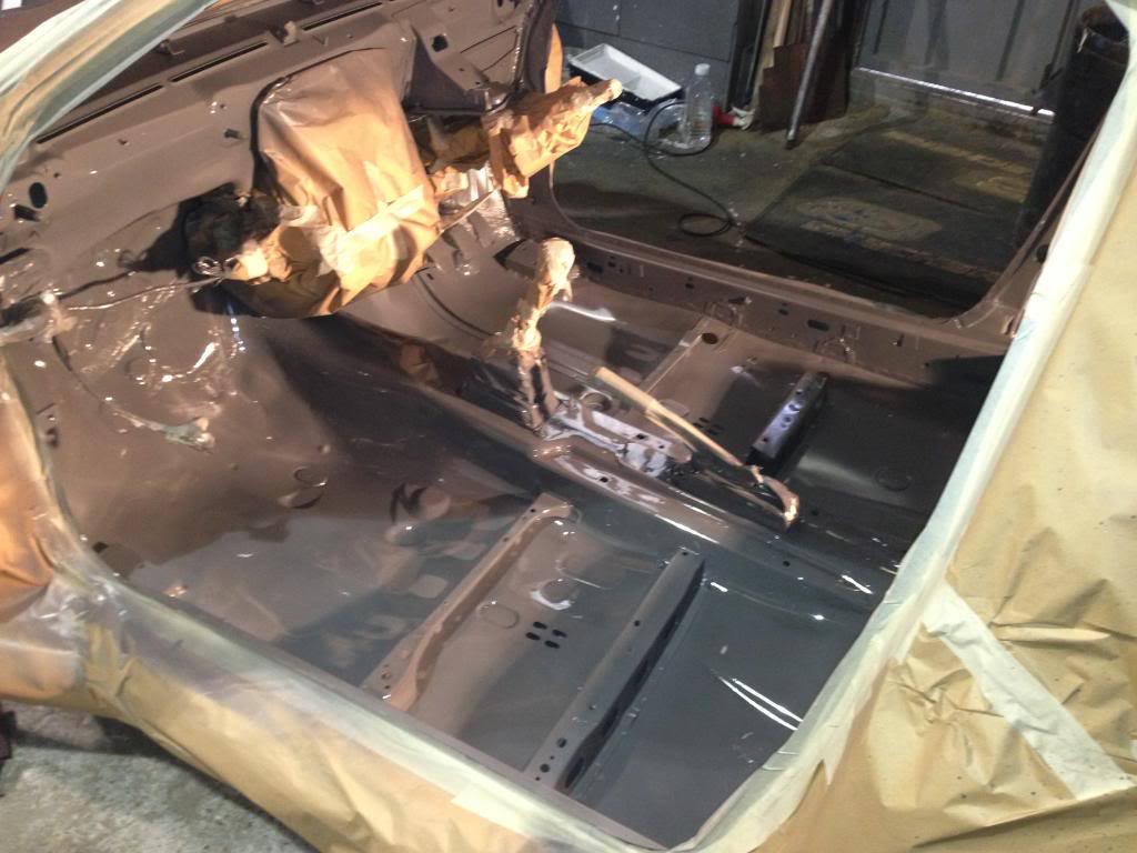

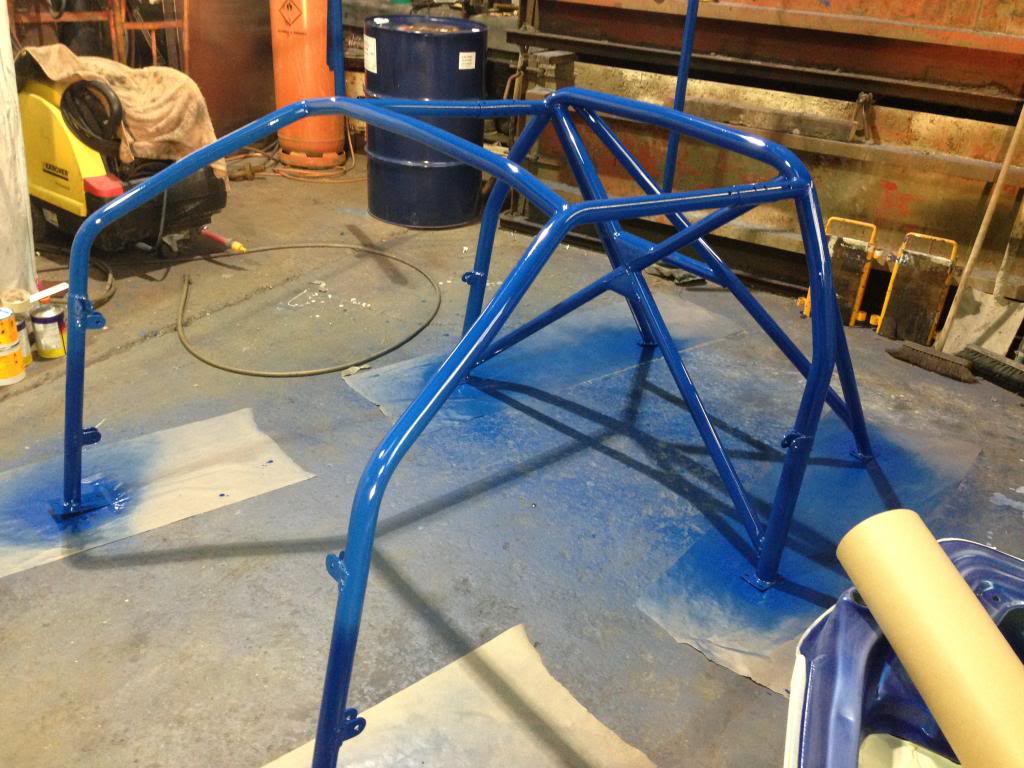

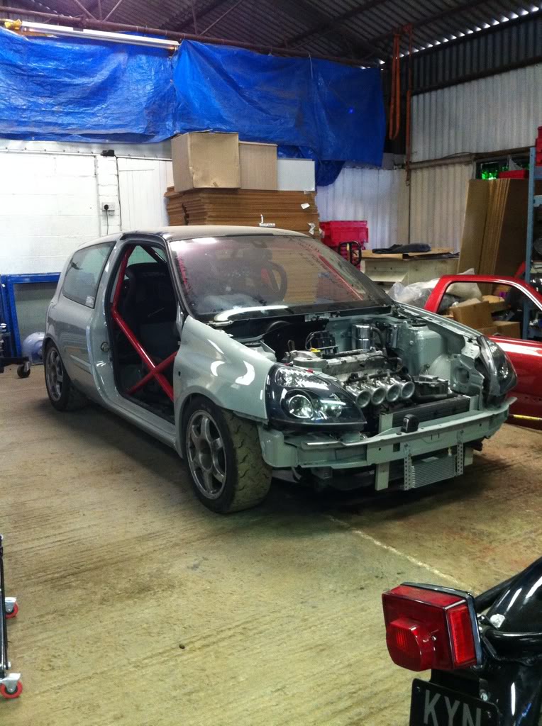

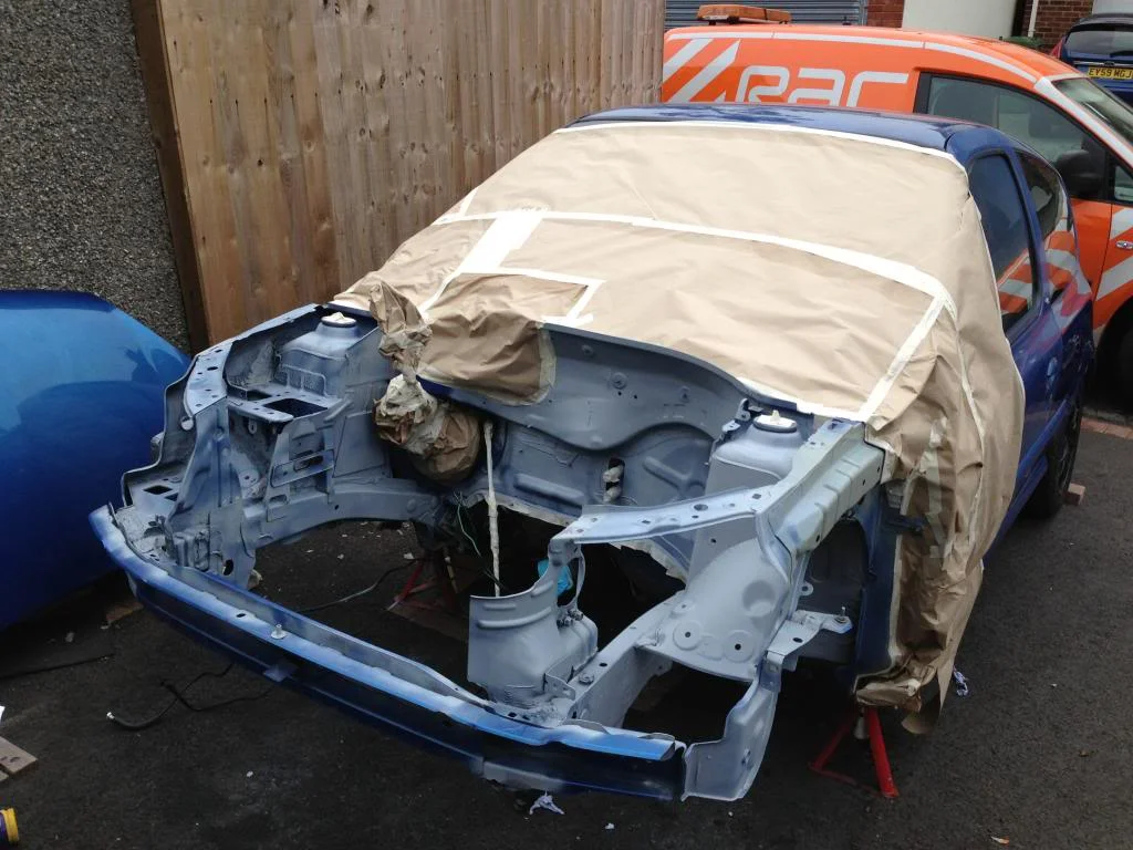

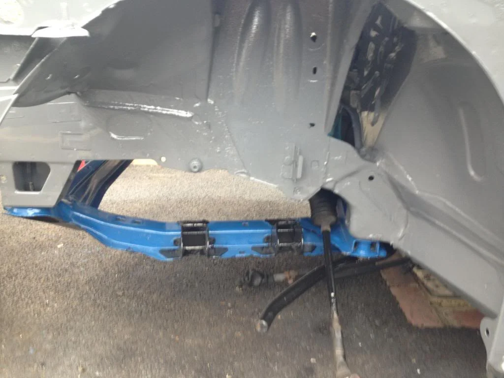

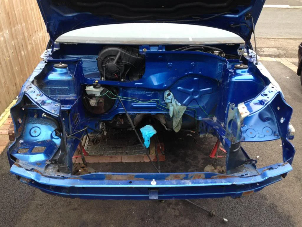

After a few years away from racing, last year I decided to get back to the fold with a Clio 172, My choice of car was the 172 Cup as origonally I decided to keep it a simple build with not too much hard work involved to get it ready for race.
I quickly realised that it wouldnt be that simple and kept seeing areas on the car that could be improved and would kick myself if I hadnt built it properly from the outset, so the car started to get smaller as bits came off and the list began to grow,

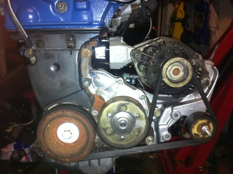

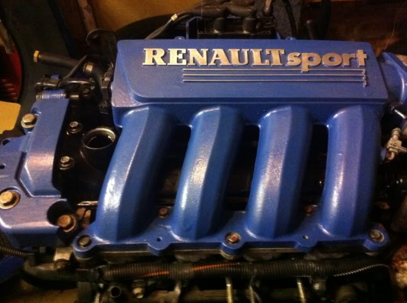

So far I'm about three quarters of the way through with most of the leg work done, I'm not gong to bore you with the progress over the last 6 months but will post some pictures to date and continue with progress updates from here on,
So a story in the life of my 172 Cup tin top racer build up to now.
So Thats where I am up to now, Still waiting for some parts to arrive so I can bolt the gearbox back on and re fit the engine after an overhaul.

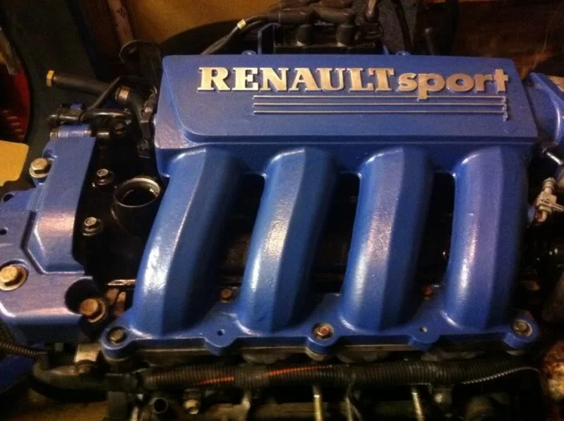

Engine spec wise, I've blown all my budget this year on suspension and drivetrain so the engine is internally standard apart from arp bolts, new dephaser,pulleys and belt, Next winter will be another engine refresh with more power and stronger internal,cams and ITB's

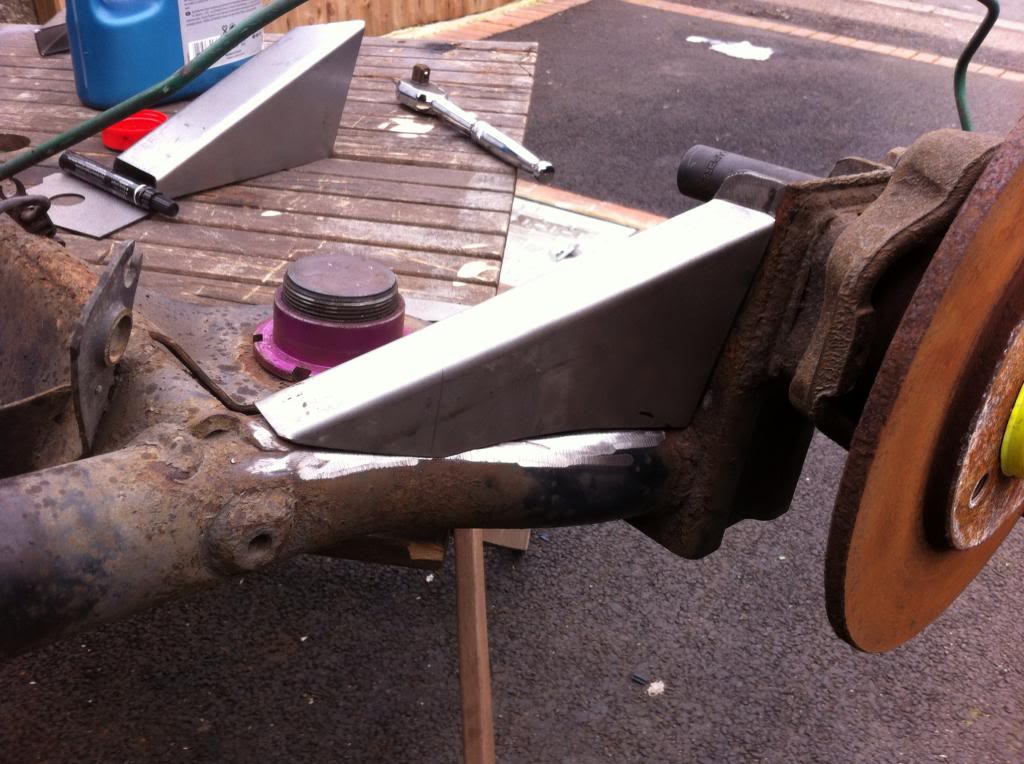

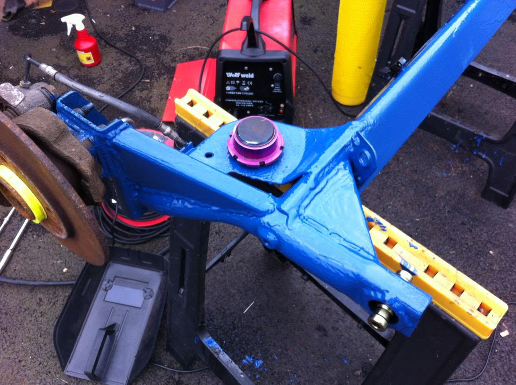

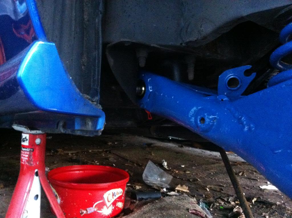

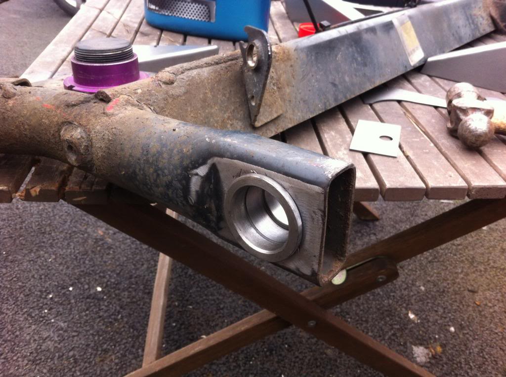

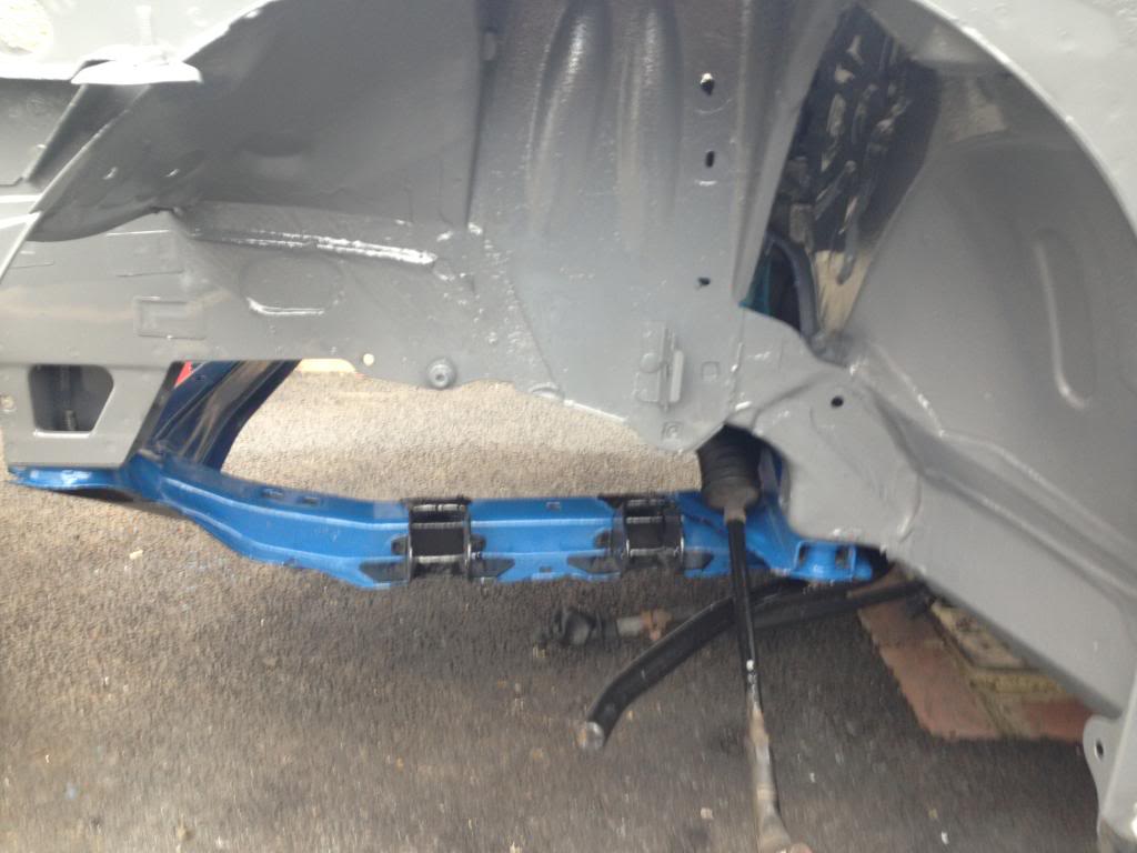

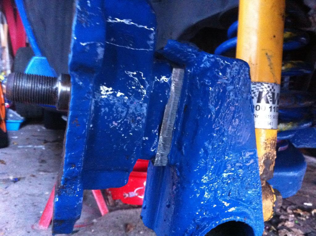

Looking good so far! Have you gone for KW's variant 2's?
Yes, they are Variant 2's, on the look out for some rear "proper" coilovers though and remove the inboard spring.
Managed to get the comp brake solid top mounts fitted this eve, will get some pics up tommorrow

Have a word with Josh from Cooksport about his Ast kits I have just fitted mine but kept the original spring location but as they use the rear coilover damper i dont think it would cost too much to convert to a coilover set up.

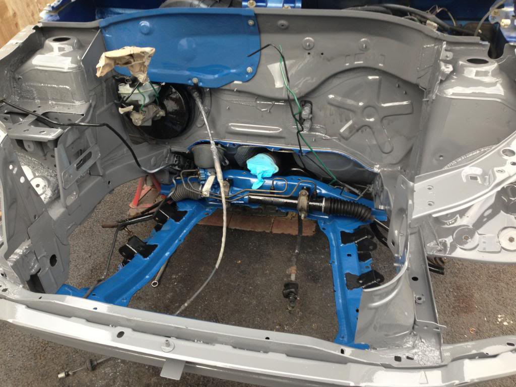

Ok, so I am in the middle of removing the power steering pump and using a saxo electric pump, I've dont this many years ago on a different race car but not a 172.
Below is a pic of my present temp setup but if anyone else has ideas then it would be most appreciated

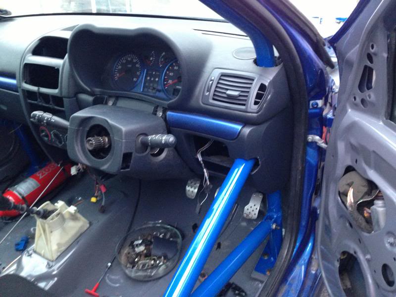

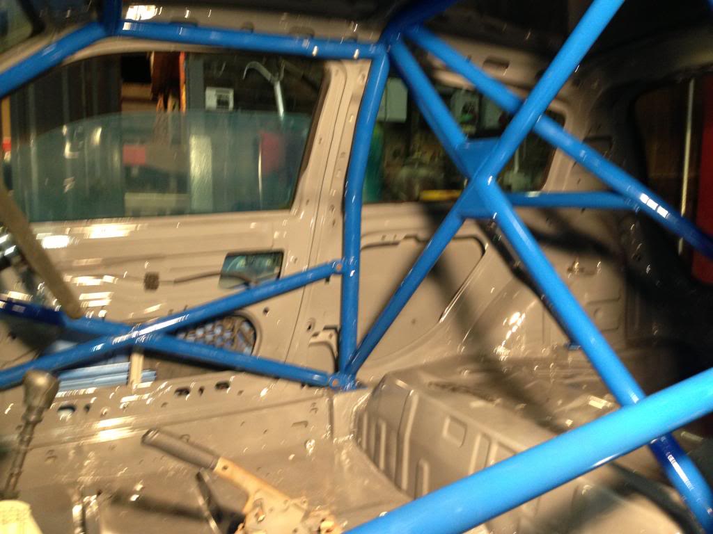

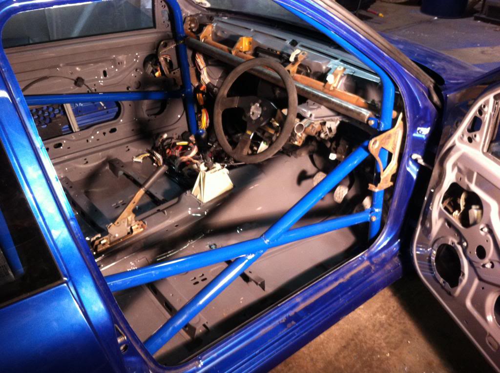

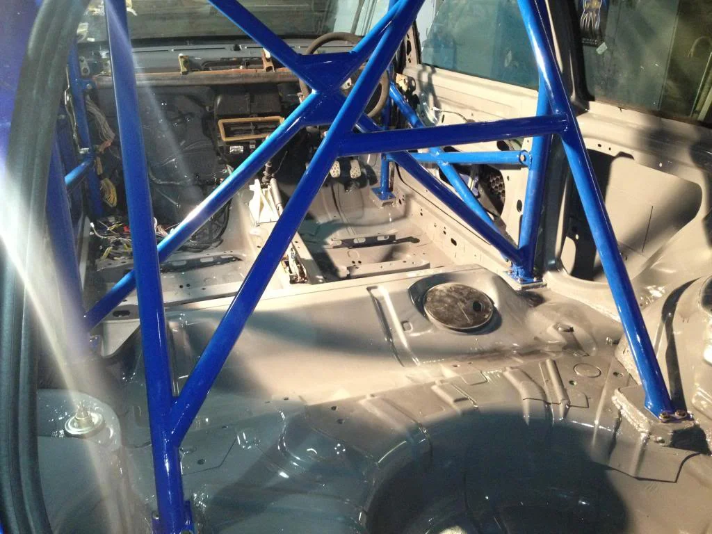

What cage is that you have fitted mate? Had a quick read through but apologies if you've already said and i've missed it. Cheers
  clio cup
Tomo,
Its the OMP bolt in, Its had some mods to it, the first being a bulkhead bar across the two front legs that also attach to the steering column and a harness bar welded in, Also drivers side cross bar instead of single bar. Bought from balance motorsport although I think all the OMP stuff comes through Demon thieves.
What parts did you use for the Saxo pump mod Buddy?

Jay also pointed me in the right direction, Amazing what you miss when your engrosed in something, woods and trees come to mind, lol

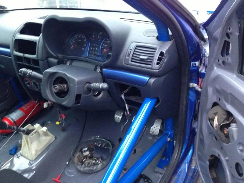

A small update,

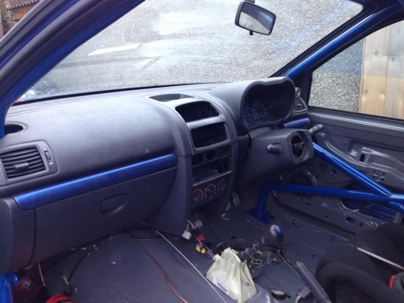

Made some progress on the dash today, Not as simple as it seems as I have a 40mm cross bar running across the bulkhead attached to each side of the Roll cage and also to the steering comlumn,
Not decided where my gauges or switch panel will go yet as I'm waiting for a panel to come from the fabricators, Ignition switch will be infront of the gear lever but only for the purposes of the immobiliser as I dont want anyone driving the car away.
I have alot of bits waiting to go onto the car but am still waiting for my gripper diff to arrive and can only do small thing till the engine and gearbox are in, once that happens its full speed ahead and should be ready within a couple fo weeks afer engine install.

Hi
I have a couple of questions regarding your cage , does it clear the fuse box ok or does it need to be moved ? and the rear stays that go down to the rear floor, did you raise the plating up as opposed to welding the plate direct to the floor to allow for anything as some of the other Omp cages look like they are welded flat , if you know what I mean ?
