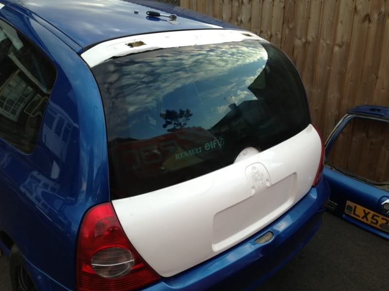

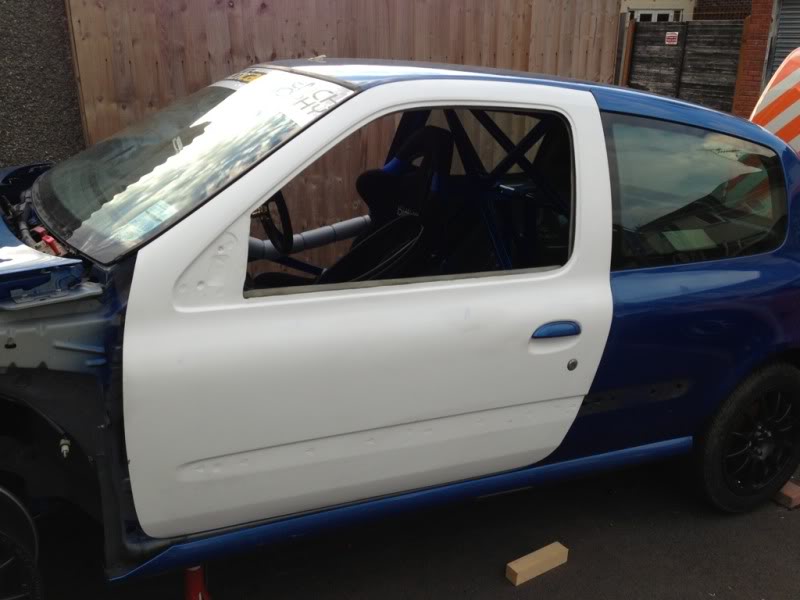

Ok, Its been a few weeks since I have updated this so a small photo bomb required,
So, My Diff finally turned up, not with the ratio I originally ordered as this was the problem in the first place, The company I ordered it from wasn't exactly being truthfull with my updates and a quick call direct to Gripper revealed that the only thing holding up the order was the ratio I had ordered was not in stock and would be for some weeks due to a machining issue. Gripper kindly offered me other ratio's which they had on the shelf, this could of been sorted out 3 months ago if only the guy I ordered it from asked me the question!

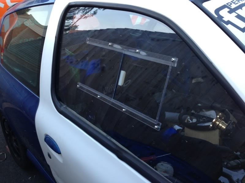

In the meantime I've managed to get my fibreglass doors and tailgate on, no real problems here, Also polycarbonate windows fitted.

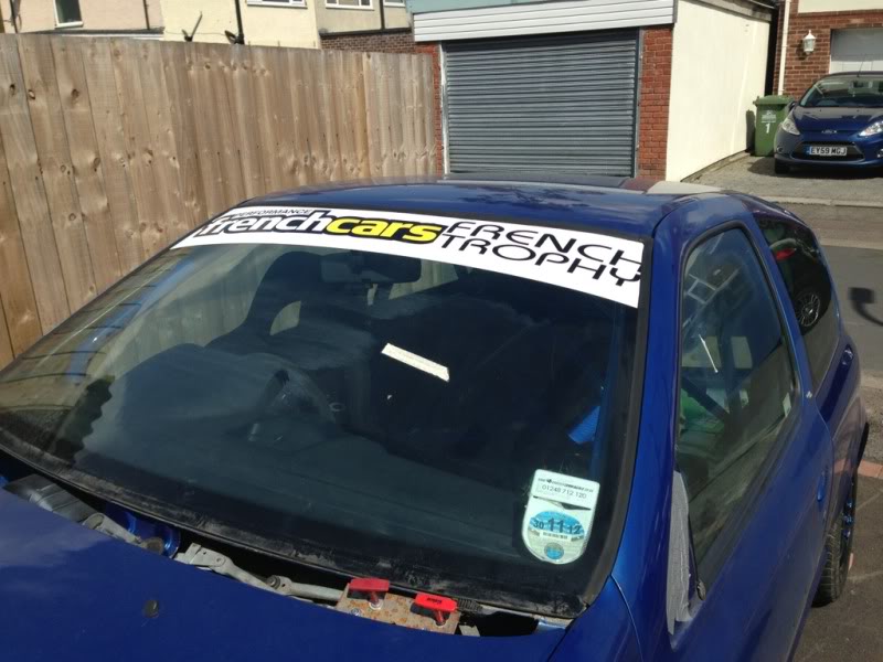

Most importantly is the front screen sticker!

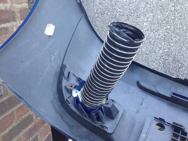

Also got my brake ducts finished

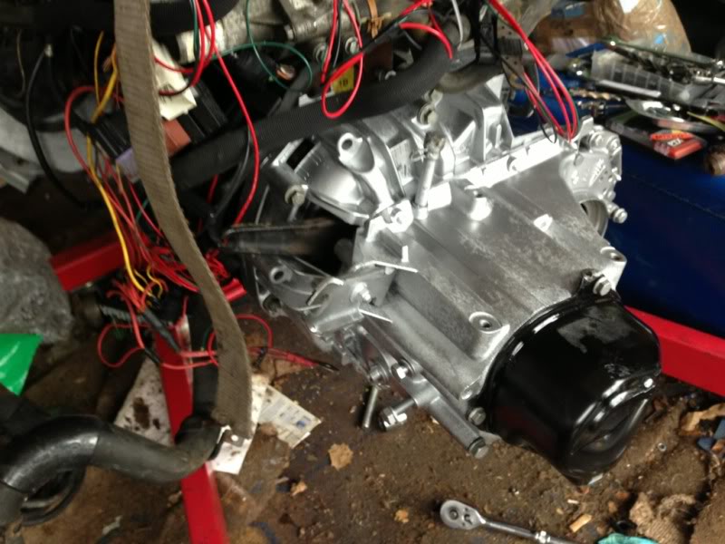

Don't even think of fitting a gripper diff with crown wheel and pinion yourself if you've never stripped a Renault gearbox before, My hands now look like the inside of a JC5 including synchro's! However, the box is now back together with new bearings and seals, Will be "suck it and see" regarding ratio though.
As you can see the gearbox is now on the engine and almost ready to be dropped in, All that's left in the gearbox is to fit a modified 5th gear retaining bolt and washer as the mainshaft is slightly different to original.
These should be here tomorrow and engine should be in place by the weekend. Getting close now and starting to have trouble sleeping now!

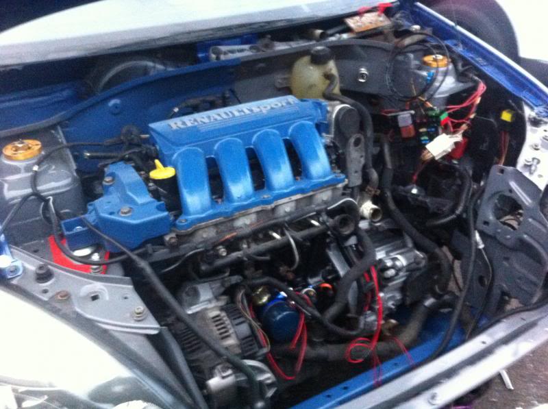

[h=5]

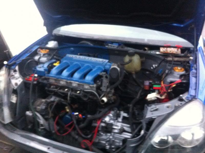

[/h][h=5]I got busy this evening and the engine is in! Electric plumbed and driveshafts, wishbones brakes back on,
Its really starting to take shape now, should be rolling Saturday afternoon and oil cooler pipe work should be completed next week, Then its time to start the bugger,
Its certainly felt like a long journey, hope its over soon and can enjoy mine and others hard work.
