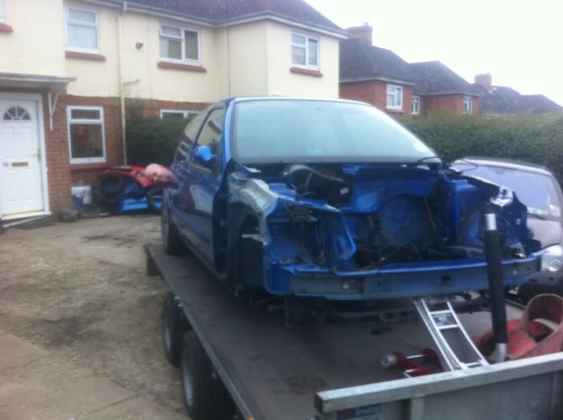

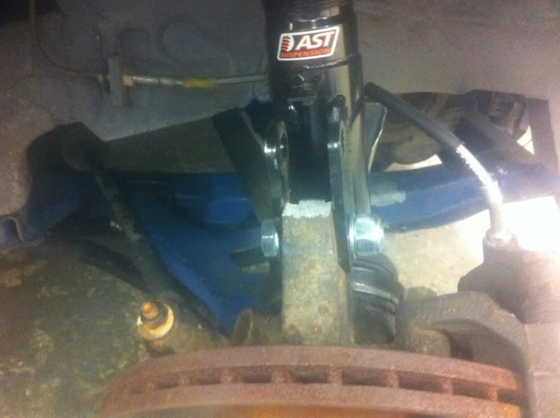

So I finally got to look at the Clio today, Plan was to assess the AST's and go from there, First inspection shows that there is no damage to the strutts and all that has been damaged is front subframe(which just kissed the engine sump) off side wishbone, hub and ball joint,

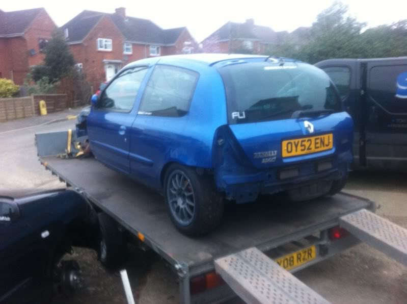

We shot off to collect the new shell which was a 80 mile round trip., No problem getting it on the trailer.

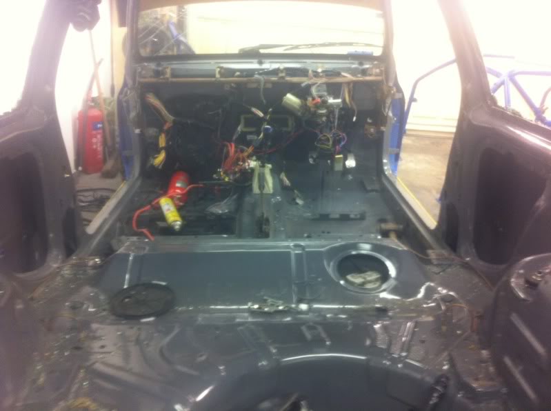

Then back to the workshop to start stripping the bent car, Luckily when I built the car I went on the basis that it needs to practacle but minimal, so the strip down wasnt bad and within a couple of hours I was left with this
Tommorow we will cut the old foot plates out ready for welding in on Thursday, Hopefully have it painted inside by the weekend.
Who'd of thought that the AST's are stronger than cast Iron?????

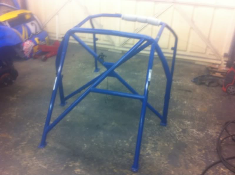

Always wondered about reusing a cage after a roll, is it ok so long as its not been bent or is it heading for the bin?
  clio cup
I'm re using the cage as its not damaged, it never hit the roof,
I'm re shelling it due to the inner quarter damage where it landed on its arse on the passenger rear quarter. If there was any danger that the cage took a hit I would bin it.
