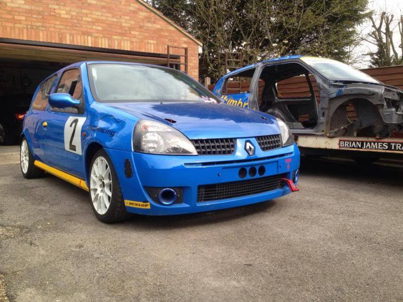

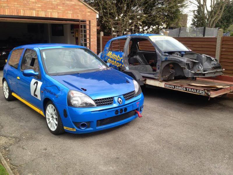

Some more pics of the almost complete car taken on Friday, I've not amaged to do anything on the car over the wekend due to weddings and mothers day so will be continueing tommorow night, Its booked in for geometry on Thursday so hope nothing is too far out,
List of jobs to do now are
Finish sponsor decals
Wire aux gauges
wrap bonnet
bolt bonnet catches in
Corner weight and geo
Think thats about it, I'm then off to Rocking early Friday morning for testing.
