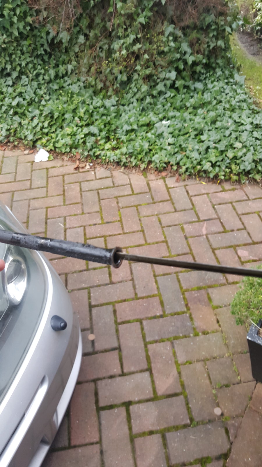

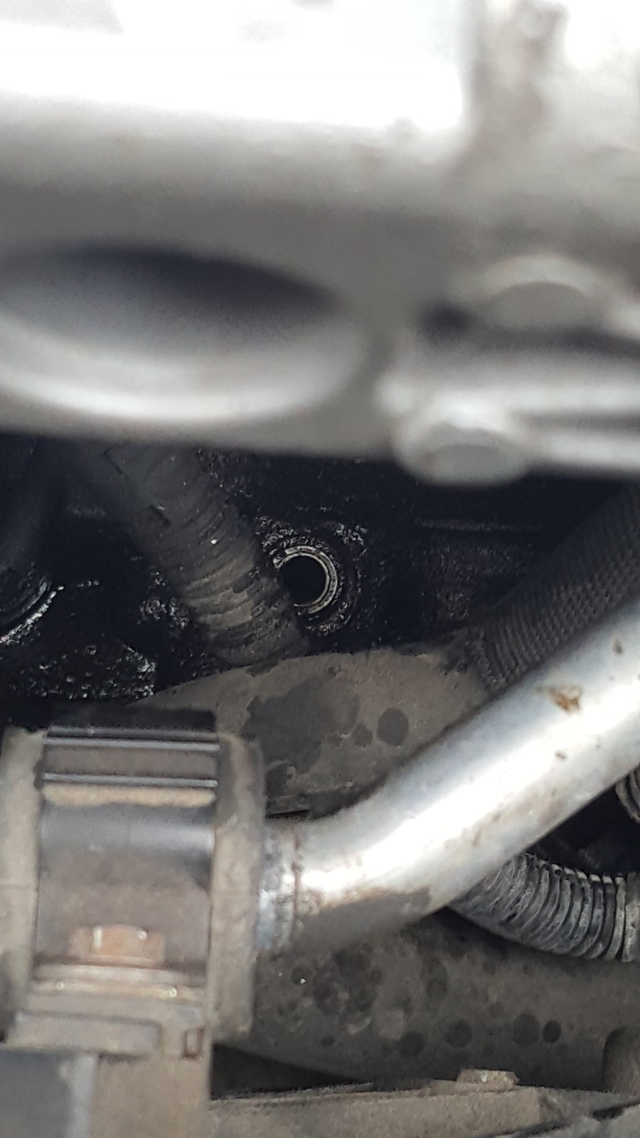

Noticed the car as giving low oil warning and as i went to check the oil i noticed oil on the block due to the tube snapping off somehow. I have a new one on the way that wil arrive tommorow but i cant get the rest of the tube out the block. Any suggestions ? Doesnt help that there is barley any space at the front
Nothing to bond it back on its flush. i have a new dipstick arriving tomorrow more concerned about getting the remaining bit out without taking the sump off
it's flared out where it meets the block, good clean and bond it. bit of bar down it to stop the tube getting clogged up and hold it straight while it cures.
