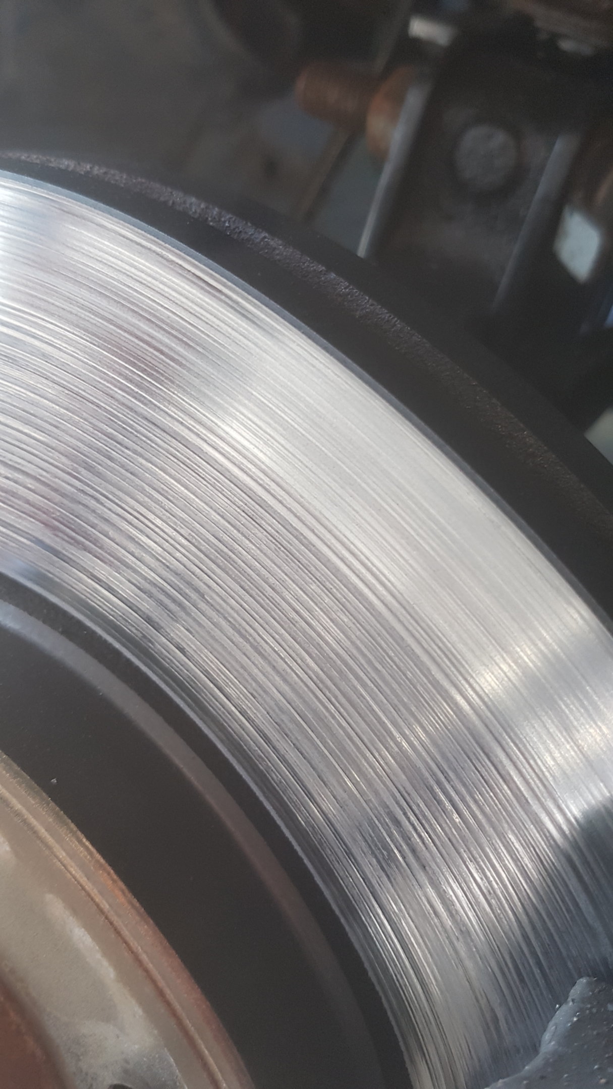

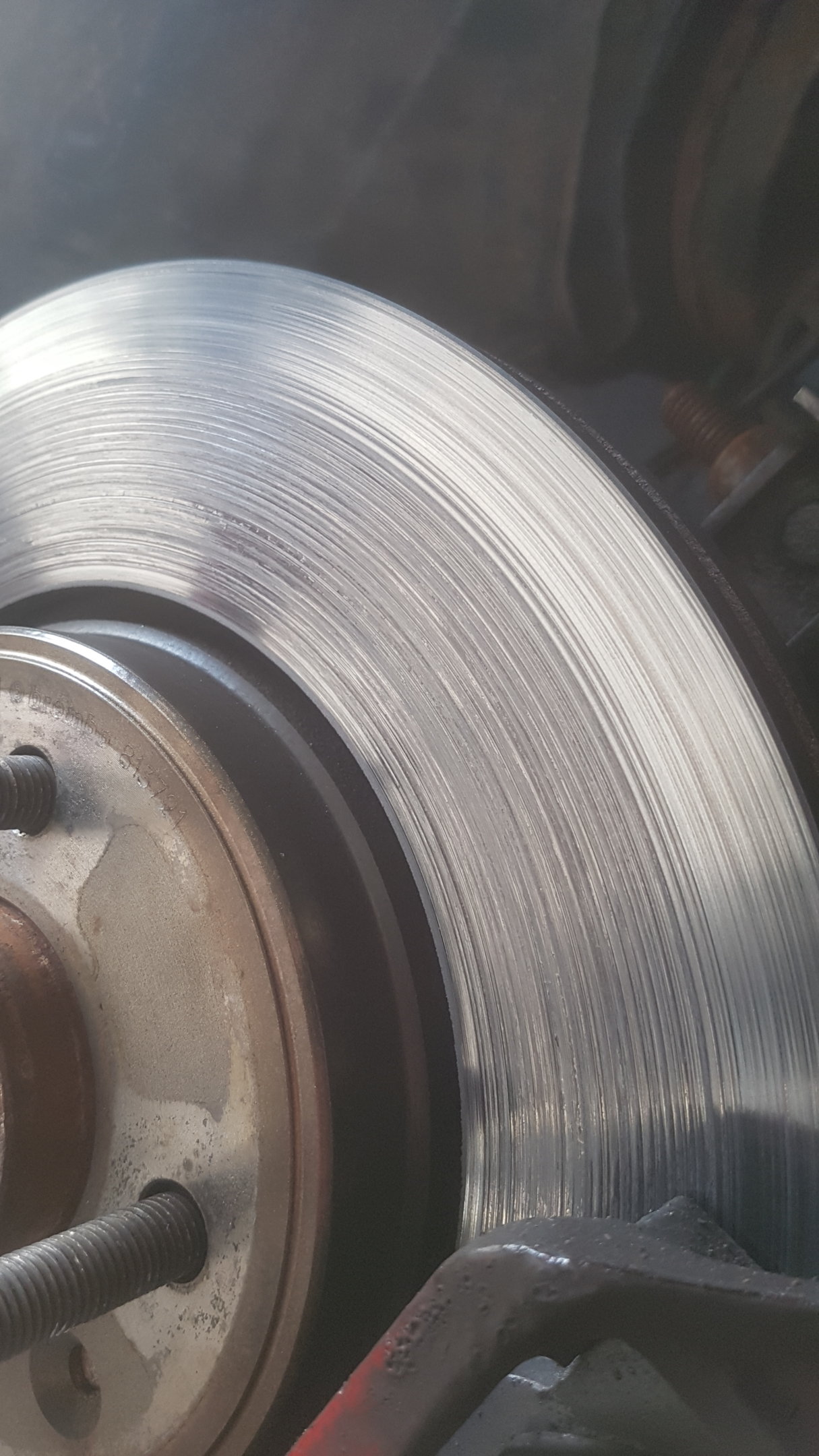

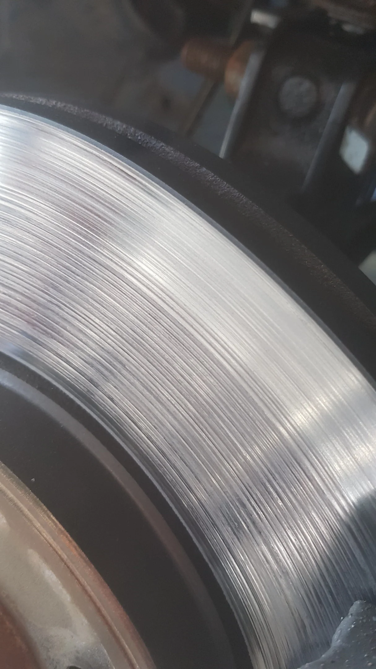

I did a trackday yesterday with brand new Brembo HC discs and ds1.11s and now have deep score marks on the discs.
Ive driven the same way on the same setup and never had this.
So
1) should I be alarmed?
2) will this reduce braking due to the surface being very uneven?
3) Will my pads get chewed up a lot faster now my discs are like this? I.e. should I change the discs?
4) is this likely to get better or worse if I carry on using them?

Mine where nothing like this with HC discs and DS1.11 pads, really smooth and hardly any wear at all after 2-3 days on either pad or discs.
That's what I cant understand. Plus ive used these pads with my old discs for 10+ trackdays with nice even wear.
To be honest the discs I threw in the skip are in better condition than these!
I've transferred pads to different discs and vice versa and never had an issue, just bedded them in each time. Out of interest mate how did you bed them in? Did you do it at the track, if so then they wont have had a full heat cycle and there in lies the issue.

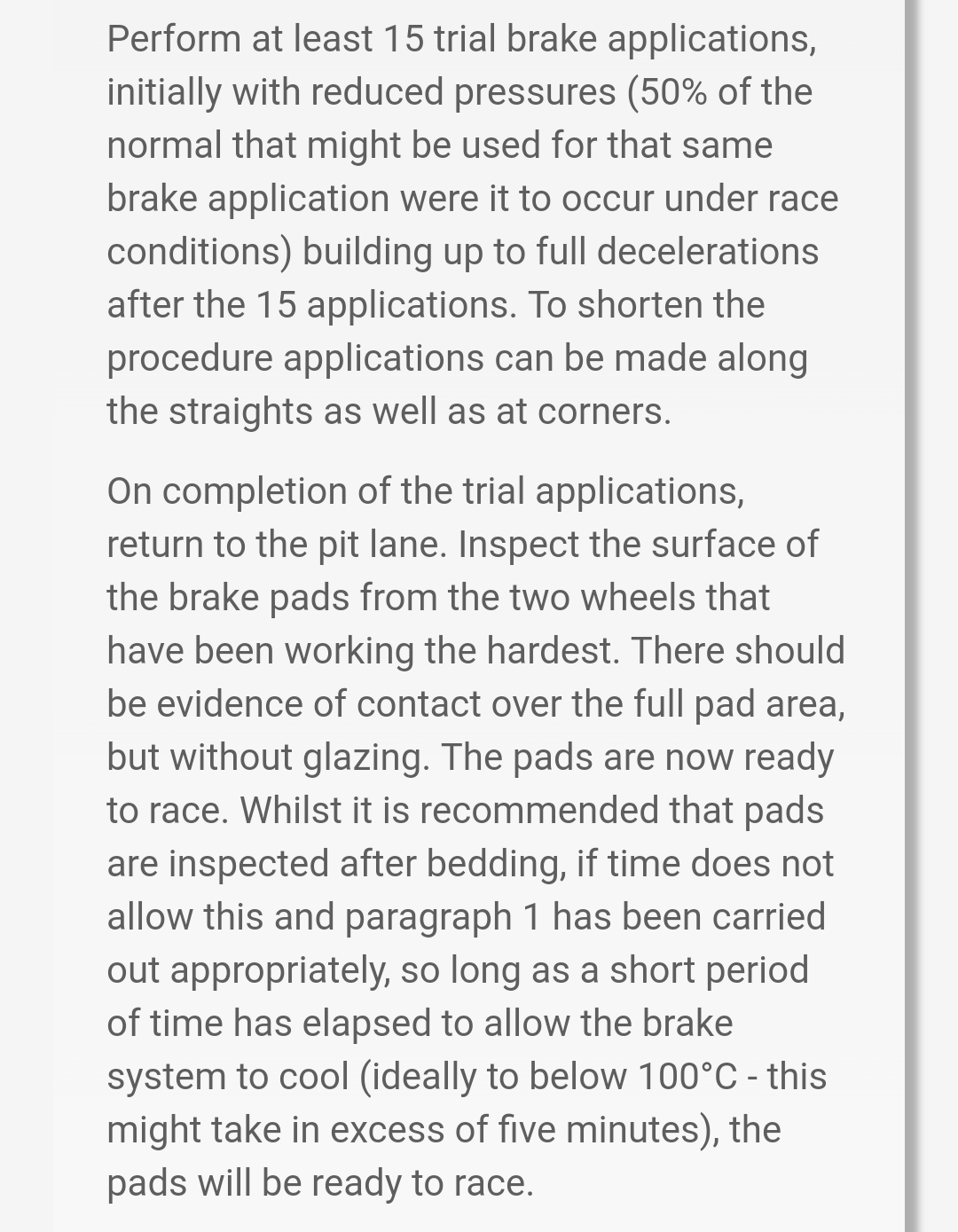

I followed the instructions as on the Ferodo website, but still seemed to have had an issue

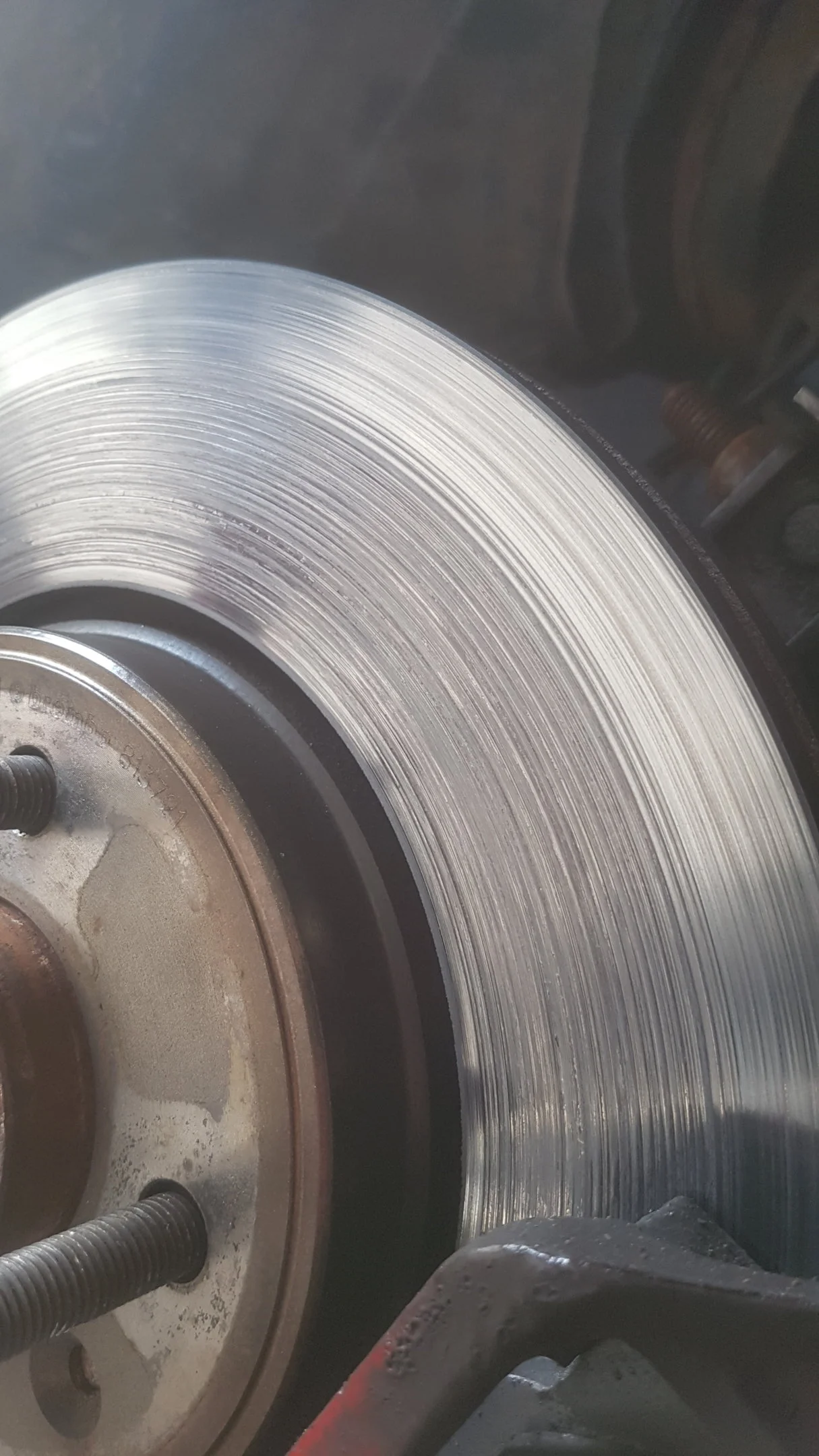

Did you let them cool overnight though? The discs in particular in my experience need to go through a cure. I've bedded in pads and discs once at the track without cooling fully and the pads and discs where toast at the end of the day similar looking to yours but no pad material left.
