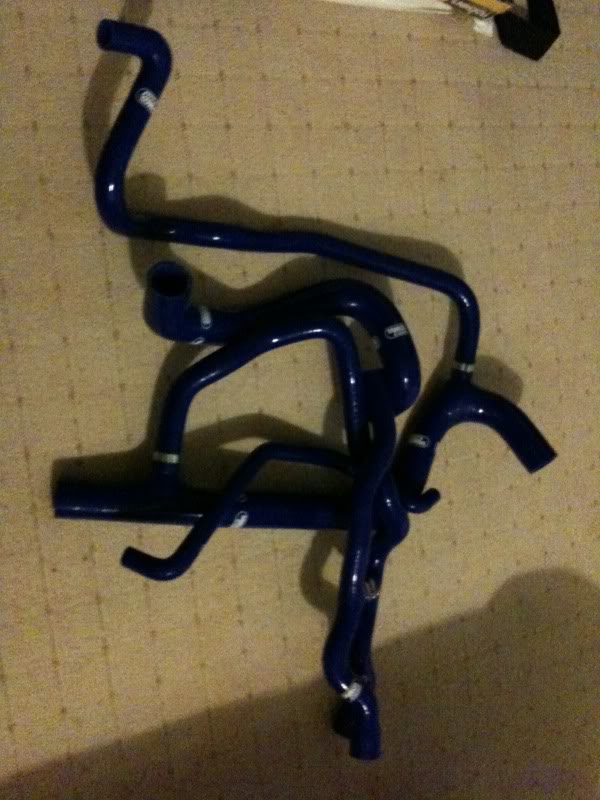

Quick update as not done much lately!
These turned up today :)
so I'll be fitting them over Xmas! Exhaust isn't liking the boost, all needs to be redone from the cat back! Probably getting a custom one made up!
Car is returning 250 miles per tank with varied hard and easy driving which is quite respectable as it's not much different to before!
