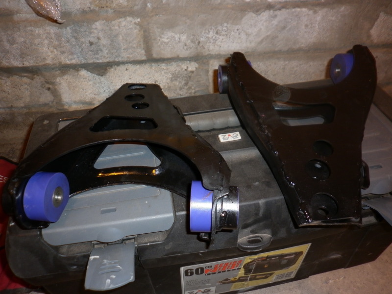

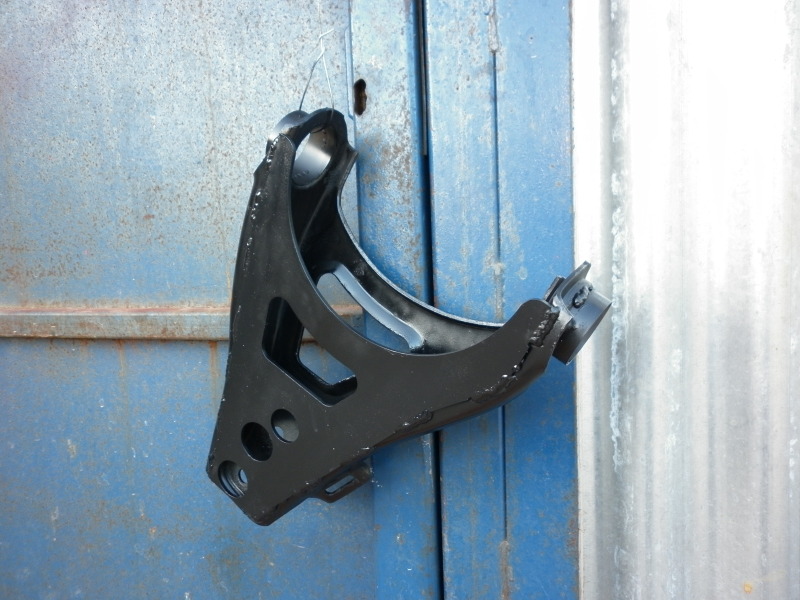

I am going to be fitting some old style ones shortly, anyone got a pic of the sleve welded into place. I know its likely to be straight forward just wouldnt mind a picture for reference!

few rubbish shots of wishbones welded peanut head.

Here you go.
