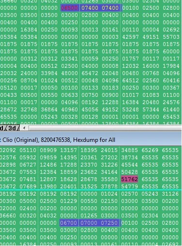

In the Siemens (Sirius 32) ECU there are three rev limiters. I'm not one to touch the rev limit usually - I'm old and boring, but, if I wanted to put my foot down after 2 minutes of driving, I can't see why the water temperature should keep the rev limit low. Obviously its a working engine, and there are explosions going off inside every second! So - after one minute at idle I know the 'engine' will be operating at full temperature, regardless of water temp.
My question Chip-mk1 is if I increased the them all to match would it really cause severe damage..?

Here's the screenshot of my 182 org map
Top half is modified and bottom is the standard file.
I know where the timing is, and I also know where the fueling is. There's one more map I'm looking for.

Send me your original if you dont mind. There might be the same 16 x 16 in yours, you might be able to shed some light.
Also. The first Rev Limit you increased is for 'low temp' or when in 'safe mode' ??? Cheers :D
Nicki, while the pistons might be at full operating temperature, the idea of the lower rpm till the water temp is to ensure that the temperature is spread well throughout the block, as if you have thermal stresses from expansion occuring more in some parts of the block than others at the same time as you have maximum force it increases the chance of cracking a block of popping a core plug etc.
However if yours is taking ages to switch over, the most likely issue is just you need a new thermostat.
