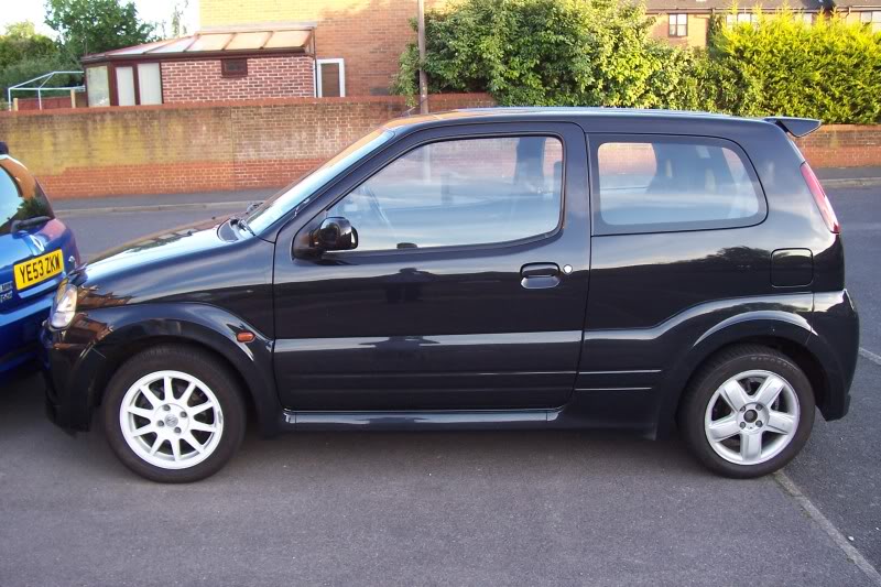

Does anyone know what model these Enkei wheels are?
  Clio 182
Refurbed in red but does anyone know the original model so I can find the offset & width of them.
All i know is they are lightweight enkei wheels with 195/45/15 tyres on

Enkei ER Tarmac. They come standard on Suzuki ignis sports.
They will fit Clios with 4 studs
  Suzuki Ignis Sport
Not very wide! Here are the measurements
5Jx15 (basic size)
4x100 pcd (the bolt holes)
54.1 centre bore (the hole in the middle)
45ET offset (how close to teh outer edge of the wheel arch they are).

And center bore is too small for clios? and offset will need spacers if you dont' want them sitting right inside arches?
  ph1-172
i think your gonna need spacers/ adaptors. can't remember 100% but think the outside dia on the hub is 60mm so the centre bore won't sit over it.
someone could probably confirm this?
  Suzuki Ignis Sport
Then how comes this worked with no modifications?
Clio Dynamique alloy on Marks Ignis?
  Ibiza FR
Because... the centre bore is bigger on the Clio wheels, so you can use spigot rings to downsize the centre bore if you want them to fit properly, but you can't downsize the centre bore without adapters.....
