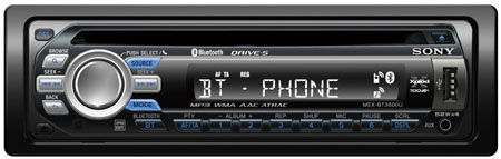

I use a Sony MEX BT3600 U, very good head unit IMO with coax outputs for speakers and sub, only niggle for me as I've said before the microphone quality isn't very good. Have to turn the blowers off if I want to be heard lol.
Comes with Aux and USB though.
