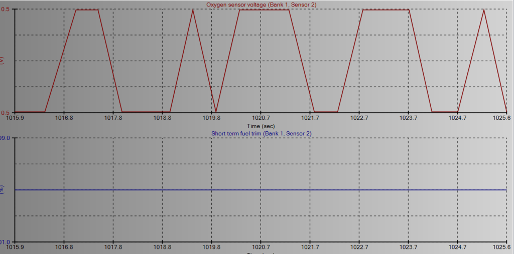

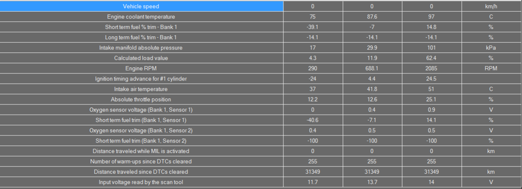

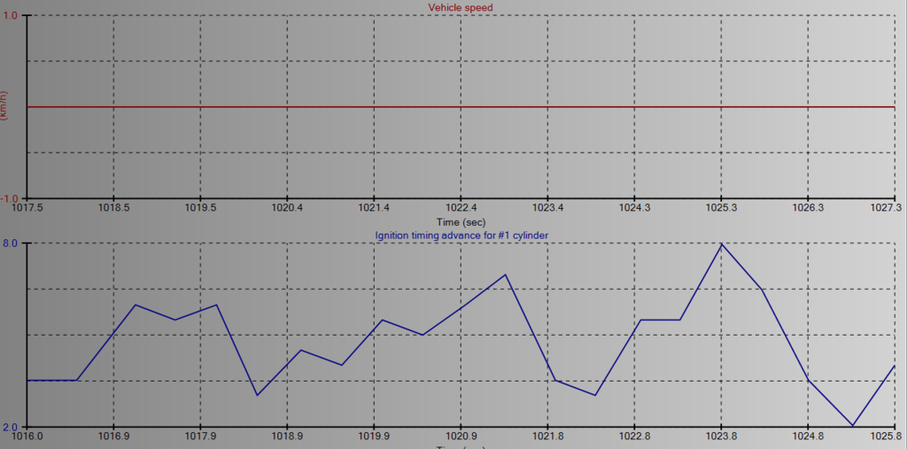

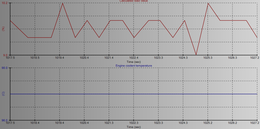

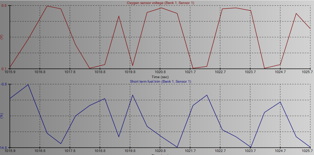

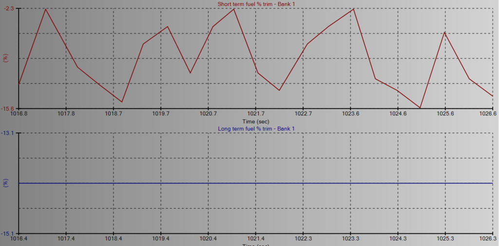

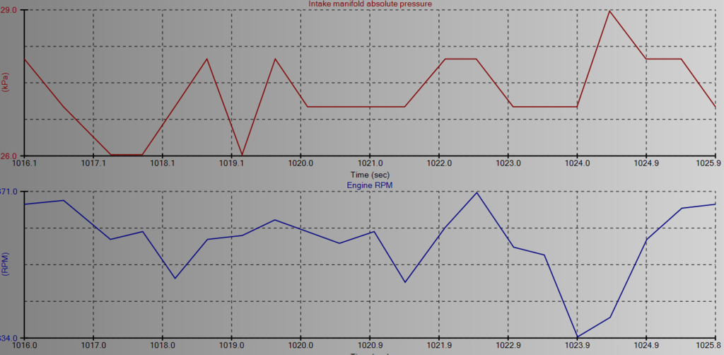

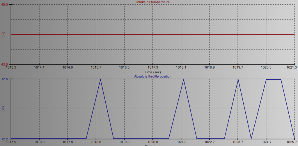

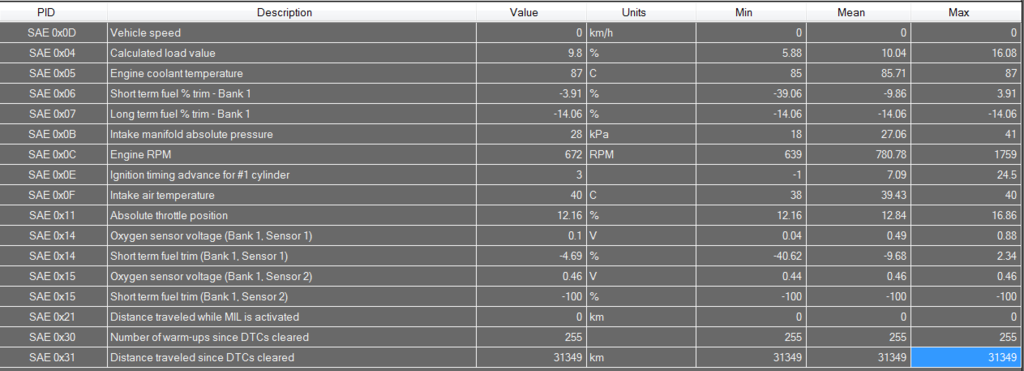

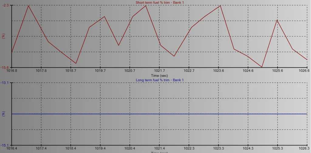

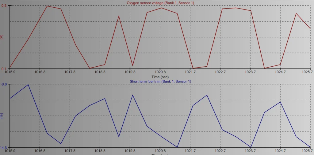

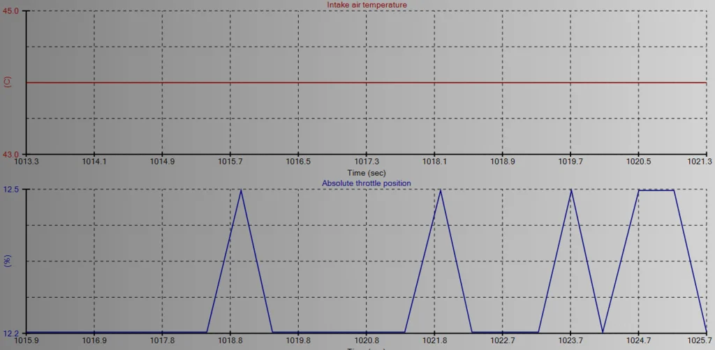

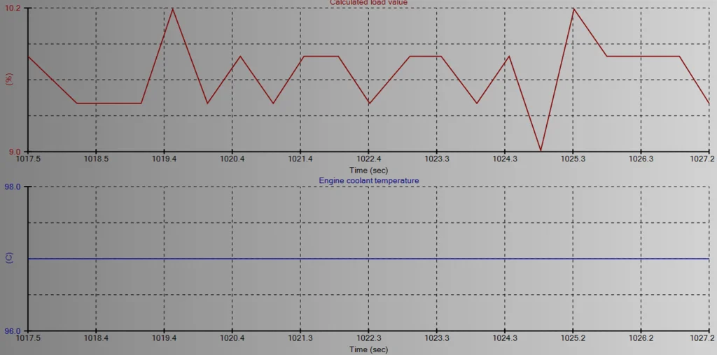

Anyway, came in from home, pluging in obdii tool. Here is all the info
Diagnostic Report
Created by TouchScan - OCTech, LLC www.obdsoftware.net
Date: 06/23/2015 17:11:51
VIN: VF1CN0C0**********
Manufacturer: Renault
Model: Twingo
Year: 2004
Monitor Status Report
Name Continuous Available Complete
Misfire Yes Yes Yes
Fuel System Yes No No
Components Yes Yes Yes
Catalyst No Yes Yes
Heated Catalyst No No No
Evap System No No No
Secondary Air System No No No
AC Refrigerant No No No
Oxygen Sensor No Yes Yes
Oxygen Sensor Heater No No No
EGR System No No No
MIL Off
Number of Stored Codes: 0
This vehicle is ready for emissions testing.
Trouble Code Report
There are no pending, stored, or permanent diagnostic trouble codes (DTCs).
Service $01 - Powertrain Diagnostic Data
PID Description Value Units
SAE 0x04 Calculated load value 9.8 %
SAE 0x05 Engine coolant temperature 90 C
SAE 0x06 Short term fuel % trim - Bank 1 -10.94 %
SAE 0x07 Long term fuel % trim - Bank 1 -14.06 %
SAE 0x0B Intake manifold absolute pressure 27 kPa
SAE 0x0C Engine RPM 666 RPM
SAE 0x0D Vehicle speed 0 km/h
SAE 0x0E Ignition timing advance for #1 cylinder 5
SAE 0x0F Intake air temperature 41 C
SAE 0x11 Absolute throttle position 12.16 %
SAE 0x14 Oxygen sensor voltage (Bank 1, Sensor 1) 0.65 V
SAE 0x14 Short term fuel trim (Bank 1, Sensor 1) -14.84 %
SAE 0x15 Oxygen sensor voltage (Bank 1, Sensor 2) 0.46 V
SAE 0x15 Short term fuel trim (Bank 1, Sensor 2) -100 %
SAE 0x21 Distance traveled while MIL is activated 0 km
SAE 0x30 Number of warm-ups since DTCs cleared 255
SAE 0x31 Distance traveled since DTCs cleared 31349 km
Custom 0x00 Input voltage read by the scan tool 13.8 V
Service $02 - Freeze Frame Report
A freeze frame was found but the vehicle has no stored trouble codes. This indicates that the freeze frame could contain out-of-date and inaccurate information.
0x03 Fuel system status Open-loop due to insufficient engine temperature
0x04 Calculated load value 0 %
0x05 Engine coolant temperature -40 C
0x06 Short term fuel % trim - Bank 1 0 %
0x07 Long term fuel % trim - Bank 1 0 %
0x0B Intake manifold absolute pressure 10 kPa
0x0C Engine RPM 0 RPM
Service $05 - Oxygen Sensors
Sensor Available
Bank 1 - Sensor 1 Yes
Bank 1 - Sensor 2 Yes
Bank 1 - Sensor 3 No
Bank 1 - Sensor 4 No
Bank 2 - Sensor 1 No
Bank 2 - Sensor 2 No
Bank 2 - Sensor 3 No
Bank 2 - Sensor 4 No
Service $06 - On-Board Monitoring
Component Description Value Minimum Maximum Units Result
$01 - Exhaust Gas Sensor Monitor Bank 1 – Sensor 1 TID $0A - Sensor period (calculated) 0.336 0 1.504 sec Pass
$21 - Catalyst Monitor Bank 1 TID $0A - Sensor period (calculated) 0 0 7650 counts Pass
$81 - Fuel System Monitor Bank 1 TID $84 - Manufacturer Defined -327.67 -327.67 -327.67 % Pass
$81 - Fuel System Monitor Bank 1 TID $85 - Manufacturer Defined -327.67 -327.67 -327.67 % Pass
$A1 - Misfire Monitor General Data TID $86 - Manufacturer Defined 1 0 65535 Pass
$A1 - Misfire Monitor General Data TID $87 - Manufacturer Defined 0 0 65535 Pass
Service $09 - Vehicle Information
General Information
Description Value
Vehicle Identification Number VF1CN0C*********
Calibration ID - $7E8 8200799147
Calibration ID - $7E8 8201015967
Calibration Verification Number Not Available
