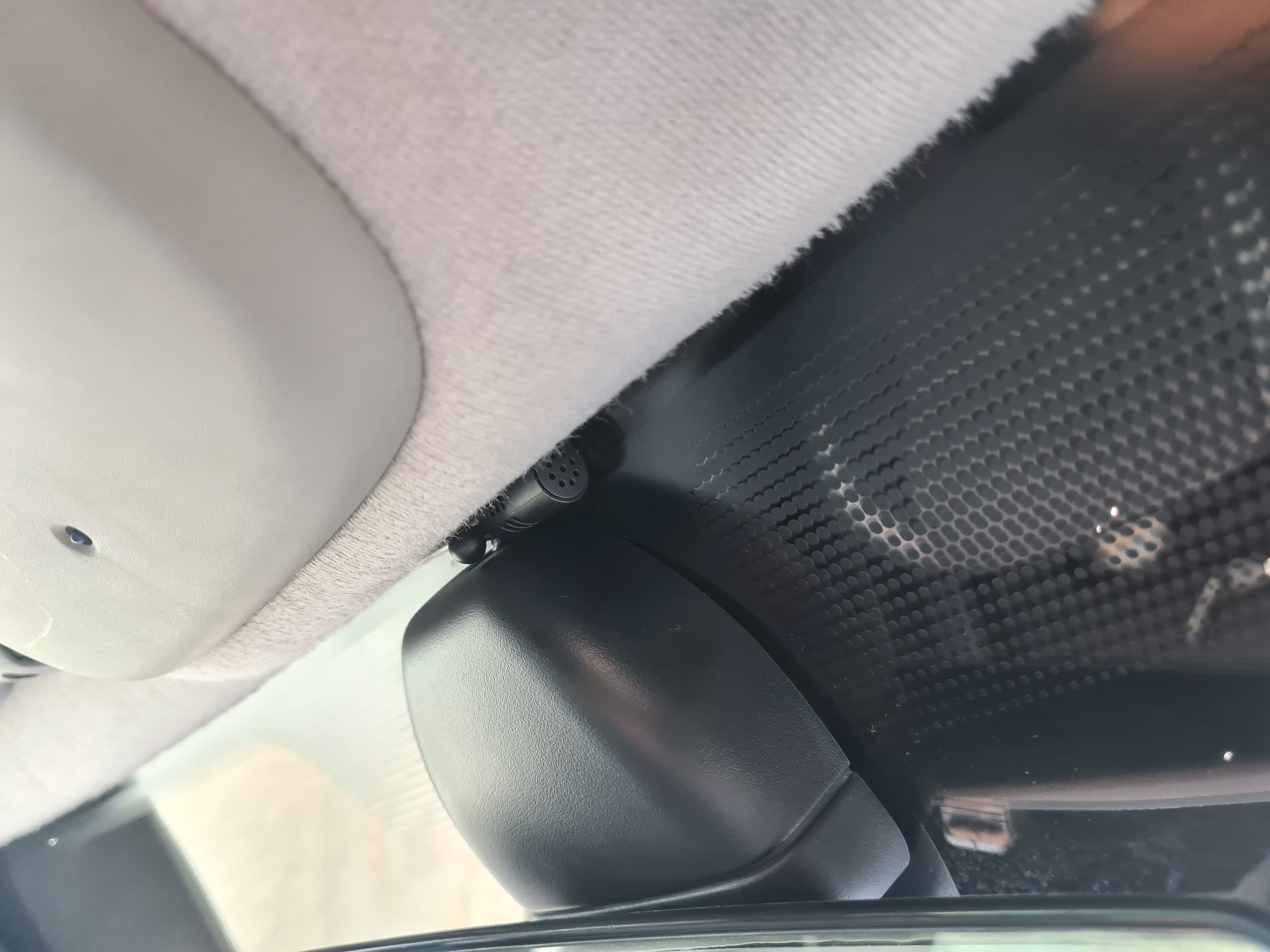

Next up, I bought a Denison Bluetooth kit for the RB. This plugs straight into the OE head unit and replaces the CD changer or the tune point that I had previously fitted. Being Bluetooth means I can stream Spotify over easy peasy and it comes with a mic, so I can make hands free calls also. I routed the box under the glove box, and routed the mic lead up the passenger A piller, across to the rear view mirror and sat the mic on the sensor cover.

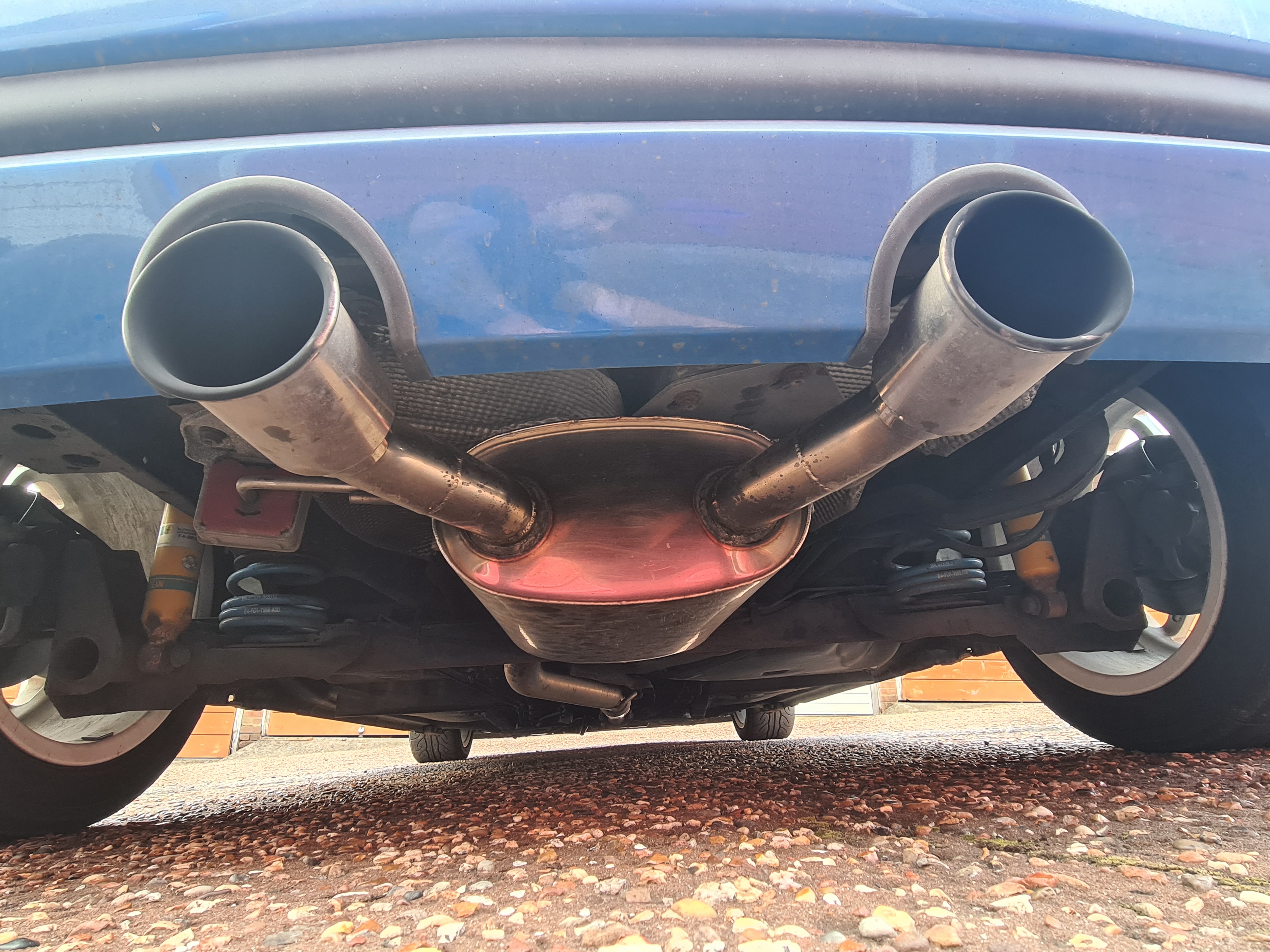

I've noticed my exhaust sounds a bit blowy, so I checked underneath and the welds have split on the sides of either tailpipe and also on one of the brackets. My plan was to get this welded up but I may look into a different system. I love the look of the tailpipes and like the sound, but hate seeing the rear centre back box. For now, I've done nothing and it's still cracked and I've carried on! 🤣

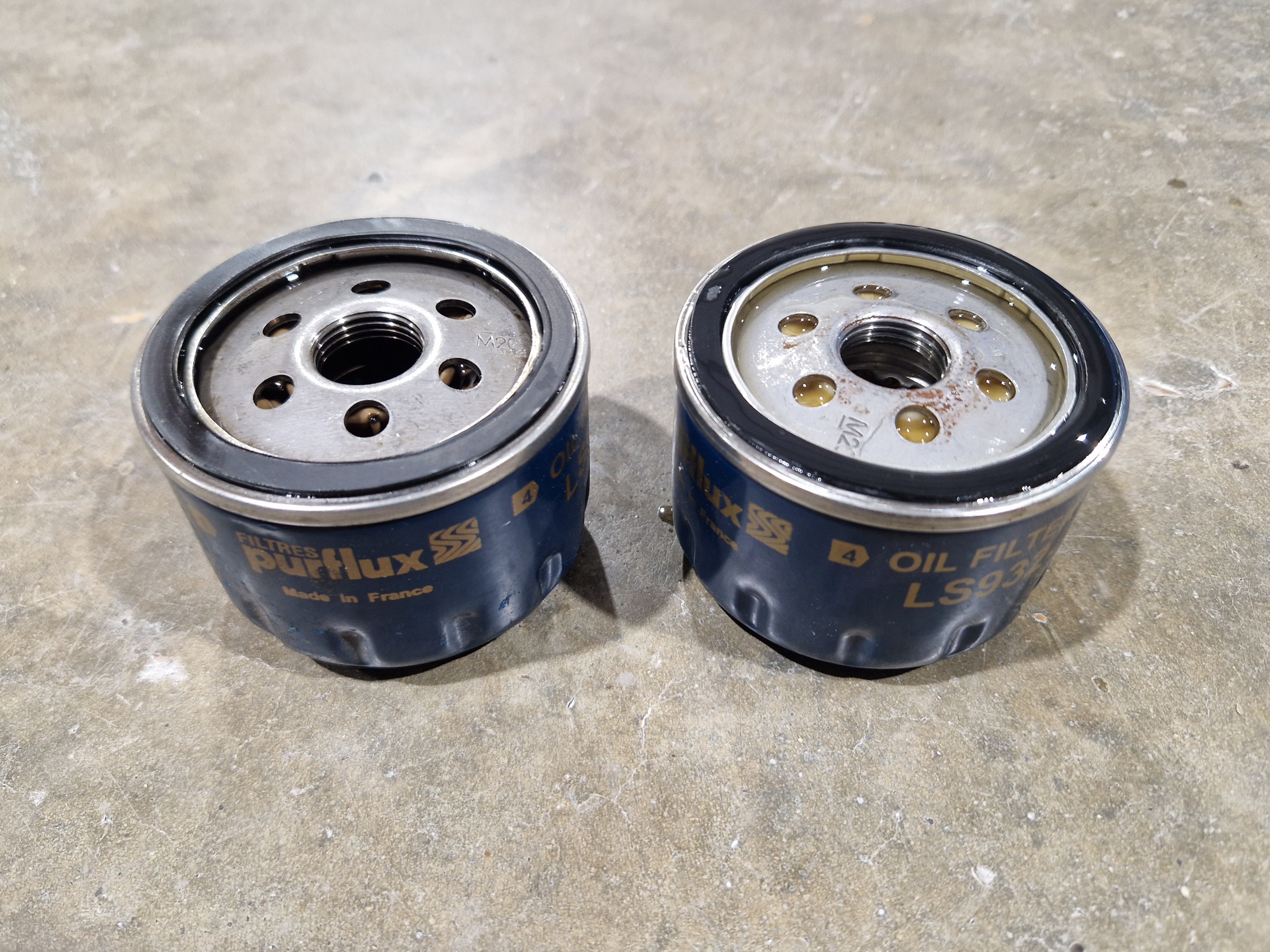

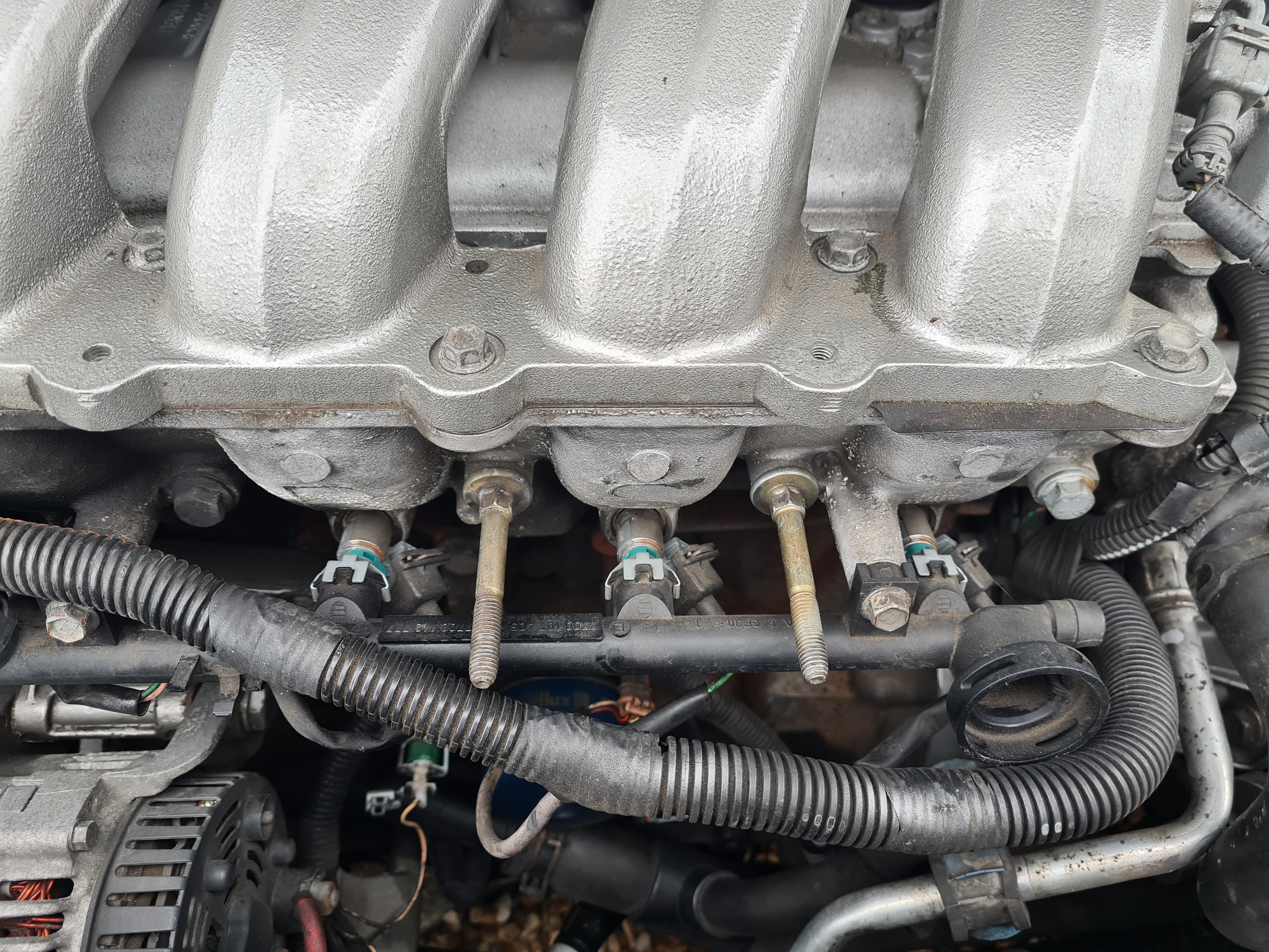

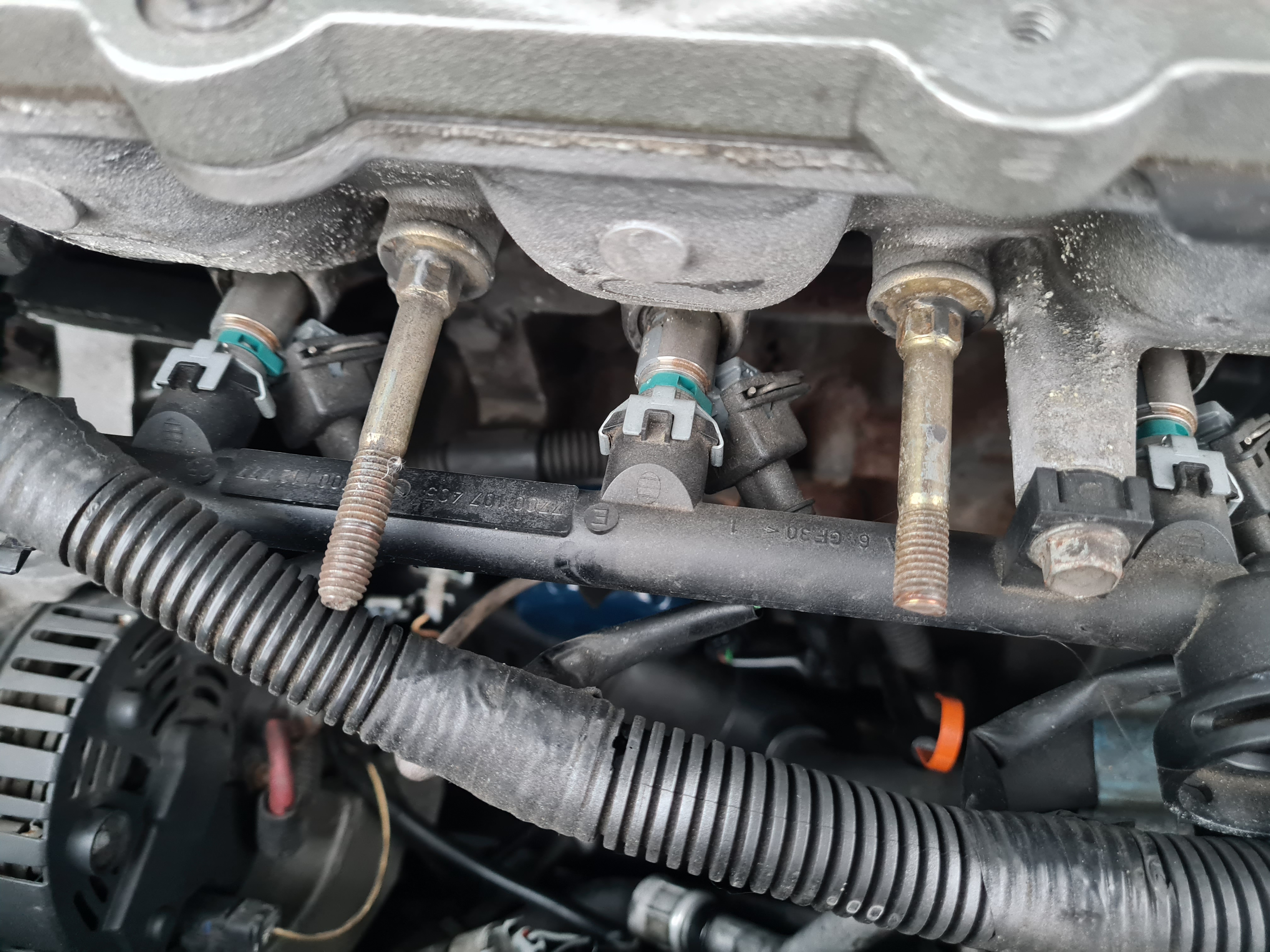

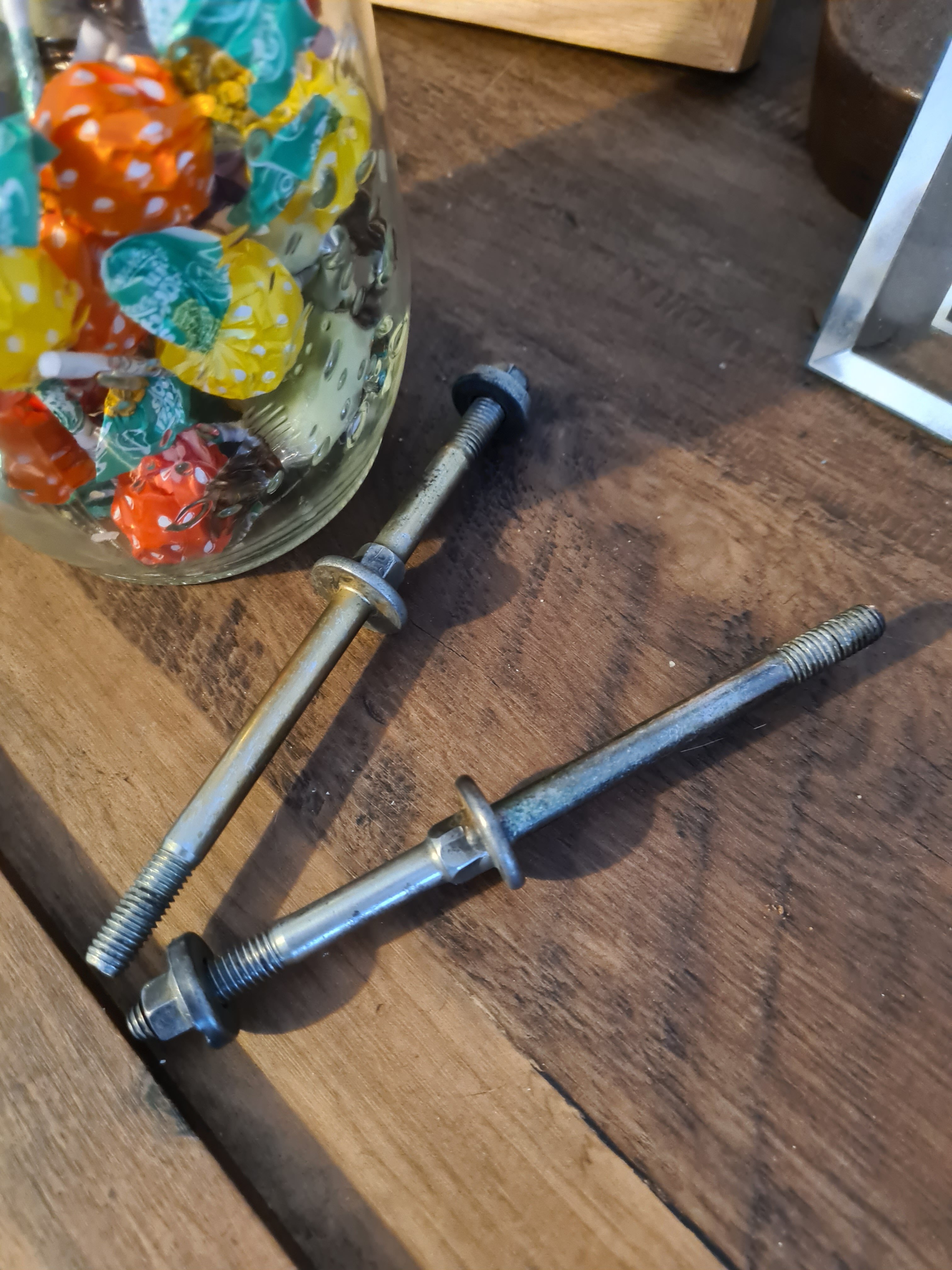

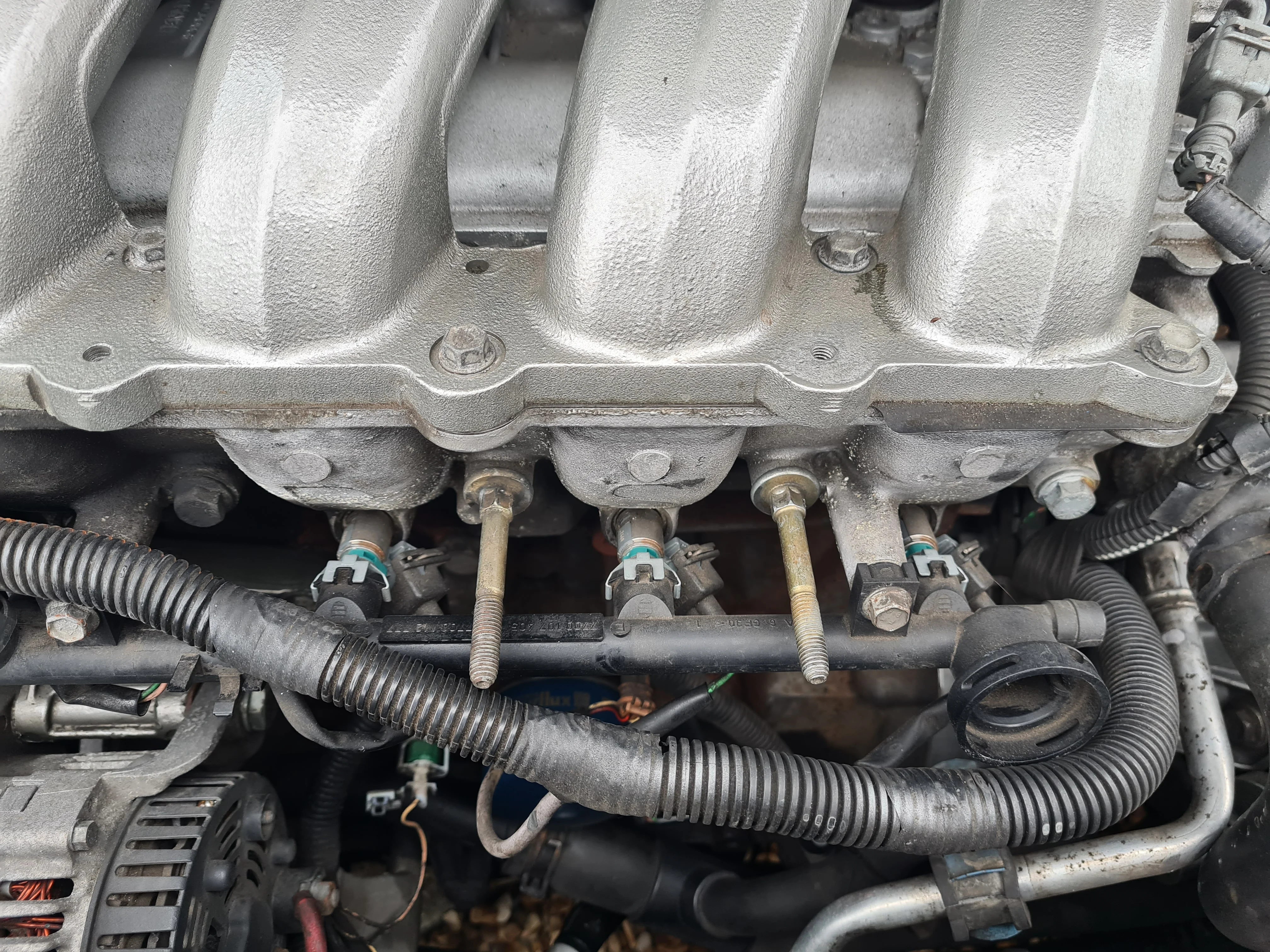

I've done a few oil changes also. Not sure how many but at least 3. When doing them one time, the studs that hold the fuel rail cover snapped. A quick stop at AW Motorworks (well for my wife as she was local and collected them) had me sorted again as he had a few spare.

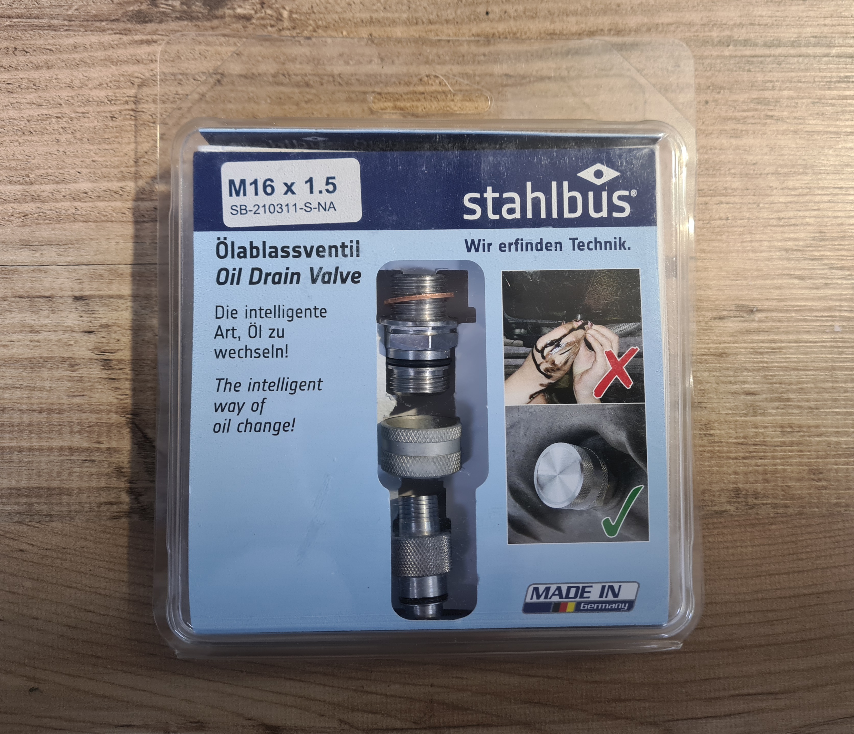

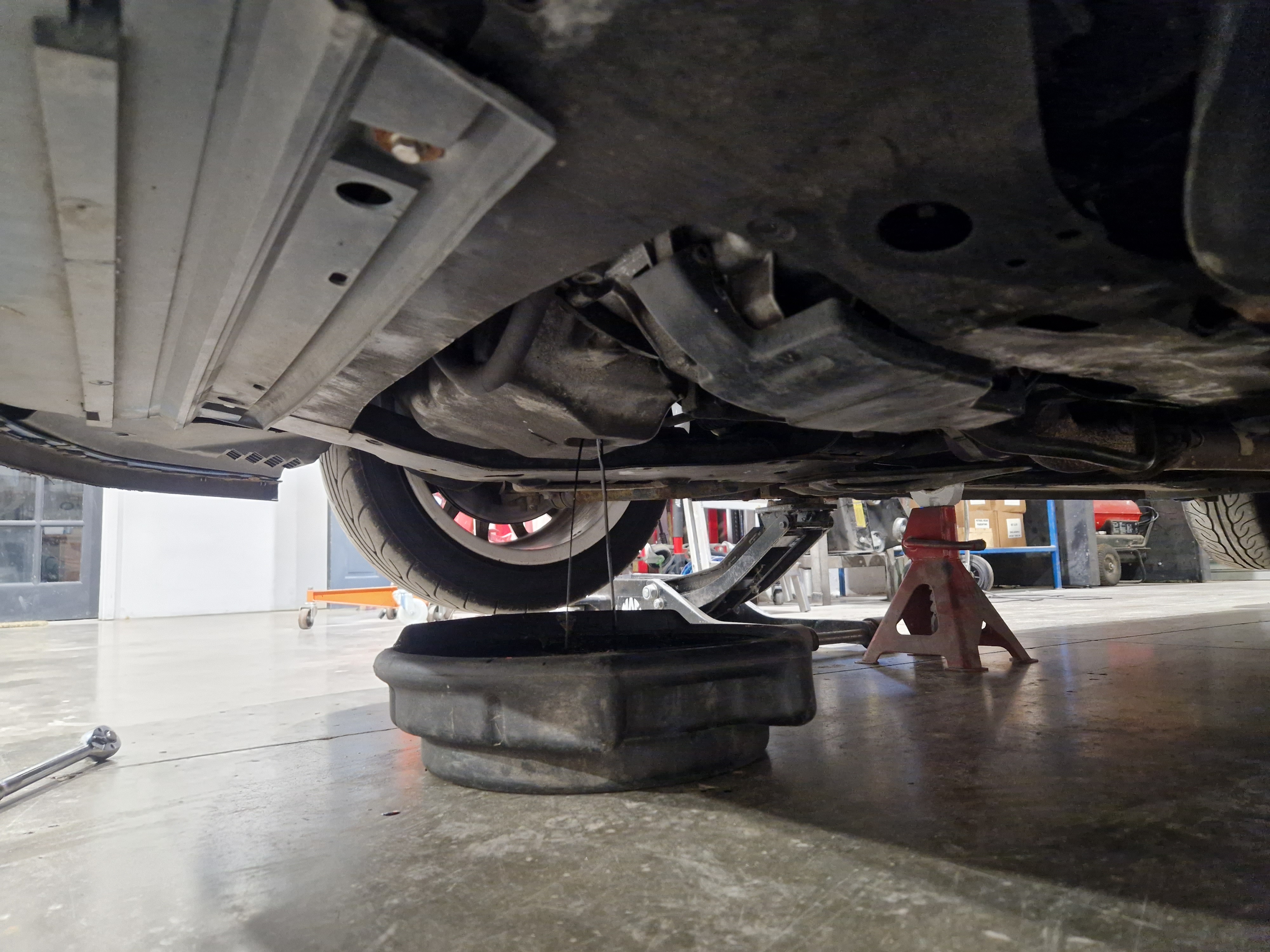

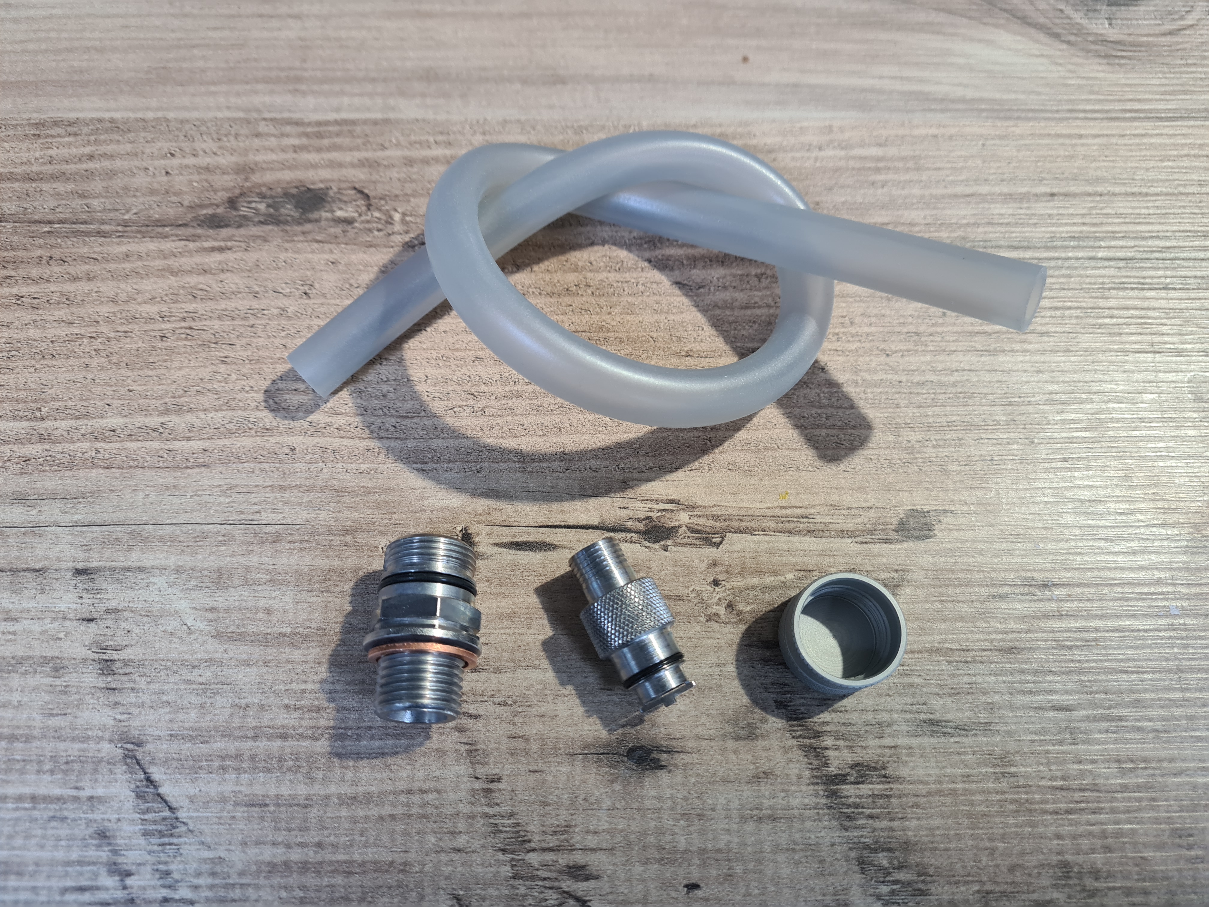

I seem to have lost a few pics of stuff I've done. I bought a stahlbus easy oil drainer and fitted that. It does make driving a little more simple/less messy but because of the height I'm currently on, I didn't really like how low it sat. As I have no protection like a sump guard, I was worried the valve may catch or even pull out when driving, so I've gone back to standard for now. I've kept it for a later date though as its a good design, well made kit and I think the stock on this size seems rarer, so I'd regret selling it I think.

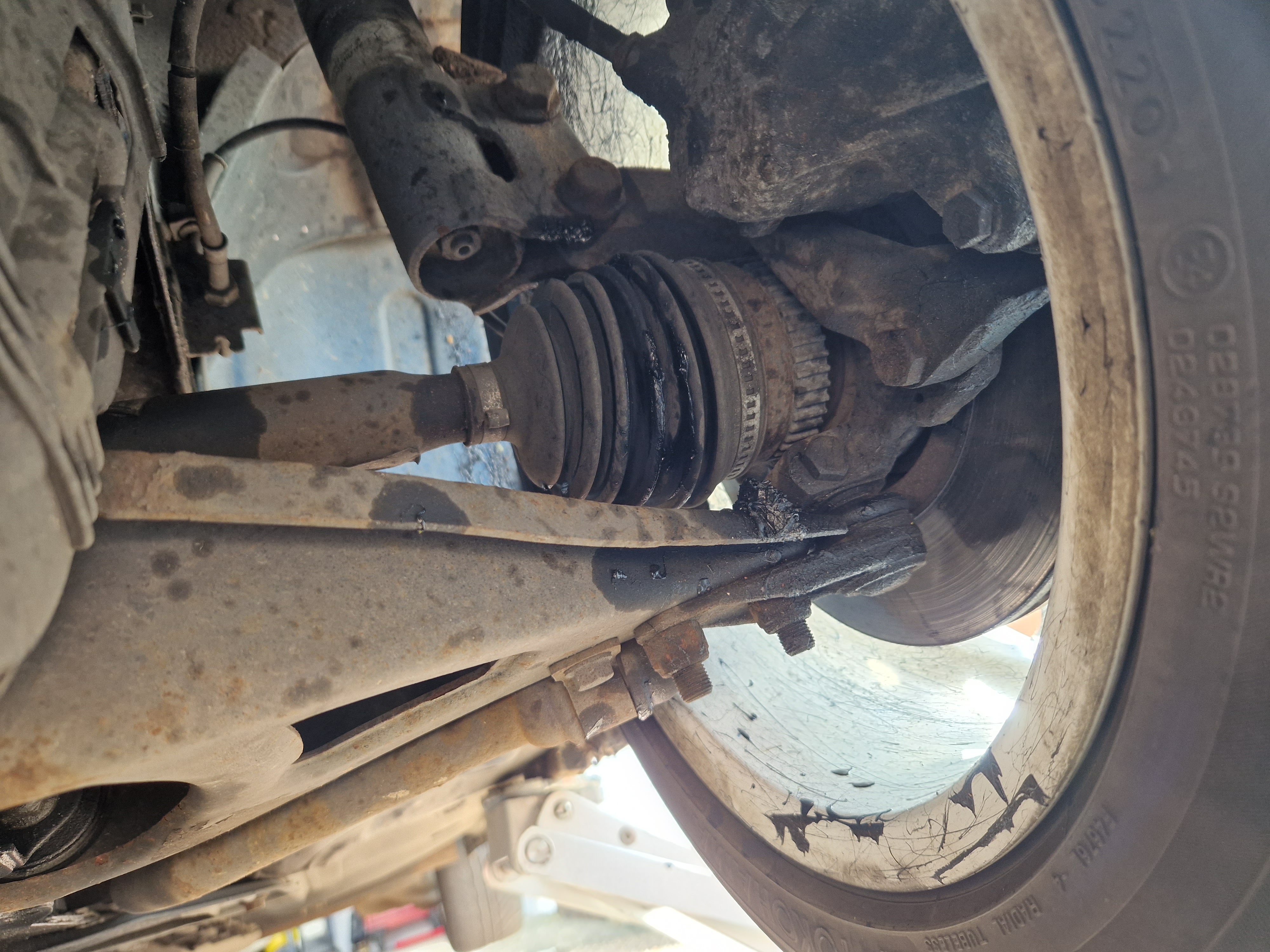

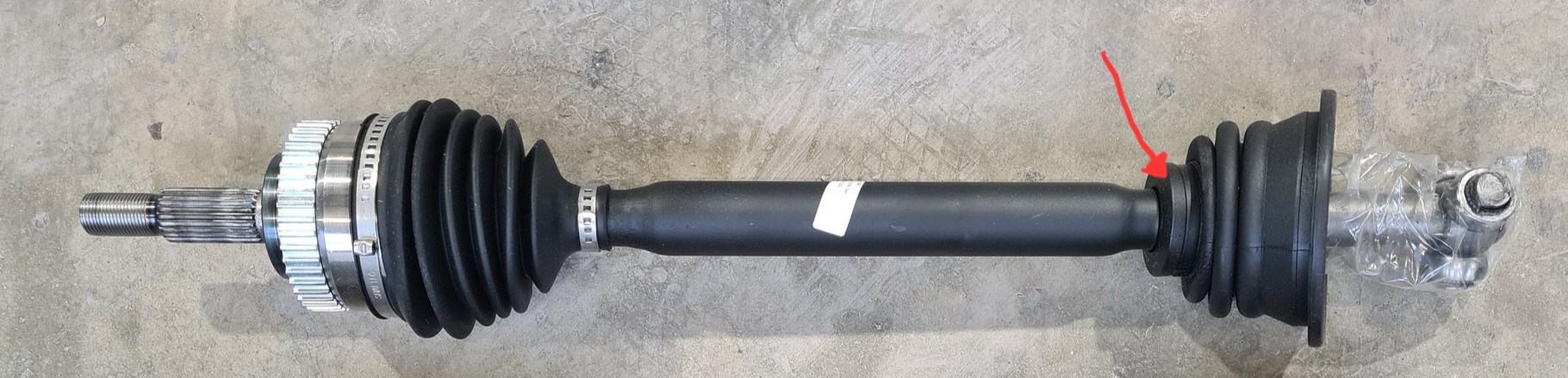

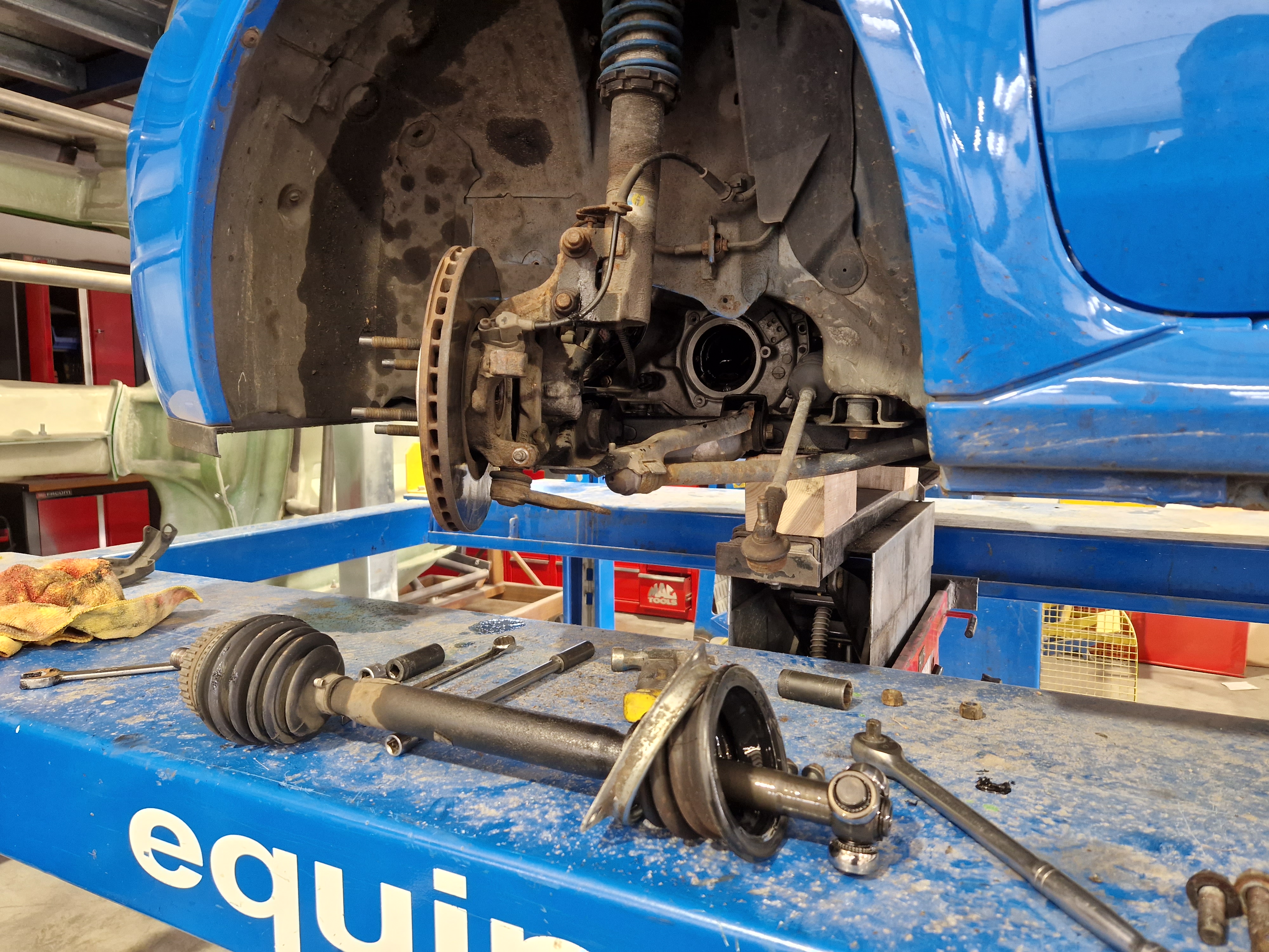

Driving to work and I noticed this when I pulled up.
Yep, CV gaiter split. Ordered a new one from my local motor factor's who supplied my driveshaft and got that fitted. Being that the gearbox oil was fairly new, I kept it and reused it.

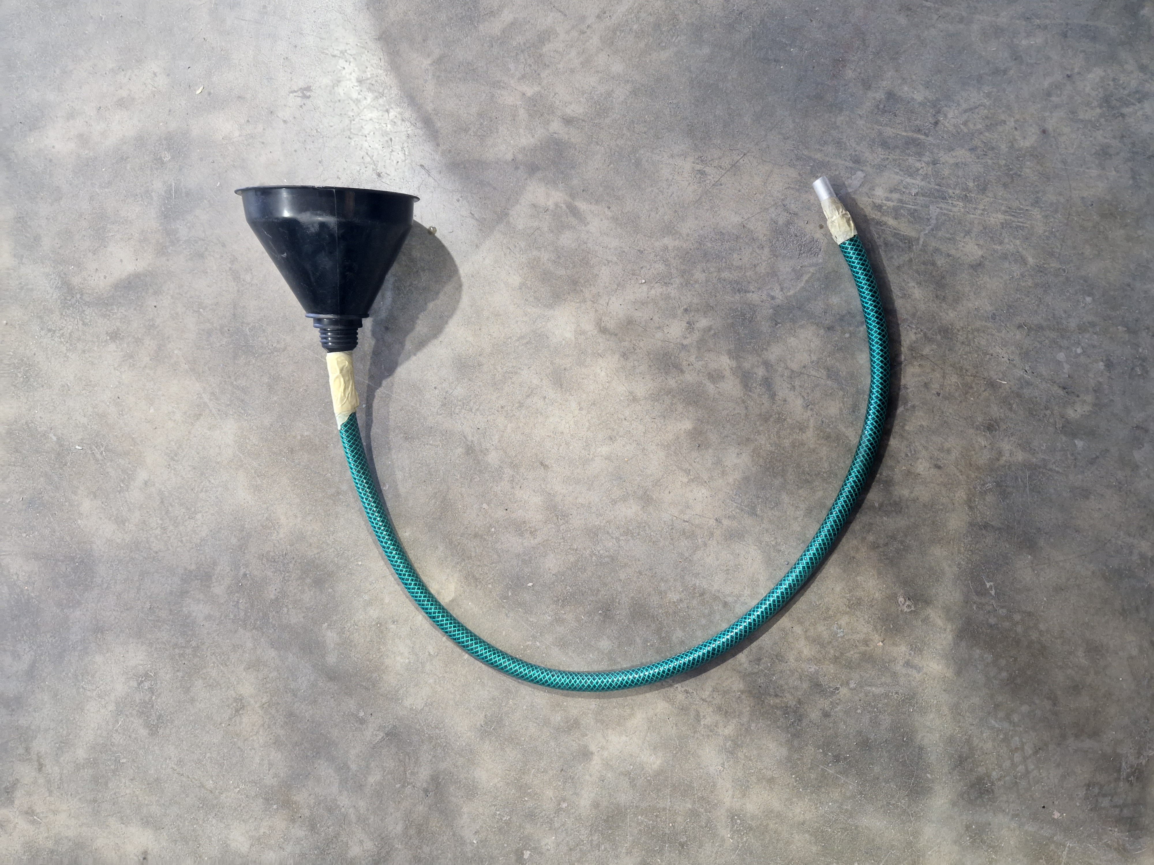

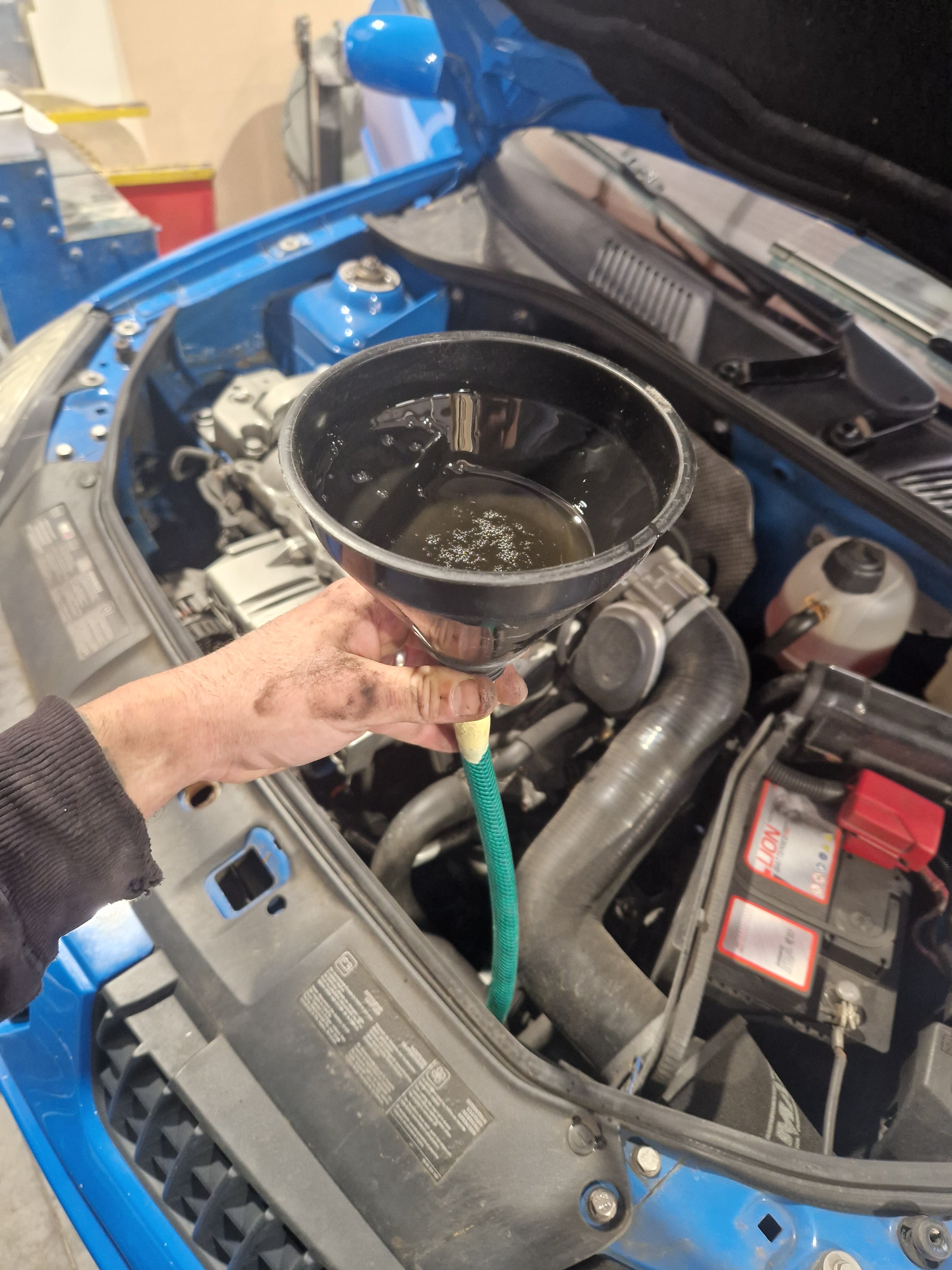

Had to make a DIY gearbox oil filler out of some old garden hose, a old funnel and some ally tube, but it worked a treat!
When I fitted the new outer gaiter, I had to remove the inner gaiter. Unfortunately, behind the rubber is a bearing that I had to knock down. Unfortunately I ruined the cage doing so, so I had to order a new inner gaiter. Once again, a call to my local factor's got me a new one. Turns out there's 4 bearing sizes, but this one was 28mm for anyone that runs a shaftec shaft.
View attachment 1602586View attachment 1602587
View attachment 1602588View attachment 1602589
View attachment 1602590View attachment 1602591
I tried to put the gearbox gaiter bracket over inner boot (opposite ABS ring) and warped it. Got a leak. Luckily I winged it and Shaftec replaced F.O.C.
Second time around I just removed the outer boot clip and it slid over, then replaced with a new clip. Annoying that these shafts don’t come with the gearbox bracket pre-installed.

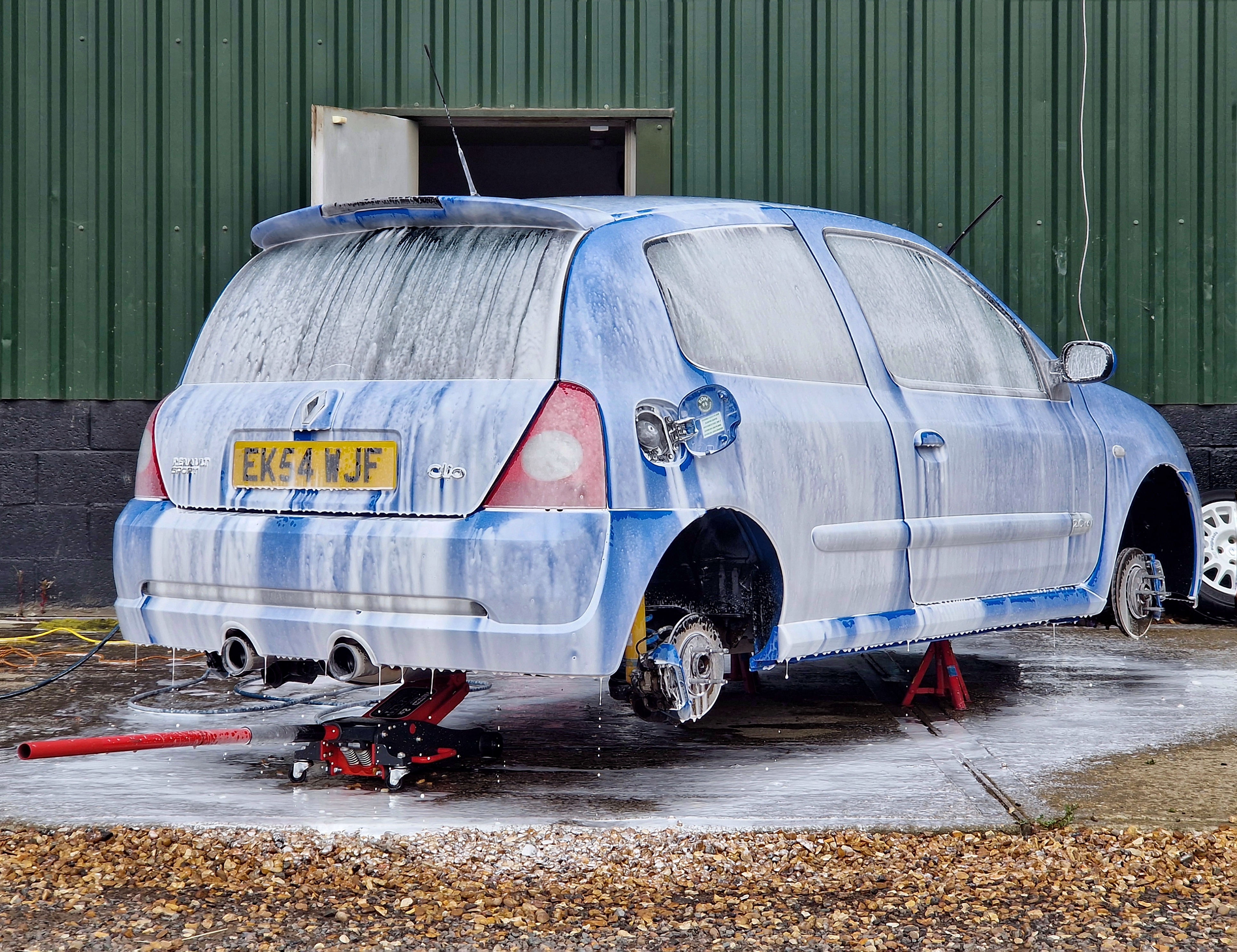

Fast forward to the weekend just gone and the clio git it's 3rd wash of the year! Spare time isn't as free as it was, pre kid so that explains that. Plus I've kind of fell out of love with it a tad as its used as a A to B car and I have to pick up my son 4 days a week so it feels a bit less special.
There's rust on both rear arches now, which is really annoying as I thought I ground it all out years ago. The rear tailgate has some big chip on it, which I don't even know what that came from ive done a temp cover up and from a distance, looks OK. The front bumper is super pebble dashed as is the bonnet with a few rust spots. There's probably a bit more. I think I'm probably being too fussy but it's hard to keep a car clean and perfect, being used daily, 200ish miles a week, through all seasons. But to be fair, it's done 40k since it was painted, so I shouldn't be too cut up.

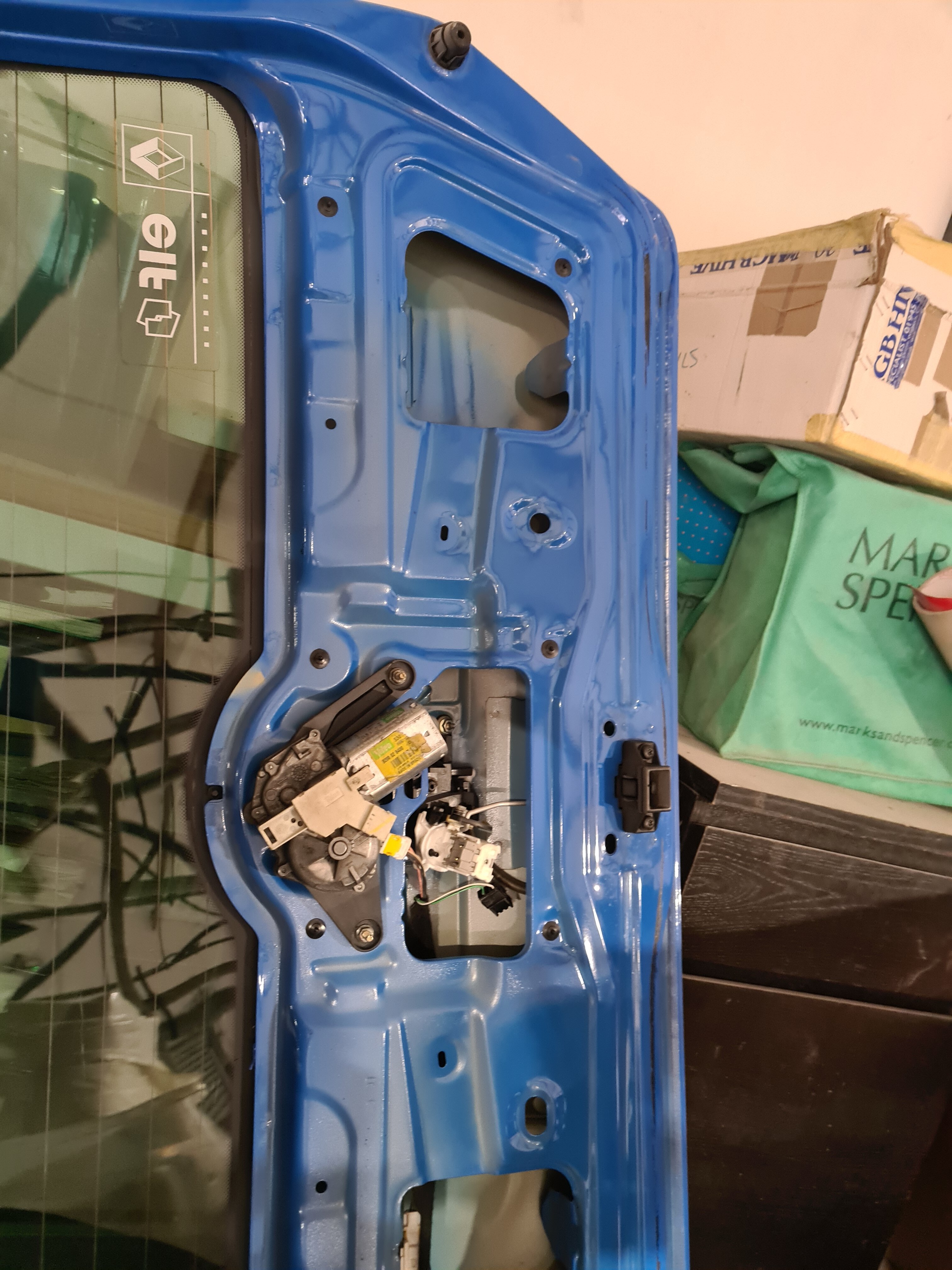

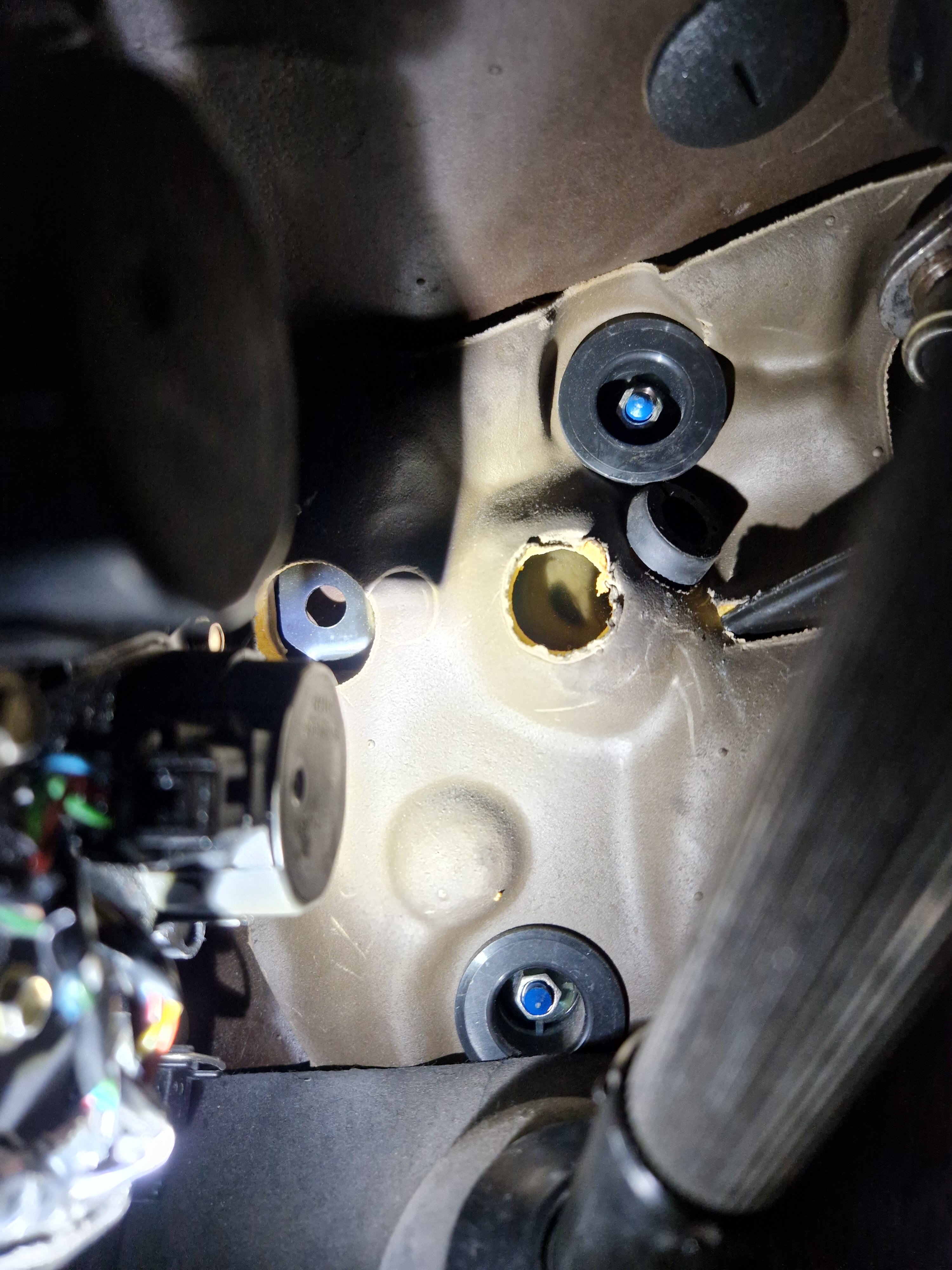

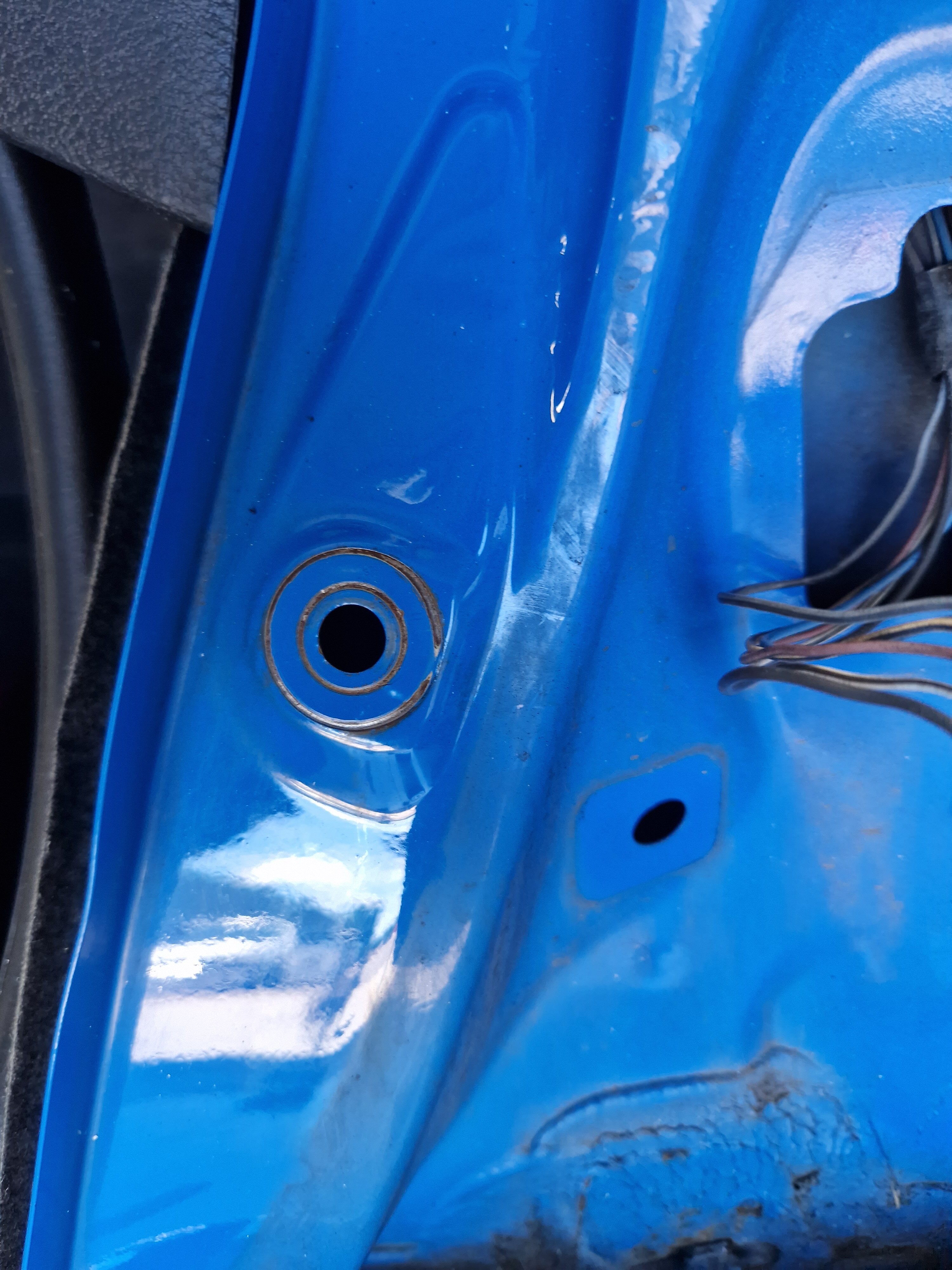

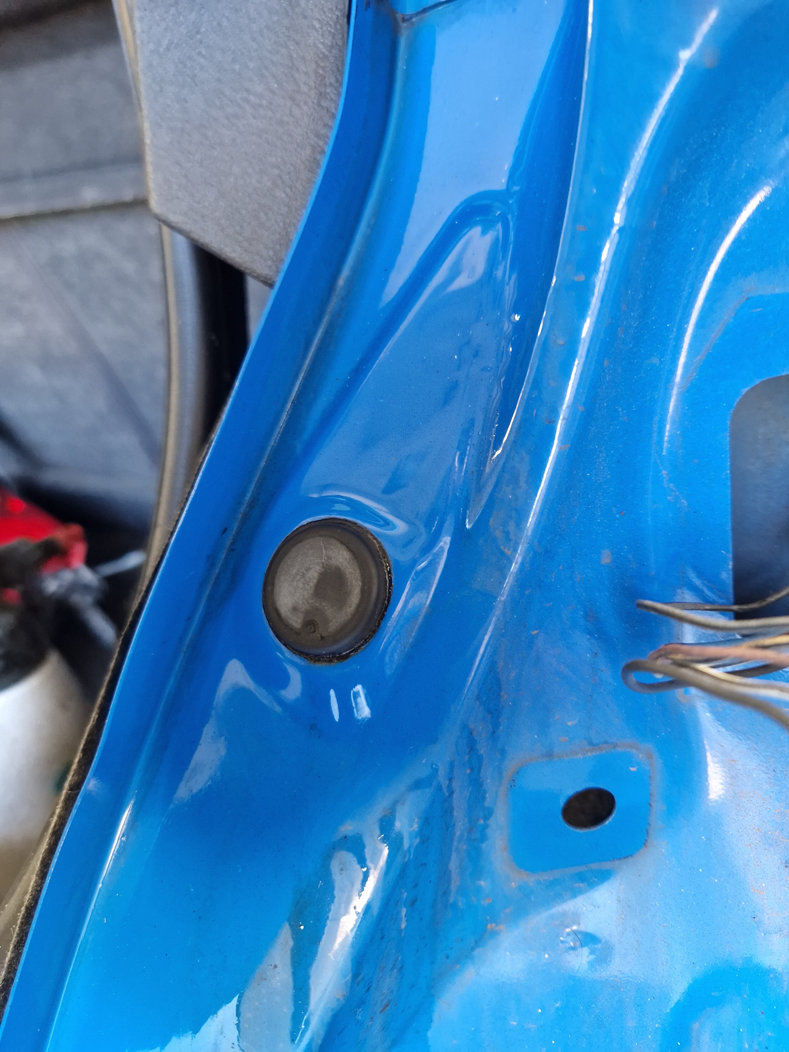

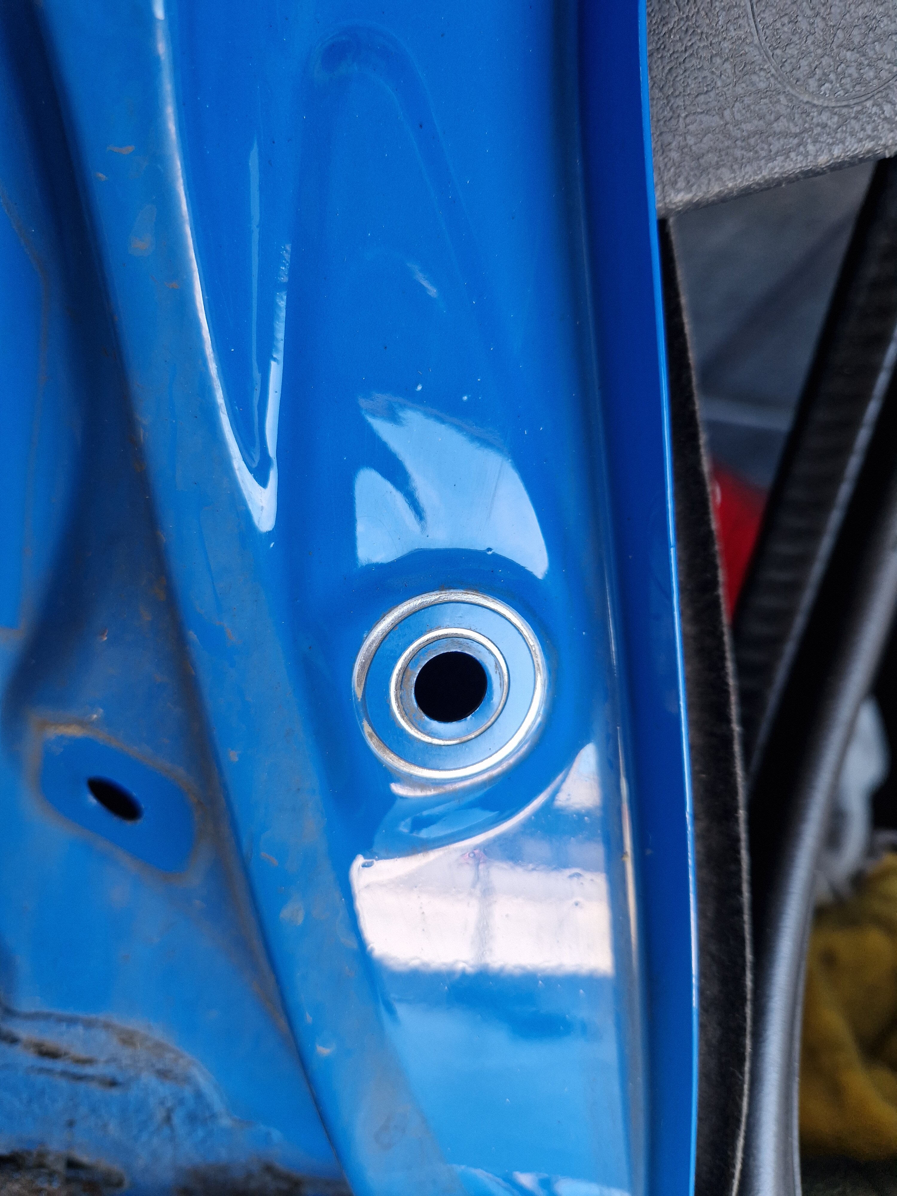

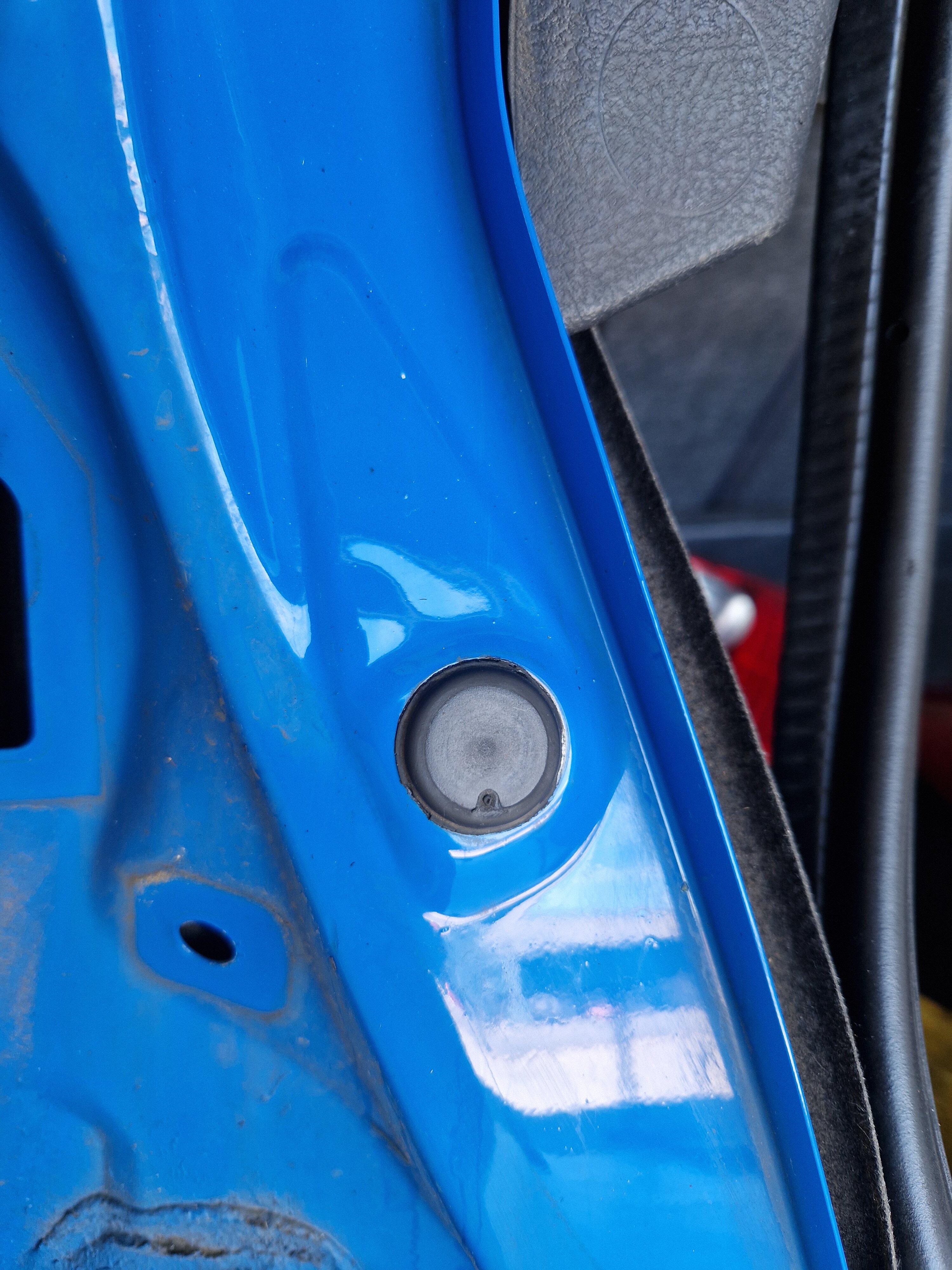

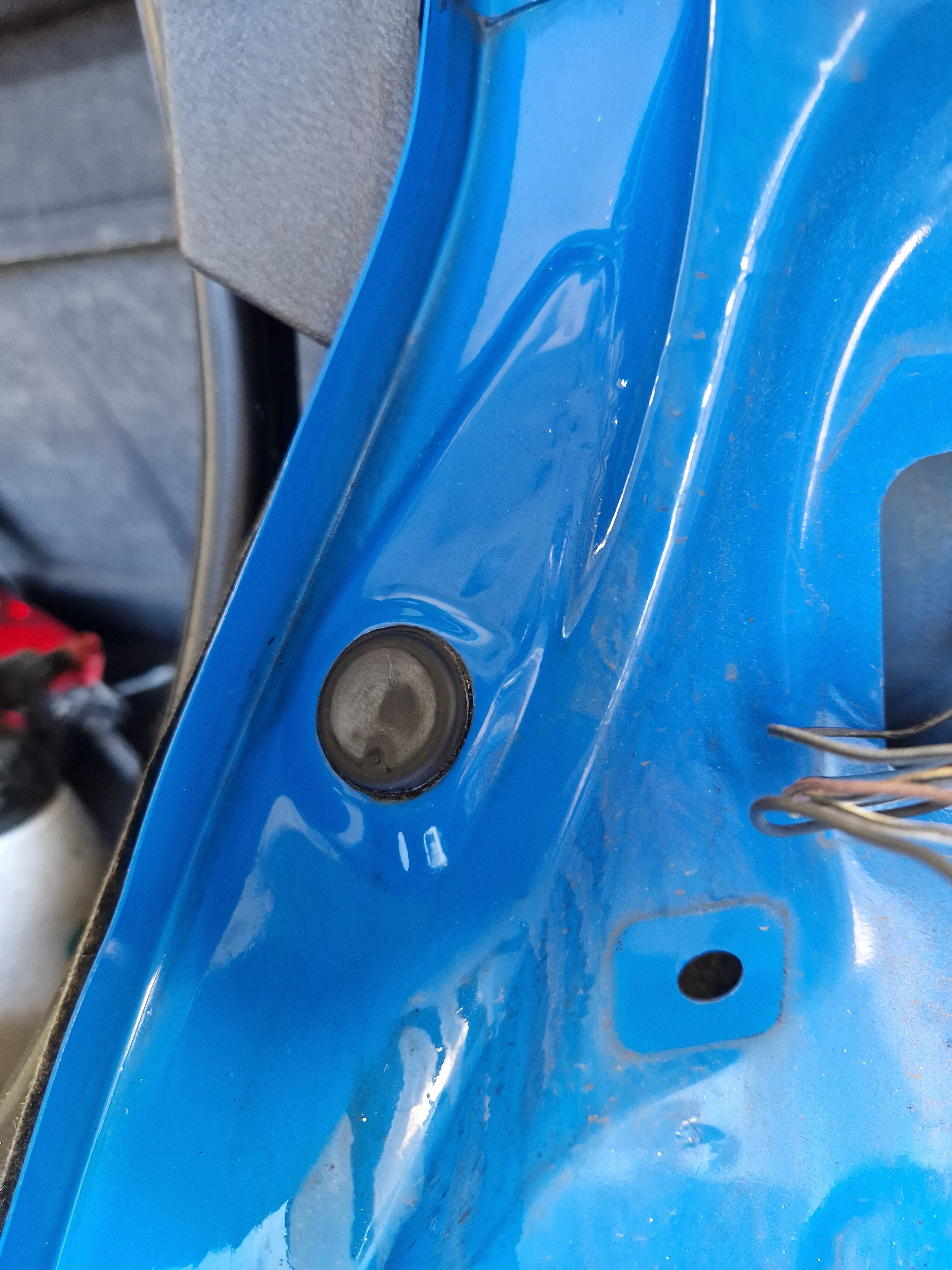

I also sealed in the rubber bungs on the tailgate, as I was getting a little damp in the boot and I think it's a common fault for it to be this.

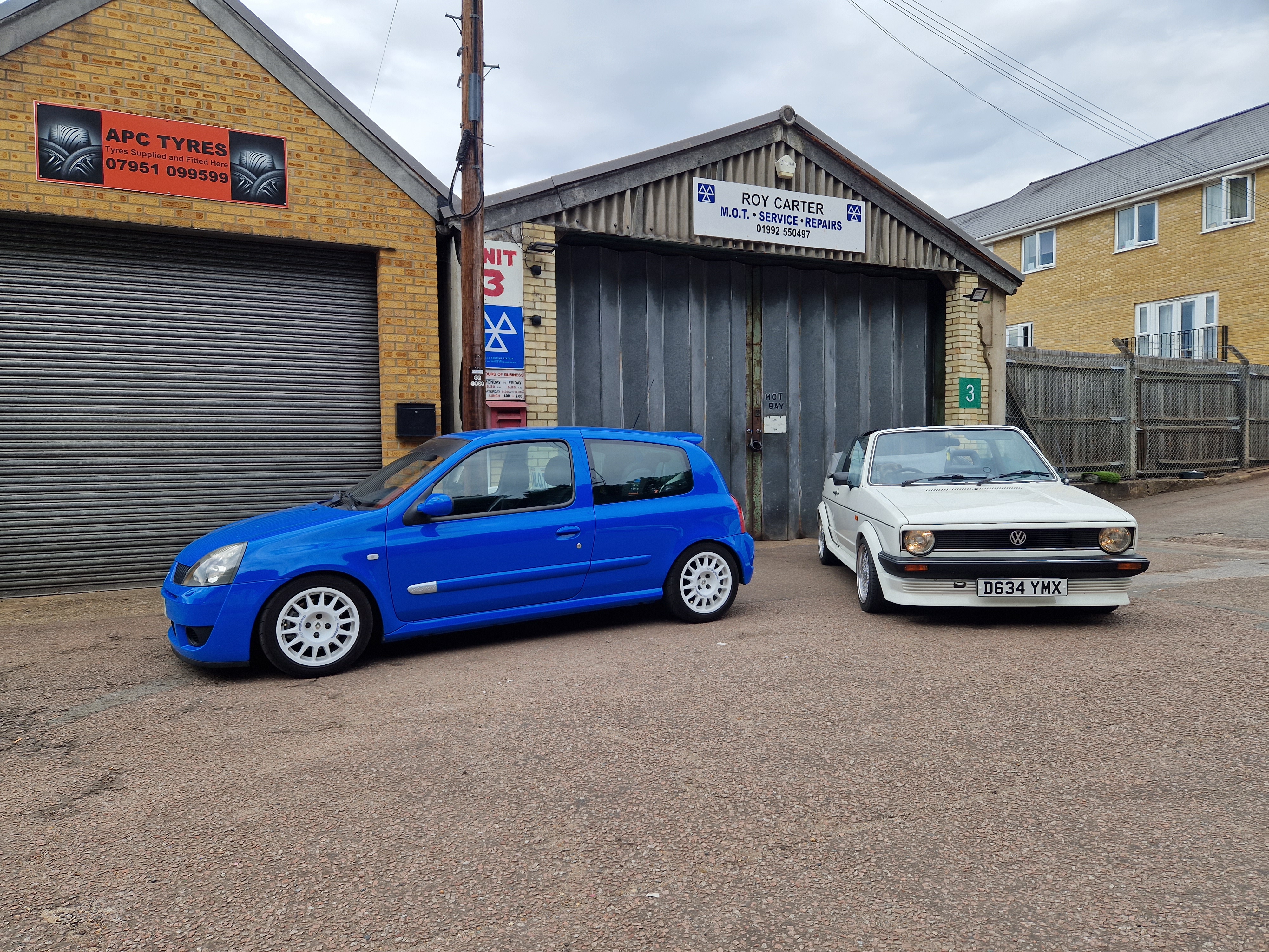

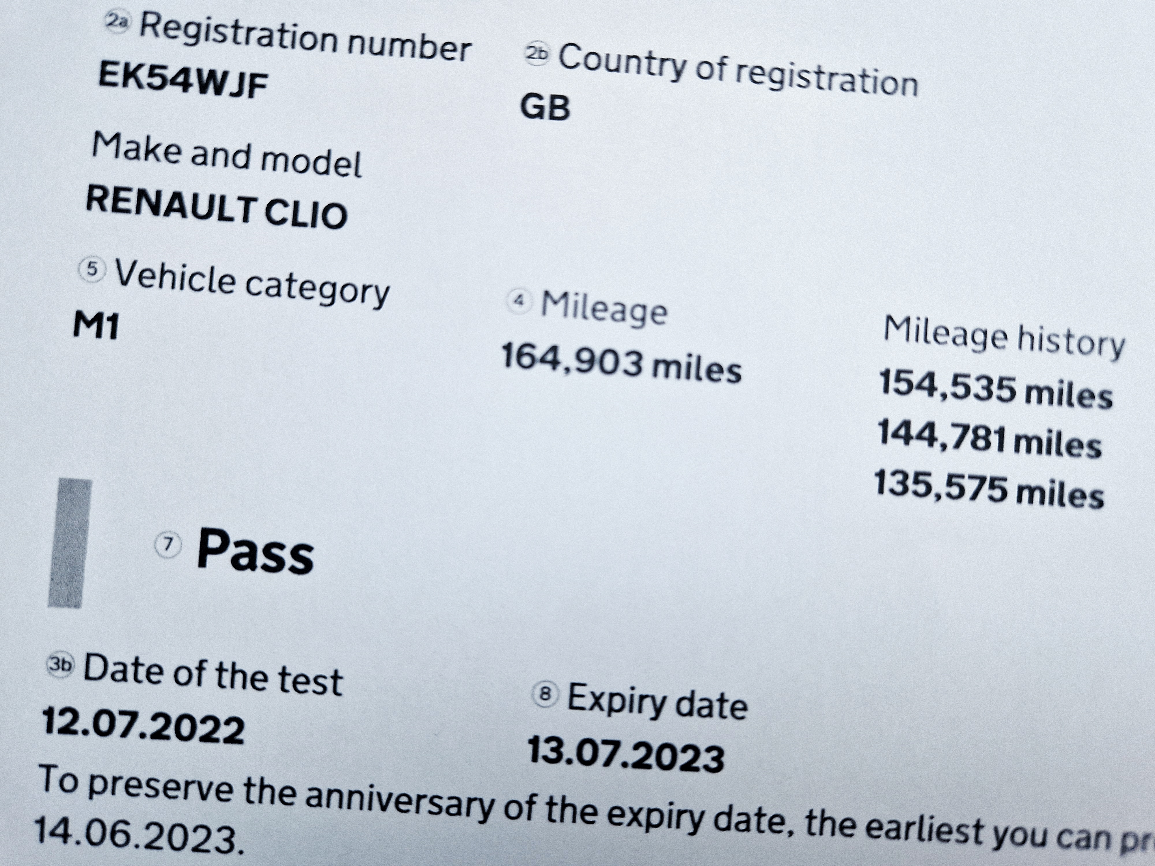

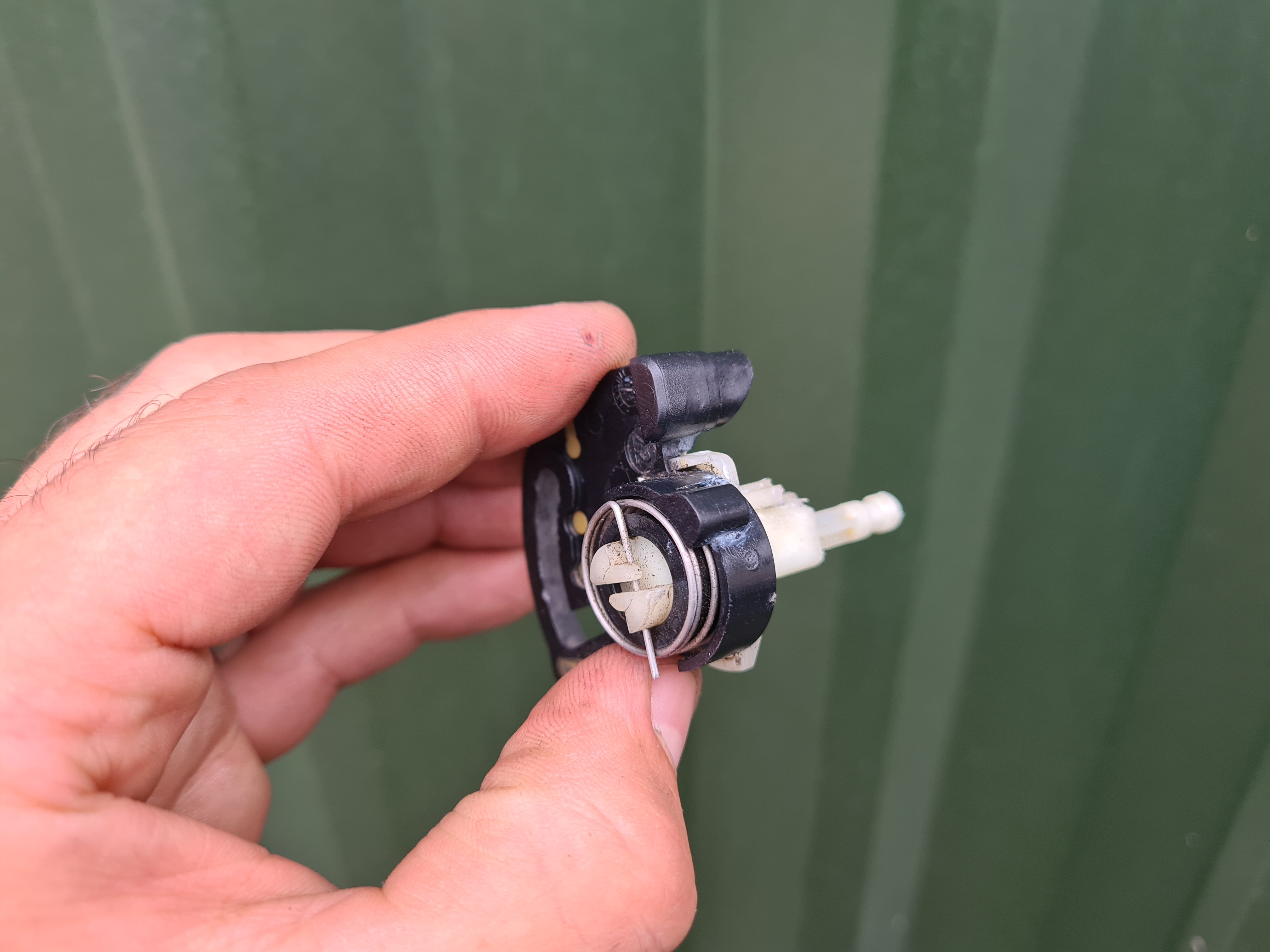

This week had the clios MOT. He passed it but the advisories was headlight being a bit high on the passenger side and the drivers rear caliper being not that great. My guess is a sticky slider? Either way, it passed for another year, but I'll rectify these issues ASAP. The car will tick over 165k by the end of the week.

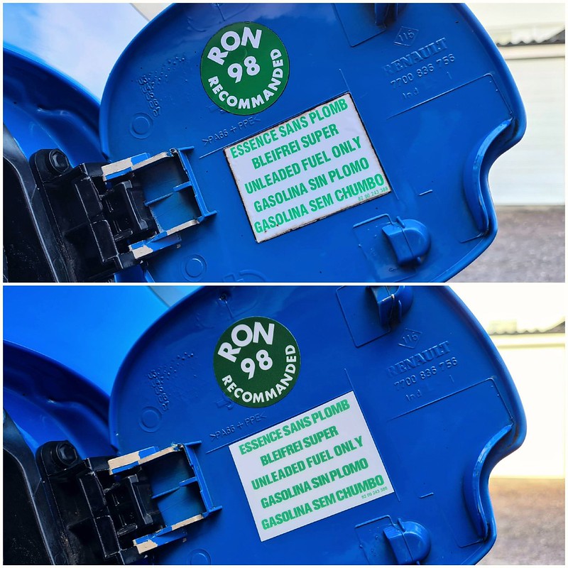

Treated the RB to some new clean plates too as the front was too yellow for my liking. Ordered off Proplates and arrives after 2 days.

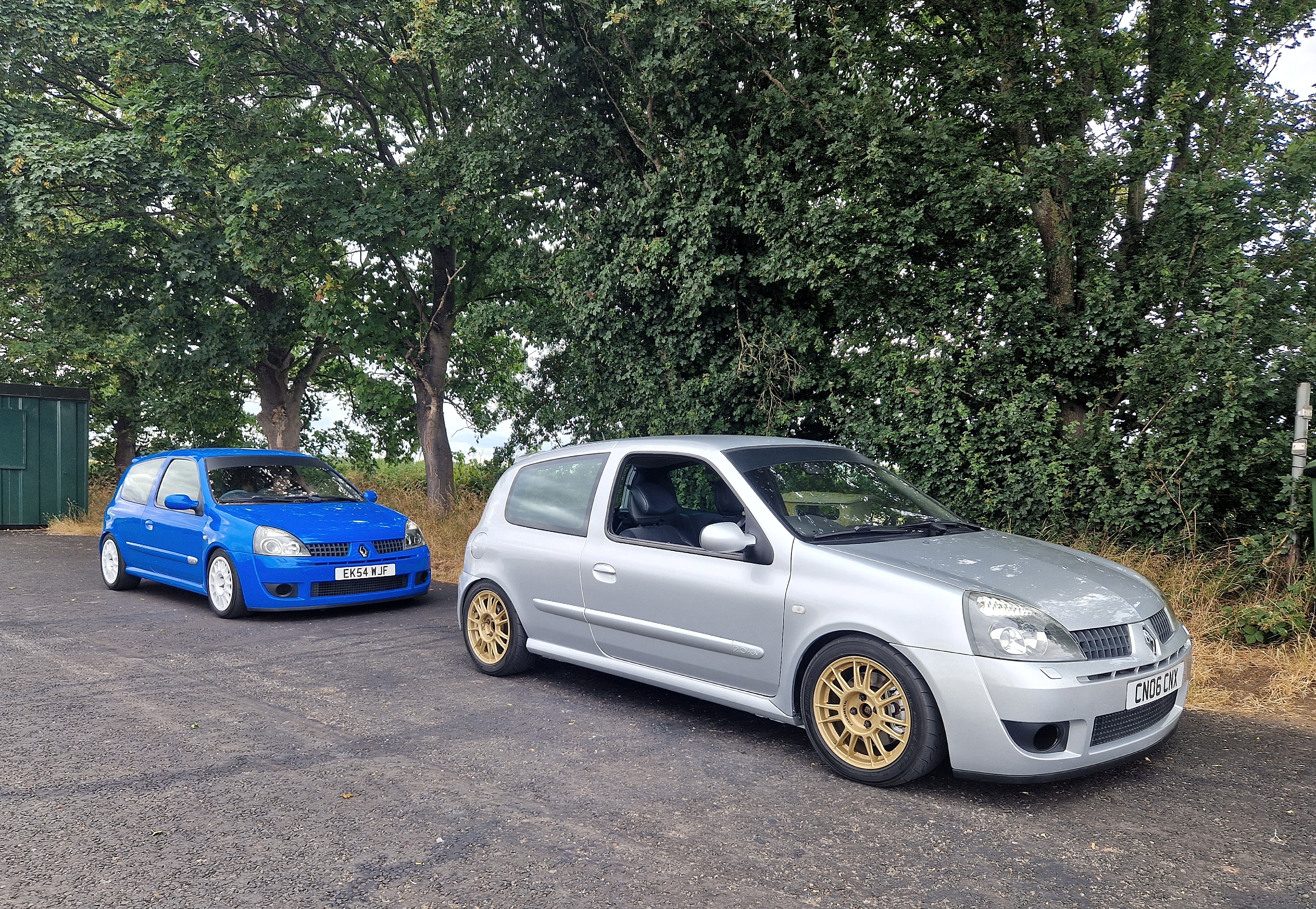

Nice to see my 2nd favourite Clio passing it’s MOT and still going strong after 160k and getting some TLC. [emoji122]

It's still looking great Mark 👍. Still seems like it was resprayed recently, not long enough to do 40k since! It's impossible to keep a car mint using it daily but give it a few fun runs out and the love will come back.
P. S. I'm looking forward to catching up with you and Emily and meeting the new boss.

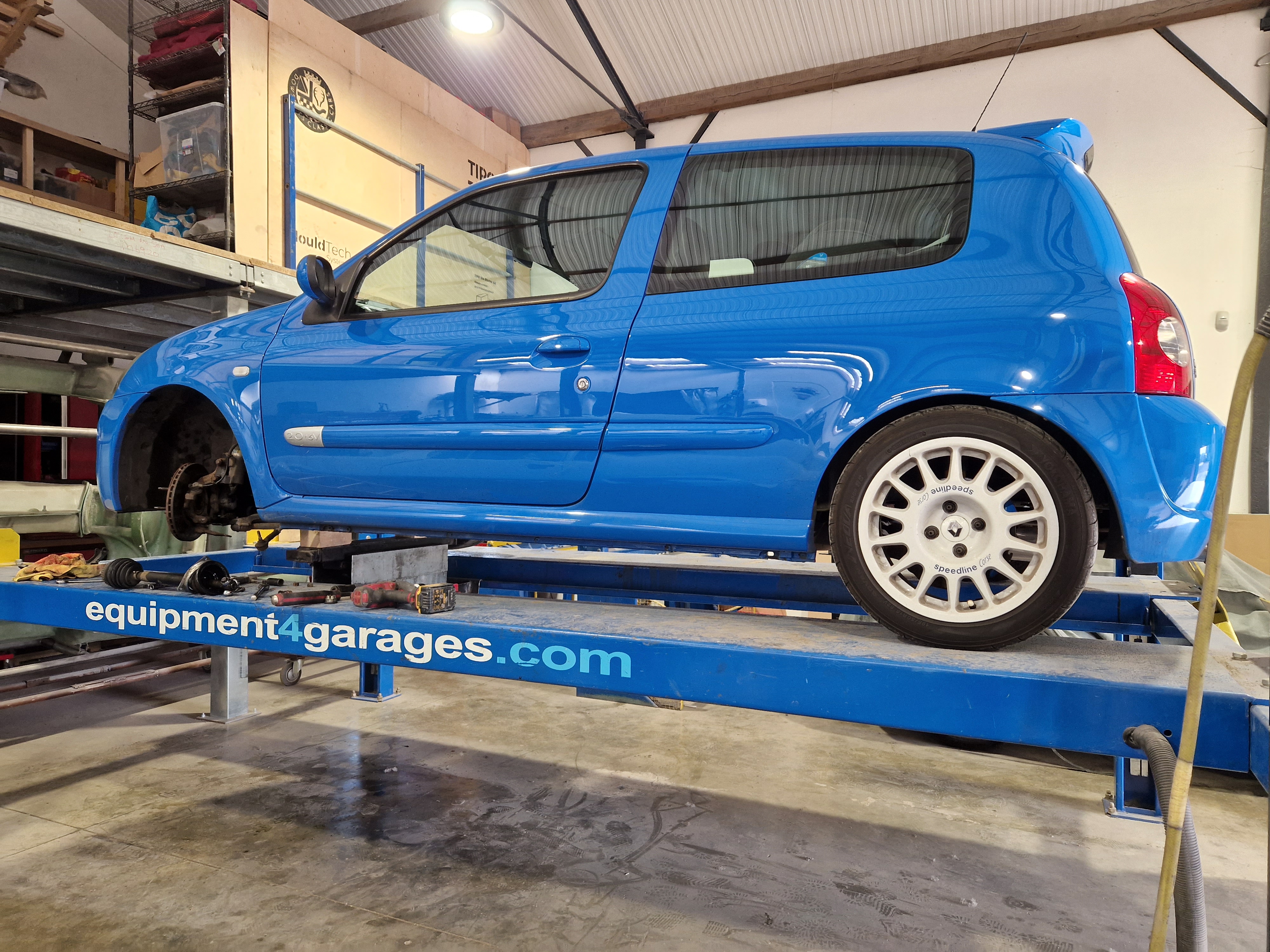

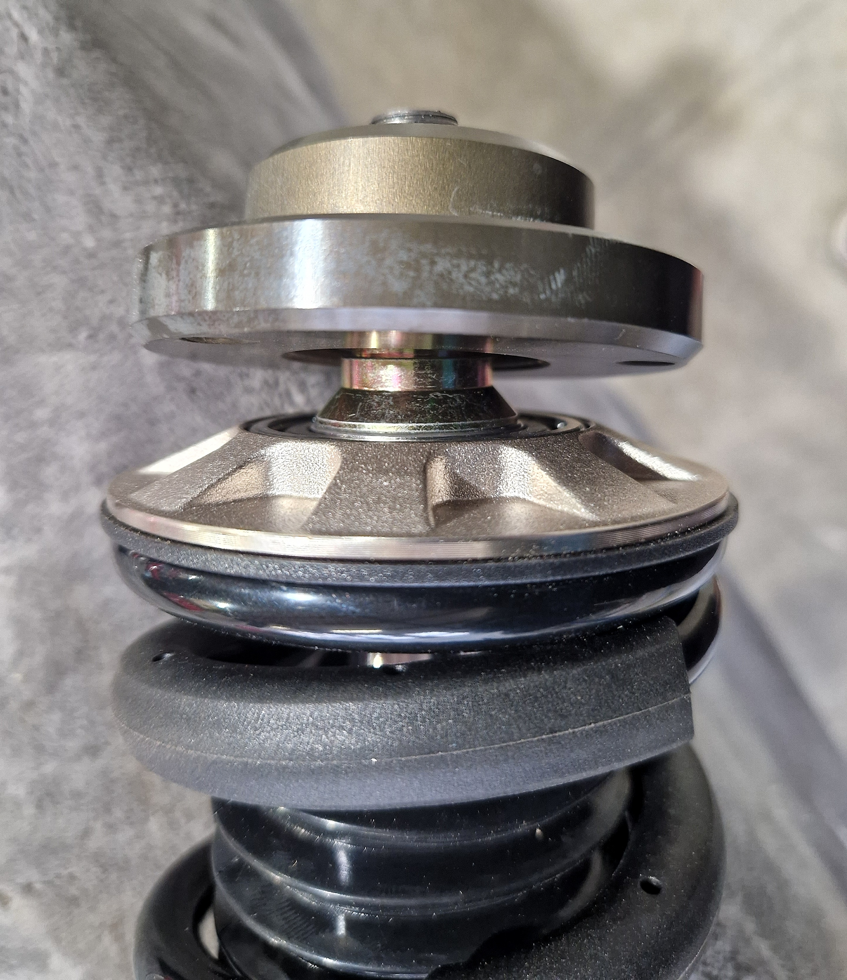

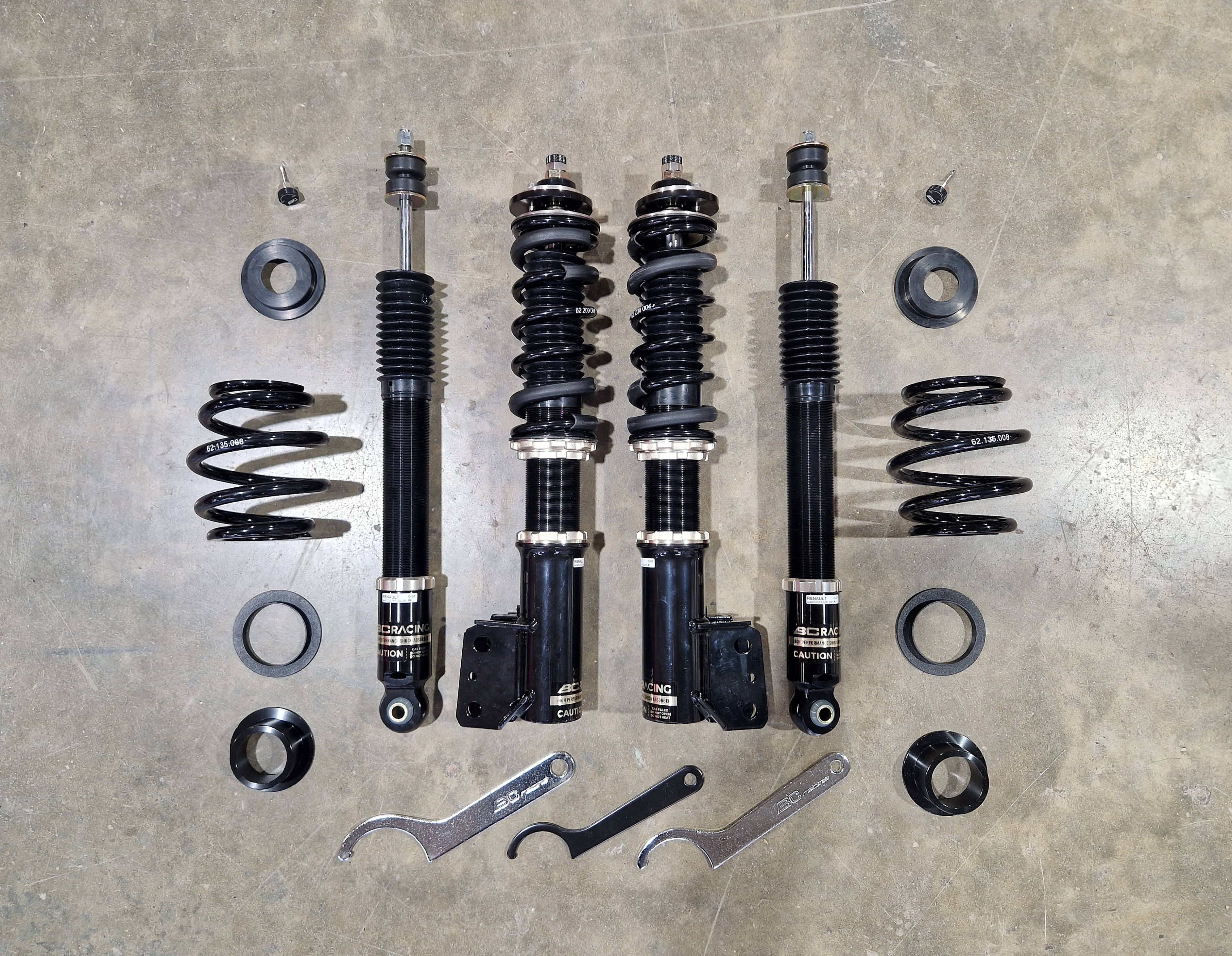

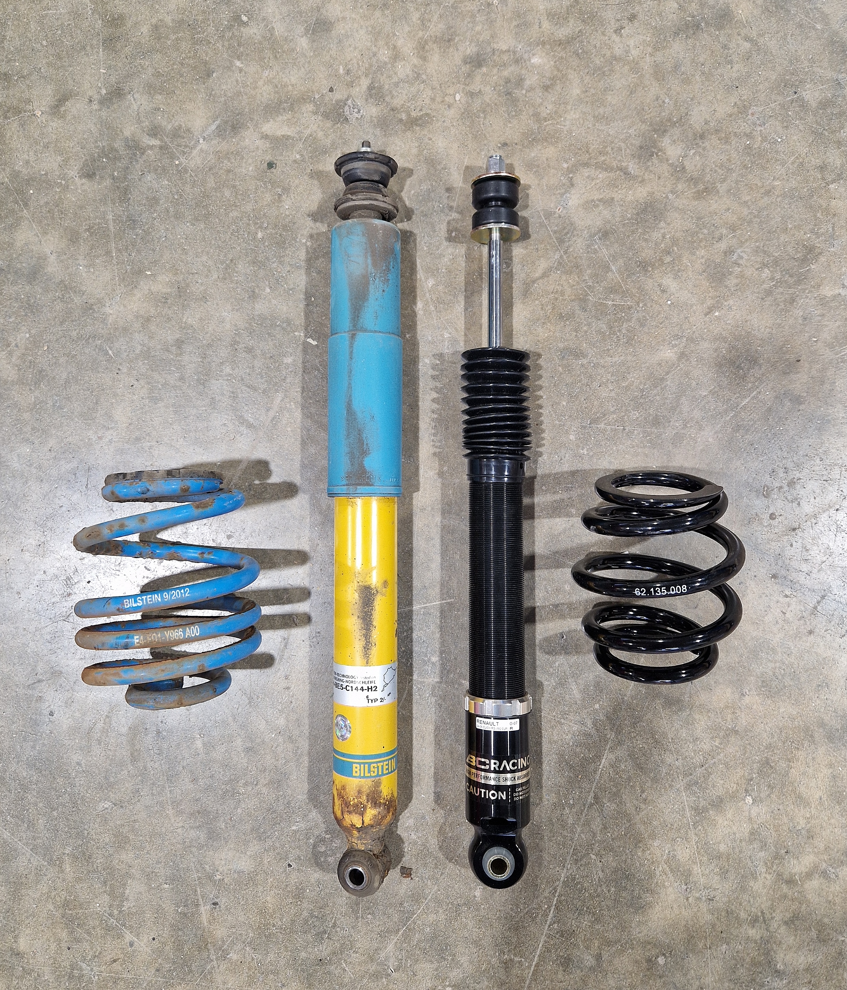

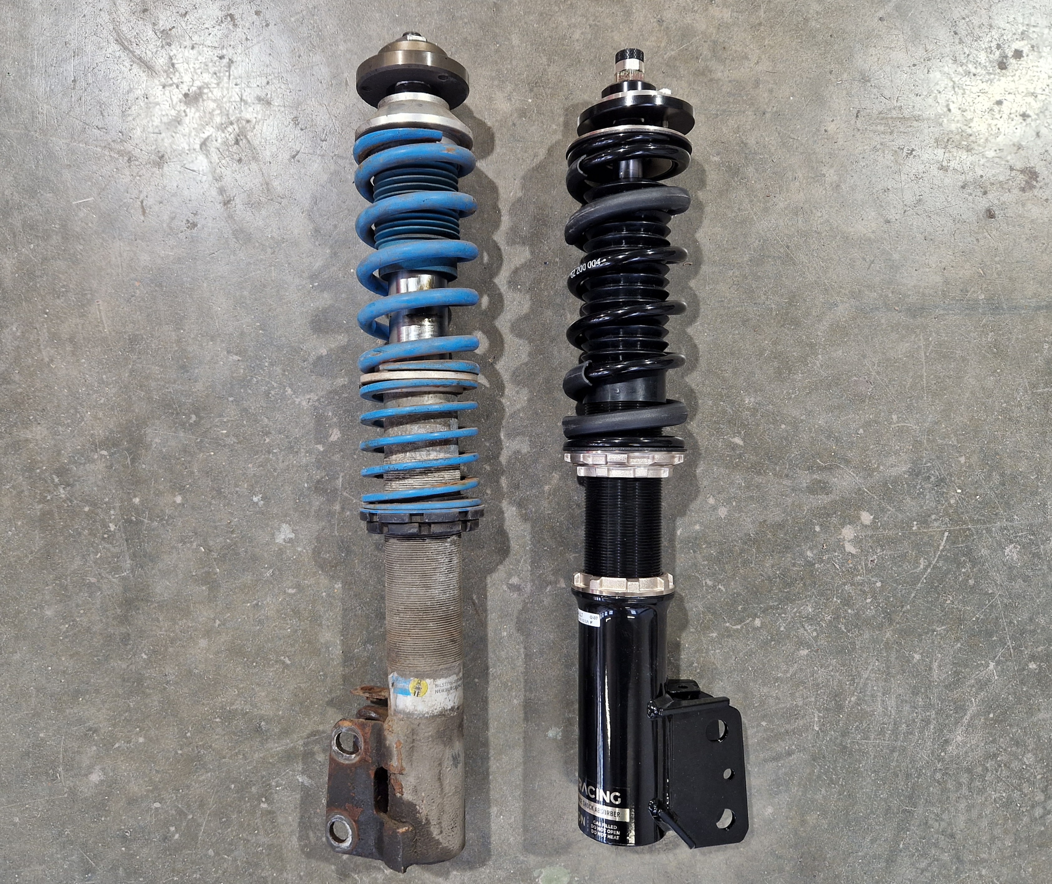

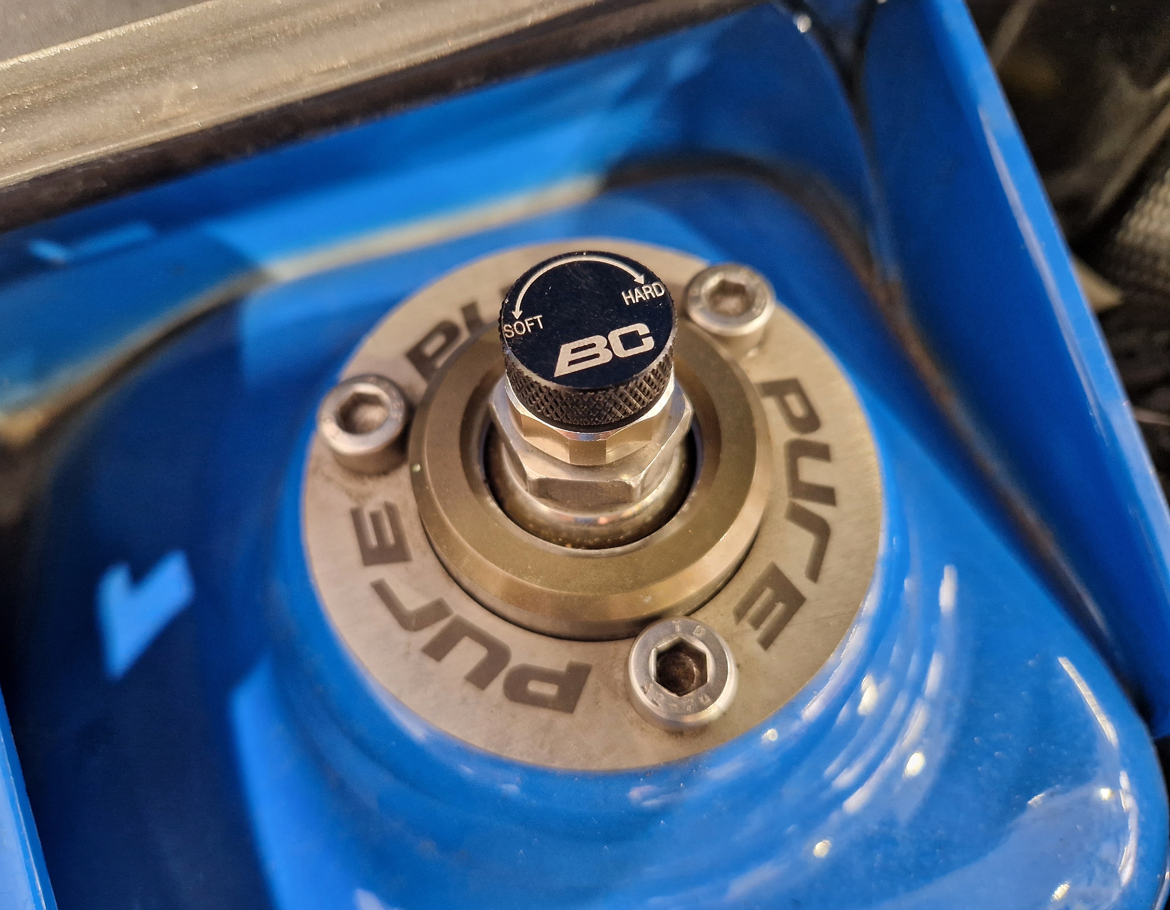

Come back from the show and thought about new suspension. Was torn between getting BCs or Bilsteins, having had both before. I opted for BCs this time, and ordered @CFAB abs brackets also. Excellent service from them, arriving quickly. Once they all arrived I got to work and fitted them. Wanting to still keep the PMS top mounts, I heard mixed reviews saying it could or couldn't be done, so I had a play. Turns out it can be done but have to use the BC top hat with interrogated bearing and lower sleeve and then the PMS bearings and top sleeved nut. Reason I wanted to keep the PMS top mount is I like the design and want to run the strut brace in future. Plus where the turrets have been drilled for the top mounts (previously done before I owned the car) the holes would be exposed using the BC top mount and the "holes" aren't pretty 😅
Jekyll
So from these vids, I'm using the BC top hat with the integrated bearing and lower sleeve.
Then the PMS mount. The bearing has a slightly wider ID so there's little play. However I'm using the PMS top sleeved nut and it seems to centralise it all, leaving no play as the bearing is now pressed down on the BC lower sleeve and the top nut has sleeved out the excess play, thus making it fine.
Jekyll

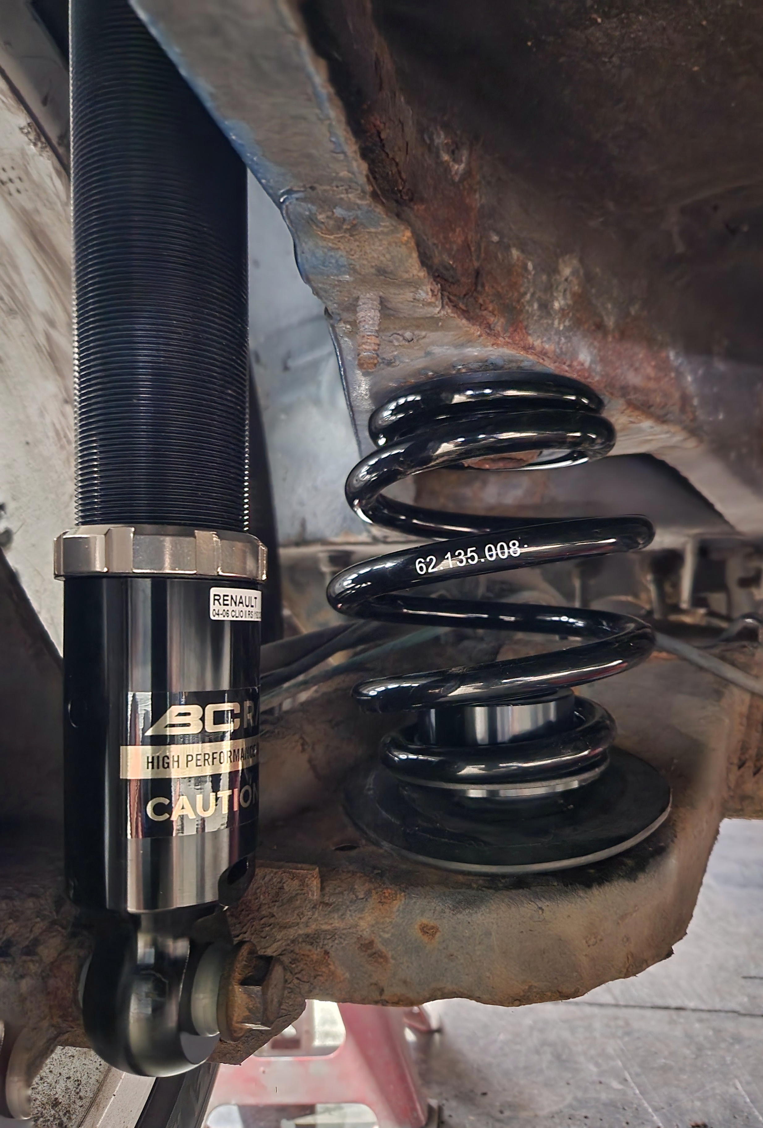

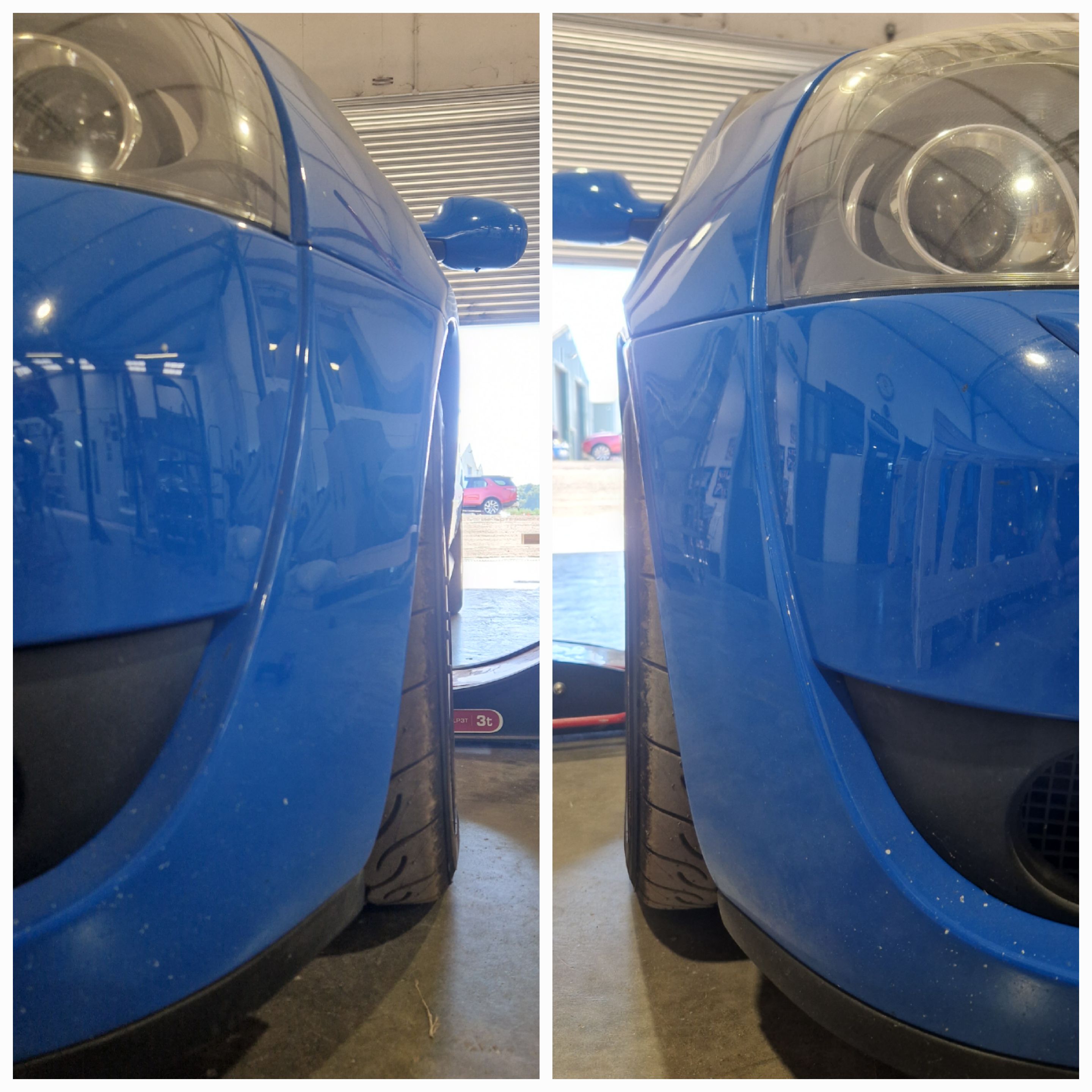

I did notice that since fitting the BCs, the track was wider. I was running 16mm front spacers before with the Bilsteins and it looked visually bang on for my liking, but it sat too far out with the BCs. It looks like the part where the hub mounting holes are, is wider than the Bilsteins, so wondering if it pushes the hub out more? I'm not sure why, but it definitely stuck out further, so for the time being, I'm now running no spacers at all. I've also reverted back to standard wheel bolts as my stud/nut kit was too long as they accounted for the previous spacers.
The pic doesn't really show how far the spacers stuck out, but it was too much for me. I'd like to add a 5mm to 10mm spacer just to give it a little extra but the 10mm one I'd have to get machined whereas a 5mm is off the shelf. Plus being 10mm, I'd lose a bit more hub lip. I'll do some homework at a later date and once the spacers are fitted, I'll order some new stud/nut kit to fit once the measurements are figured out.
So once the coilovers was fitted, I did 40ish miles and all felt good. I had a day out and when driving back, all was good and I was coming up to a roundabout. Engaged the clutch and bang, clutch pedal goes completely floppy. Coasted over the roundabout and managed to ease into a lay by I knew of. (I'm approx sub 10miles from home)

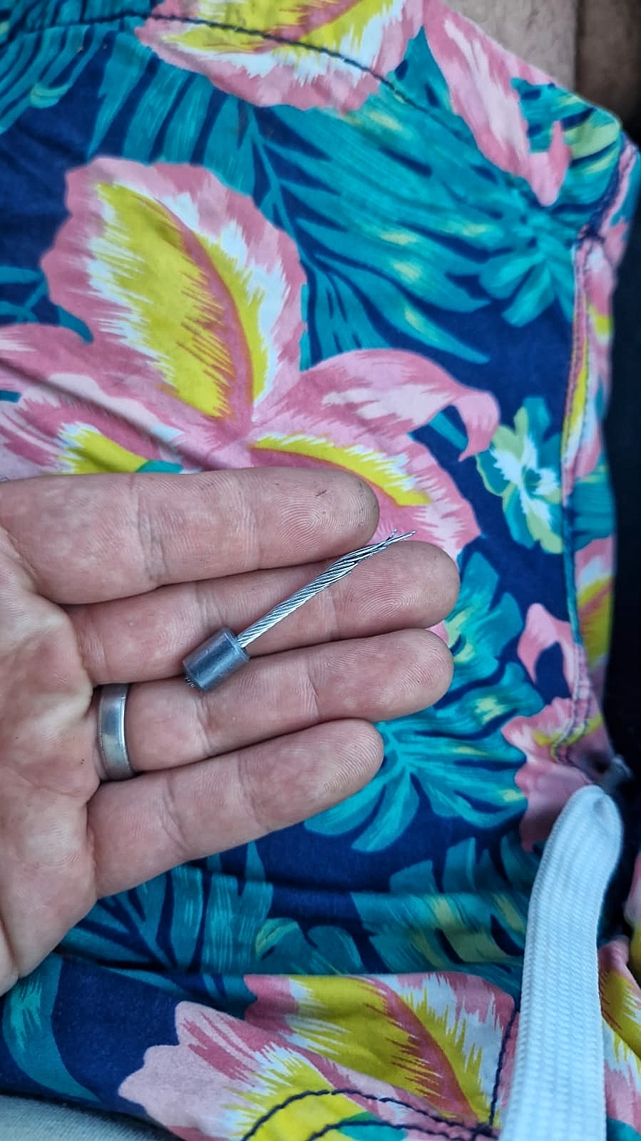

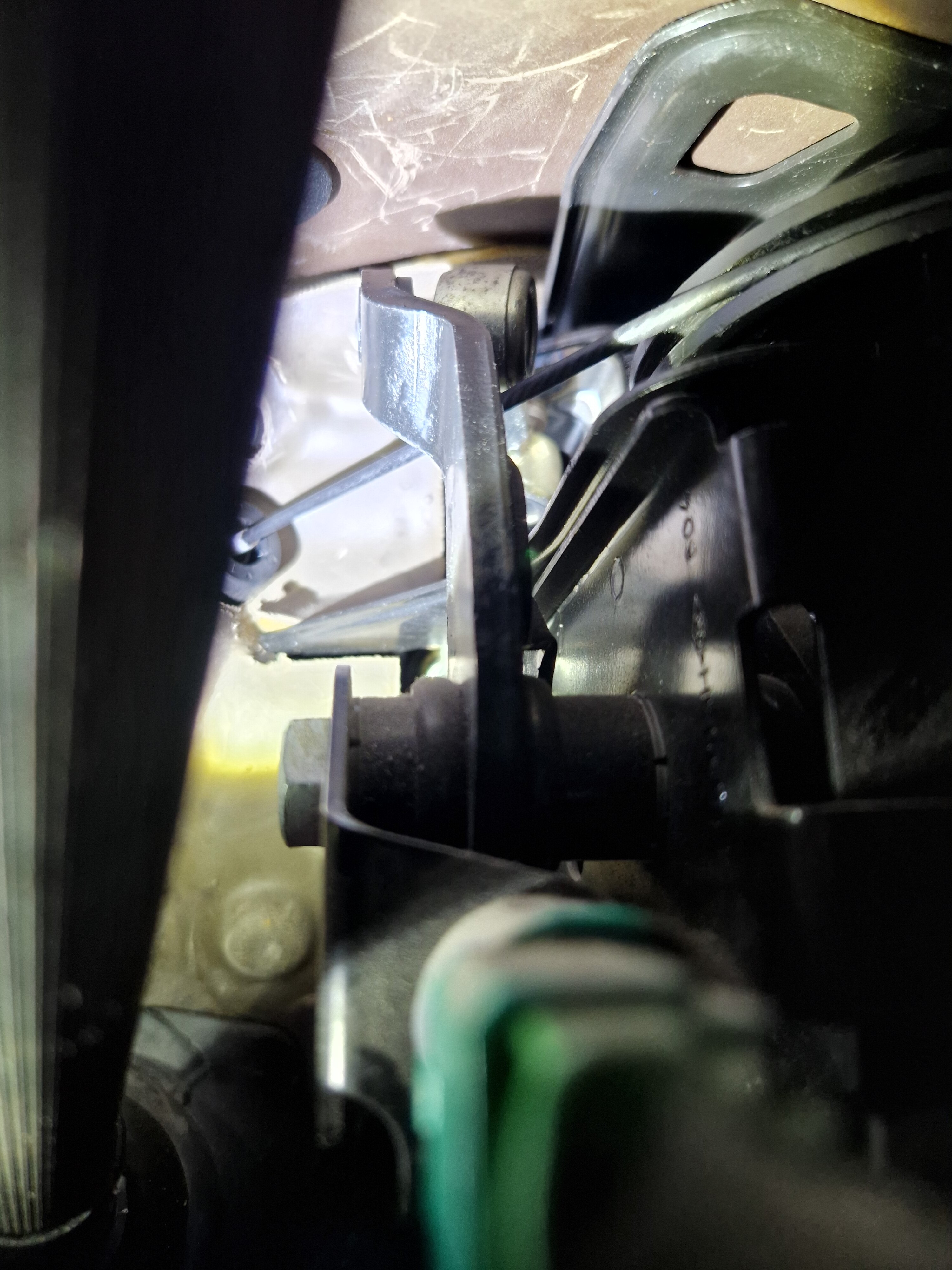

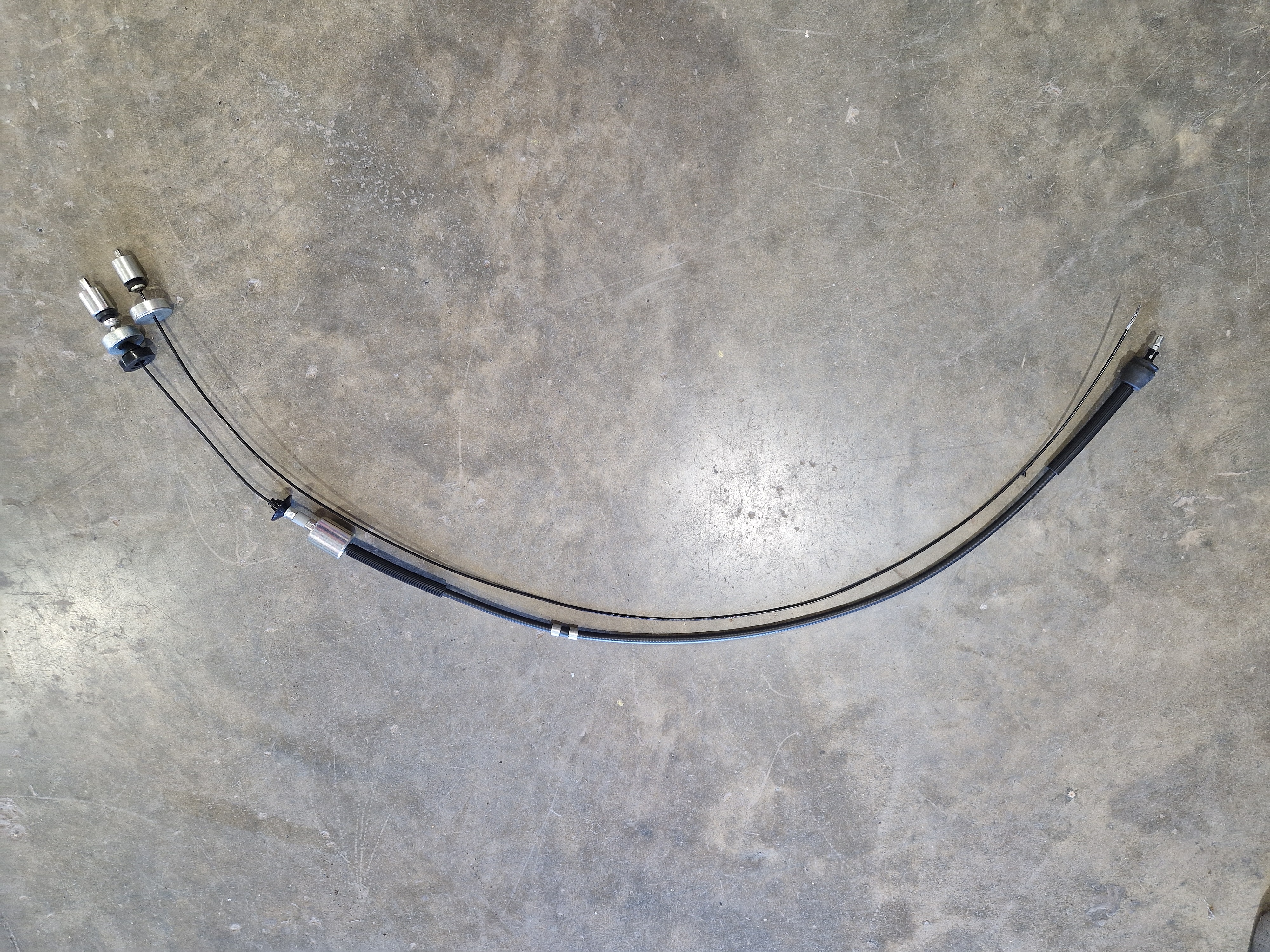

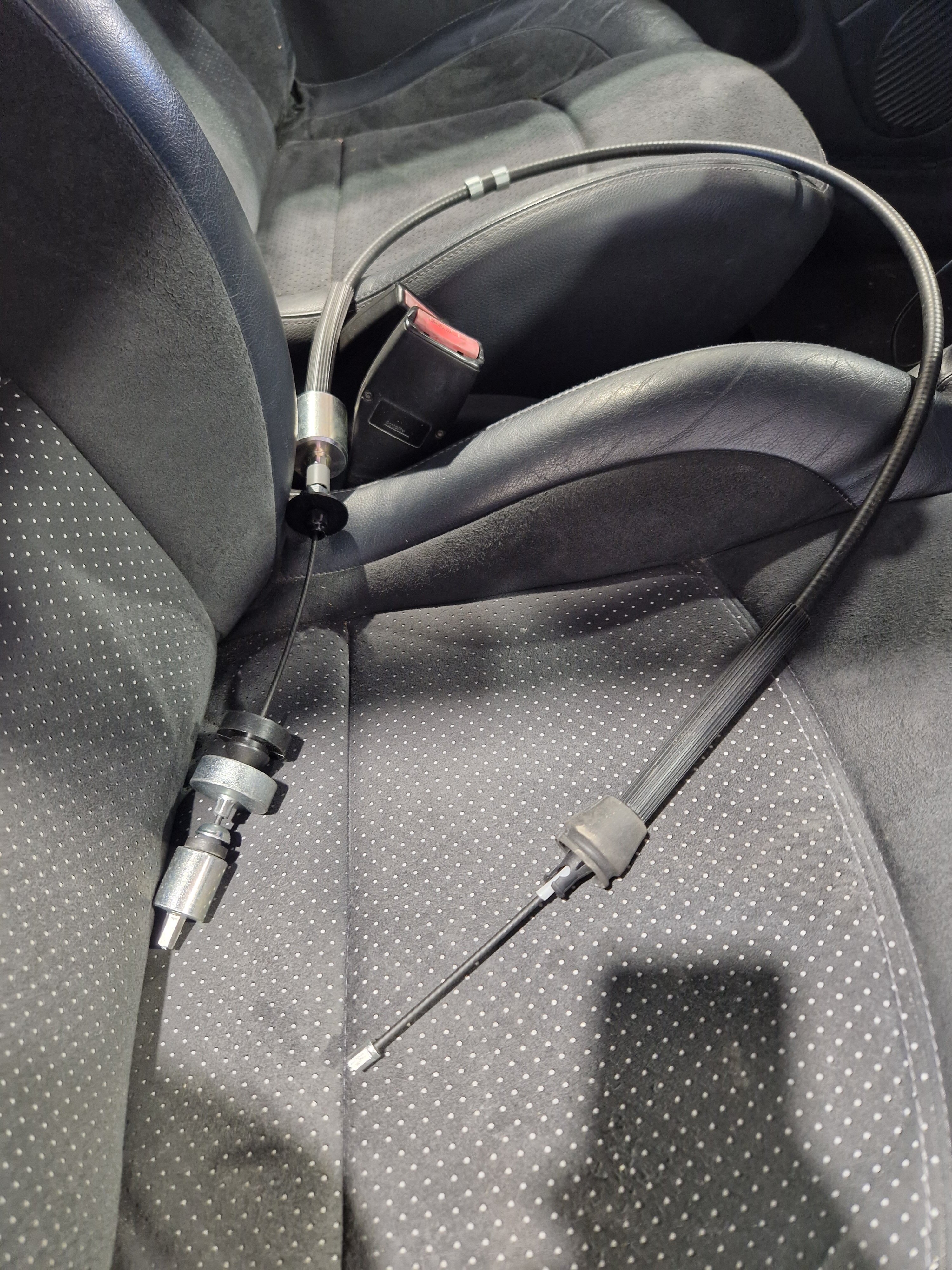

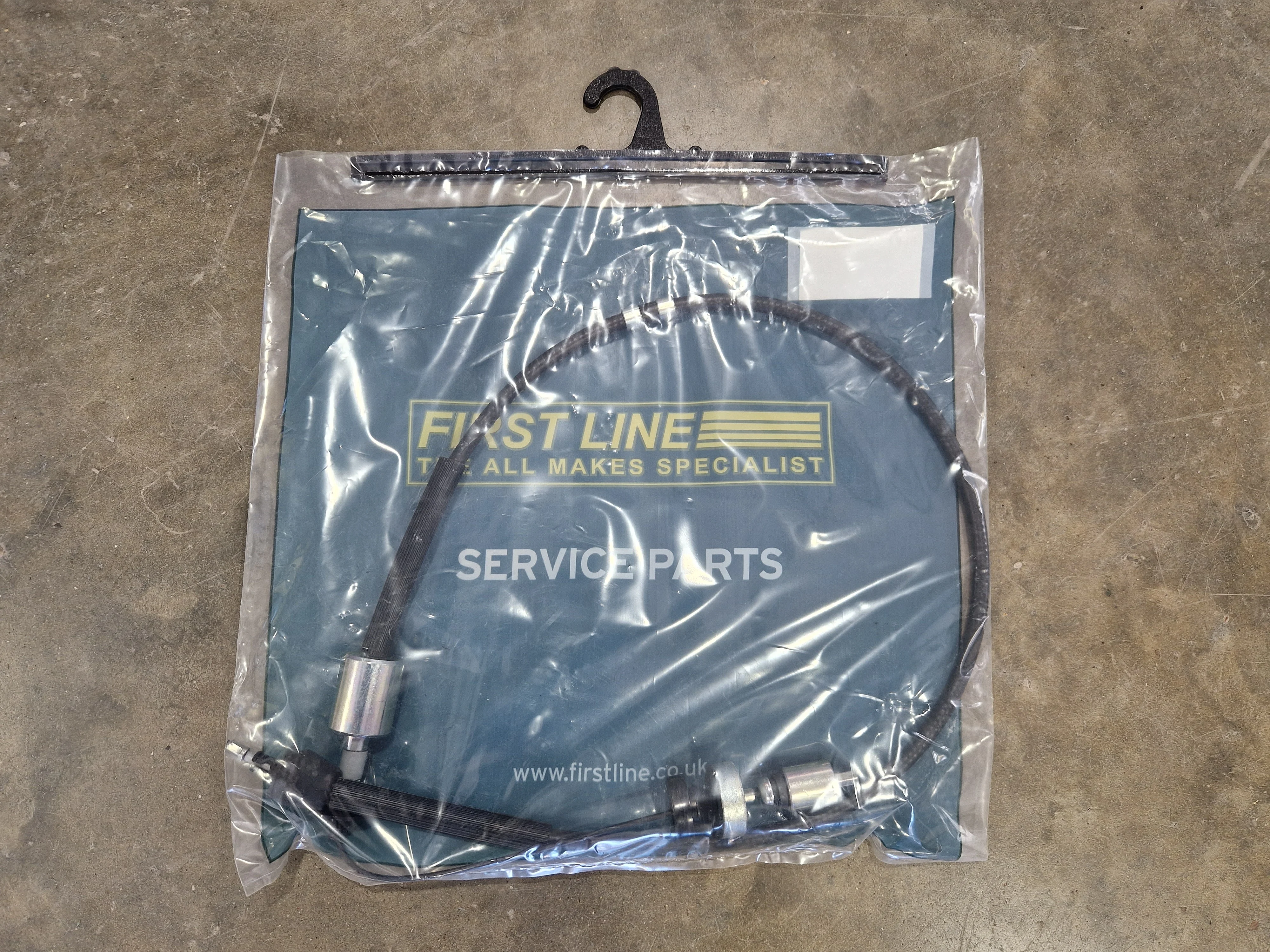

Had a little nose around and turned out my clutch cable had snapped. This pissed me off a bit as it was a brand new genuine Renault item bought and fitted last year. But alas, it was broke and i was broken down. Called the AA who we are with and the AA man tried making a cable in situ, but it was dark and late, plus he was at the roadside so was limited. Basically I ended up being towed, but work was only 10 miles away so he took me there and I had wife pick me up. (The funky shorts was because I was coming back from a day at a outside park and paddling pool! 😅)
Once i was back at work the next day, i ordered a new cable from our local motor factors. Ordered at 8:30am and delivered by 10:30am!
Jekyll

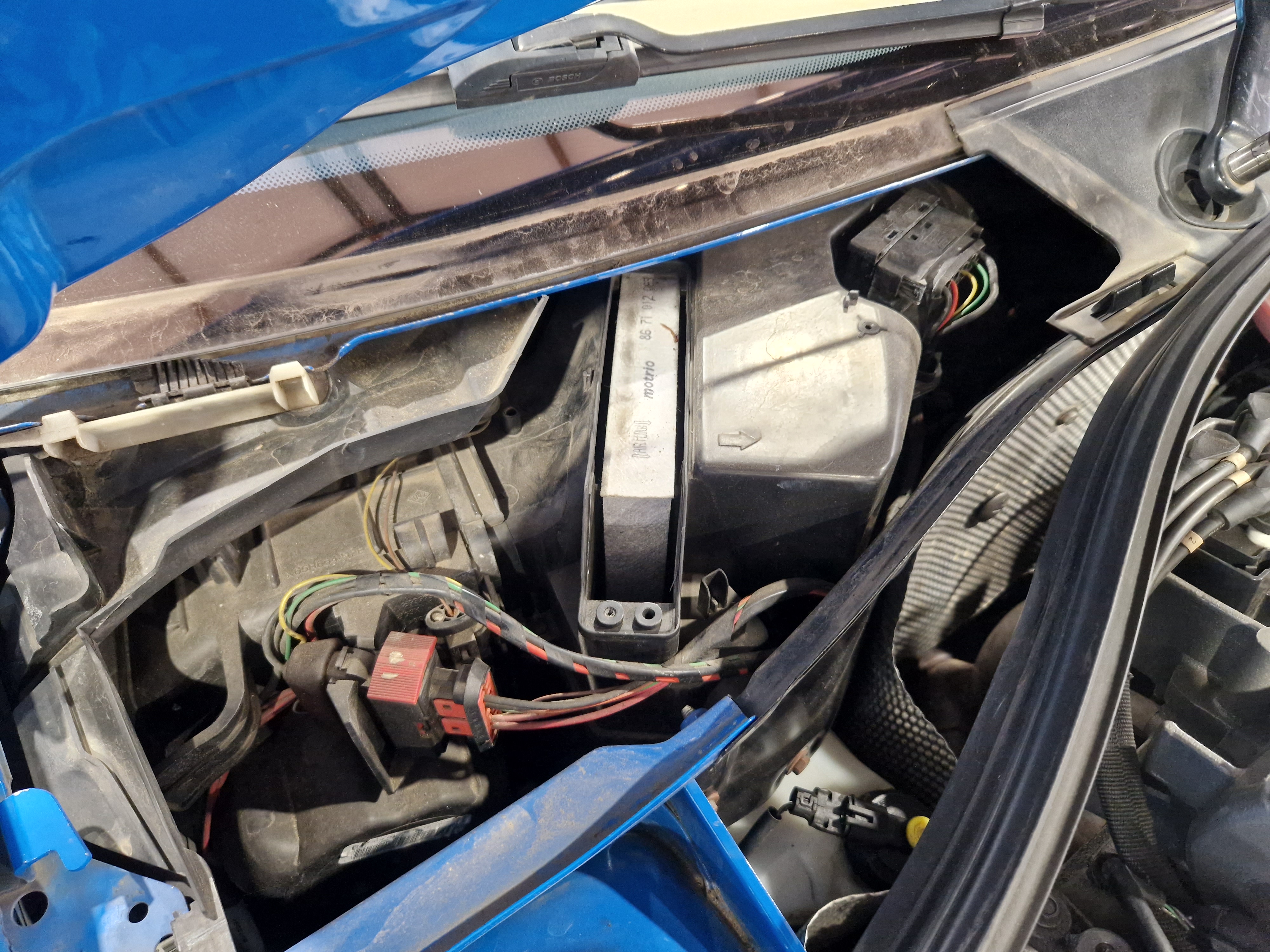

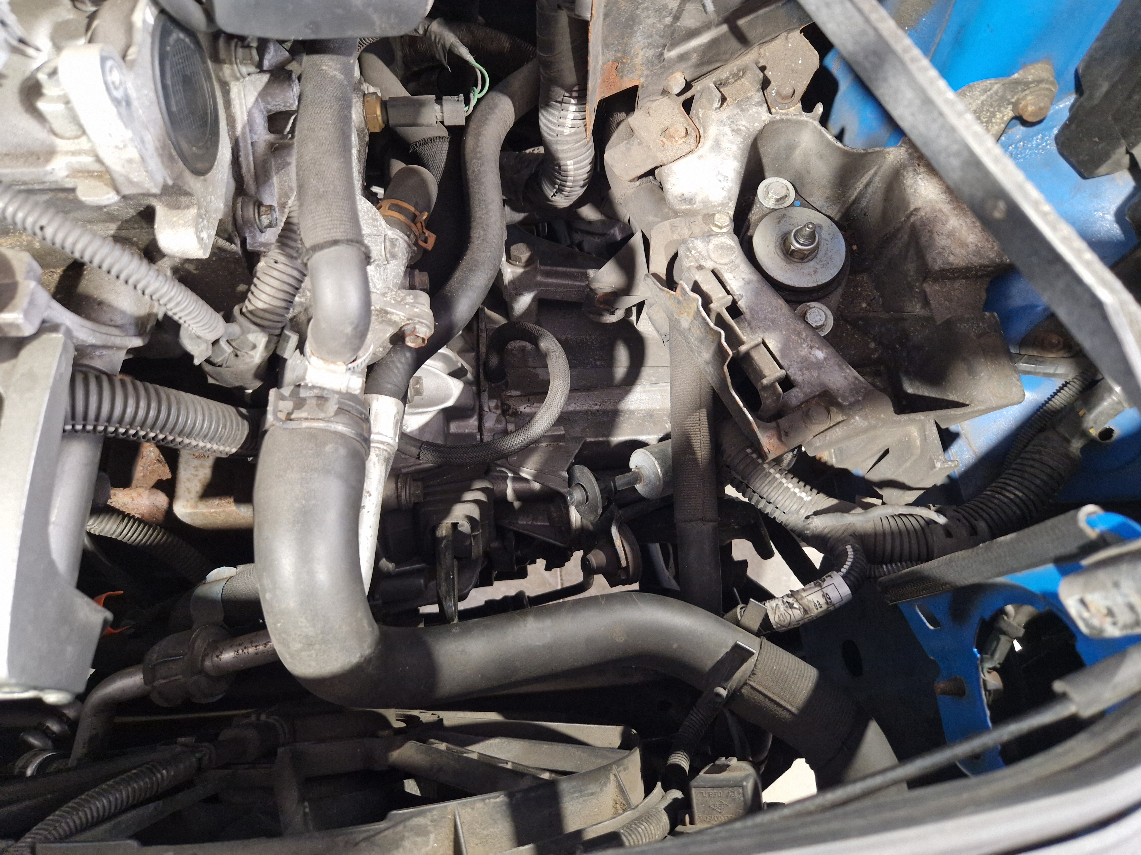

So one day after work I opted to change the cable. I read a few threads on here and I'll be honest, it wasn't a job I was particularly looking forward to doing. I've never done a clutch cable before and I know in the footwell, access is a bit tight. On one of the threads I read, I saw @Louis had done one recently so I dropped him a message. Pictures of this job are a bit limited and I'm a culprit myself as I think with this job, you just want to crack on and get it done.
@Louis was basically my on call phone help and he really did. Just made things more easier to see rather than just guess. So many thanks buddy, it was very much appreciated!
My pictures don't show a lot really but thought I'd add them anyway. I found this thread helpful.

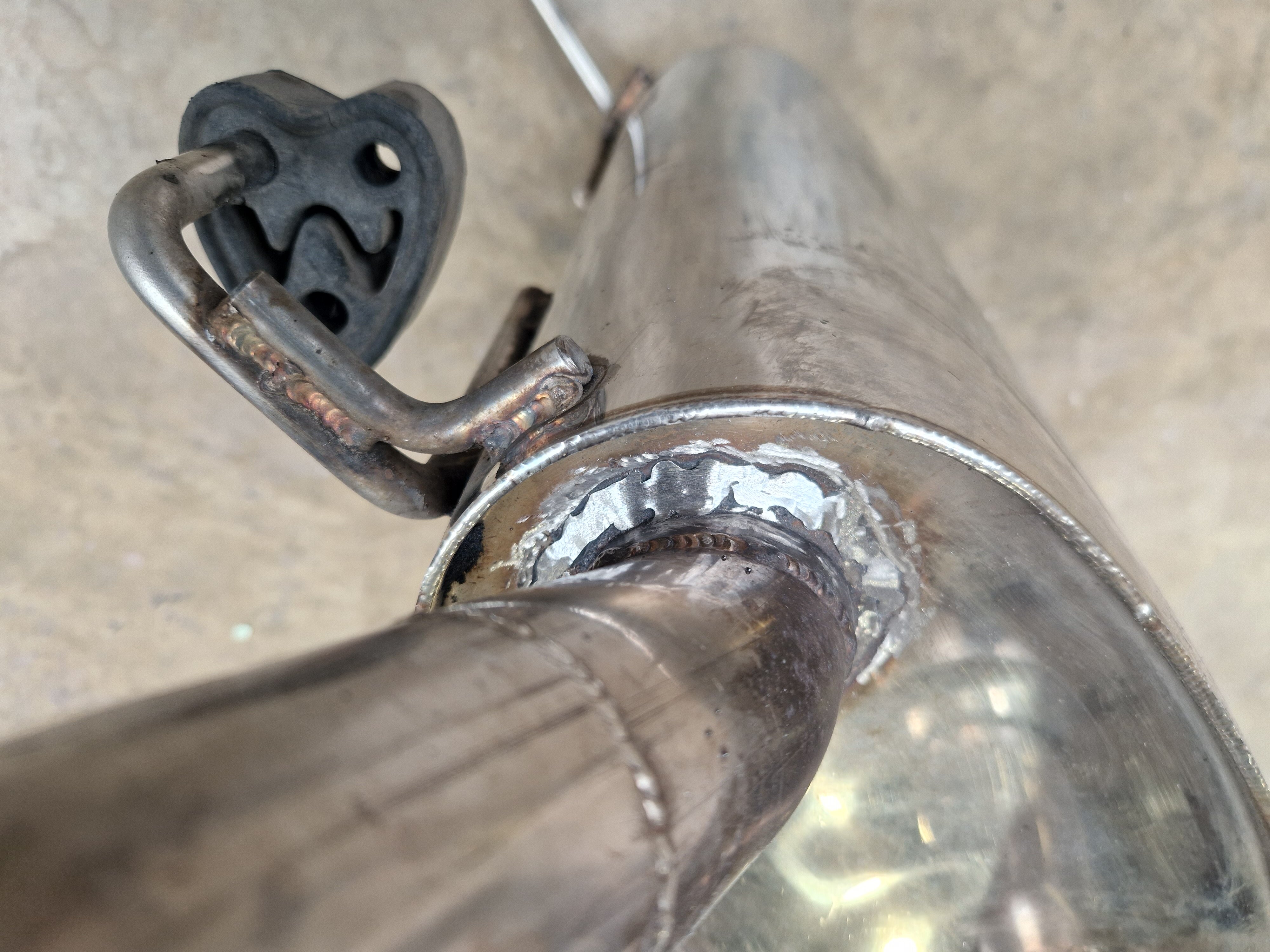

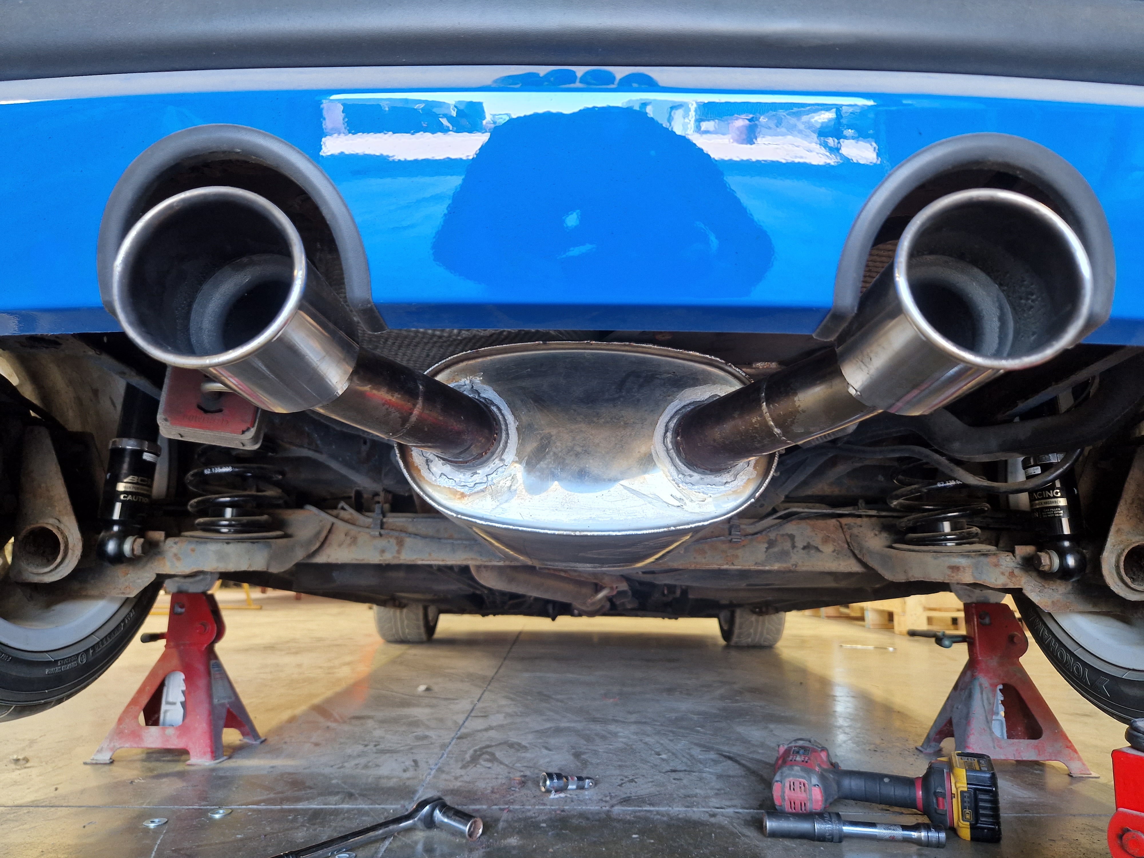

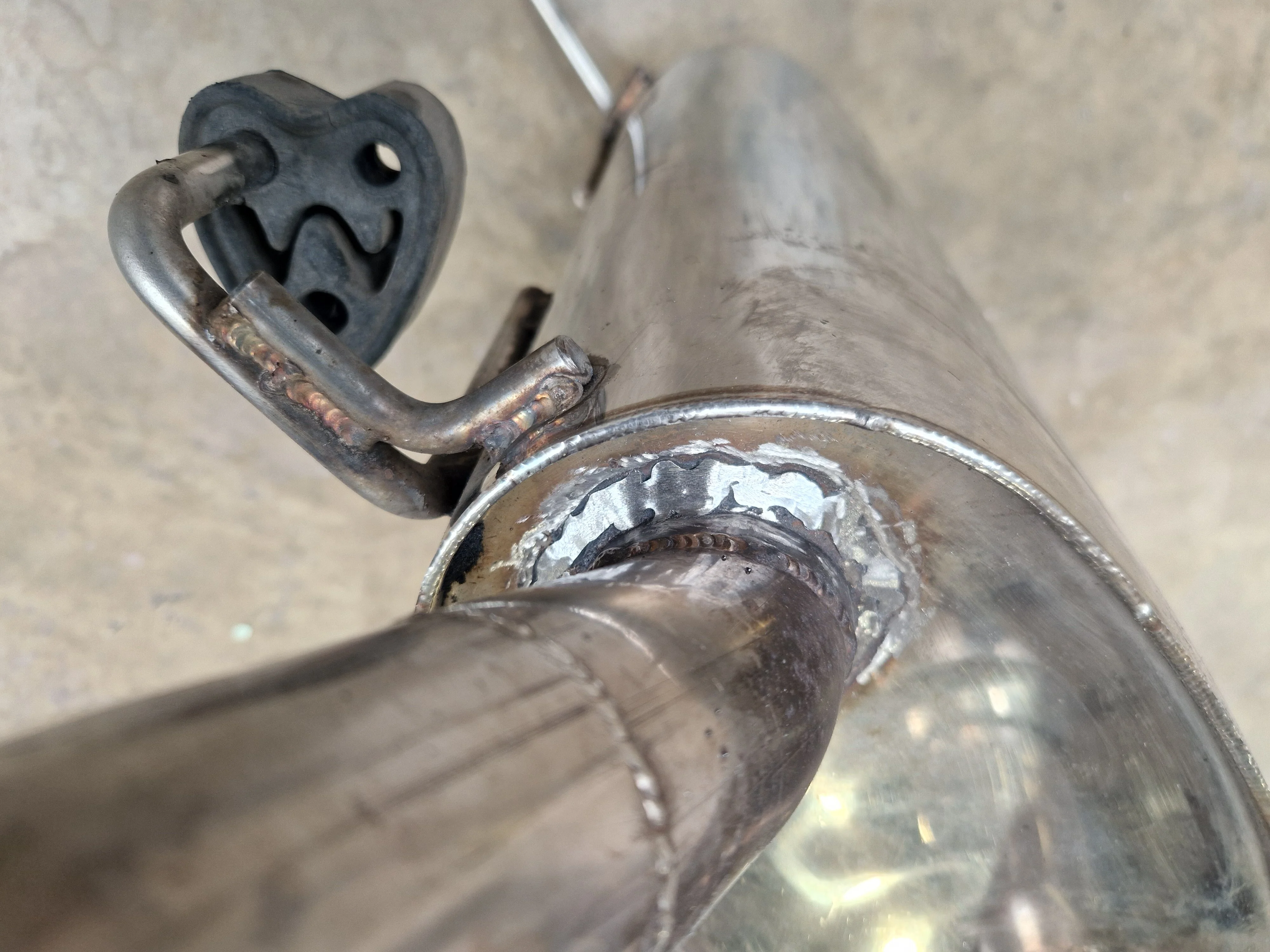

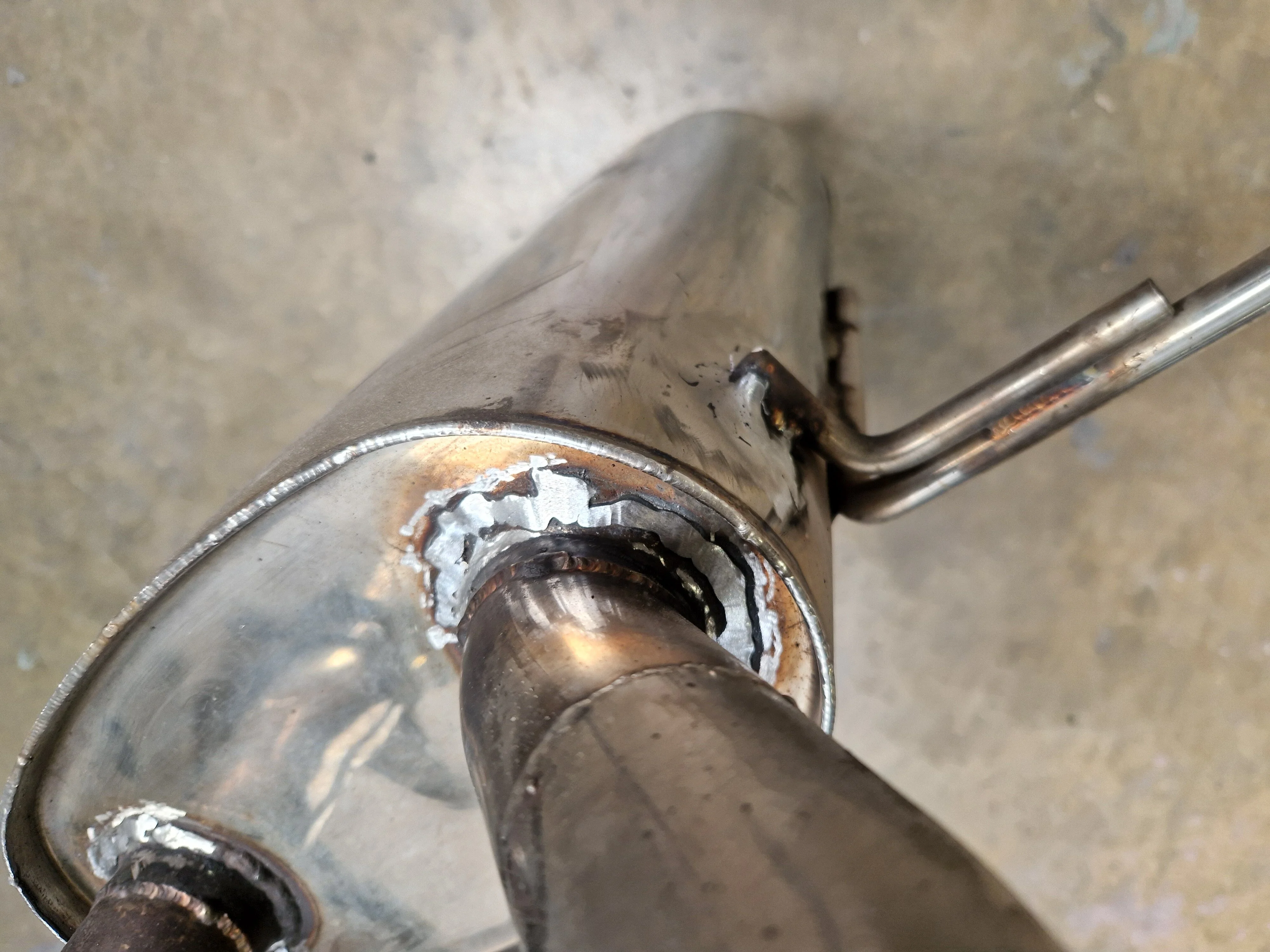

Next job was the exhaust. It had got quite bad and I was worried that at one point, the mounting bracket would snap off during driving. Since I've decided that I don't like the back box, thought it'll be a disposal system so I decided to weld it myself. I'm no welder but can do the basics, however we've only got a mild steel mig at work. You can weld stainless with it, but obviously it'll go rusty. Also, the torch/gun is quite big compared to tig ends so I found trying to get in the gaps where the tailpipes are, was a bit hard. Plus it was really hot that day and wasn't feeling being stuck at work doing this job!
So basically I've welded it. It's not pretty, but it's structural. Sanded down the welds and gave them a bit of silver paint, just to hide it a bit. Plan is to remove this system at some point and replace with another, so that's why I wasn't bothered about butchering it as such. Now that the exhaust has been refitted and settled, the paint has blended in a bit more and being low down, you don't see it that much.

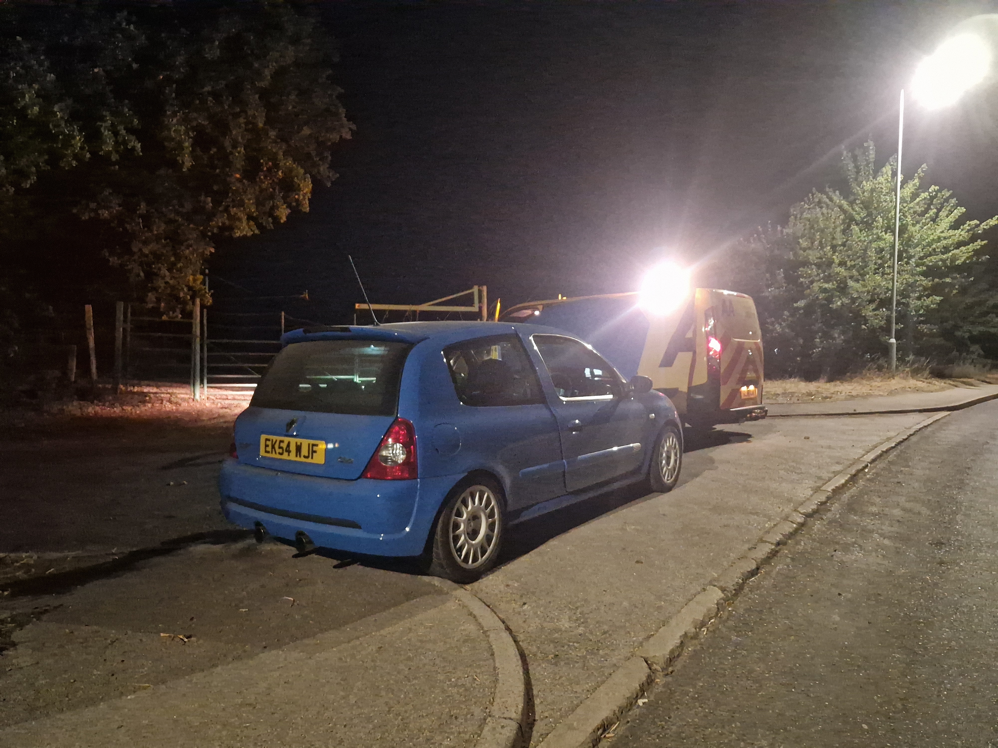

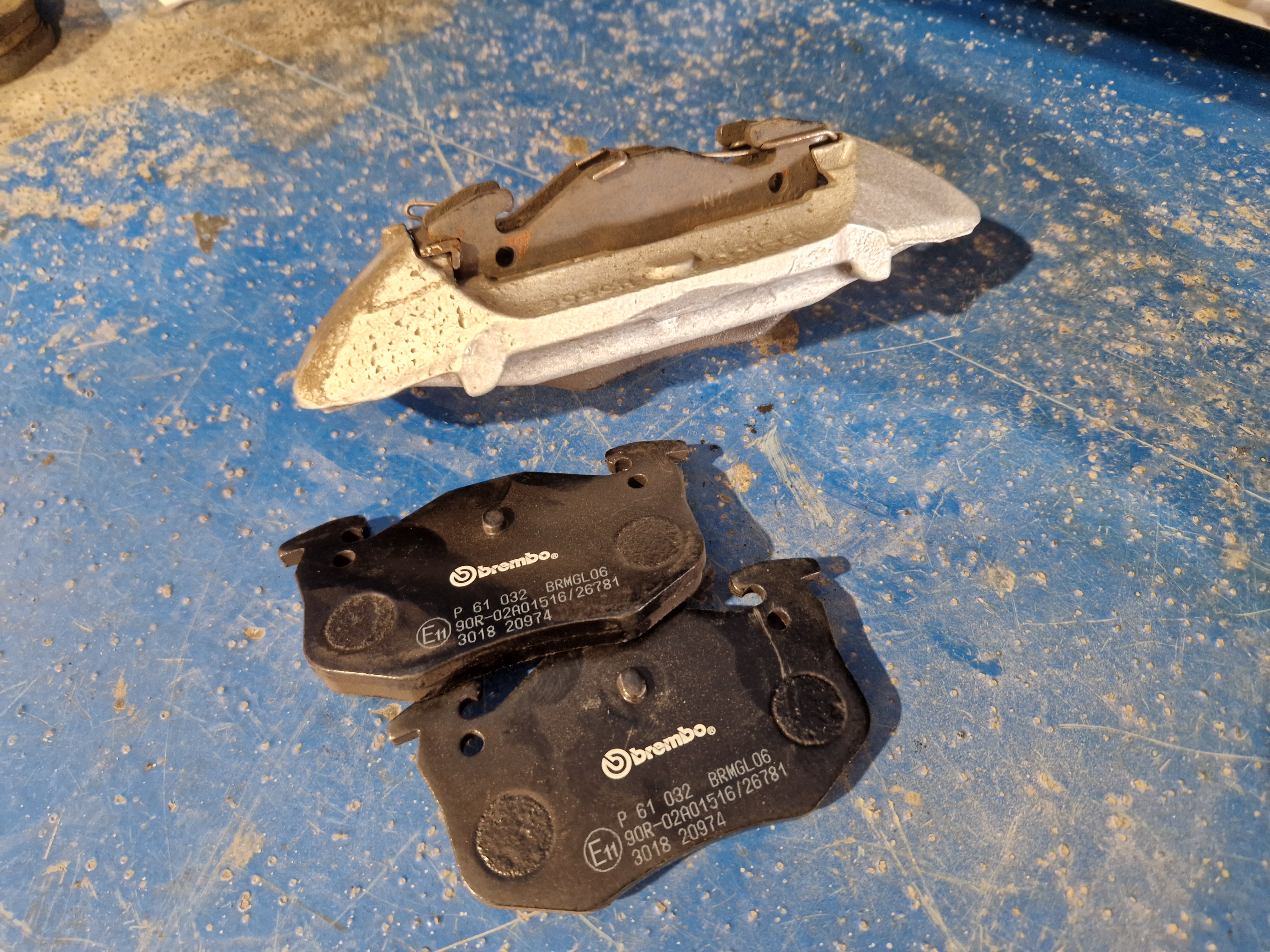

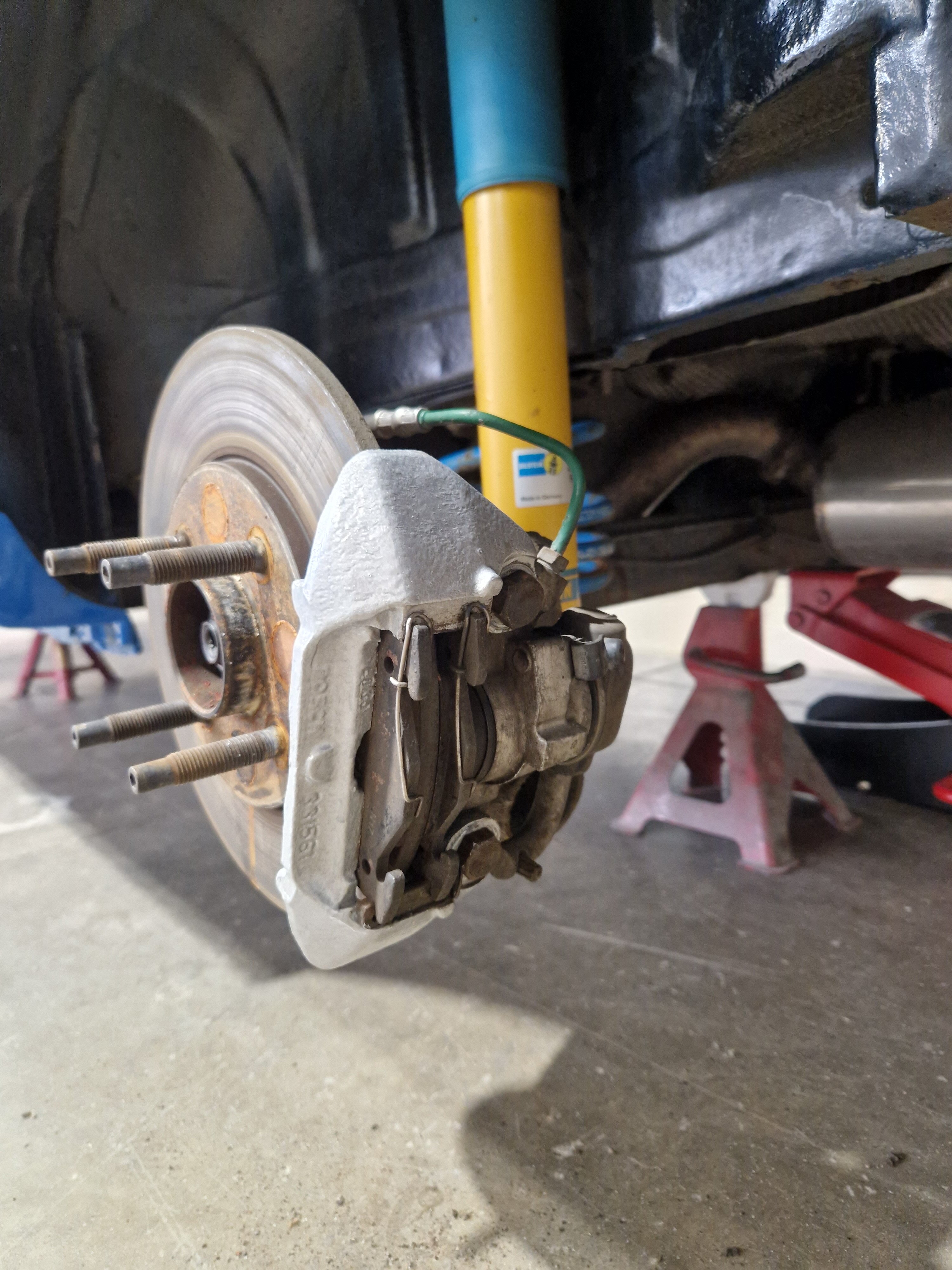

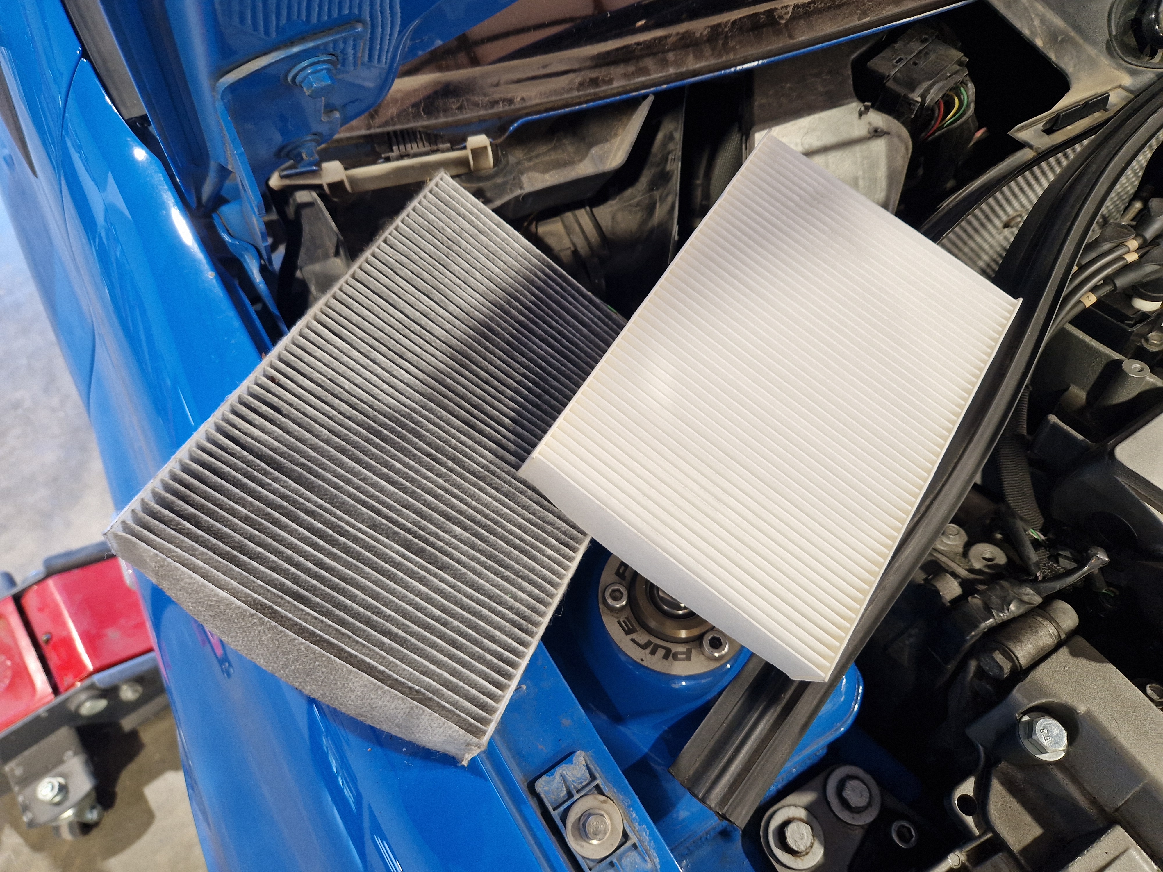

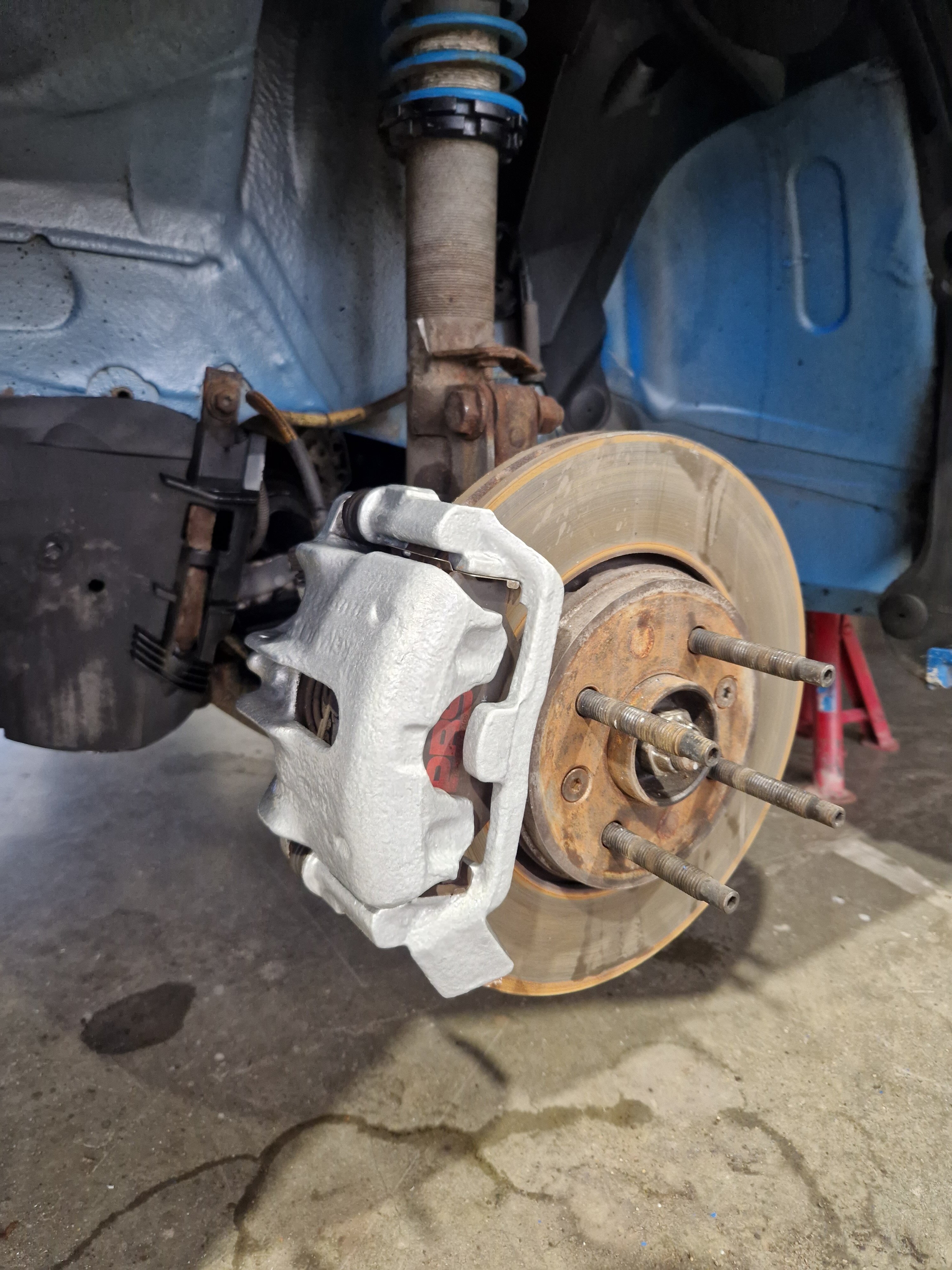

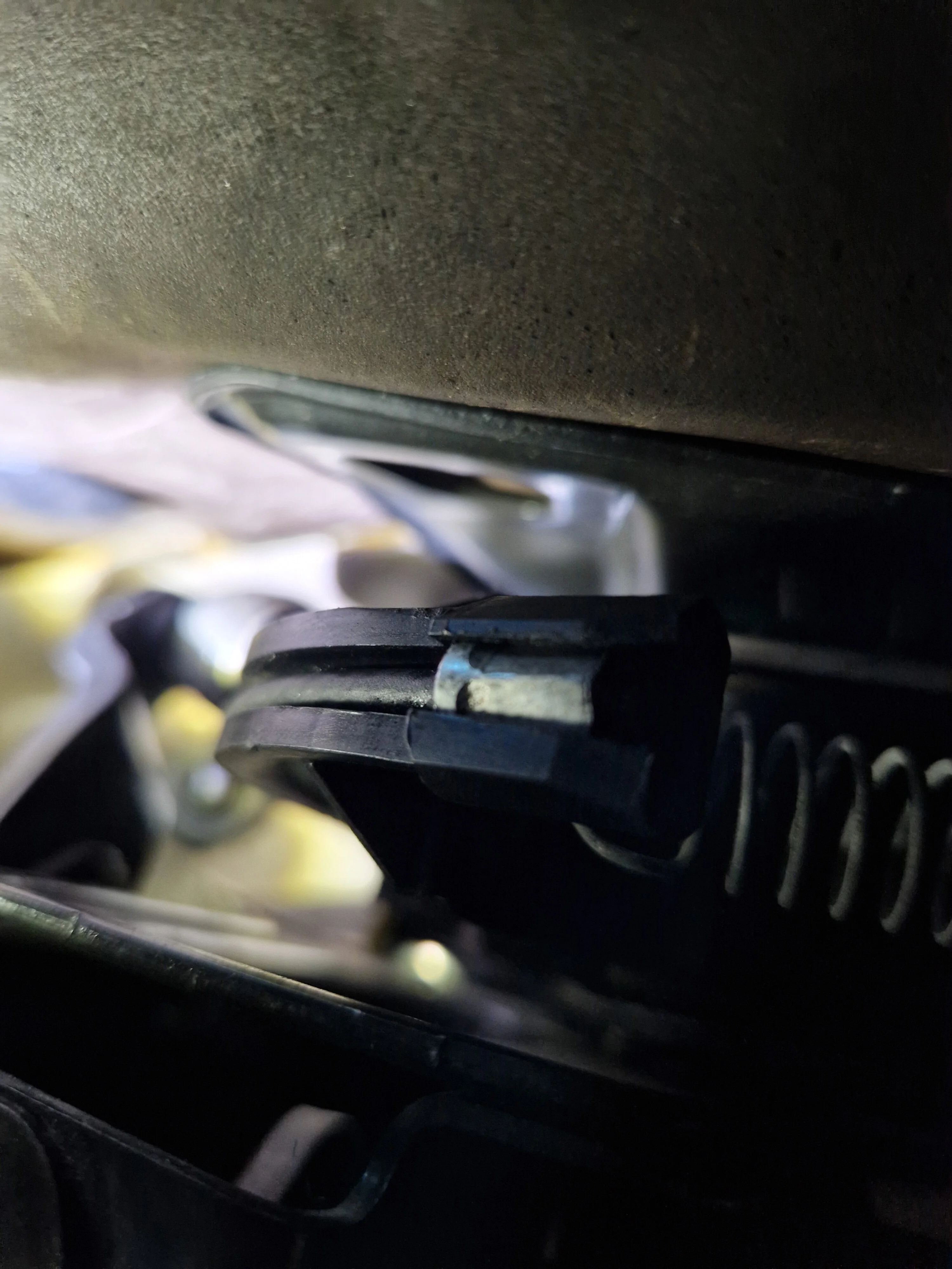

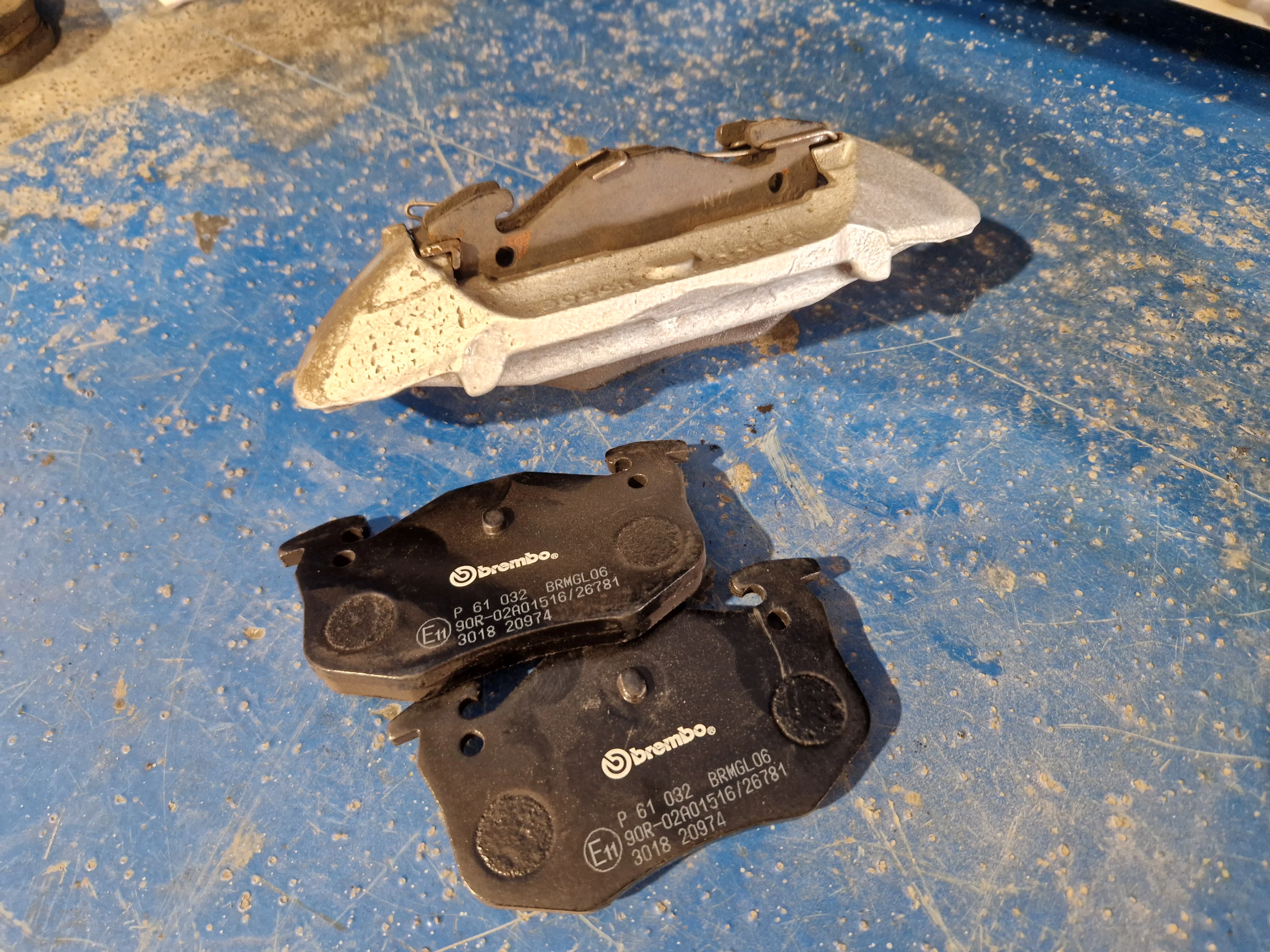

Few other pre Scotland jobs was oil/filter change, pollen filter and rear brake pad change. One of my MOT advisories was the drivers rear caliper wasn't doing anything so while I was changing the pads, I removed the sliders, gave them a clean and added caliper grease. They was stiff before and slide nice now so I'm wandering/hoping that it was just a sticky caliper. I'll take it back to the garage for them to check before I buy new rear calipers.

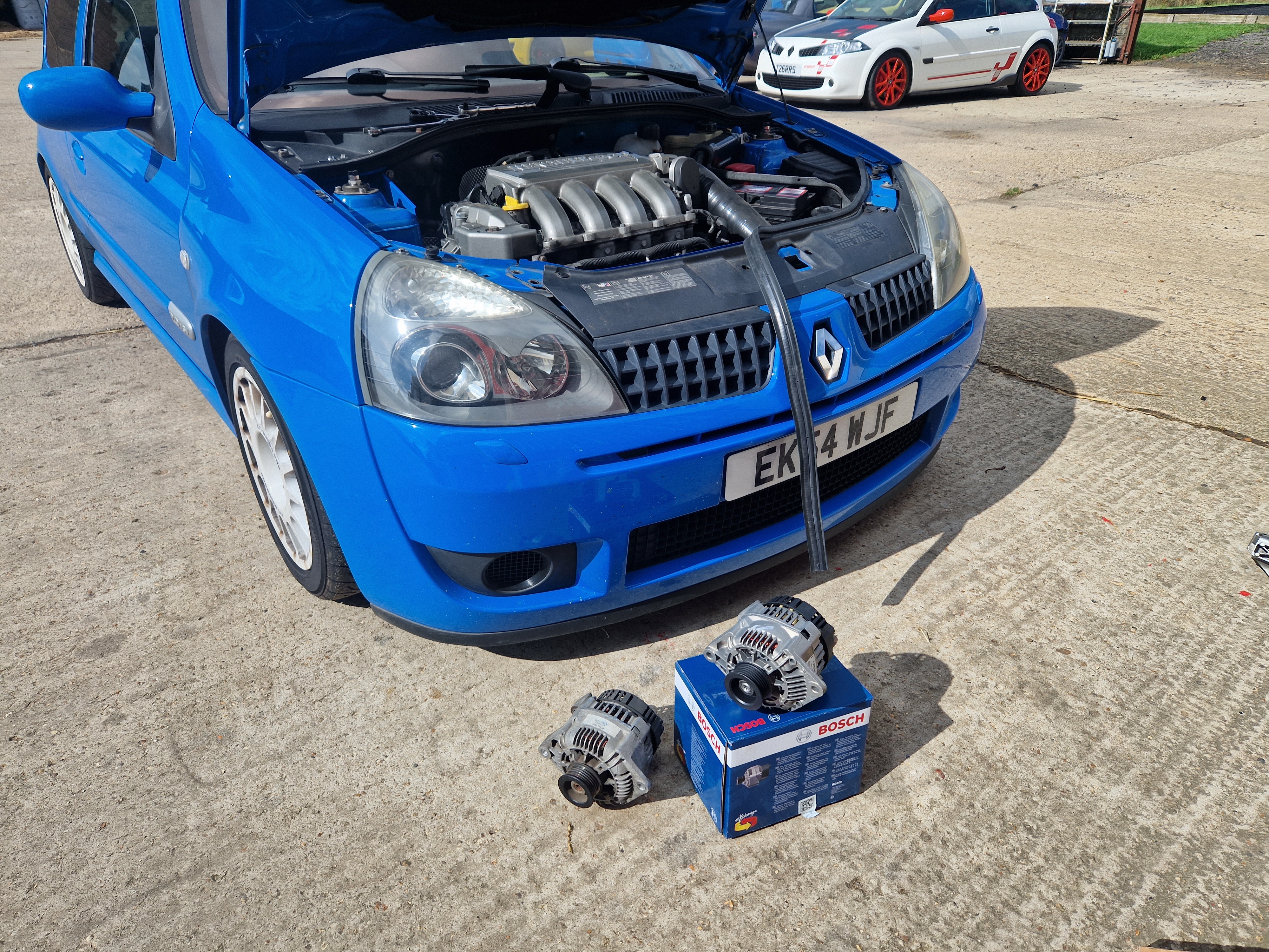

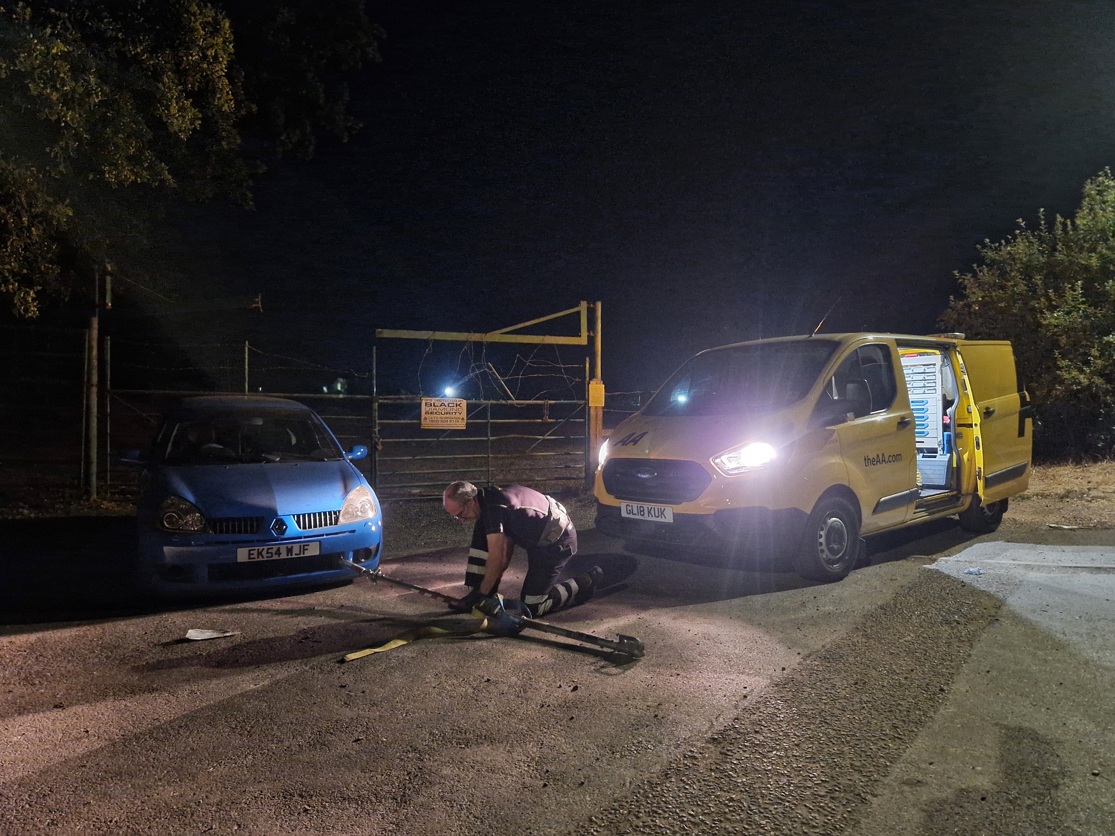

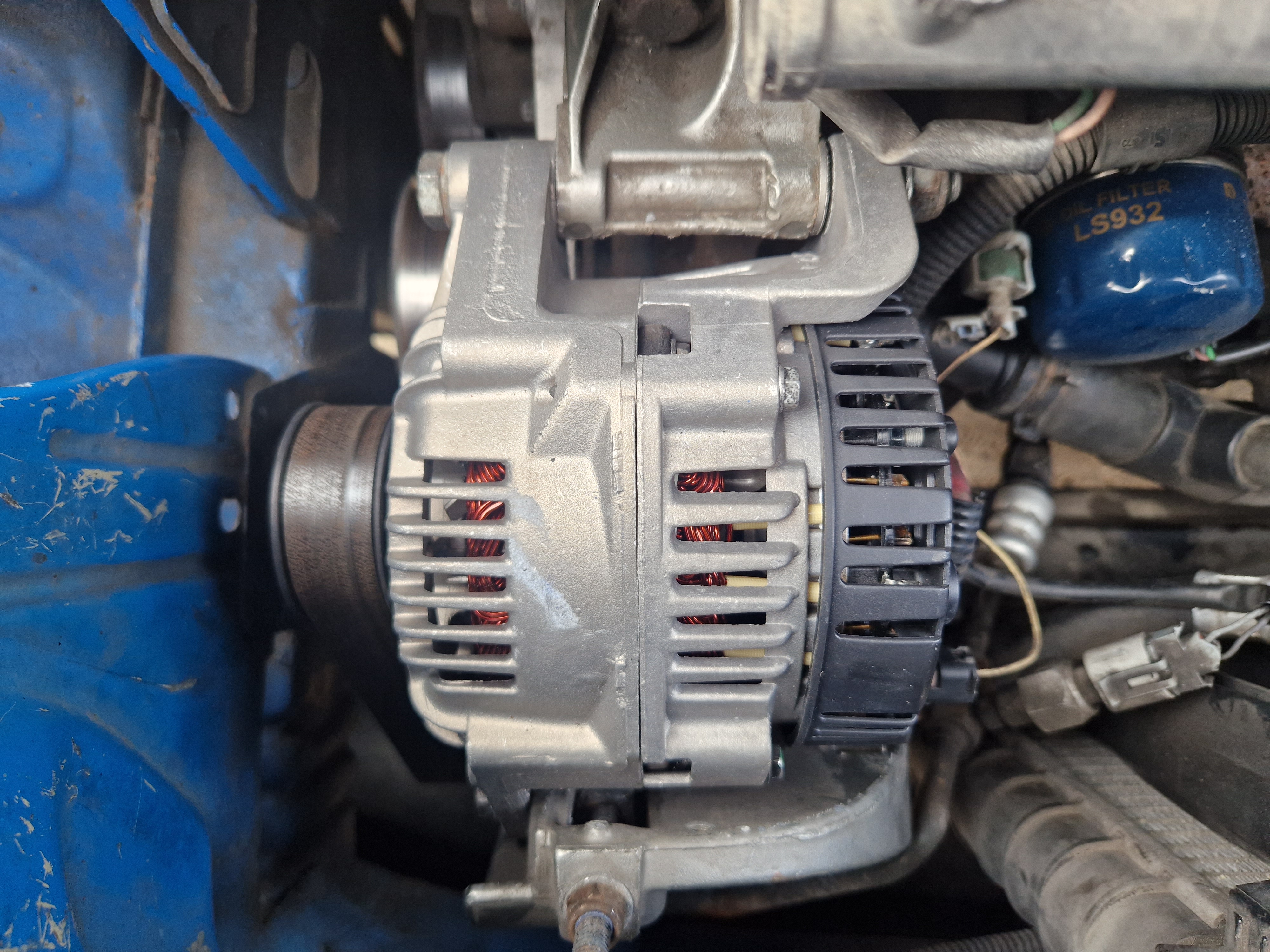

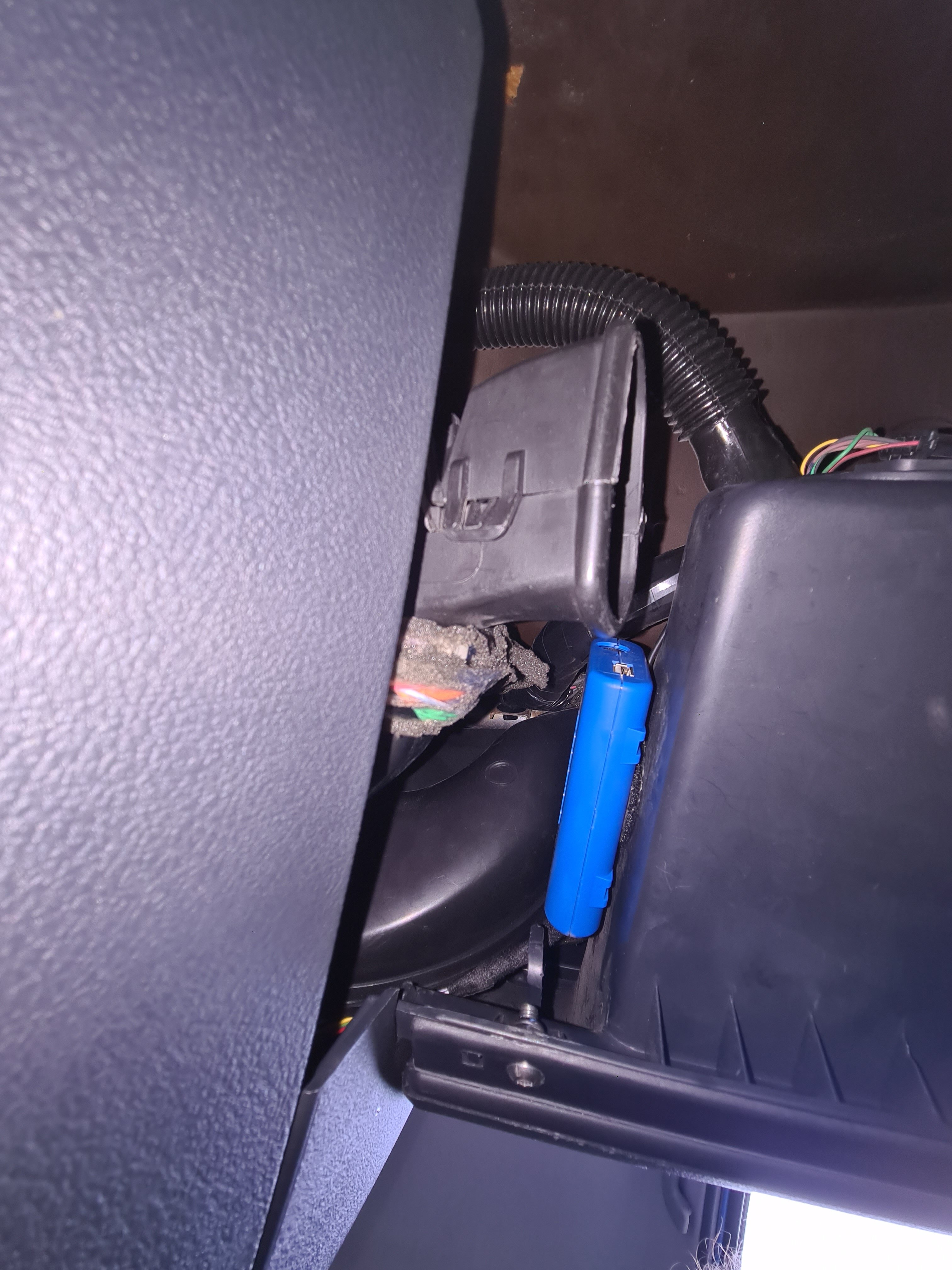

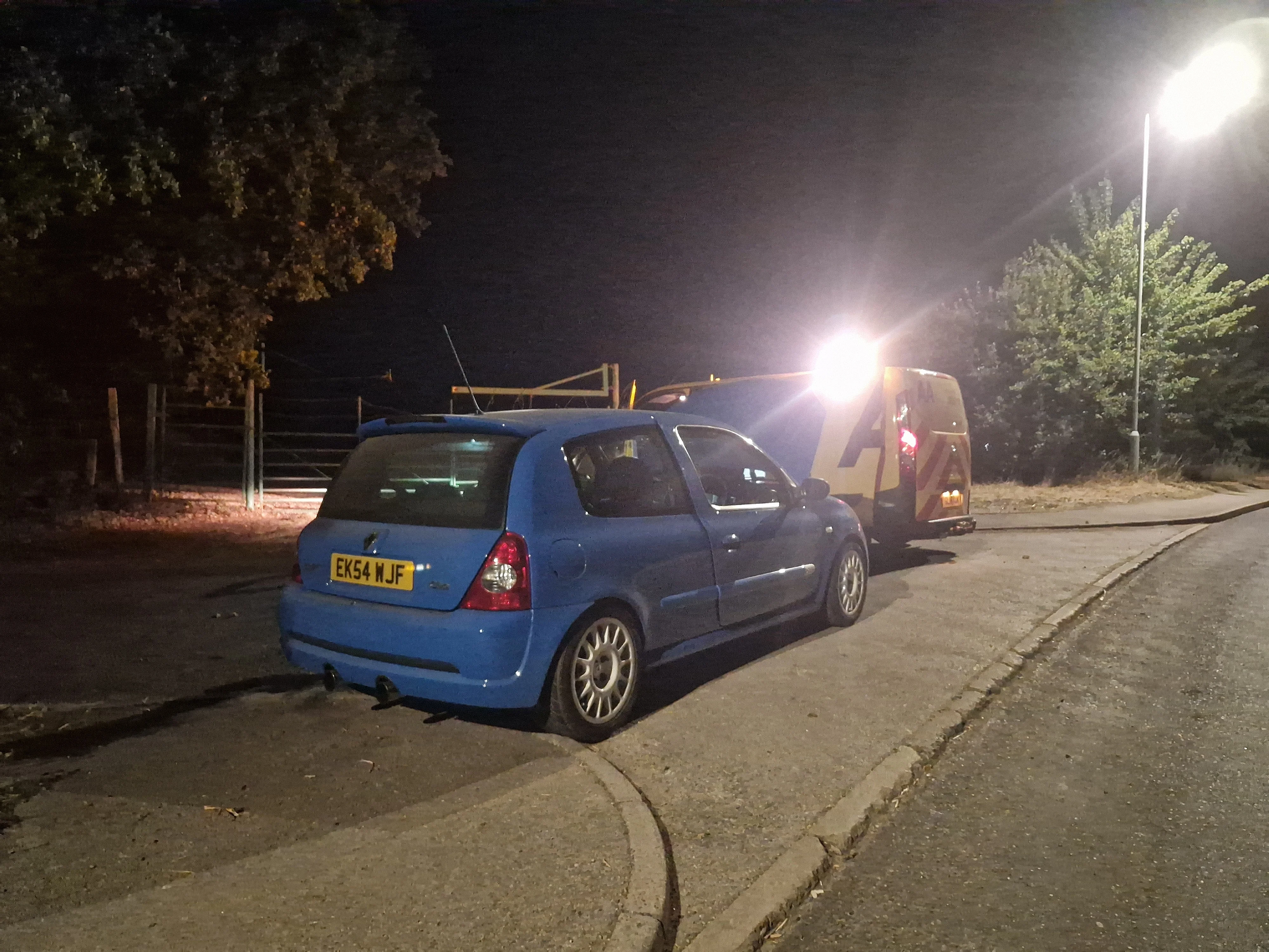

All was fine and easy jobs. Then this week, my alternator decided it didn't want to play ball. This was on the Wednesday evening and I drive up to Scotland today (Sunday) so timing wasn't ideal.
I spoke to Alex @ AW Motorworks and he could get a Bosch one next day. So I ordered that on Thursday morning and true to his word, arrived on Friday. Having a half day, I left work and drove to his place. Once there, I fitted the new one and had power again. Having the cup setup makes it a lot easier to change the alternator. It works as it should, but it is a bit louder than previous one.

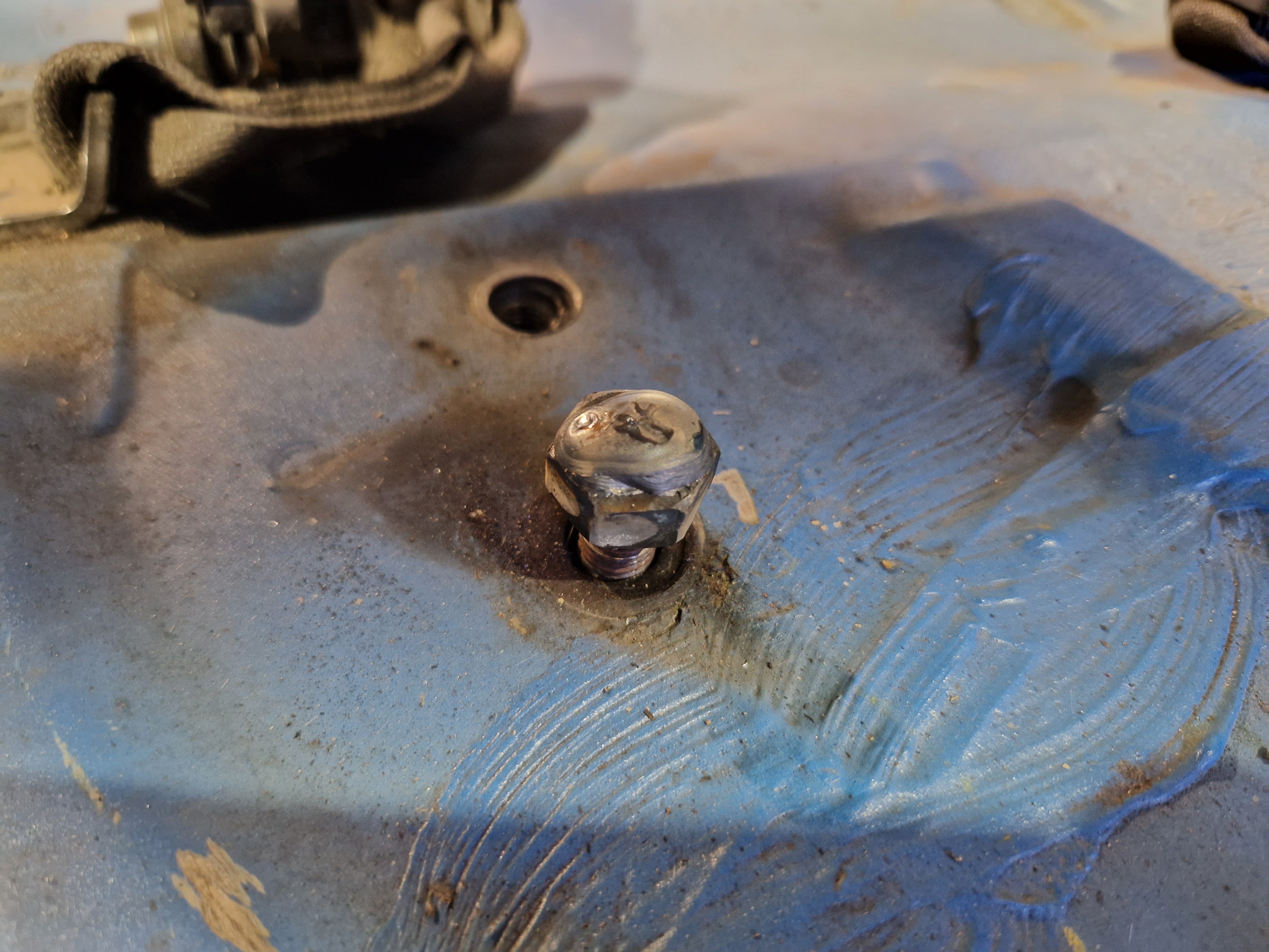

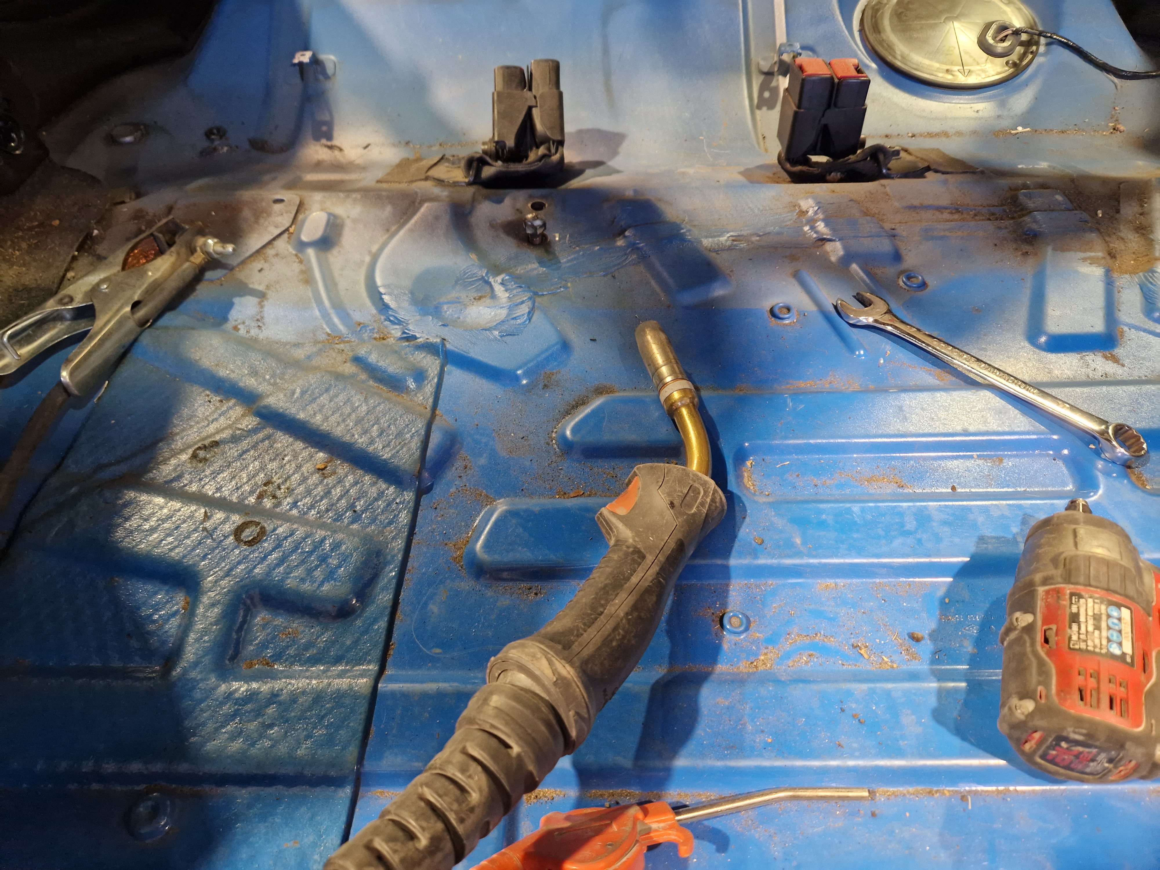

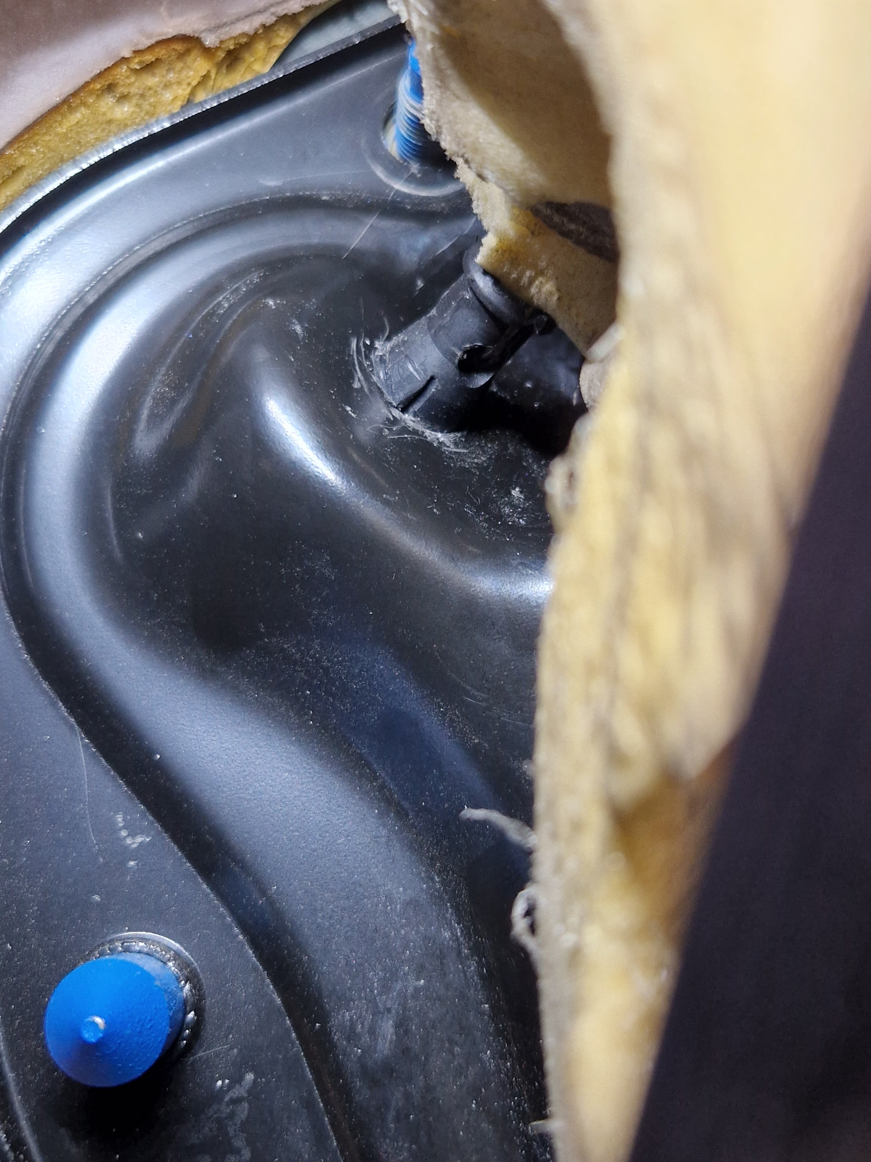

I then drove back to work to give the front brakes a clean up and I wanted to remove the rear seats to allow me more space in the boot for camping equipment. Isofix bar came out easy as I've had that off recently, but as expected, the seat brackets didn't! Stupid torx head bolt rounded which I knew would. I cut the head off with a grinder and originally tried doing the double nut trick as I had enough threads showing but the bolt wasn't budging. Mostly because the lower part is seen to the elements so was rusty and seized. So out came the trusty welder again and I welded a nut to it and buzzed it off. (I disconnected the battery first and used a welding blanket around the stud and surrounding areas)

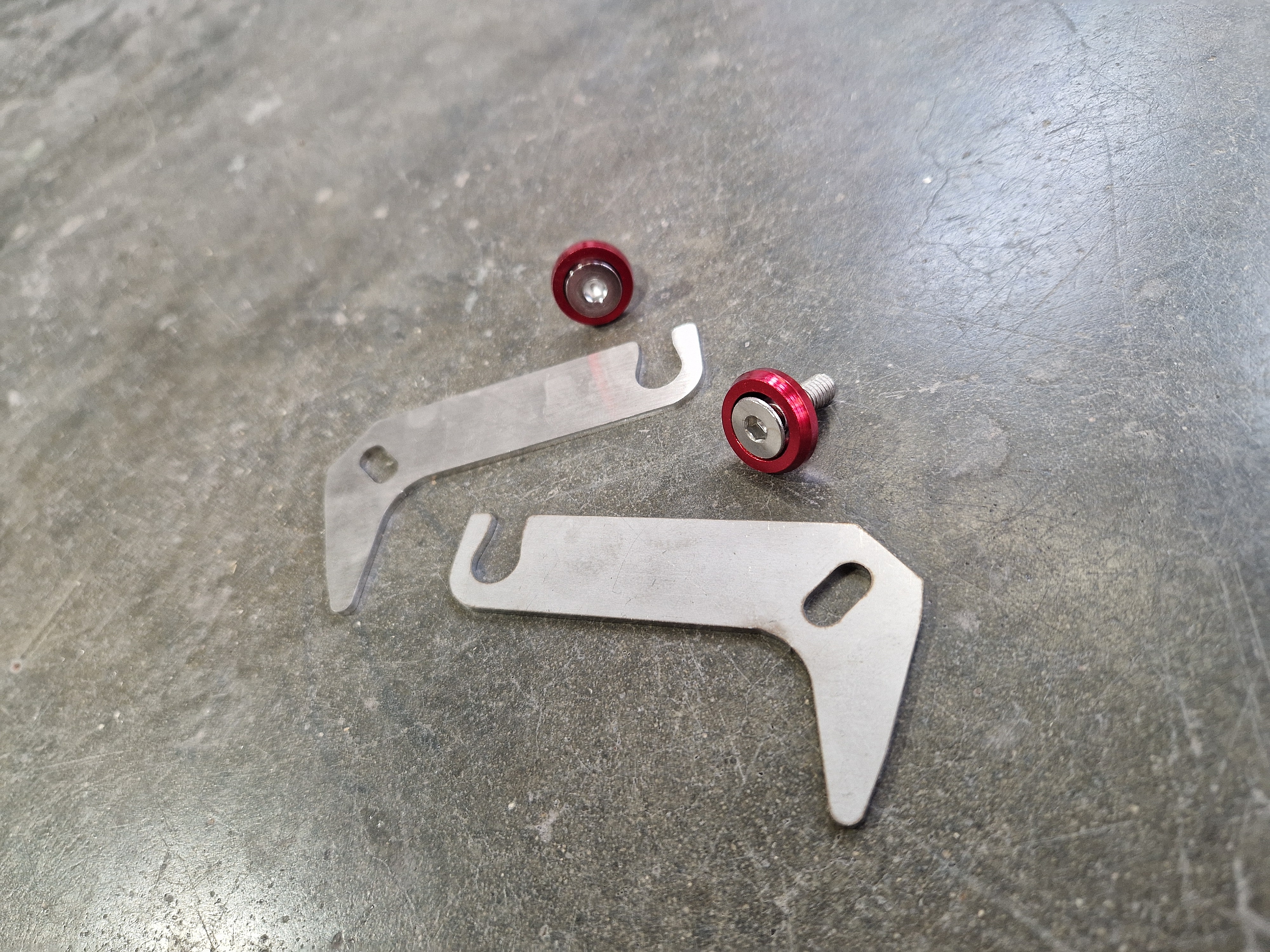

As I plan to refit the seats once I'm back, I will order some hex head bolts to replace the torx one. The one closest to the dash is fine as the bracket is U shaped so just slides in, but the back bolt will need replacing. I've cleaned the threads and temporarily fitted some bolts in place with copper grease, just so I haven't got exposed holes for the trip.

I think is more a different camber, and not a wider track, or?
Your posts are always the ones I love to read, always!!
Quite possibly mate as the BC top mount allow for camerber adjustment, whereas the PMS are fixed and the caner is adjusted via the hub parts on the coilovers. But it was definitely noticeable and not in a good way. I like a little "tuck" when I fit spacers to make it more OE looking but this was more than that.

For the record though you don't need to remove both torx holding rear bench in the middle, one is fixed and the bracket is open that side to just hook under iirc

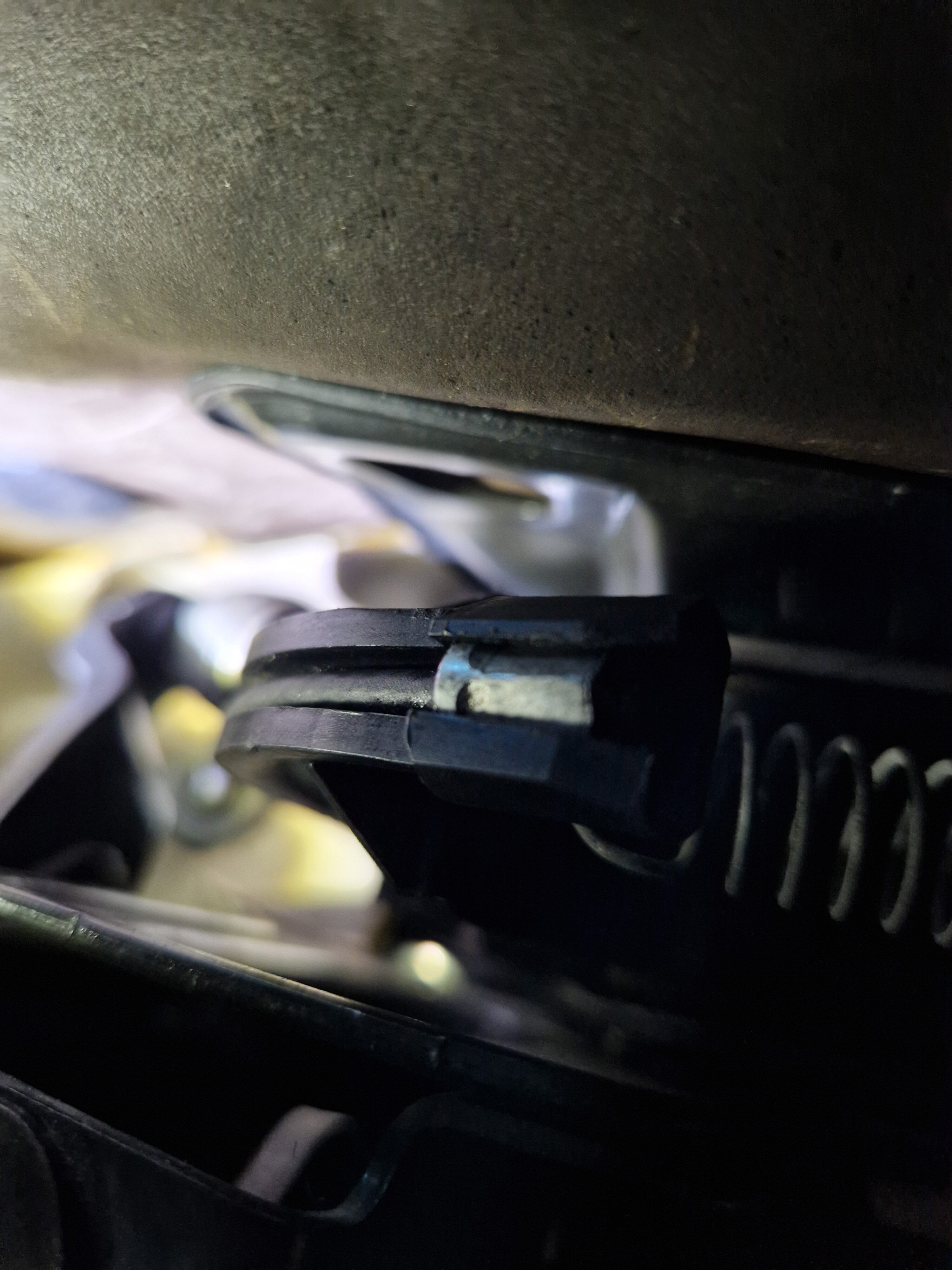

I've got rear caliper issues too, must be an age thing, mines the handbrake mech on the drivers side has totally seized up, cannot for love nor money get it to shift so I'm just getting new calipers which I'll fit to the oddy then the RB can have the ones from the oddy which are fine

Yeah I did know that about the torx and bracket being slotted. In fact I may have just done it a 1/2 turn just so it wasn't butted up but it's minimal. Ots always the one nearest to the boot that gives most issues.
