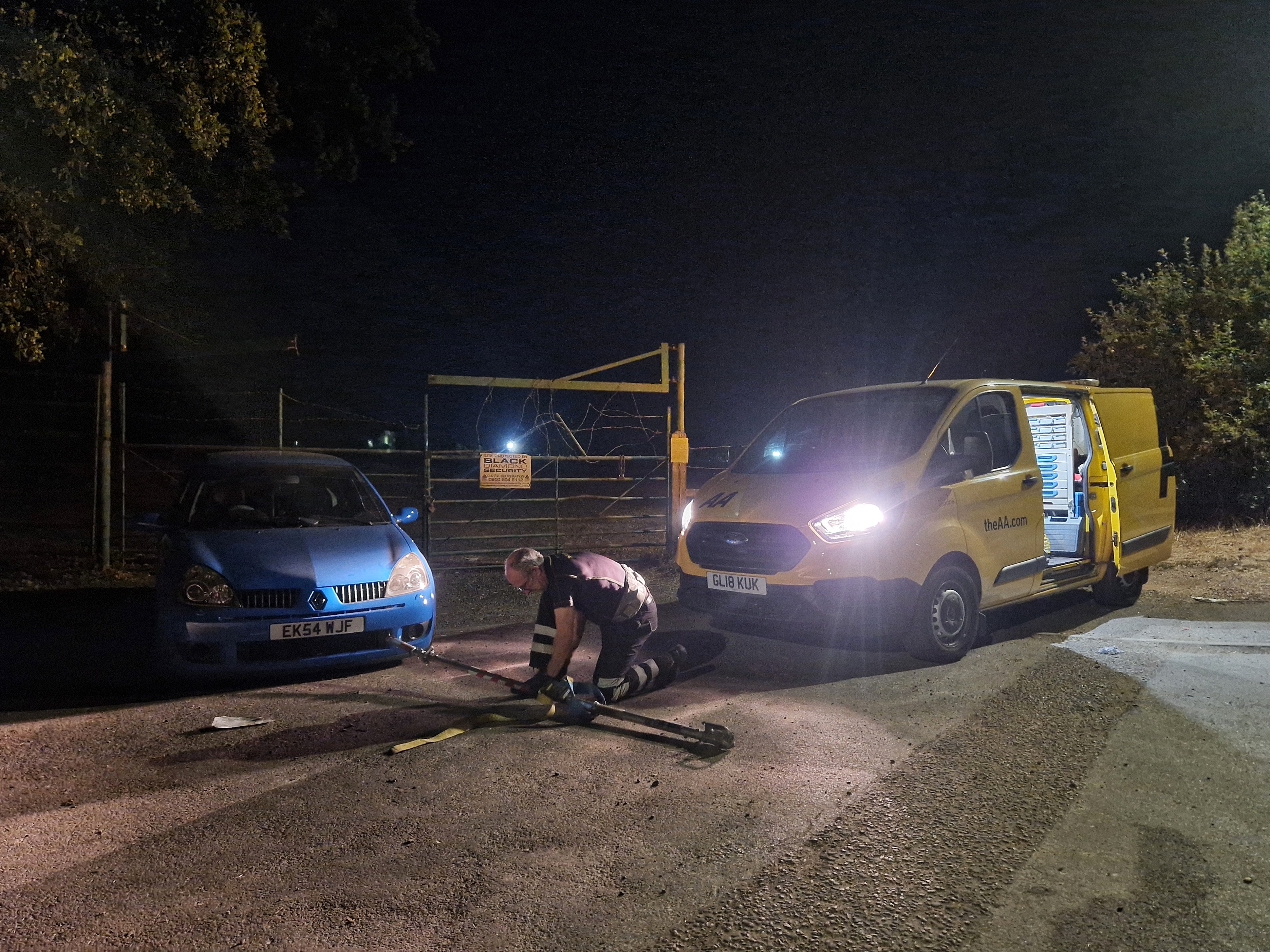

Lucky with that aux belt, mate. Could have gone while the engine was running and spat it into the cambelt.
Do you have the plastic splash guard behind the front grille fitted? They protect the alternator from excess water ingress.
Very lucky really as I planned on leaving about 2 mins afterwards.

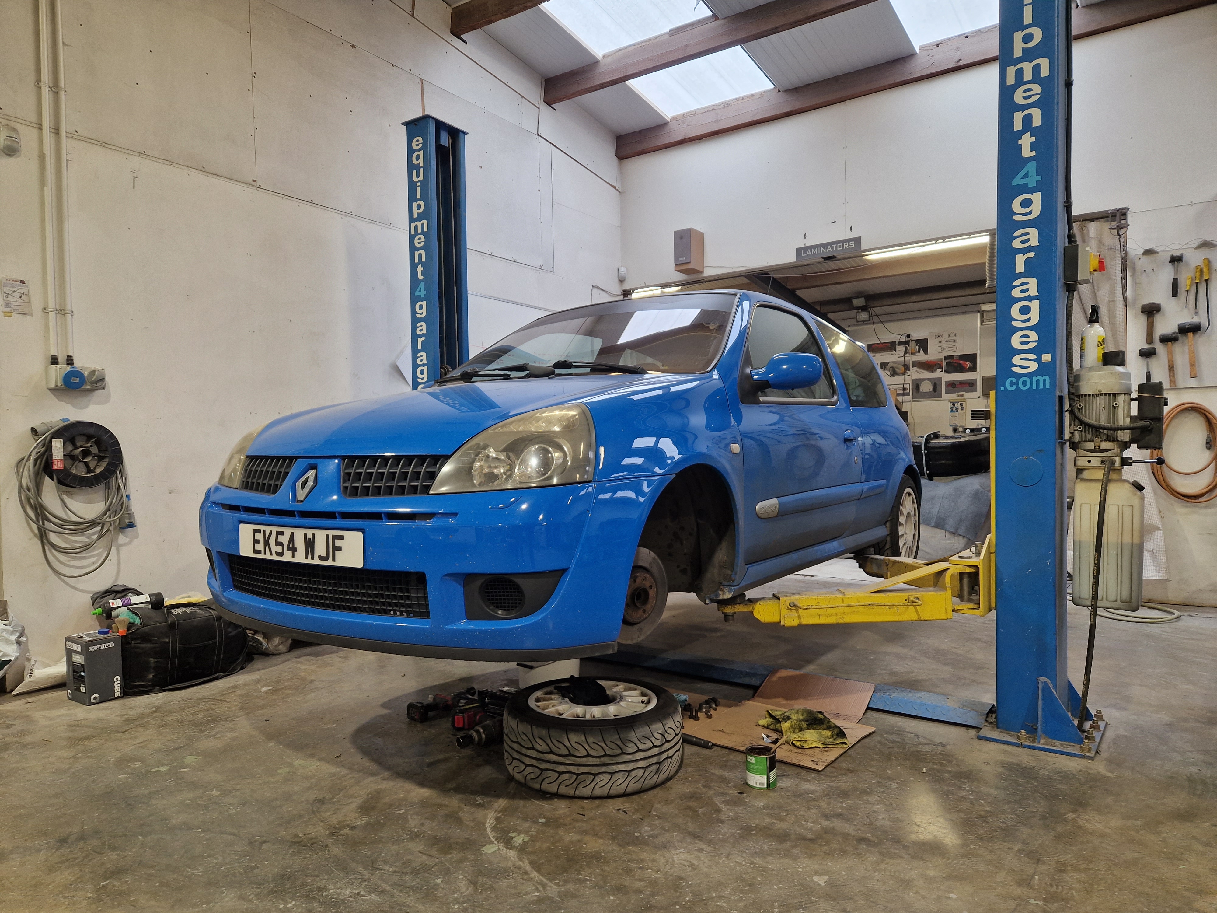

Went to go work one morning to find out my front tyre was completely flat. I couldn't check it there and then, so I took wife's car and investigated once I was home. Found the source.
Got it repaired at a local kwik fit. They charged me £30. I was a little taken back as I didn't think puncture repairs was that much. I think I was expecting half that but just goes to show that everything goes up and/or im out of touch!

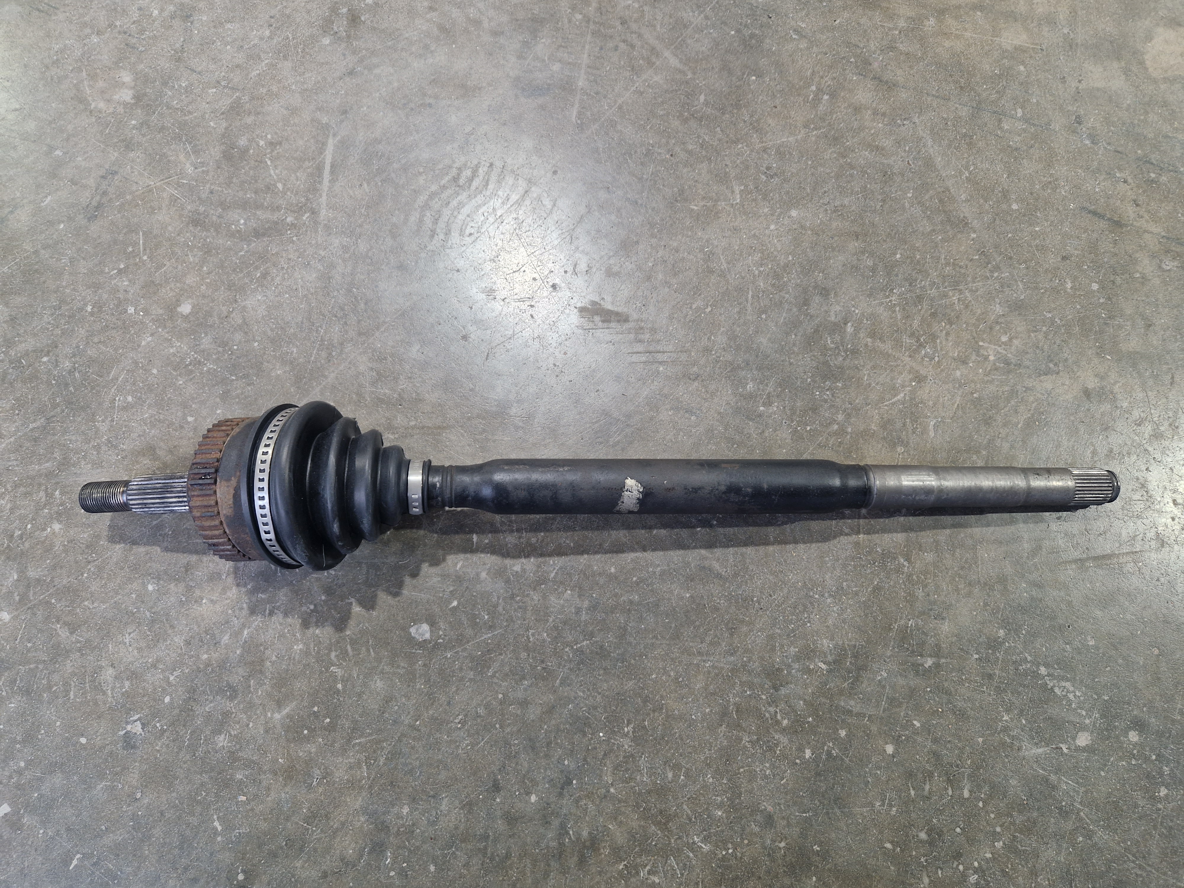

Anyway, while the wheel was off I noticed the outer cv gaiter was split. Took the car to work and ordered the part. I planned to fit from the gearbox end and slide it on the driveshaft once it was all removed, but I had to remove the inner gaiter first and I couldn't see a way to do so without ruining the bearing. So I had to order a new one of those too! It wasn't a hard job and because all bolts/splines was copper greased, they all come off pretty easy. I kept the gearbox oil, draining it into a clean bucket and resued it once it was all back together.

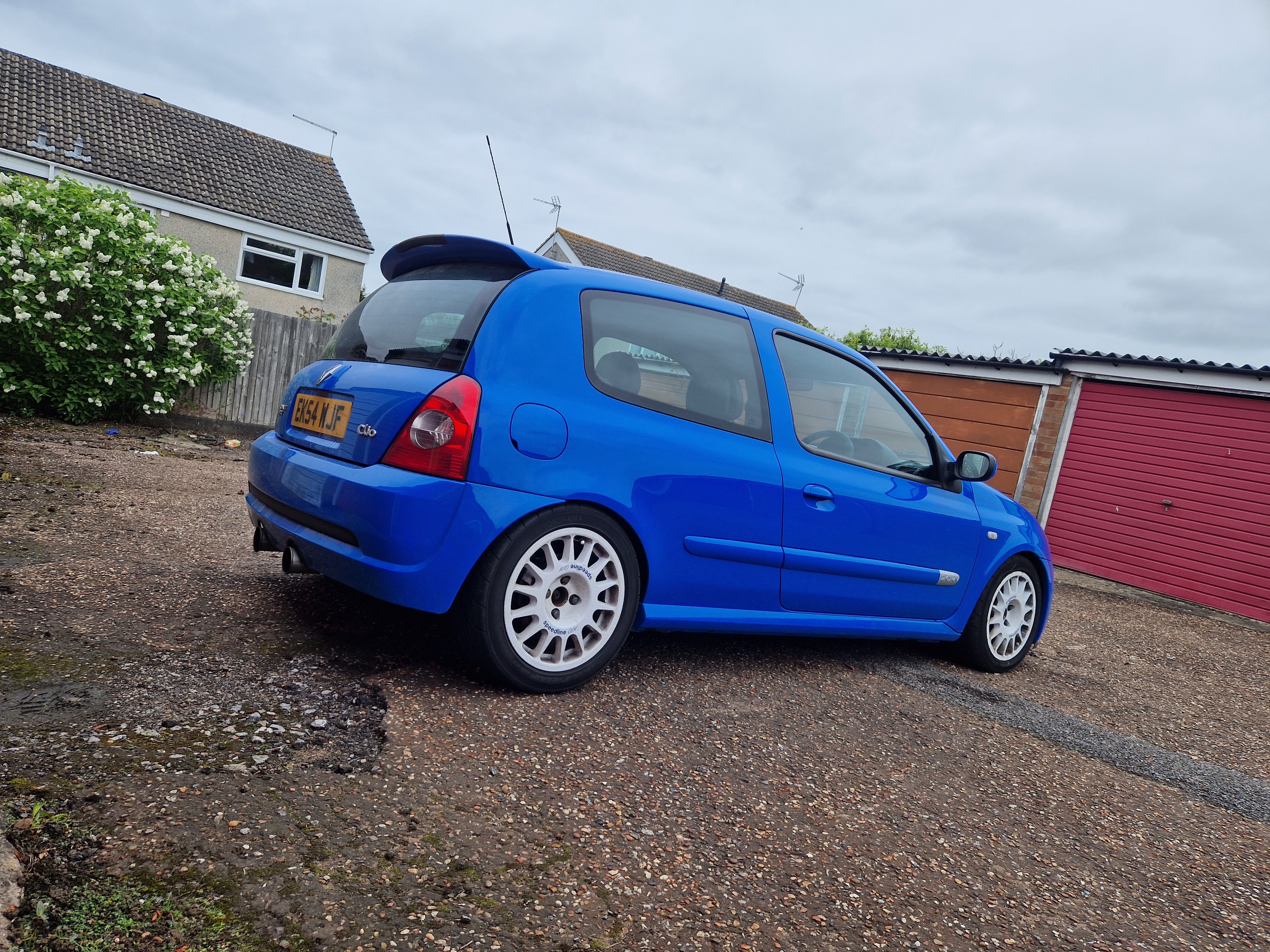

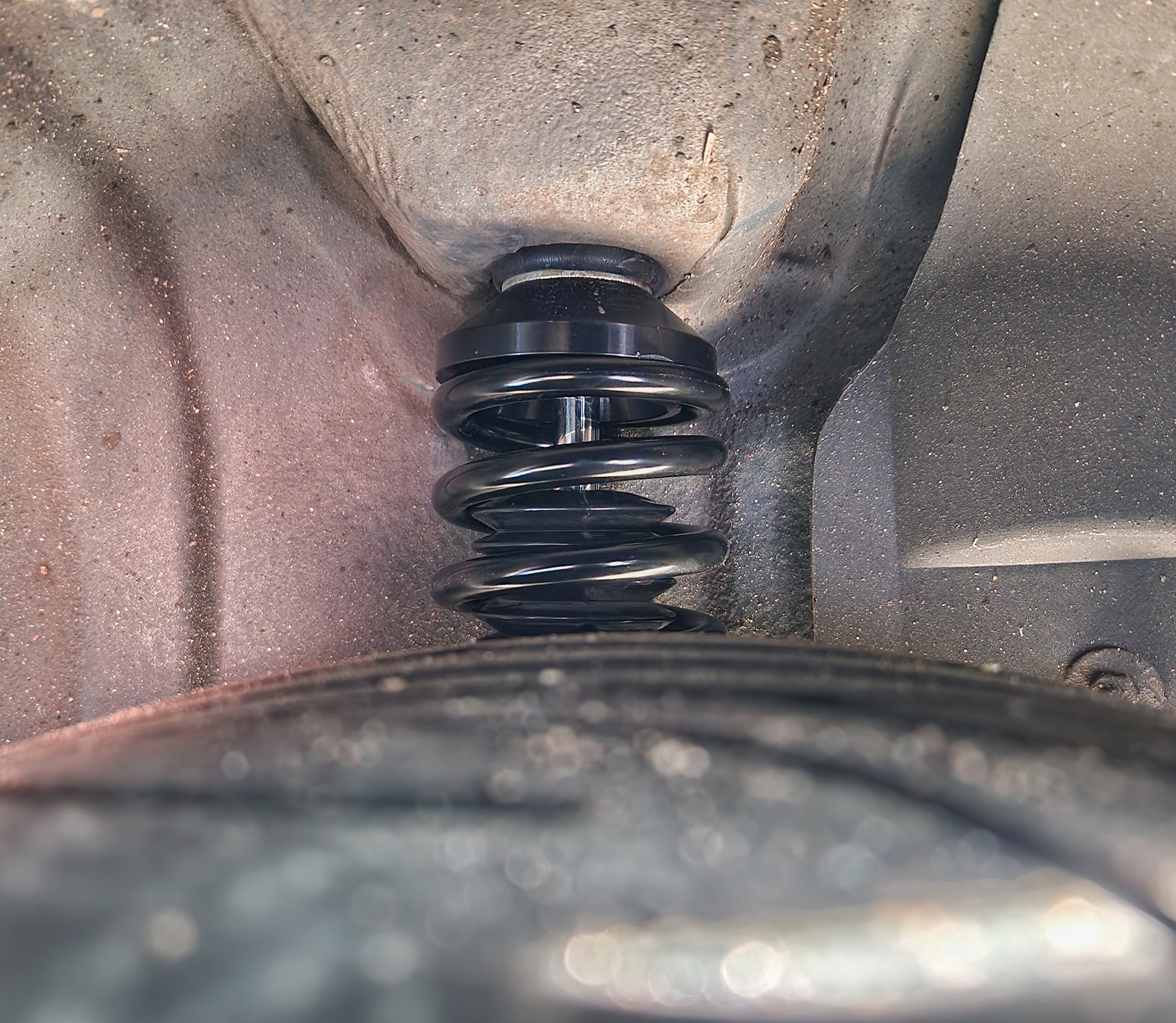

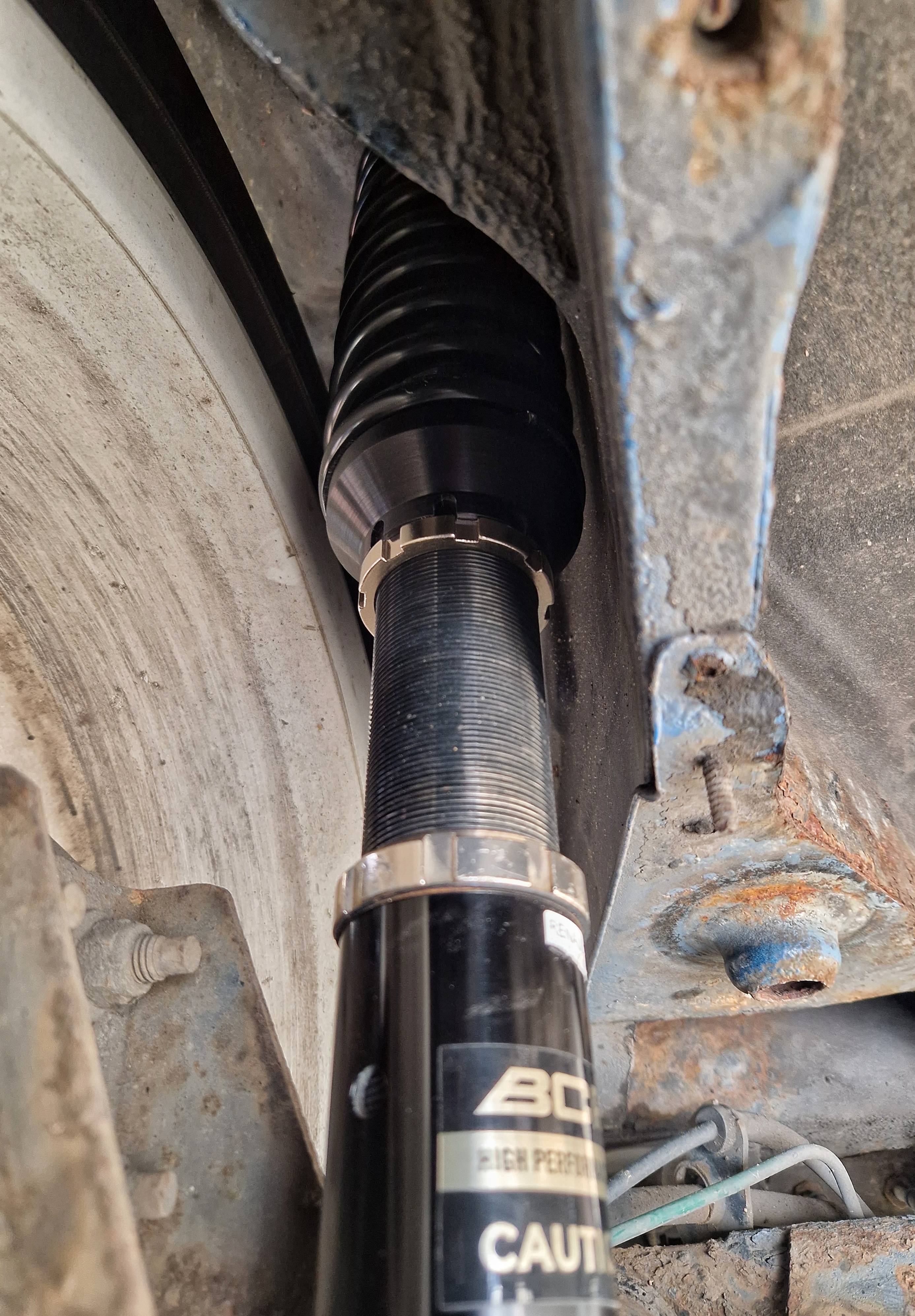

I did notice that since fitting the BCs, the track was wider. I was running 16mm front spacers before with the Bilsteins and it looked visually bang on for my liking, but it sat too far out with the BCs. It looks like the part where the hub mounting holes are, is wider than the Bilsteins, so wondering if it pushes the hub out more? I'm not sure why, but it definitely stuck out further, so for the time being, I'm now running no spacers at all. I've also reverted back to standard wheel bolts as my stud/nut kit was too long as they accounted for the previous spacers.
The pic doesn't really show how far the spacers stuck out, but it was too much for me. I'd like to add a 5mm to 10mm spacer just to give it a little extra but the 10mm one I'd have to get machined whereas a 5mm is off the shelf. Plus being 10mm, I'd lose a bit more hub lip. I'll do some homework at a later date and once the spacers are fitted, I'll order some new stud/nut kit to fit once the measurements are figured out.

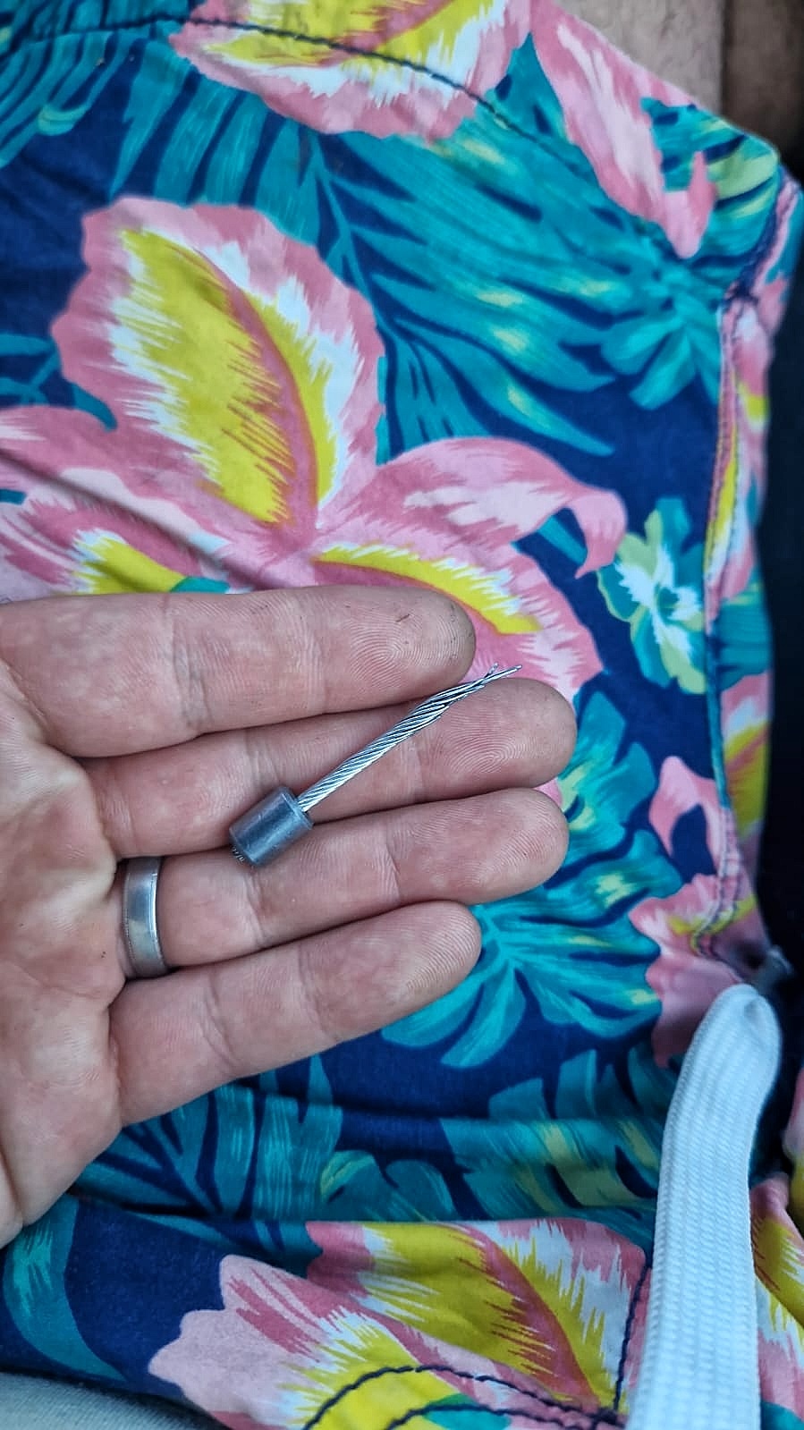

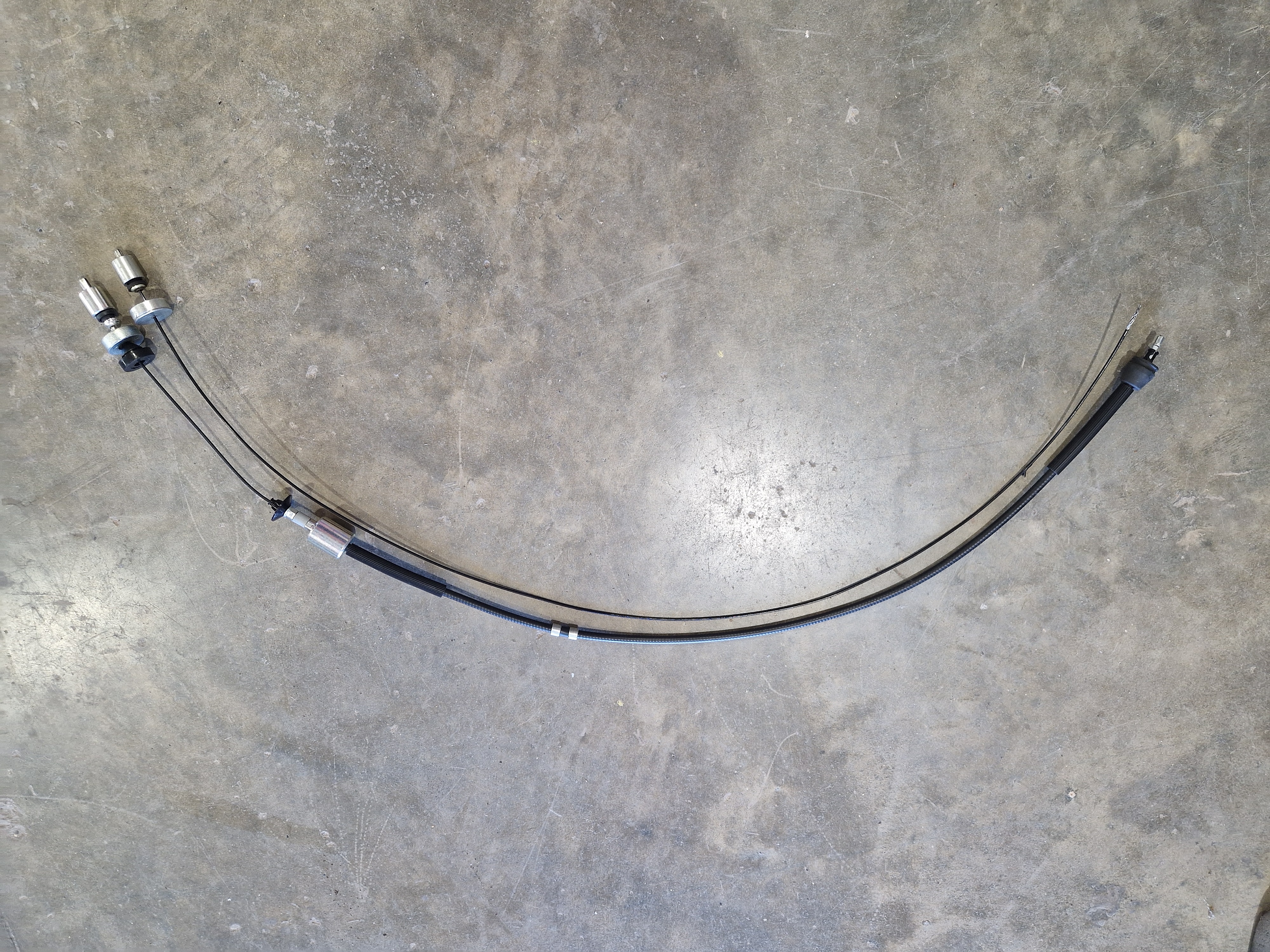

So once the coilovers was fitted, I did 40ish miles and all felt good. I had a day out and when driving back, all was good and I was coming up to a roundabout. Engaged the clutch and bang, clutch pedal goes completely floppy. Coasted over the roundabout and managed to ease into a lay by I knew of. (I'm approx sub 10miles from home)

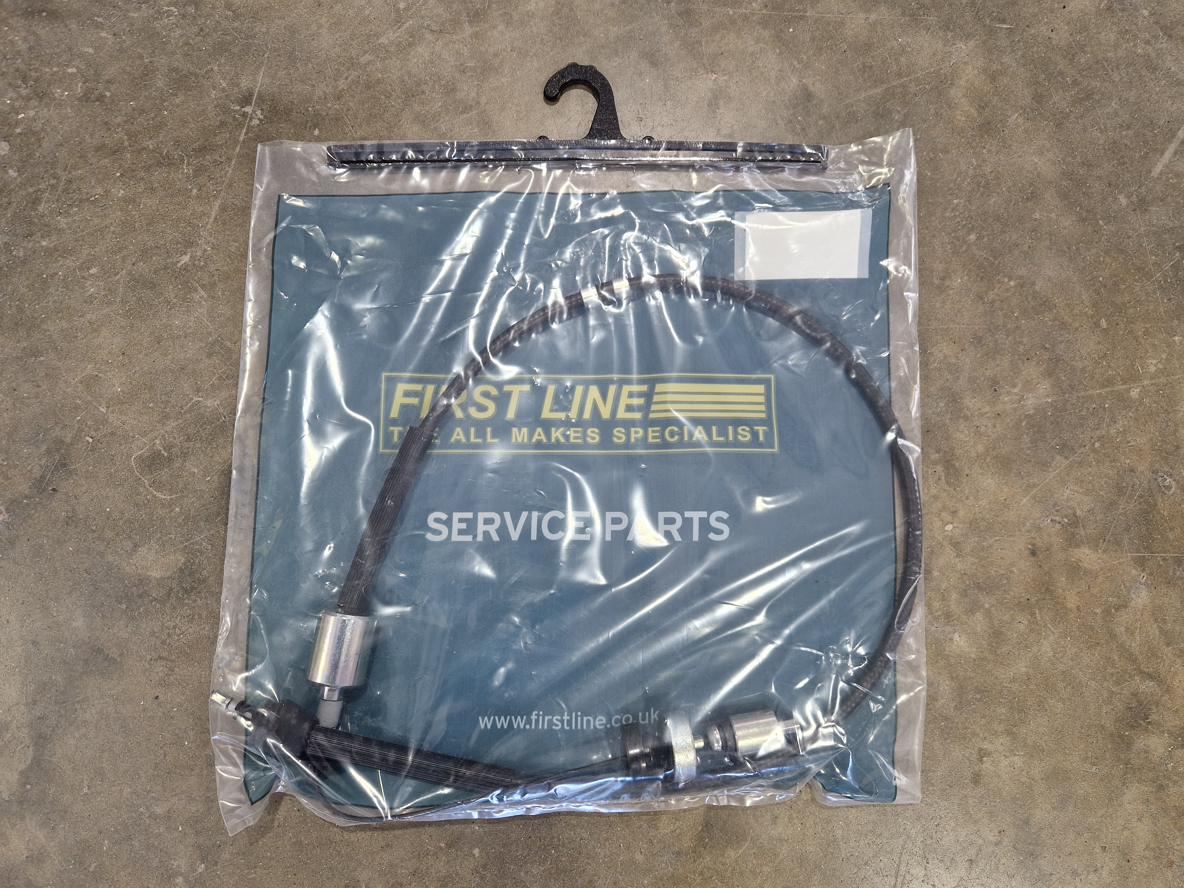

Had a little nose around and turned out my clutch cable had snapped. This pissed me off a bit as it was a brand new genuine Renault item bought and fitted last year. But alas, it was broke and i was broken down. Called the AA who we are with and the AA man tried making a cable in situ, but it was dark and late, plus he was at the roadside so was limited. Basically I ended up being towed, but work was only 10 miles away so he took me there and I had wife pick me up. (The funky shorts was because I was coming back from a day at a outside park and paddling pool! 😅)
View attachment 1611399View attachment 1611400View attachment 1611401
Once i was back at work the next day, i ordered a new cable from our local motor factors. Ordered at 8:30am and delivered by 10:30am!

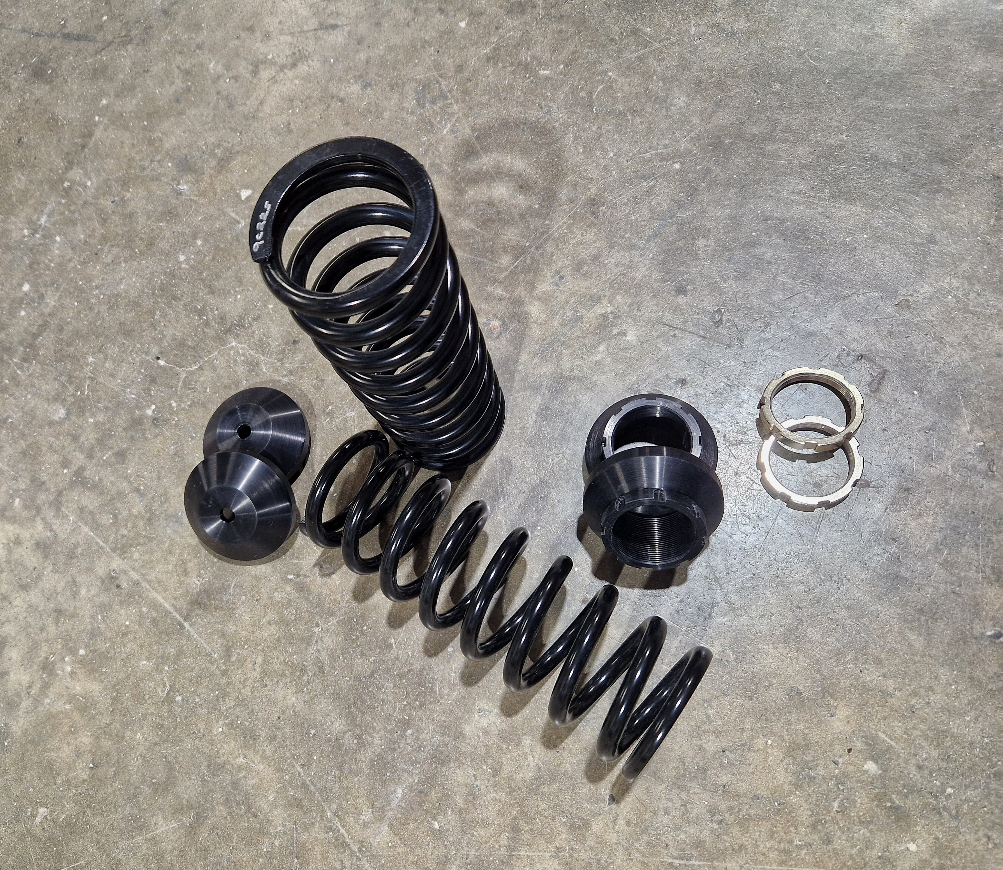

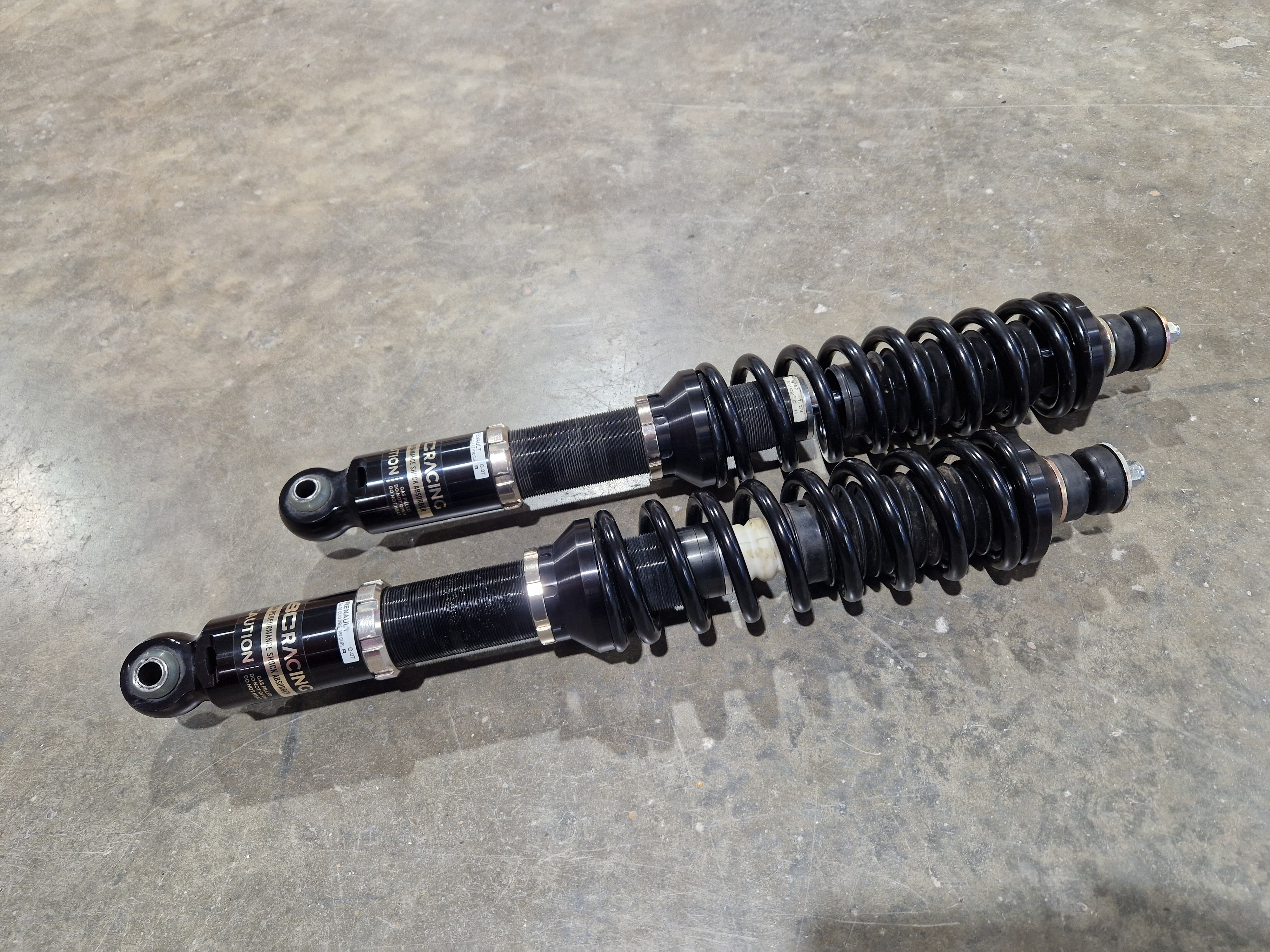

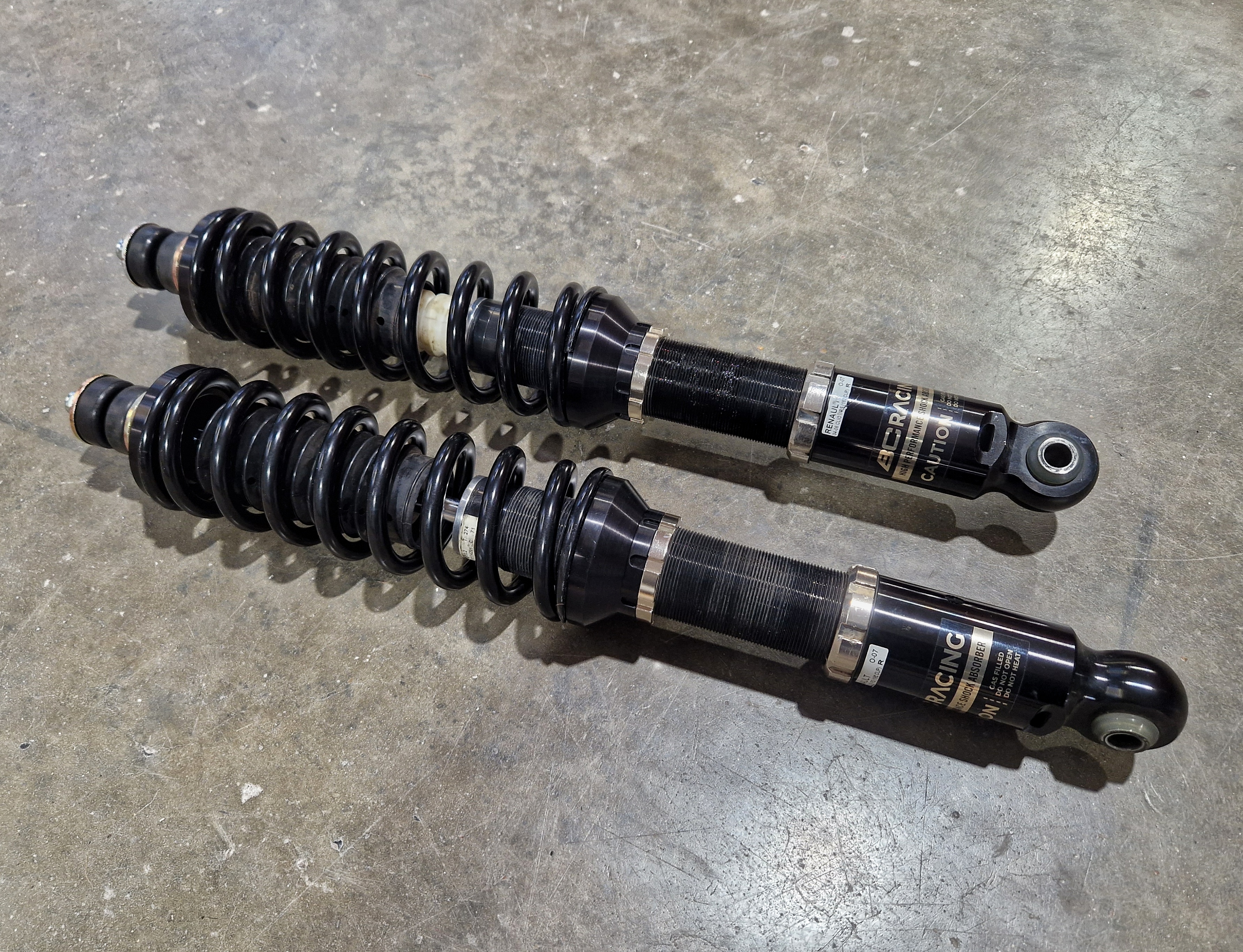

Once back from Scotland i started to look at a kit i had my eye on for a while. One thing that prompted me to buy the BCs when I did was a found a chap that made conversion kits for the rear shocks to make them a full coilover. In fact I had a picture saved of his kit months before I made the purchase.
Once I was back from Scotland, I decided to drop him a message and get the ball rolling. Now I'm not saying the BC separate shock and spring on the rear is bad, it's not. But I like the idea of full coilover units and im led to believe that it'll handle better still.

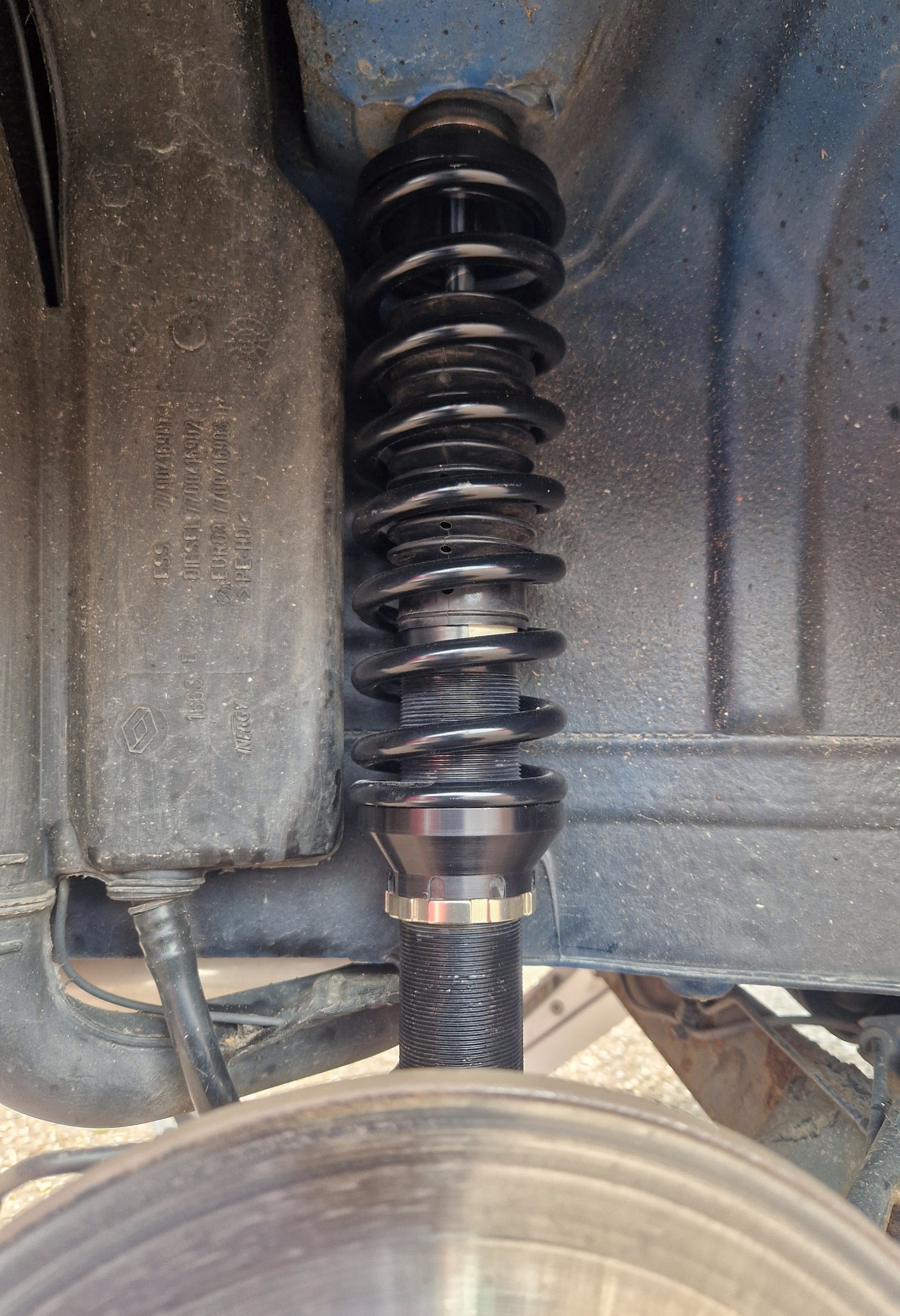

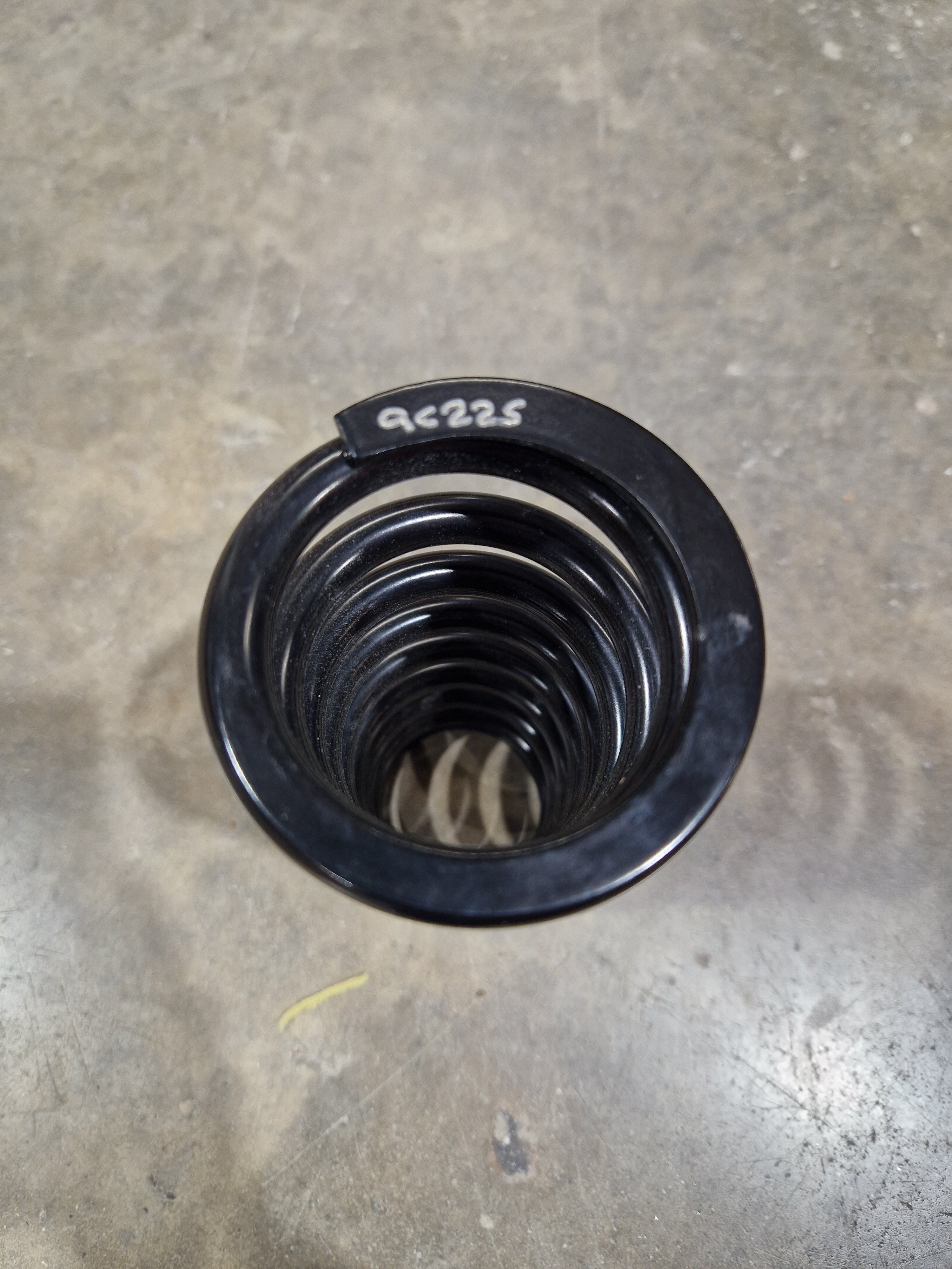

A few messages back and forth and I ordered the kit. I opted for a 225lbs spring on the rear as its still a daily. This is what I had on some gaz units I fitted years ago. I was I. Between 225lbs and 250lbs but glad I went with the softer of the 2. In fact I contemplated 200lbs after fitting but I've decided against that now.
Turns out the seller is a old member on here but not sure how active he is @Hutchie
Ordering was easy, well communicated and descriptive. Parts arrived quickly also. Once they did arrive, I got them fitted and played about with the heights until I was happy and took it for a test run. They do look snug in there but they clearly everything so all is good. Its definitely stuffer on the rear and feels more flat. A old purchase I think 👍
