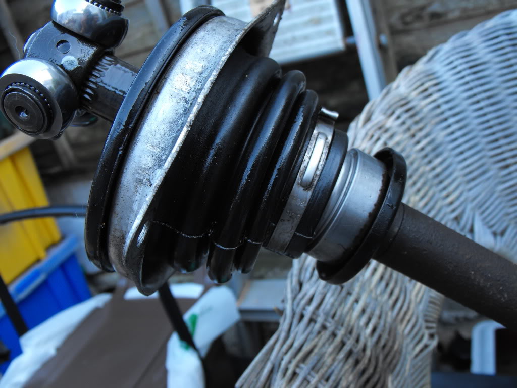

Quick pic of the gaitor, is it suppose to be like this?
im pretty sure the small side is suppose to be stuck to the shaft everytime, and its were people use jubilee clips instead, then the rubber gaitor stretches and bolts to the box,
Have i got it right?
I think the smaller end is meant to be pushed right up to that cap on the right, not sure, dont remember it looking like that though.
When its actually pushed into the box, the rubber boot doesnt stretch that far, it doesnt need to go as far as the end.
As long as its tight and doesnt leak then I suppose it doesnt really matter.
Ye thats the thing, in that picture i couldnt push the small rubber part right to the end, but when you looking at it, if it doesnt reach the both ends then clearly oil will flow out which i think thats what's happening on mine.
Il test my theory tomorrow with a new, jubilee on small end then stretch the boot and bolt it on :)
