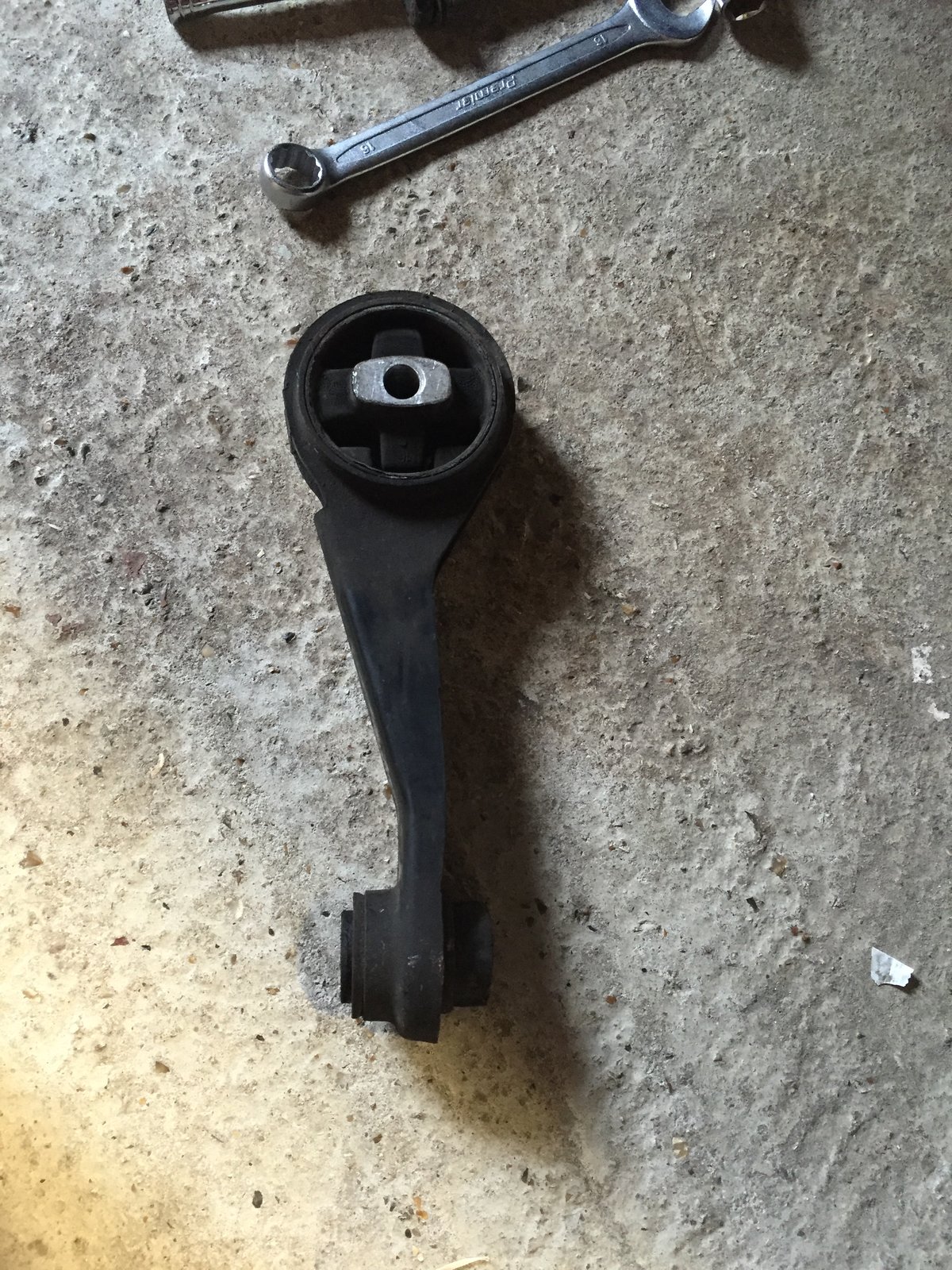

My dog bone mount is truly buggered. Iv taken it off and it isn't one of the twisted type. I'm taking the mount to engine dynamics just down the rd tomorrow. There going to supply and fit the poly type bushes to the mount for me.
Will they fit?
Is that and aftermarket mount not standard?

182.. Just had a loom on engine dynamics site and it seems my car is fitted with a phase 1 dog bone mount.
thats not a ph1 mount, the ph1 has a really short one with the bushes the same way and a metal bracket bolted to the gearbox, it looks like a cheap replacement ph2 mount
To be honest it'd probably be alot cheaper to buy an Evol mount with the polybushes already installed and then have the garage fit that, it'd only take them a couple of minutes on a ramp.
Plus you wouldn't have to worry that you've fitted polybushes to some s**t mount
