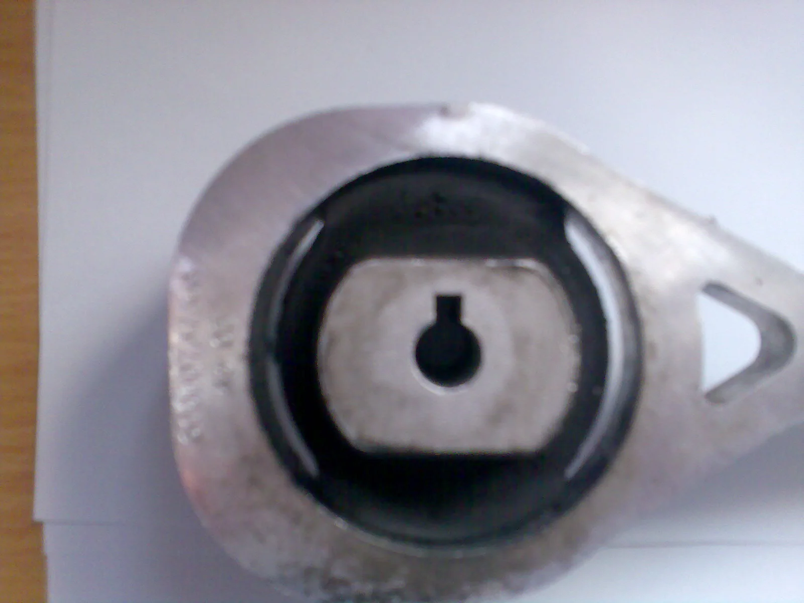

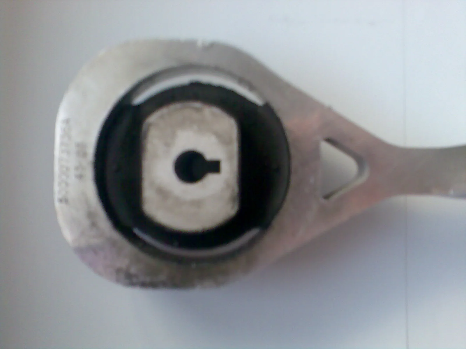

After trying to find a solution/compromise I took off the std mount (first pic) and turned the big bush thru 90deg (2nd pic), to do this you need to spray penetrating oil or wd40 around the edges where it fits in its mount so you can then turn it. Do this carefully so as not to damage rubber hence the need for oil allow to soak ,also you will need a bench vice to clamp the bush and carefully turn the mount 90 deg and make sure is central and square to refit .
Std bush position has gaps either side to stop vibration but when turned thru 90 deg these are at top and bottom and solid rubber is against moving direction points of bush .
See attached pics to try and explain.
This greatly reduces engine movement and improves gear change BUT because rubber is softer than poly it does not give you the vibration on idle that a powerflex bush does .( you will get a bit of viration on idle when you first refit it this will go after a week or so as the rubber softens) I have done this to mine and is a great improvement to std without the vibration of uprated bushes .
