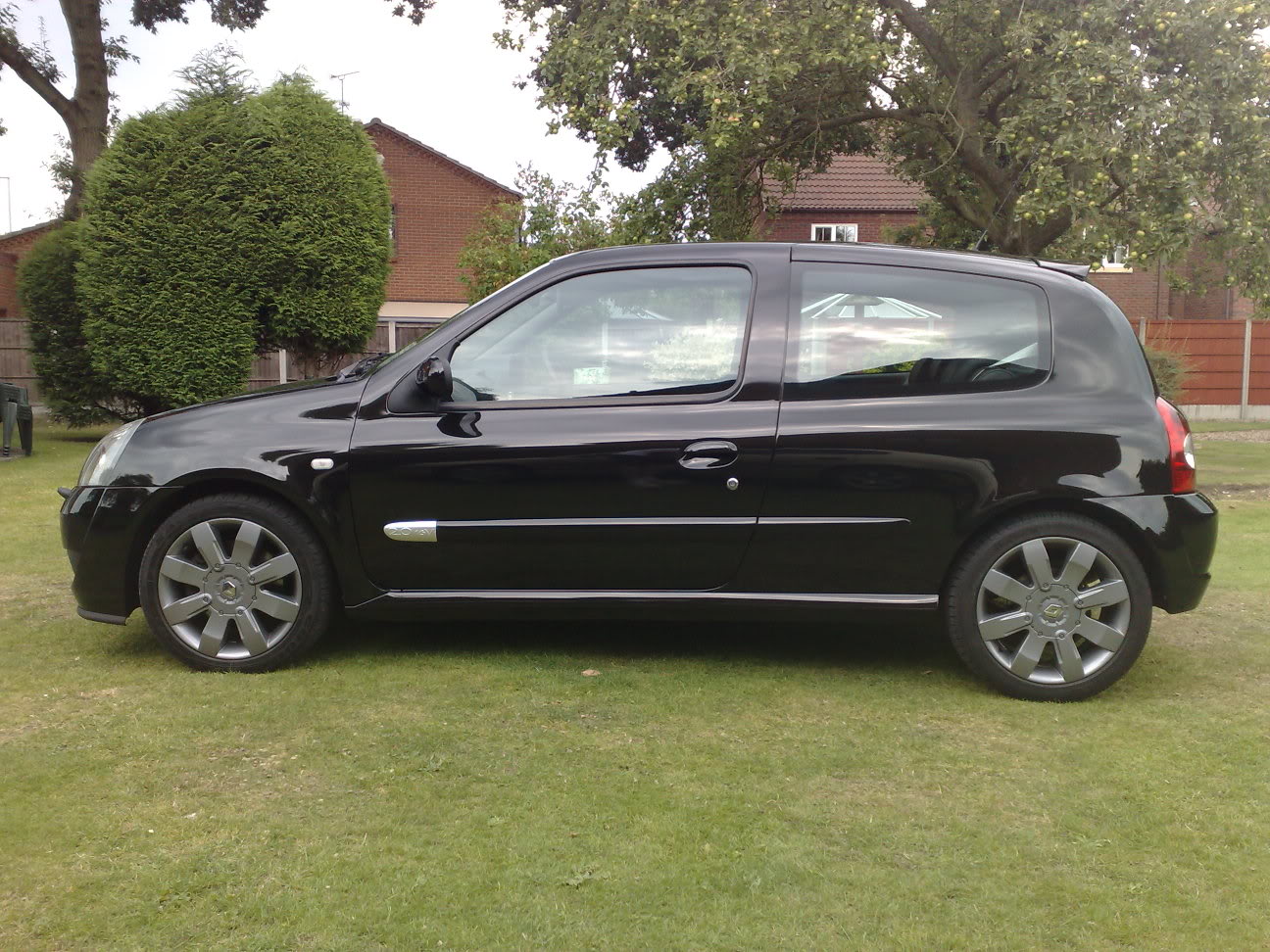

Dont know if i have cup model or not
Car  Renault Clio Sport 182
Silly question but how can i tell which model i have?
It doesnt say cup in the log book.
The reason i am unsure is that my mates 182 has a slighly diffirent spoiler and i have the grey alloys.
I also have the michelin pilot exalto tyres, are these on all clio 182's or just the cup?
thanks
Do you have a leather-ish seats or fabric? Is your spoiler larger than your friends? Best way is probably to call a local dealer and get them to find out which options were fitted when new.
Its black.
Thought the wheels were the giveaway on the Cup suspension front?
Silver for non Cup pack, anthracite for Cup pack
You can tell if it has cup suspension by measuring the space between the two bolts on the hub that hold it to the strut. 60mm means cup suspension 54mm (or 56 can't remember) means not cup suspension.
+1. Could be anthracite wheels without cup suspension.
Definately not a cup because its not Racing Blue or Inferno Orange.
Its a 182FF unless in the very unlikely situation where it didn't have the handling cup pack then someone added the antracite wheels.
