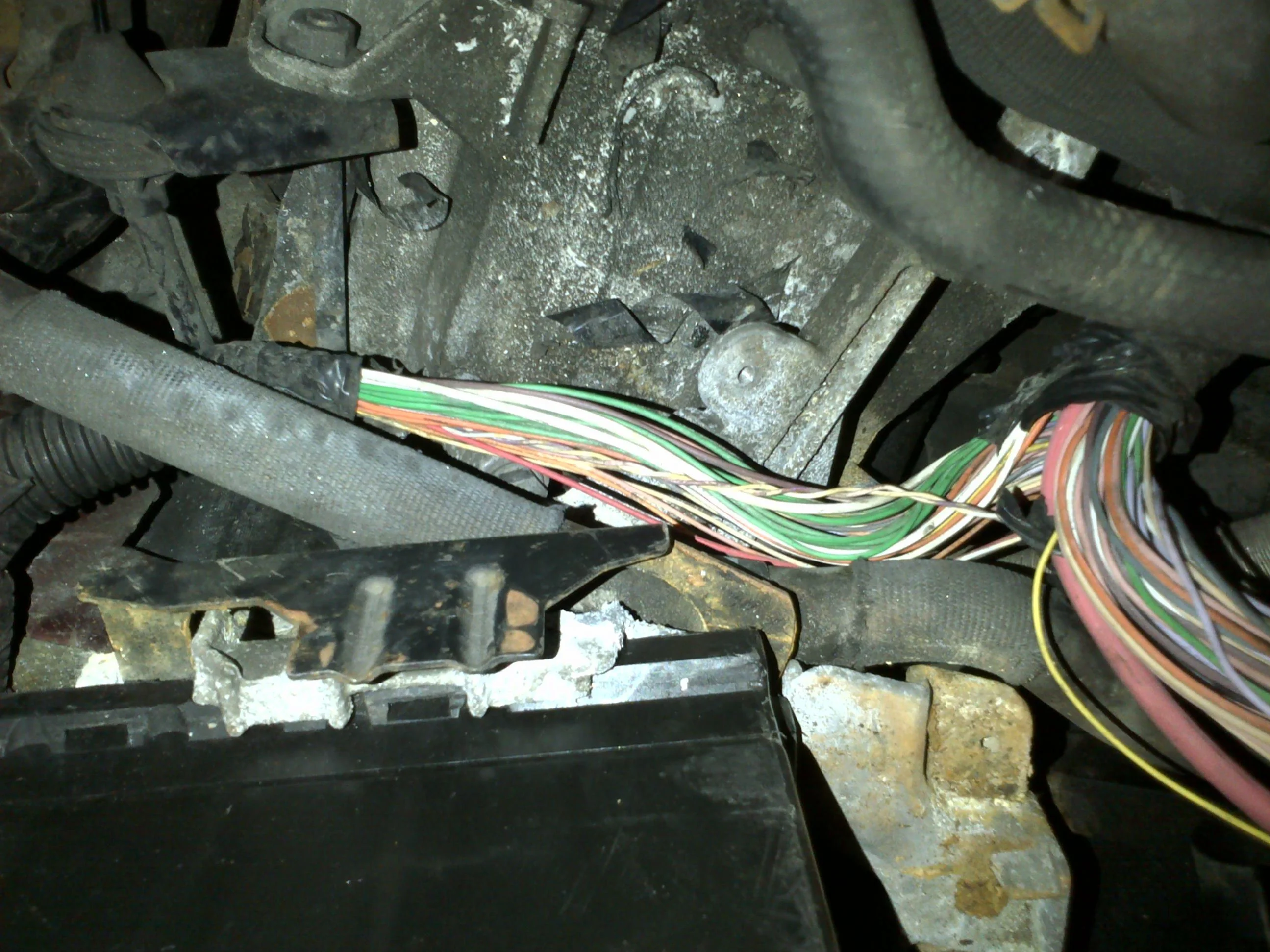

Not really; you're looking for damaged sections of wiring in the wiring loom around the gearbox area. May be a power or earth issue also.

I take it we're looking for the purple and (i think) grey twisted pair can-bus link over the gear box?

When mine did this it was the earth strap from the gearbox to the wheel arch. Mine was really badly corroded and had almost fallen apart.

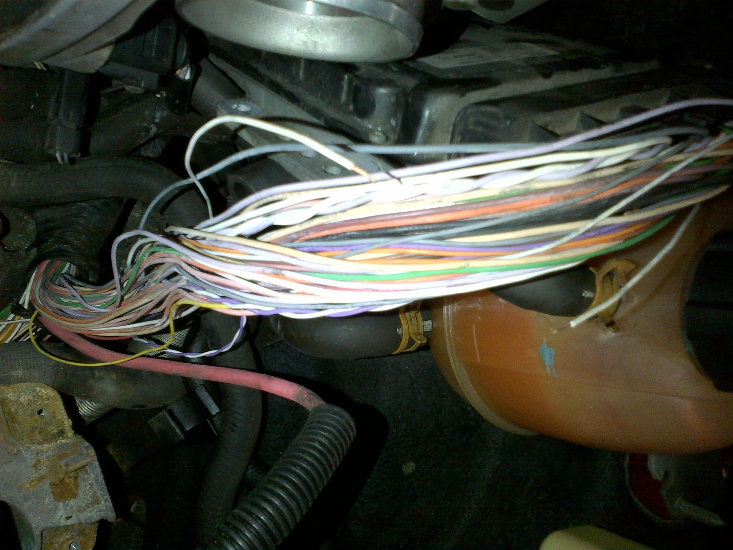

Did find this wire broken....
Small white wire near the ECu end but solder and sealed and no difference... not even sure what its for :(

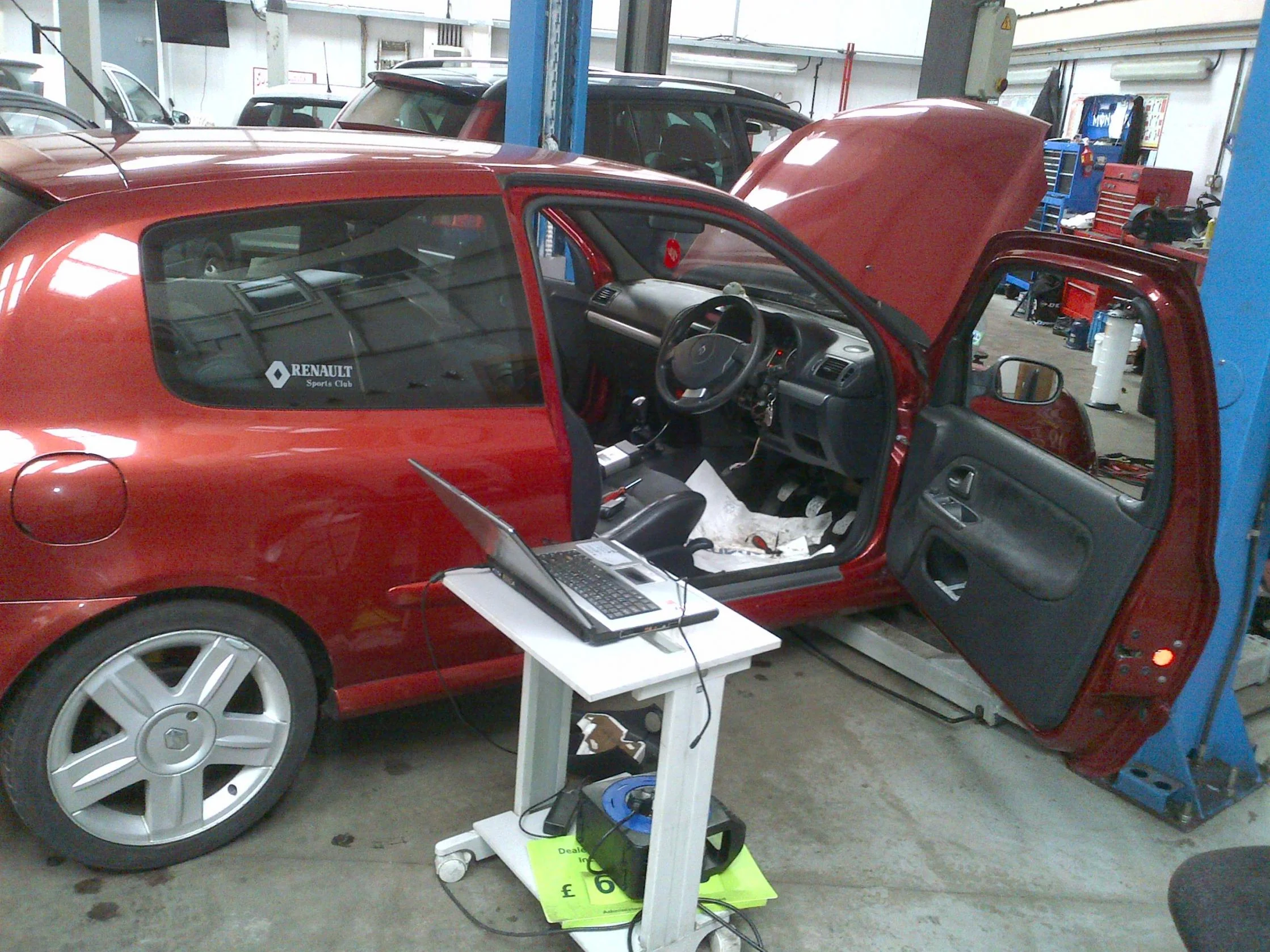

Right then....after being in work on my day off checking every fecking wire in the engine bay loom and the uch to ring decoder.......
it looks like the UCH is indeed FUBARD

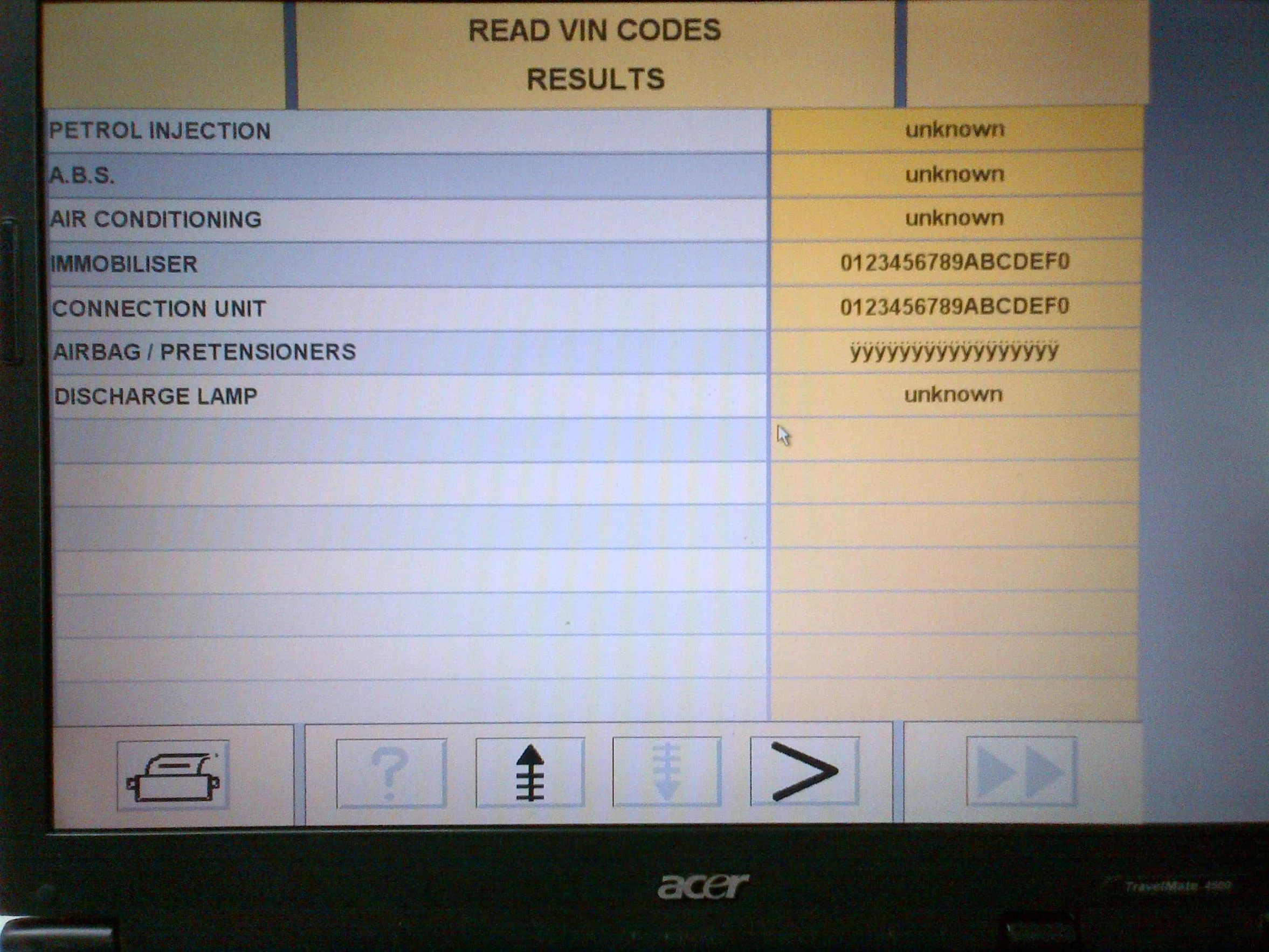

I should be getting the Clip to read the VIN straight from the UCH when I go into the diagnostics....and it doesnt
And looking at the codes above they should also read VIN numbers not 12345ABCDEF ( IE fubard ) The Air bag ECU has been reset at some point hence the ?*?*?*?*?* code but thats nothing to worry about.
If anyone would confirm or deny that the UCH is goosed before i go and buy a 'set' please do.....

It looks/sounds like its missing multiplex information to me hence the missing ID's (I've got a Megane II dCi in with similar problems that had a UPC after water ingress that started once and then after parking up hasn't gone again since).
I assume you've confirmed the UCH and ECM both have stable power and earth supplies?
Can CLIP start dialogue with the UCH and if so, what information do you get back?

All Earths and lives check out ok, the clip will start dialogue with the UCH and ECM but as i mentioned earlier the VIN codes on both are curroupt. The network map shows everything and everythign is acessible but the comms, injection, and immobiliser come up red.

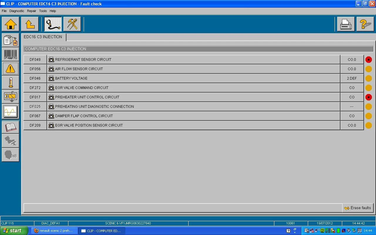

PS just for Micks benefit......Scenic ph2 below....

This is why I have a matched UCH/Key set as a test rig for the common vehicles as it saves expensive guess work.
So if the components you mention are coming up in red on the network schematic it means they've either checked in but have issues or they've not been recognise/detected. Lets forget the VIN's for the time being - What faults, if you can access them, are you seeing on the red modules?
