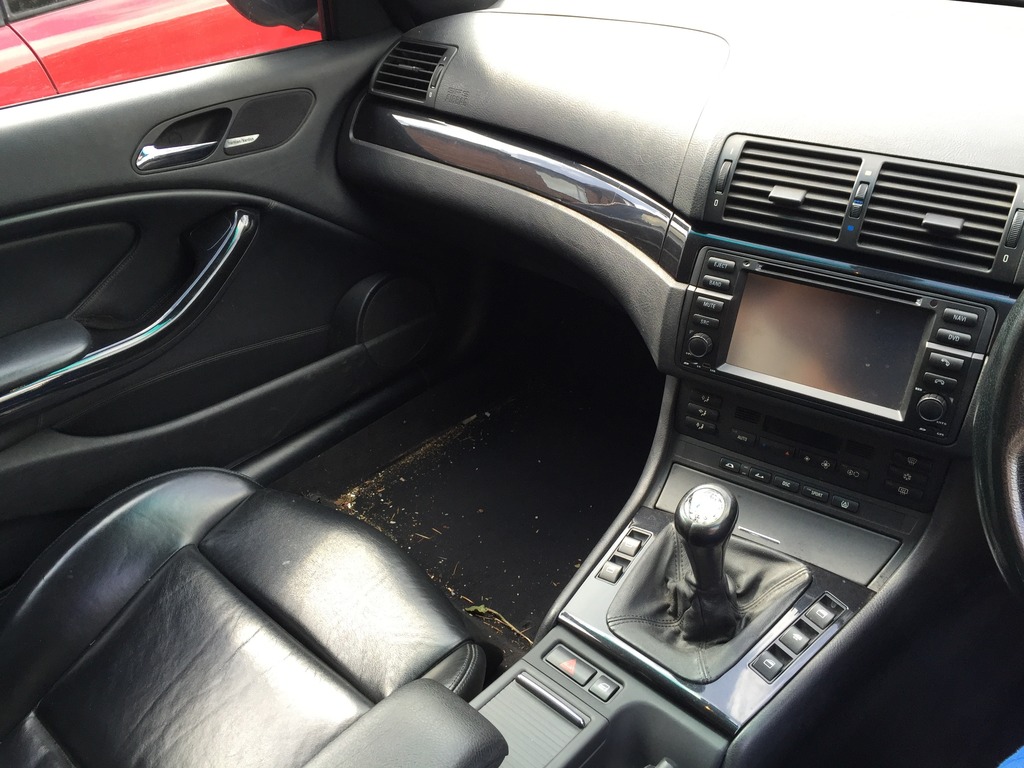

Interior parts turned up so have renewed gaitors and gearknob for alcantara and a clubsport gearknob.

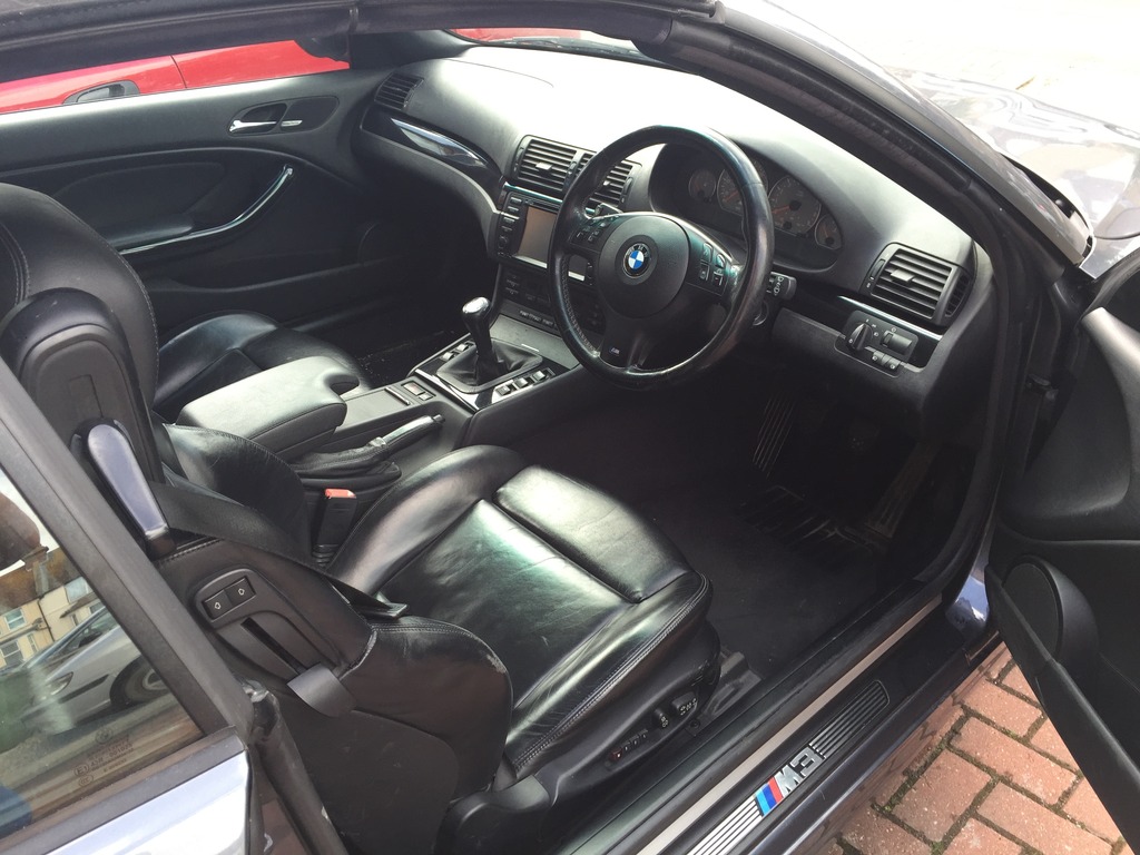

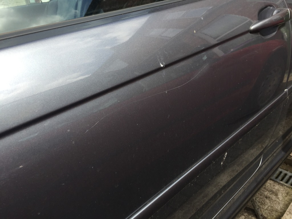

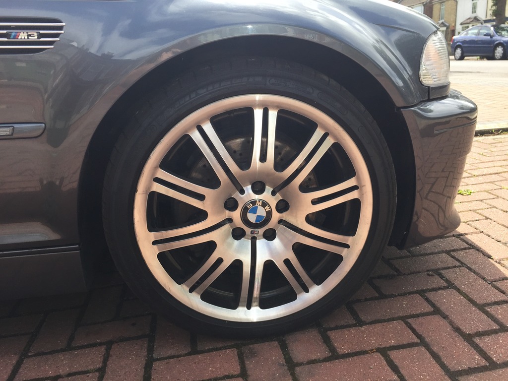

Here are some pics to show interior after drivers has been hovered, wheels and current paint condition, shall give it a clean and assess it properly this week but I have a few scratches, which may require paint. Im handy with a polisher so I’ll see how it comes up after a going over with that.

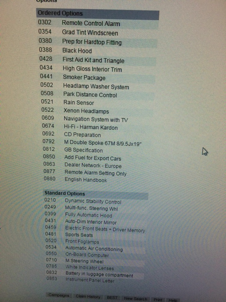

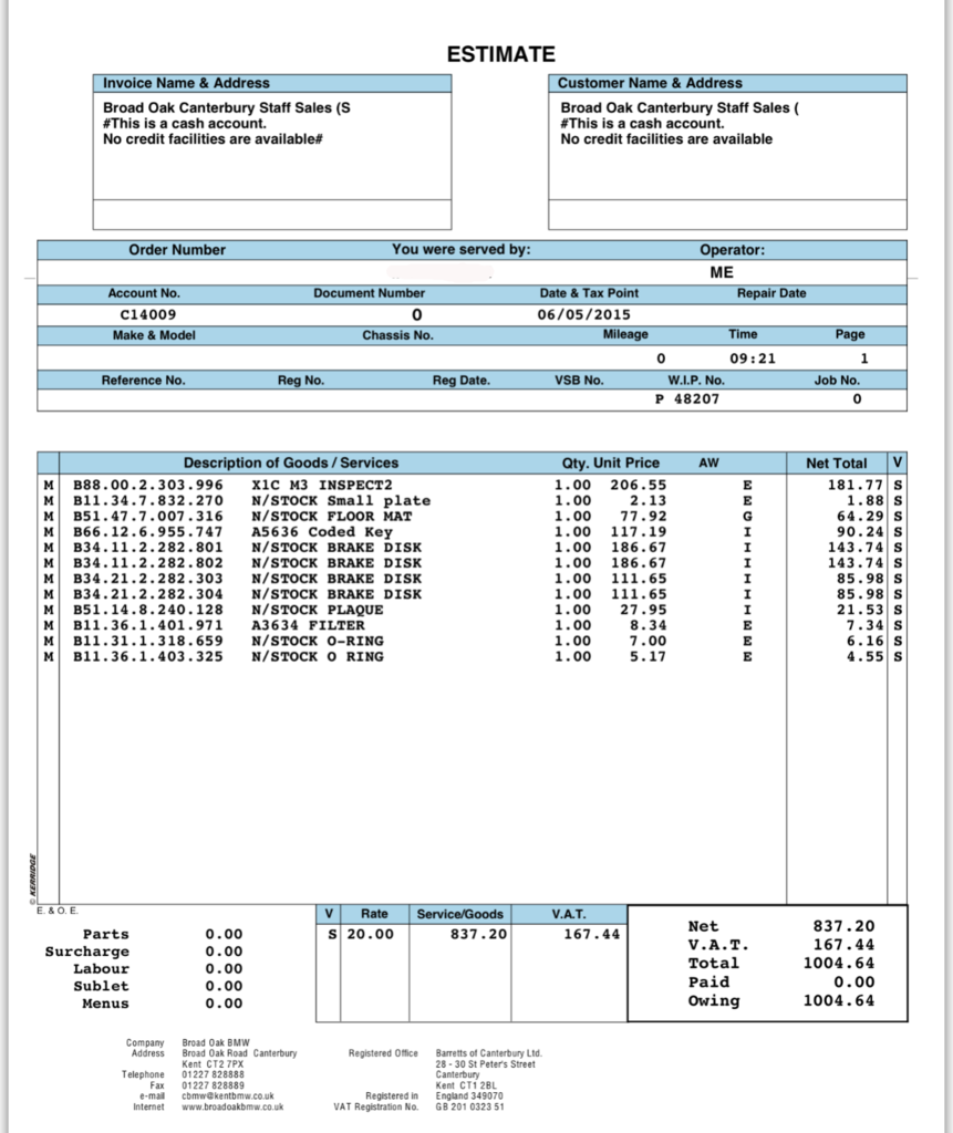

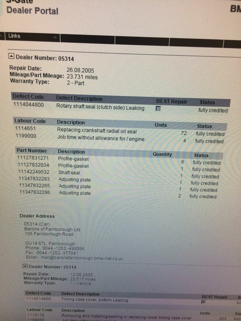

My friend works for BMW so had him price up some parts (none of which have been ordered yet) and check recalls. Looks like it’s due its airbag recall, Conrod bearing recall has been completed.
Inspection 2 service kit is very well priced
Also in there is vanos filter, new ///M3 badge, new key, new mats and discs
Also looks like it does have Harman Kardon, not really tested the speakers but it doesnt sound too great

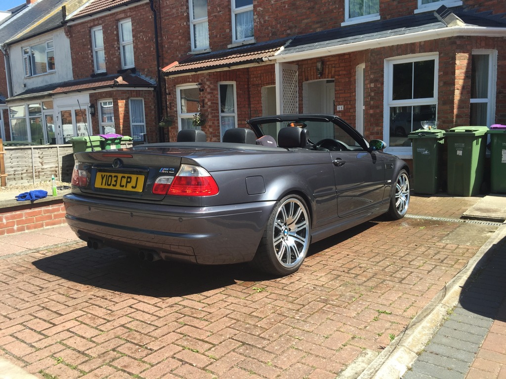

all my detailing gear is a few miles away and i didn't have much time, was that or some lynx africa!!!
full service this week including diff fluid, took it on an A road blast yesterday and it really does get a shift on, I've secured a modified back box this week so that should be on by the end of the week

It would appear to be well maintained, the only downside is the paint. It's spent 4 years living on a main road hence the key scratches.
