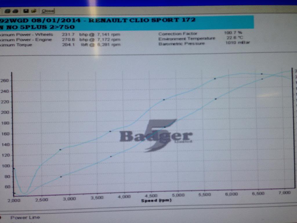

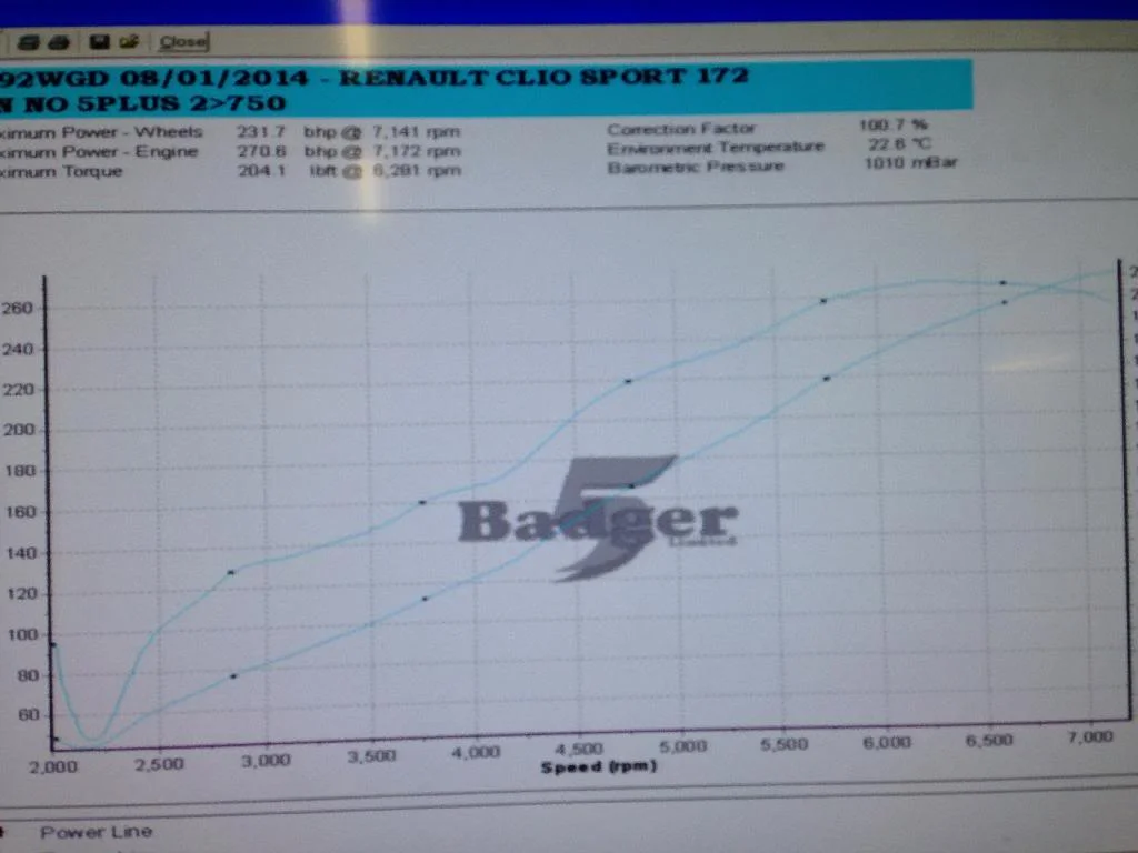

Tbh I'd like to see the same power that my supercharged one is doing which is circa 270-280. But I think I'm pushing mine a bit too much for the general public to be left with (mine sees new oil every 2000 miles, is rarely given proper abuse etc) So I'd say 250 would be my expected output.
I will be running a different turbo to what Andy offers, (gt2860r in my kit) and I plan ok having a very controllable boost regulation (boost x rpm x throttle) to give power all the way to the redline, and more importantly in my opinion a very neat torque curve. Similar to my supercharged car:

Here is a Roling Road Graph of Andys Package for the 265bhp conversion, with Megane 225 Pistons and Rods
So i cant see any skimping going on here to effect "limited Performance "
I can't price match Andy, as my ecu, electronic boost control solenoid and turbo are more expensive.
tbf both graphs look good! One would give you more midrange due to the way its setup. For an inexpensive and effective road car setup that would be a great choice. The more linear one would be better on track and the one I'd go for because I prefer a linear curve.
You could do that with either setup though by running electronic boost control either through the ECU or an external boost controller, you could have multiple maps too and have the best of both.
