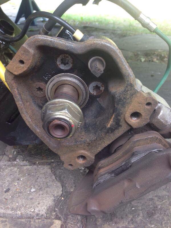

This is what I'm working with...
You will be alright to paint the caliper carrier in hamerite, it will just fall off the actual stub axle itself but who's going to see ;).
The bearing face is the part that has the spacer and the nut screwed on the end, emery it up if its showing signs of water ingress.
All done now cheers chaps. Cleaned up the shaft too or the bearing face, whatever the correct name for it is.
