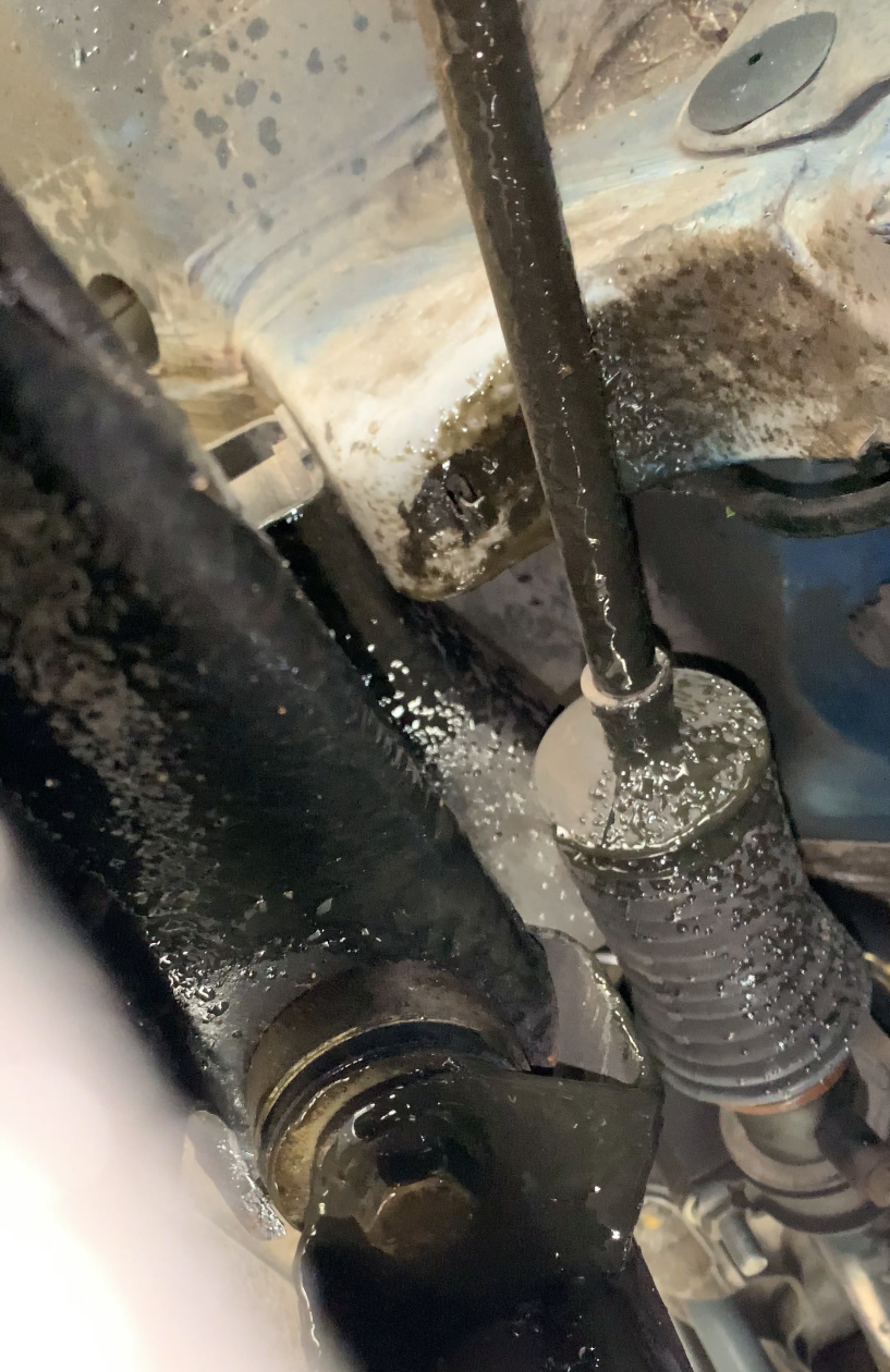

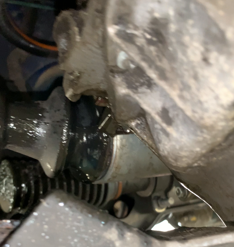

After 2 laps at the Nordschleif, 2 Sessions at Nurburgring GP and today 2 session at Chambley(Circuit at france) it looks like this.. and i have the " TAC TAC " again when turning left and a bit if turn right..
Is it possible to get reinforced drivershaft or something else? It is a known issue so whats the best update the get this fix?

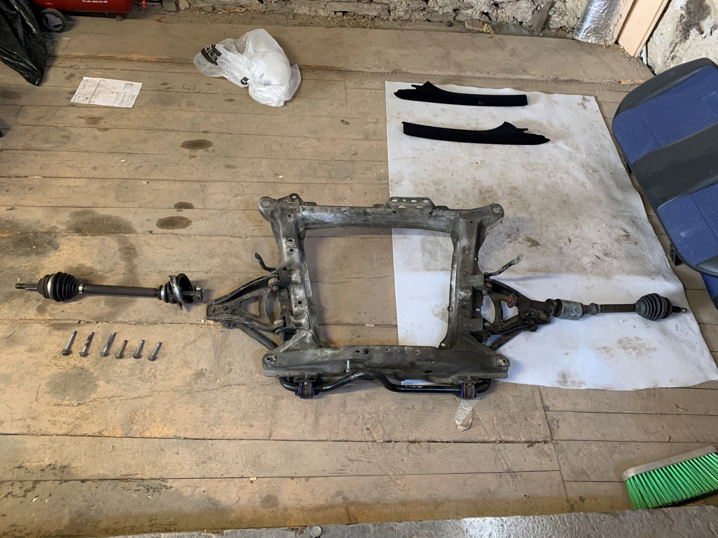

Here you can see all the ruubers changed. Also check the interior and everthing looks right!

already turn the wheels both sides spin the wheels but no noise.. but the two gaiters from the right drivershaft have a little hole..
