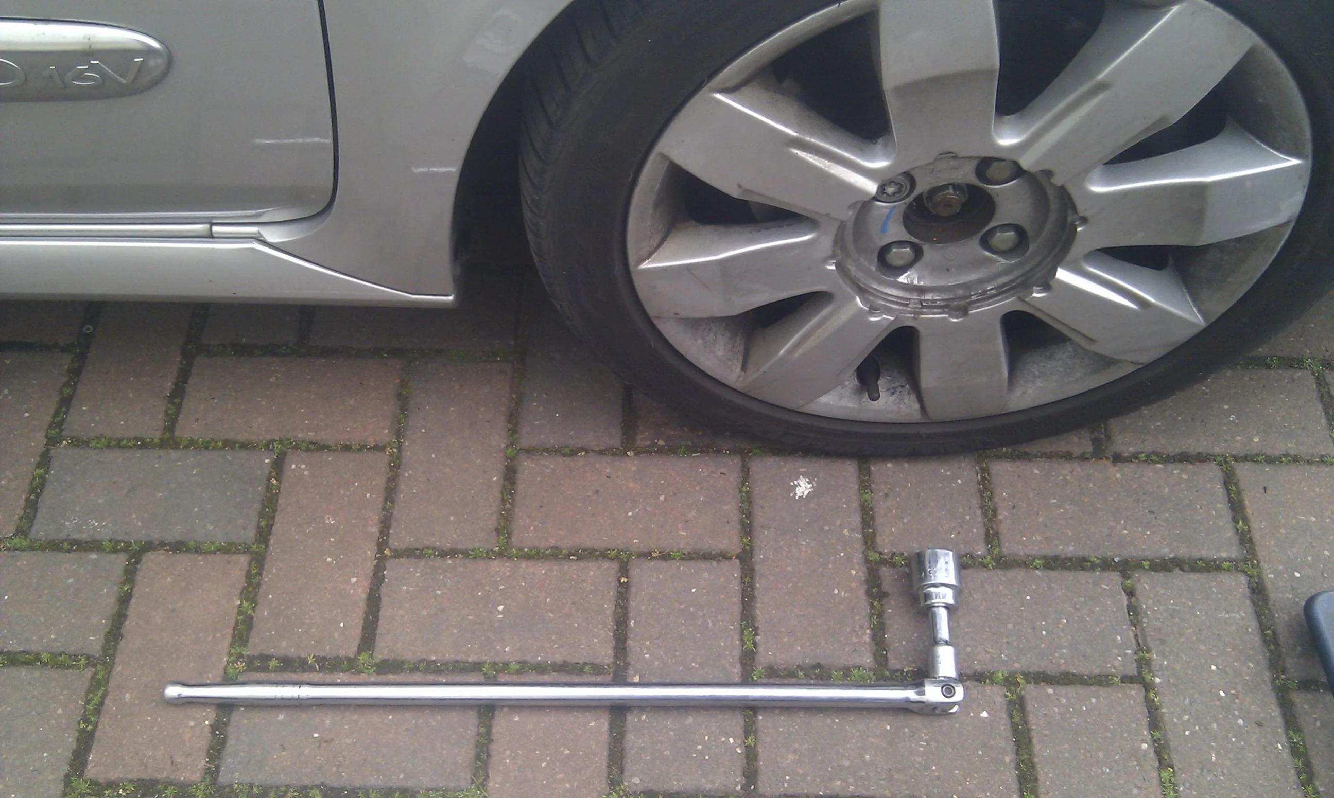

Just done driveshaft nuts today . were really tight from the factory! 600mm breaker bar and I stood on the end and bounced up and down till they cracked loose.
think halfords or screwfix maybe have them.
30mm socket
