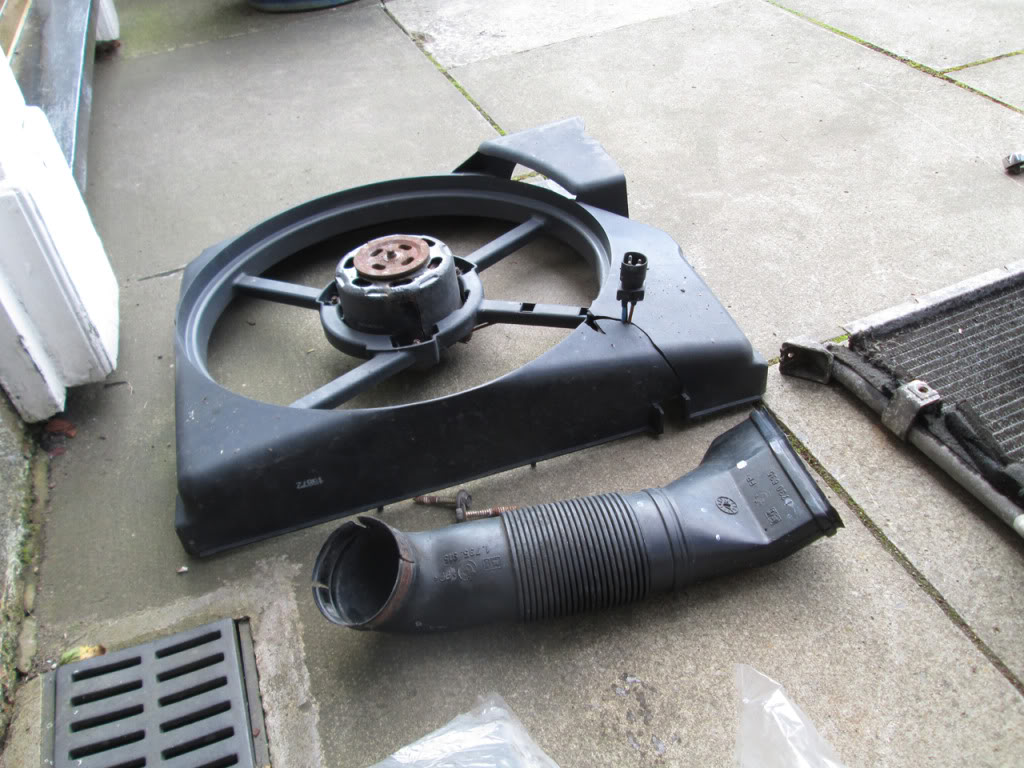

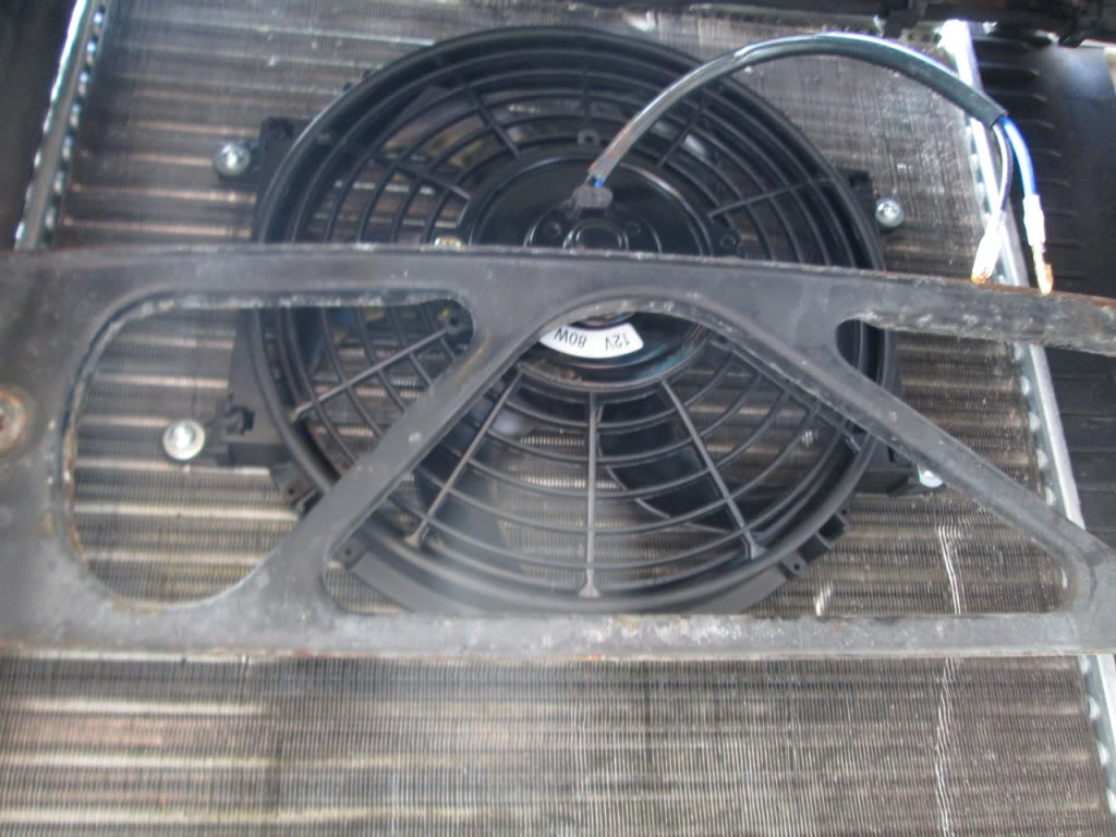

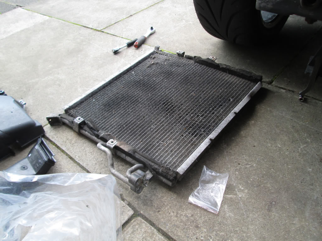

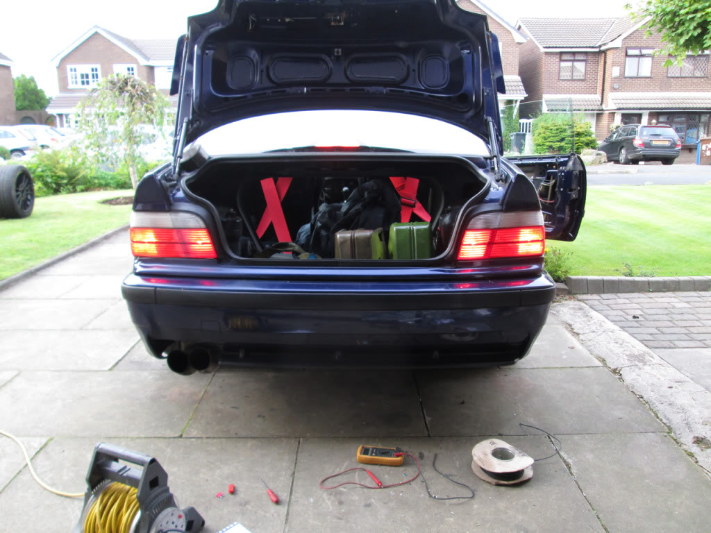

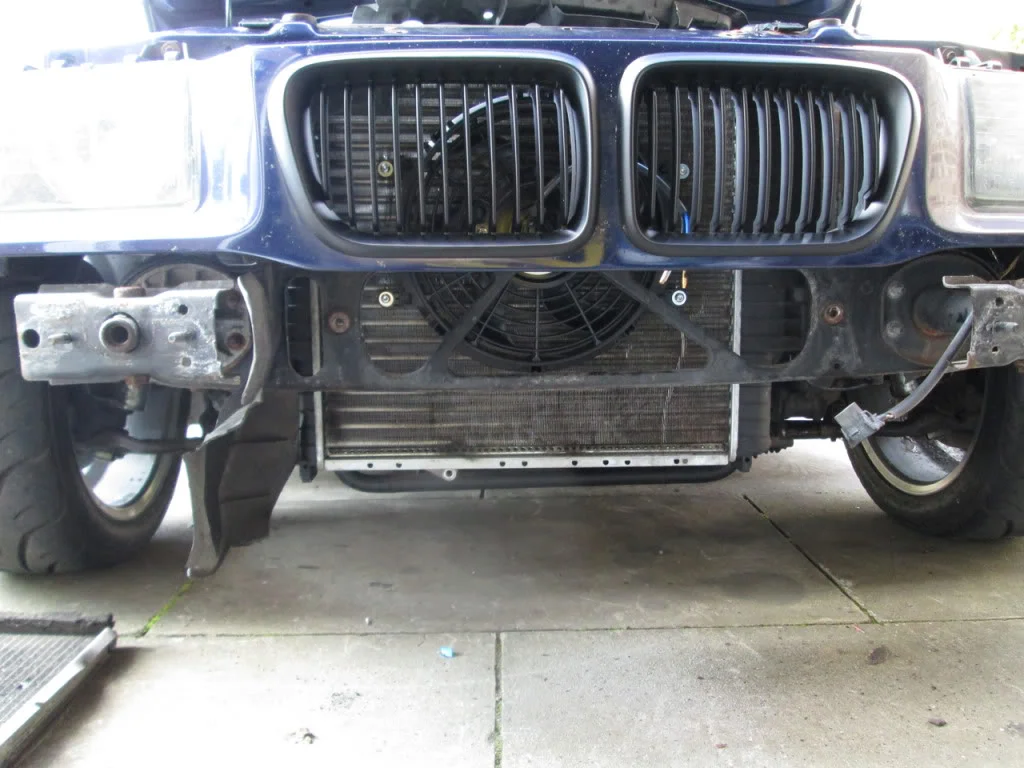

Got round to sorting a number of bits sorted over the past couple of days. First up was to sort the electric cooling fan that didn't work at Oulton, then when trying to free it up broke off. Far easier to fit a slimline item than mess around fitting second hand BMW items so I picked one up.
Gave me the chance to remove the air conditioning radiator also, a bit more weight saved.
Fitted the slimline to the radiator then wired it up..
Ran it up to temperature to check the fan cut in and out as it should with the lower temperature fan switch. 87deg on, 82deg off.
Next up I decided to wire up the fog lights to the brake lights, so they come on at the same time to give a bit brighter 'full' light from the back under braking. The spoiler hides the rear window 3rd brake light, and the standard brake lights are quite small..

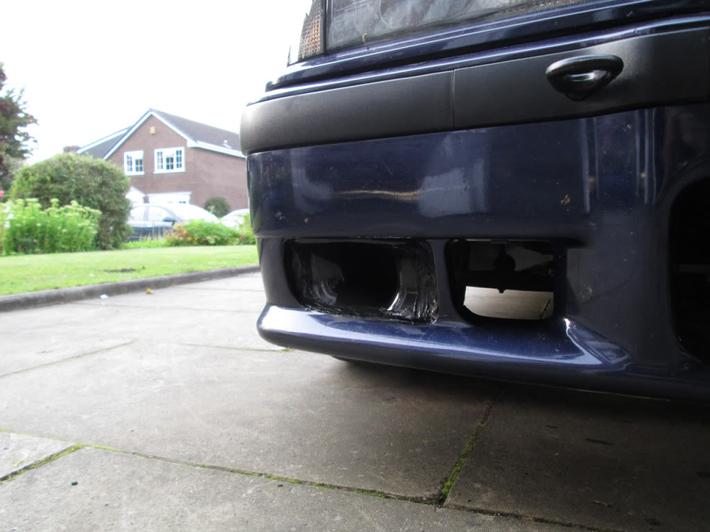

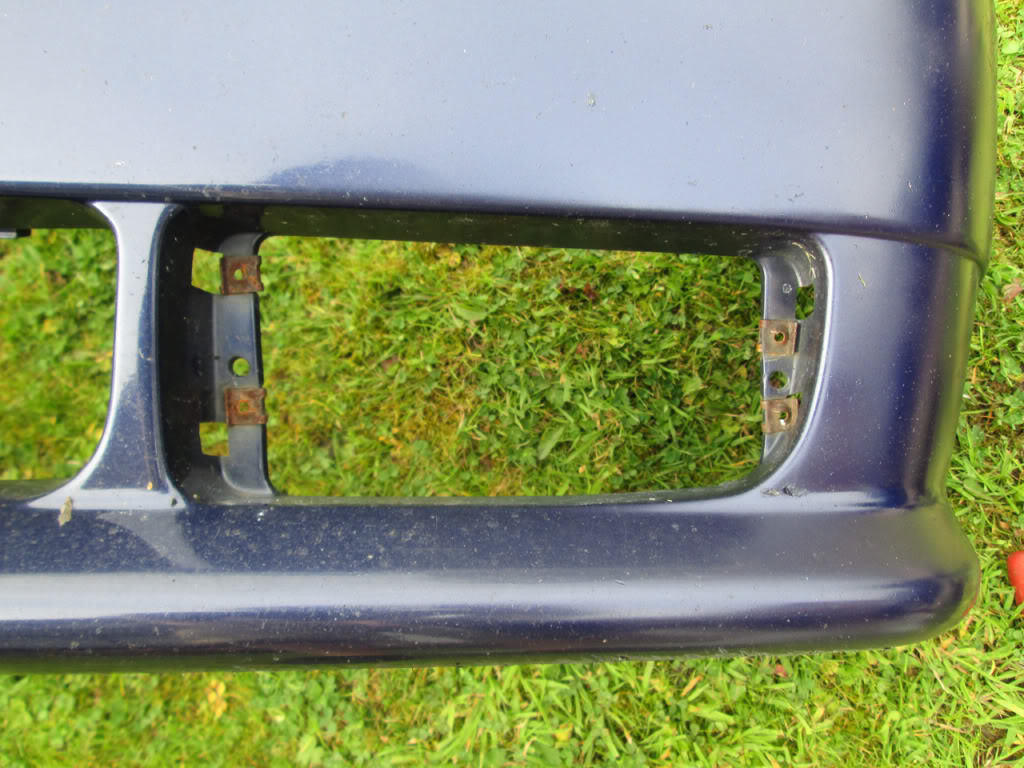

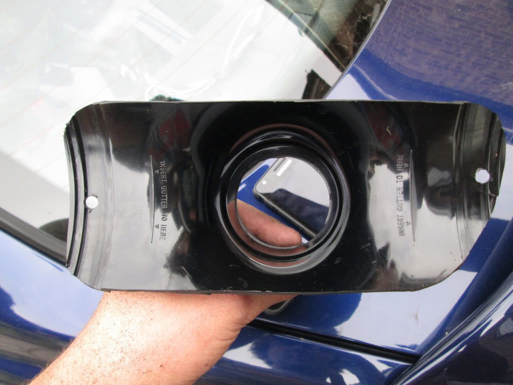

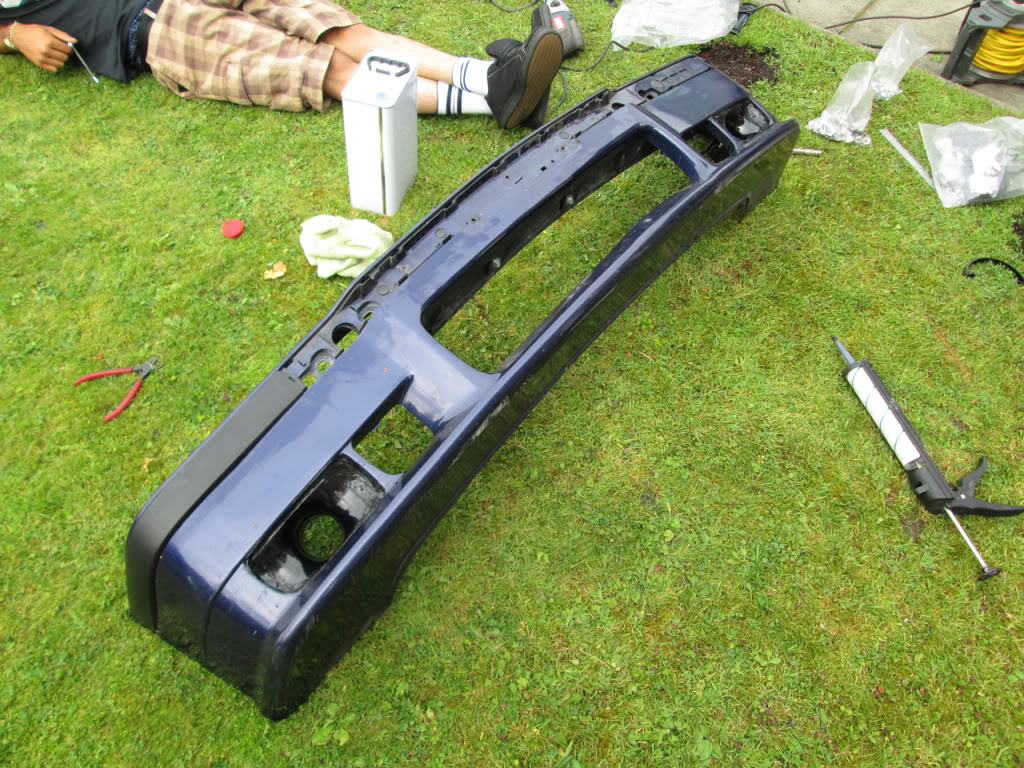

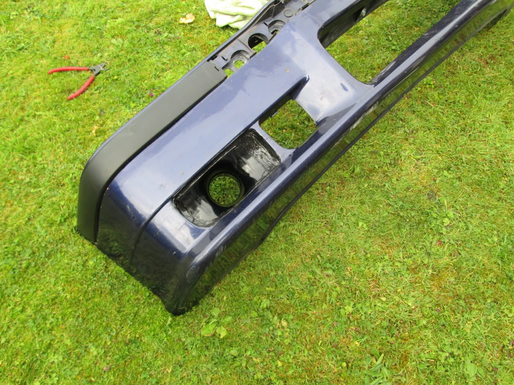

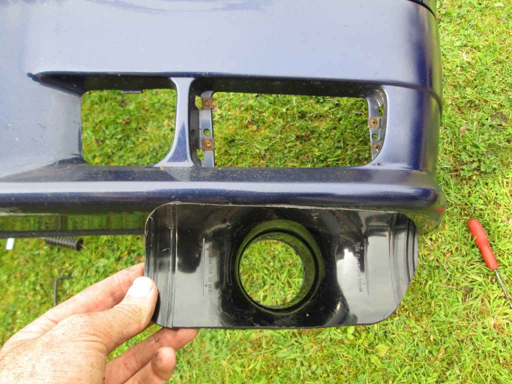

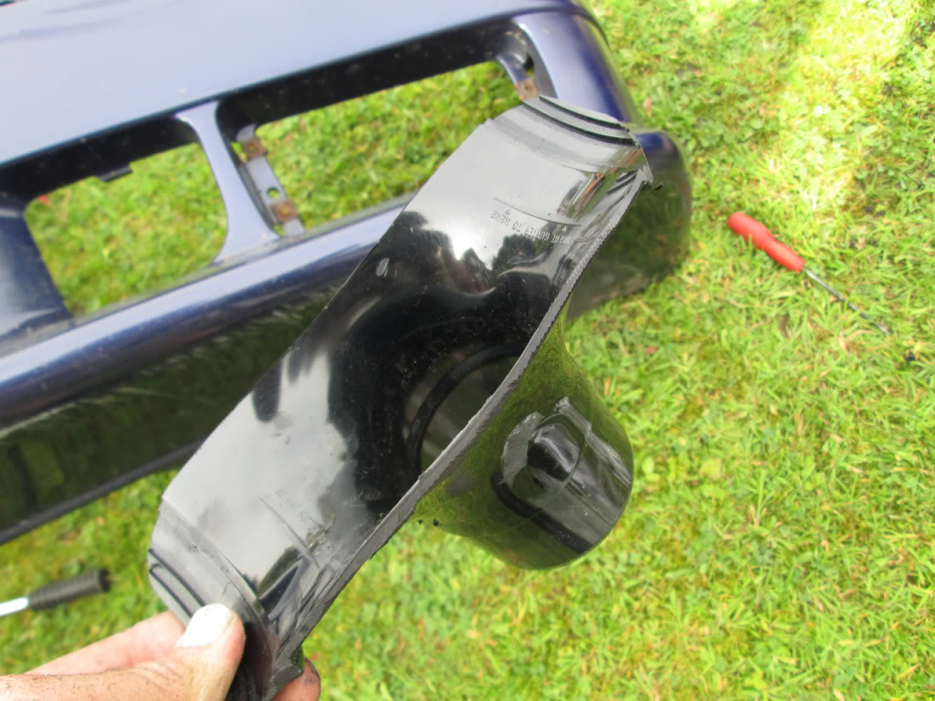

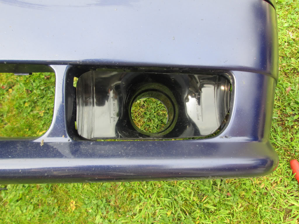

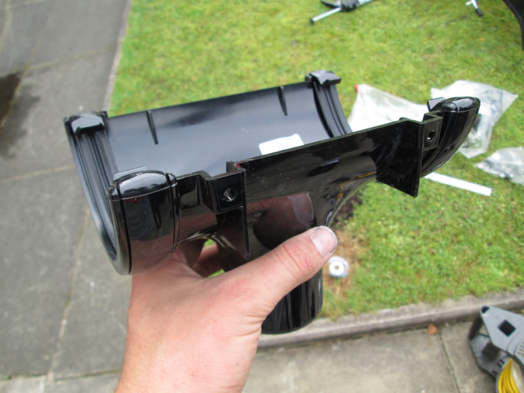

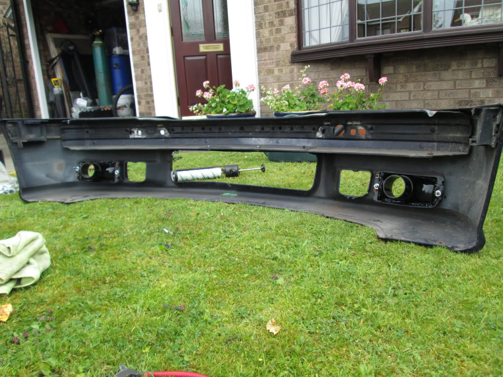

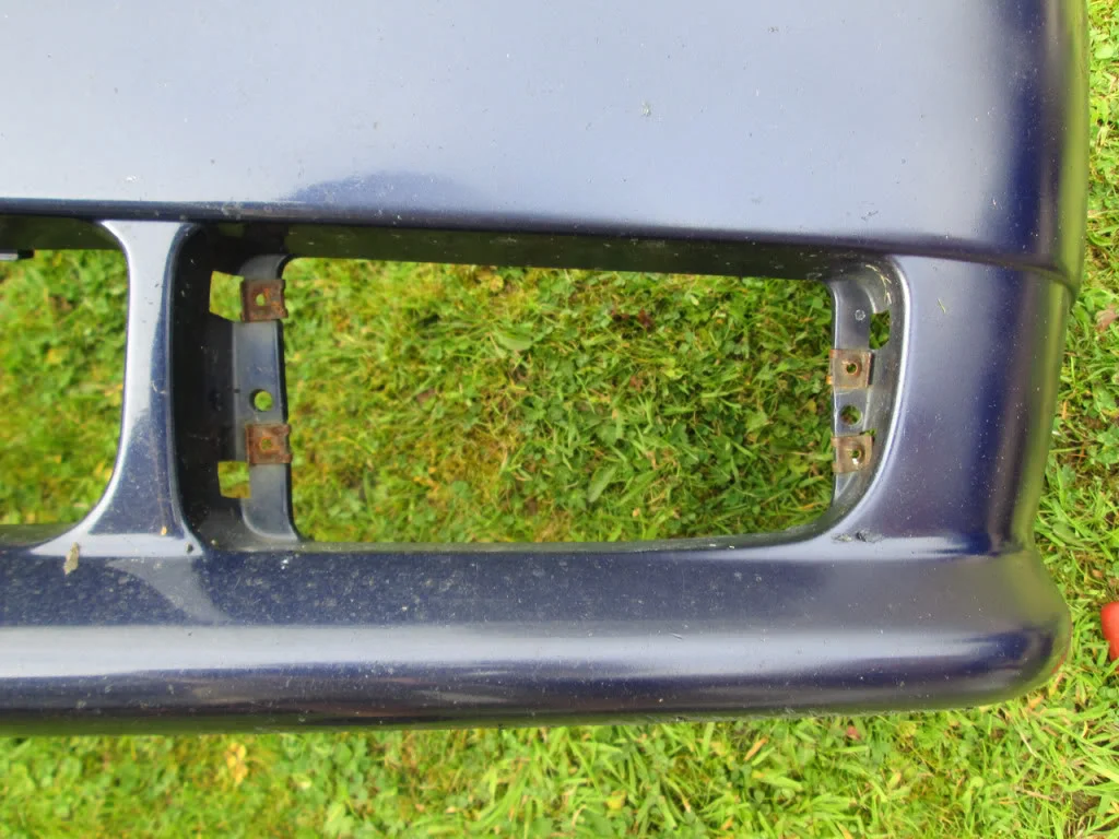

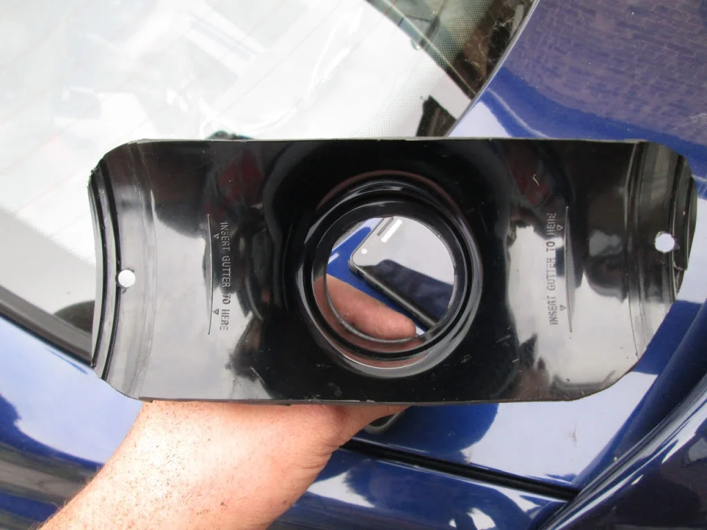

Whilst the front bumper was off I decided to do a similar mod as I did on the Clio, some ducts in the fog light which I can eventually use for the brakes. Take 2 x pieces of black guttering for £6..
Cut top and bottom, and adjust to shape..
Check fitment..

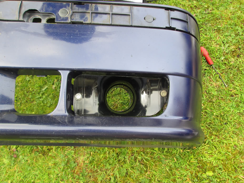

Once it was good enough marked up the holes which were already present from the fog light bracket, then drilled them through..
Bolted into place with some M6's and then sealed with some black adhesive sealant..
From the back the outlets can be seen, to which I'l be able to add ducting to in the near future..

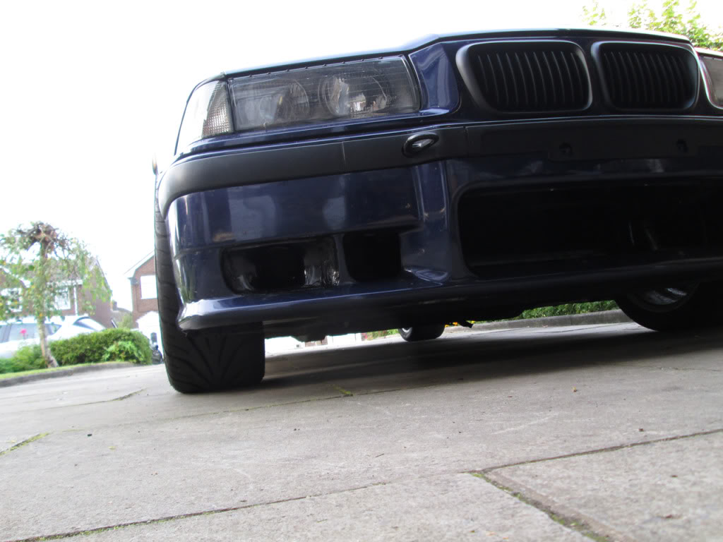

Finished by fitted the bumper back to the car..
Job done. Booked on to Blyton next weekend, couple of bits to sort before then but nothing major :boring:

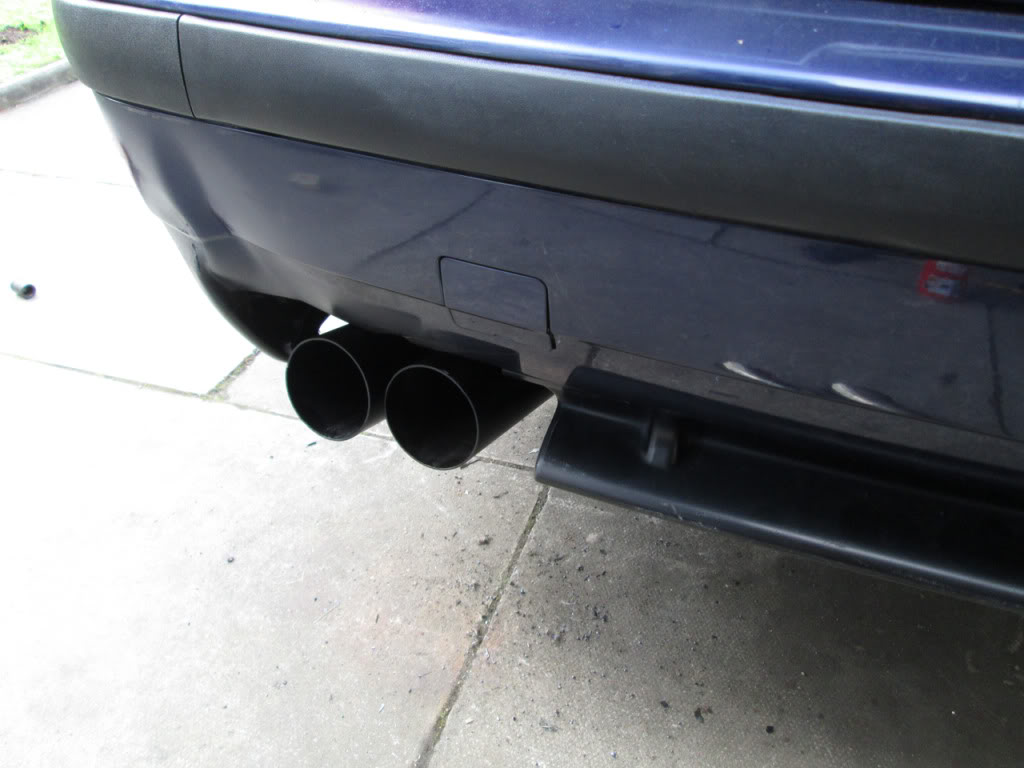

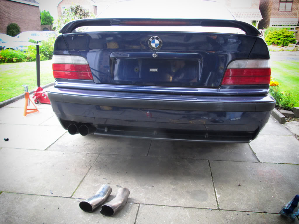

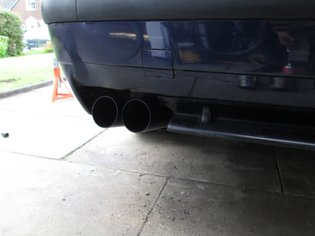

Final few bits finished to get it ready for Blyton today. The exhaust has been wonky since I got the car, and it was simply down to the terrible mounts that the Scorpion systems have. It had 'DTM' style upswept tips, which I hated, so I decided to cut them off and sort the exhaust properly.
The whole thing needs replacing at some point with a better system, as its been messed around with by previous owners and I had many issues with the manifolds/downpipes a couple of weeks back. But for now its staying until I see the right system come up for the right price.
How it was:
Started by cutting the tips off, then the brackets. Bolted the rubbers onto the car, then jacked up the backbox into the right position. Cut two pieces of 3mm plate with a hole drilled in one end, and bent them to the shape of the backbox and welded them on. Now the backbox was in the right position, I cut two pieces of 3" straight pipe and tacked them on in the position I wanted. Welded them solid..
Much better and finally level. Thats about it for now!

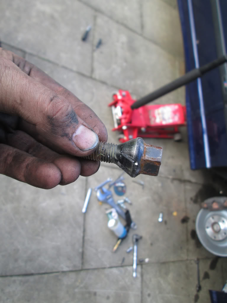

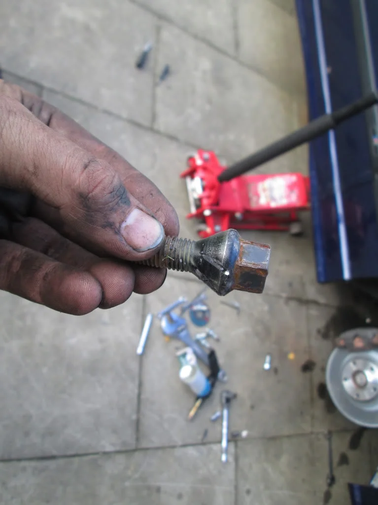

I had saw a cool trick on another forum a while back that worked, so tried it myself.
Take 1 old wheel bolt and cut a few angled slats in it with a grinder..
What a brilliant idea ;)

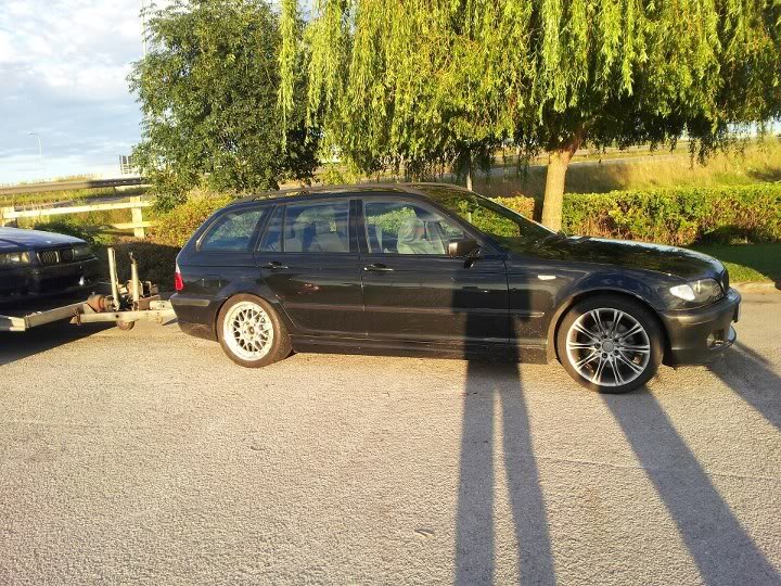

Well it was an early start on Saturday..
Got over to Blyton Park in plenty of time, signed on, briefing, etc etc. Out on the sighting laps the car had a bit of knocking from the O/S rear, turns out the top mount thread had sheared off so I needed to find another one sharpish. Whiteley was en-route and managed to stop at GSF to pick one up for me.

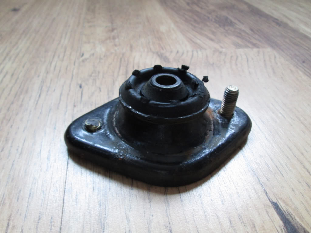

Just before dinner I started to have a few issues with the steering. Every time I went round a left hand corner the steering would lock up and it would be hard to get the wheel back straight again. It seemed to get progressively worse so I came back in for a look.
Checked the steering rack mounting, track rod ends, bearings, wheels were tight etc. Headed back out to see if it happened again and the issue was still there.
Came back in again and had a look down from on top of the engine to see the steering column linkage was nice and shiny - obviously been rubbing on something. Looking next to it the engine mount had failed and split in two completely - so the engine wasn't actually attached on the O/S. Jacked the car up and then the engine, and there was a good few inches of up and down play in the engine...
So when I had been turning, the engine had been leaning over and locking the steering column linkage - not good really. With no spare engine mount and the nearest factors a good drive away I had no other option apart from calling it a day.
Got a small amount of video footage before lunch, nothing interesting mind. I was surprised at how fun the track was with it being small and flat, it flows really well and there is a good mix of corners. The only thing I disliked was the pit/paddock entry as you will see in the clip below - if a car is still out on track and someone is going in you really cant help having to slow right down, bit of a track design flaw in my opinion..
Hung around for the afternoon to see a few other people on track then got the car loaded up on the trailer and ready to go. Heading out of Blyton through the village there was a massive BANG, followed by a lot of vibration. Turns out the N/S rear on my E46 had blown out.

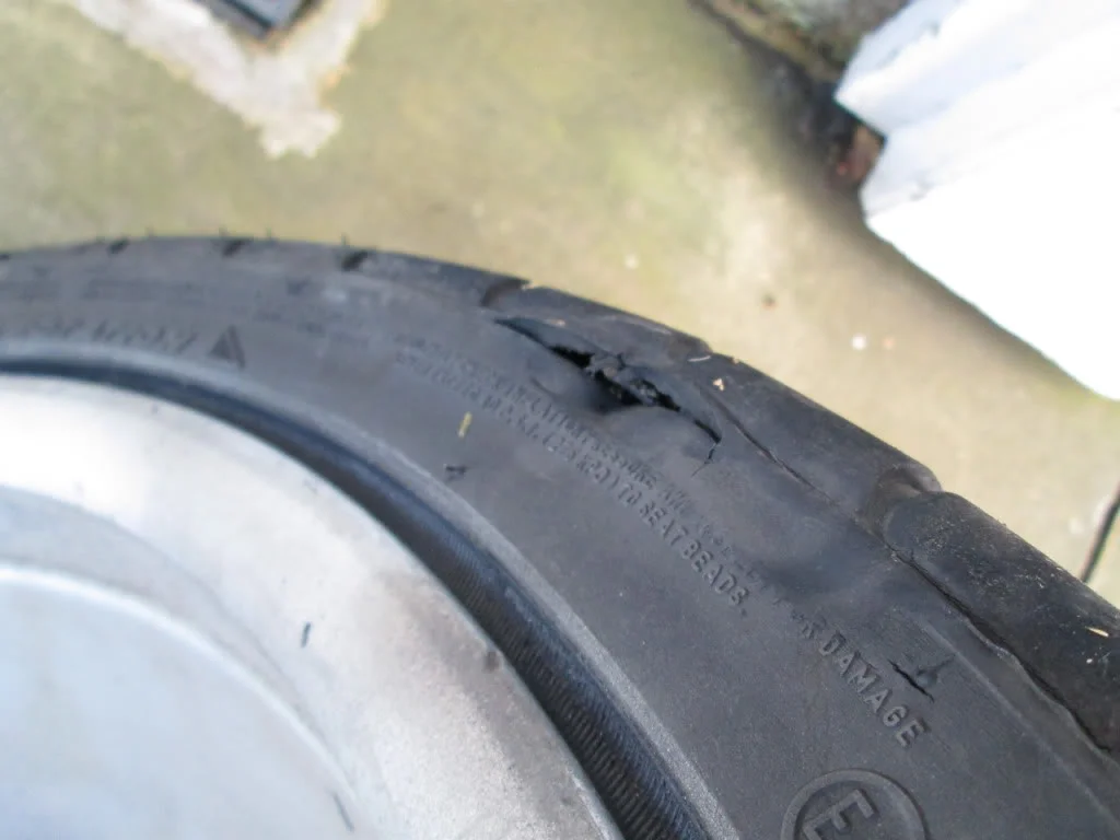

BMW in their wisdom only put a space saver in as a spare... f*cking pointless if you are towing! Ended up having to unload the E36 on the side of the road, take its back wheels off and fit them onto my E46 so I could carry on. Lucky I have a BMW with the same fitment as a track day car and not something else, or I've no idea what I would have done!
All in all it was a disaster of a weekend, but at least I managed to drive it again and get a bit more feel on proper wheels and tyres. Come to the conclusion that you have to accept that there are going to be teething issues with it for the first couple of outings, especially with the things like engine mount/top mounts/etc, the stuff that can't be predicted.
Next outing is Anglesey late September, so going to aim to get the engine mounts sorted by then (poly or solid replacements), along with a collection of common spares (top mounts, front hubs, etc) in case of anything similar on the day again. :boring:
