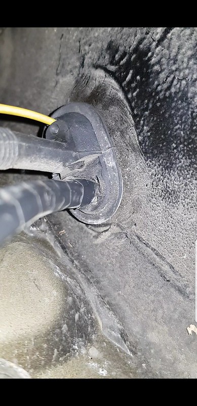

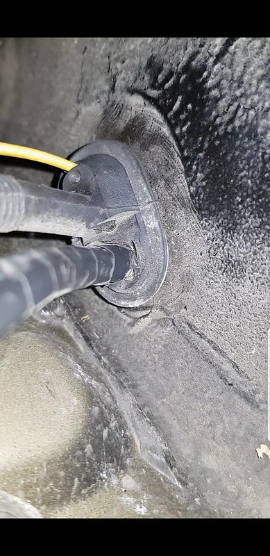

I tried this when I was fitting the oil gauge.
Fucked it off and just drilled a hole and stuck a grommet on it, put the wires through and then stuck some black sealant in to seal it up proper.
Easy peasy
Show me your hole James
