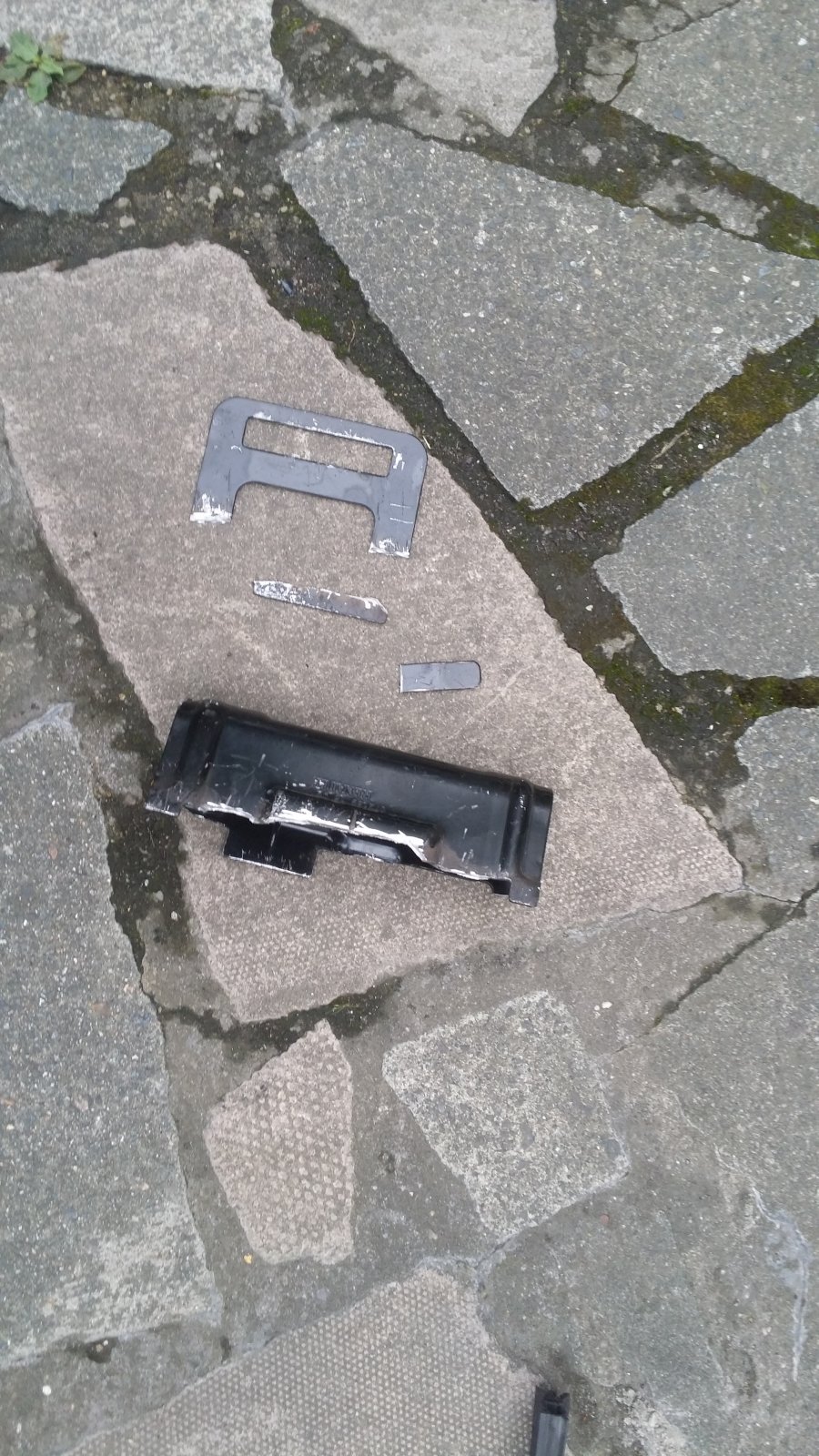

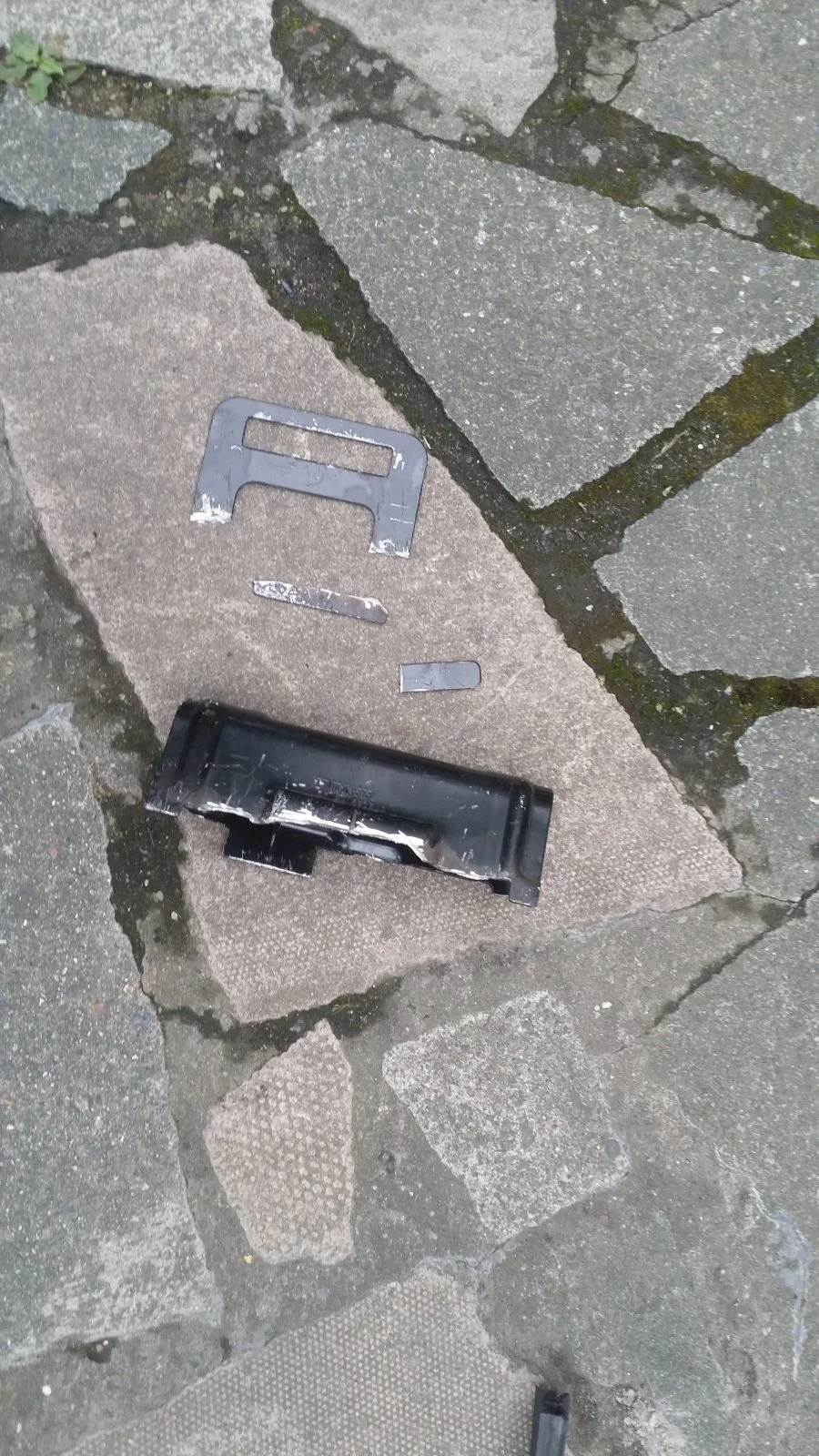

Hi. I know it's an old topic but I have the same problem, the cover from a dCi won't come off.
I also have tried the hard way, with a hammer, crowbar,and other tools but nothing.
Maybe I am doing it the wrong way. Is the cover ment to slide to the right and then lift or just press the things on the back of the cover and then lift ?
Also, I am considering using a Dremel or an angle grinder to cut it if nothing works. Is that a good idea ?
Thank you all but with the help of a Dremel, I have removed the top cover.
