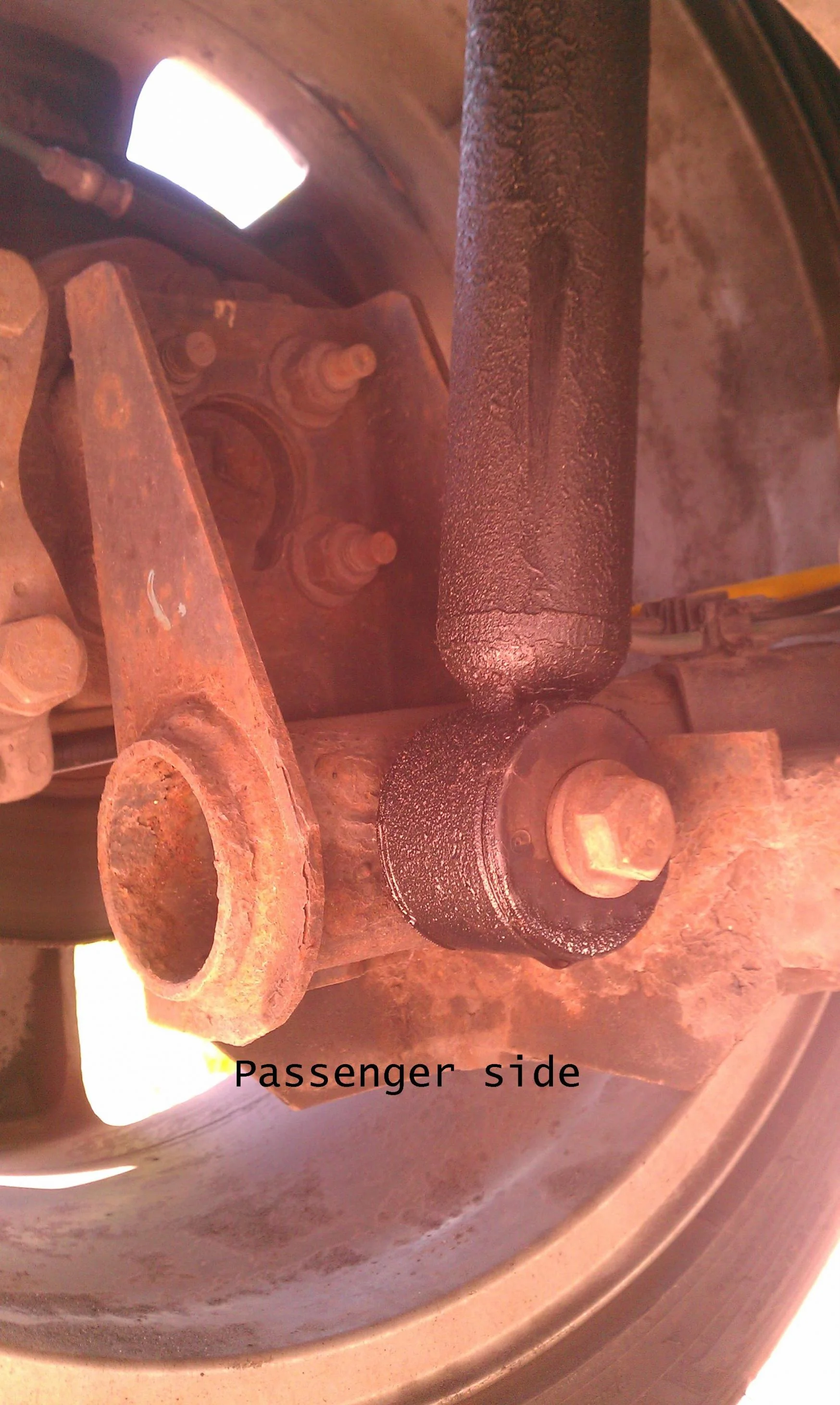

Hi,
Can anyone shed any light on this for me?
I bought Eibach pro kit back in Jan 2012, I bought new rear dampers from Renault Cardiff at the same time.
I have covered 5,000 miles since all this was fitted and the rear dampers are leaking oil already.
The front standard dampers have covered approx 35,000 miles during my ownership, 5,000 of which are on the Eibachs, these dampers still appear ok.
I am just about to leave to go to Renault for a warranty assessment on the dampers which I think they won't honour due to the Eibach springs.
Does anybody else have similar experiences when running standard dampers with the Eibach springs?
Car is a Clio 182FF both cup packs.
If Renault do not honour the warranty what are my best choices for some rear dampers to suit the Eibachs? I was thinking Spax adjustable or Koni adjustables.

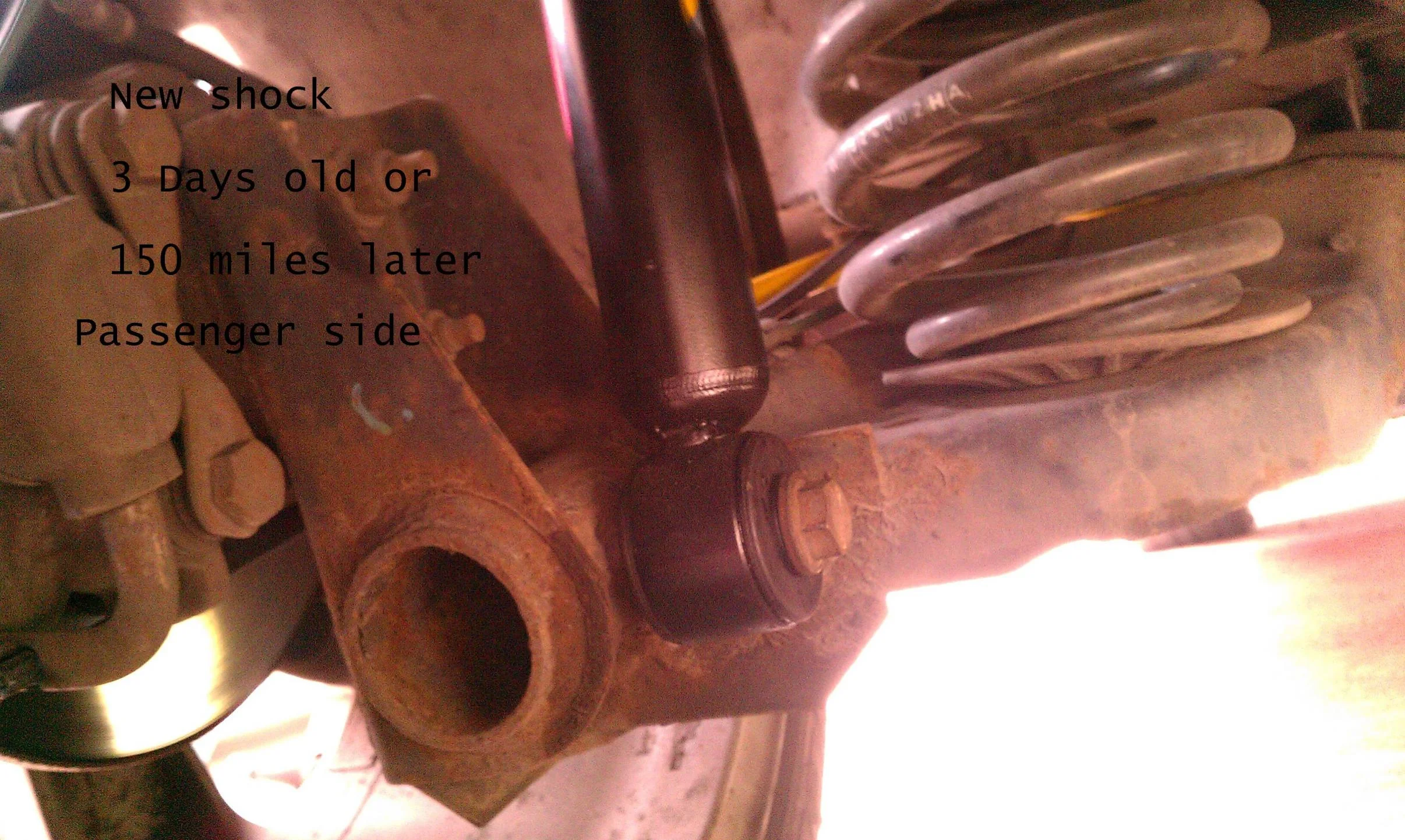

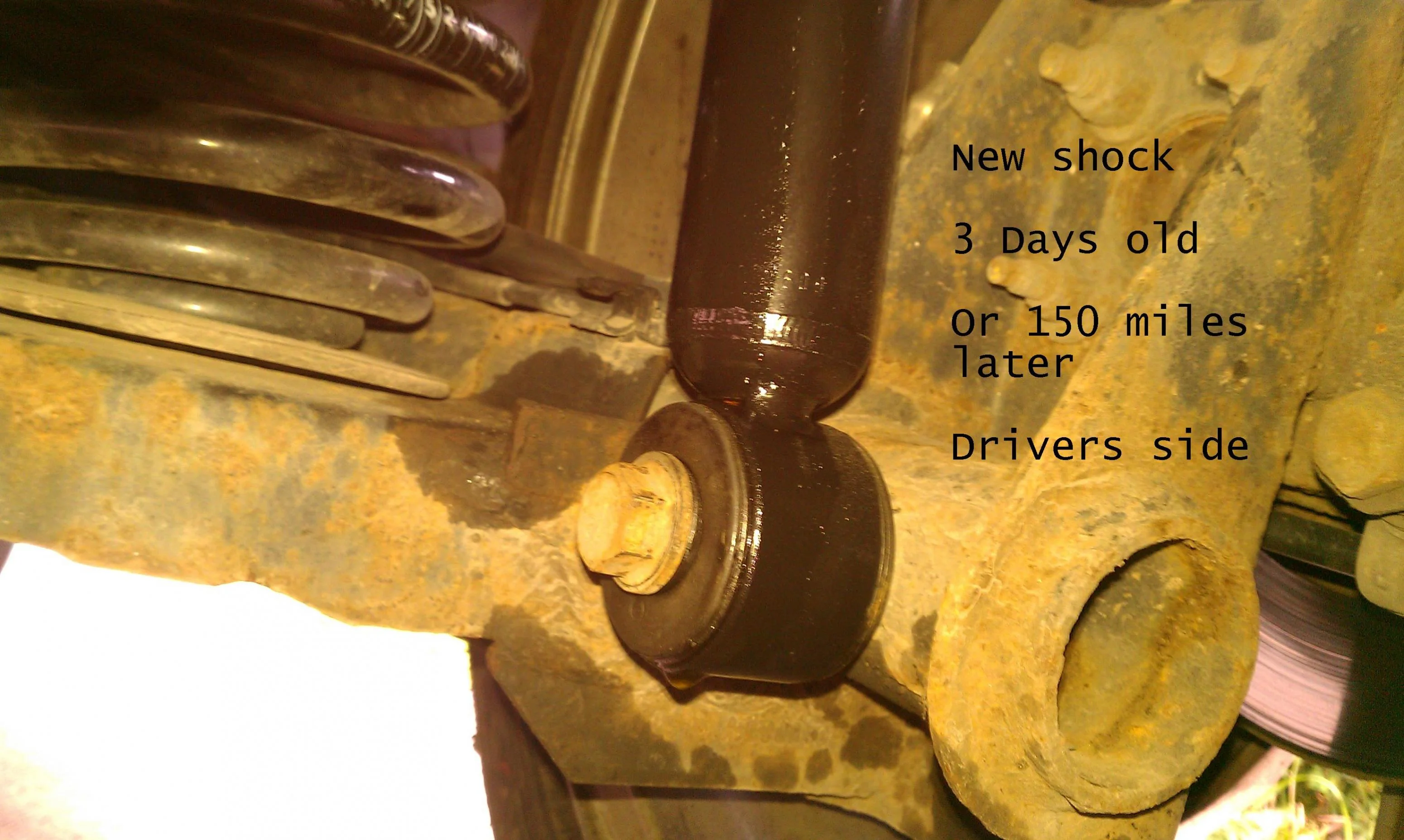

1 day & 80 miles of relaxed driving later the drivers side rear shock has traces of oil over it with a ball of oil pooling at the bottom of the damper. Passenger side is still dry but I will check it again tomorrow.
I will be checking this daily, can't believe I'm having such bad luck with this & Agree with DTM not many threads on this so shouldn't be a problem.
Renault even agrees that the spring should not affect the lifespan of the shock. Hence they changed them for me at no cost, they even valeted the car. Can't fault the service so far, although I think the Cliosport.net sticker and tax disc holder helped.
  derv biege barge
Car is perfect to drive when the shocks are not leaking. No odd noises to hear, checked all 4 wheels for signs of play and everything is solid. I changed the rear discs, bearings and pads 12 months ago, all still in very good condition.
I can't find any play anywhere, car is solid, the only thing that is not standard are the springs.
Even checked the part numbers fitted to the car and that's correct too 8200681125 stamped on the dampers.
What else could cause the shocks to fail like this other than faulty shocks, all 4 of them?
I'm completely confused, the Eibach pro kit hardly lowers the car over standard, so cant understand why this is happening.
Needless to say I will be contacting Renault in the morning for further assistance with the matter.

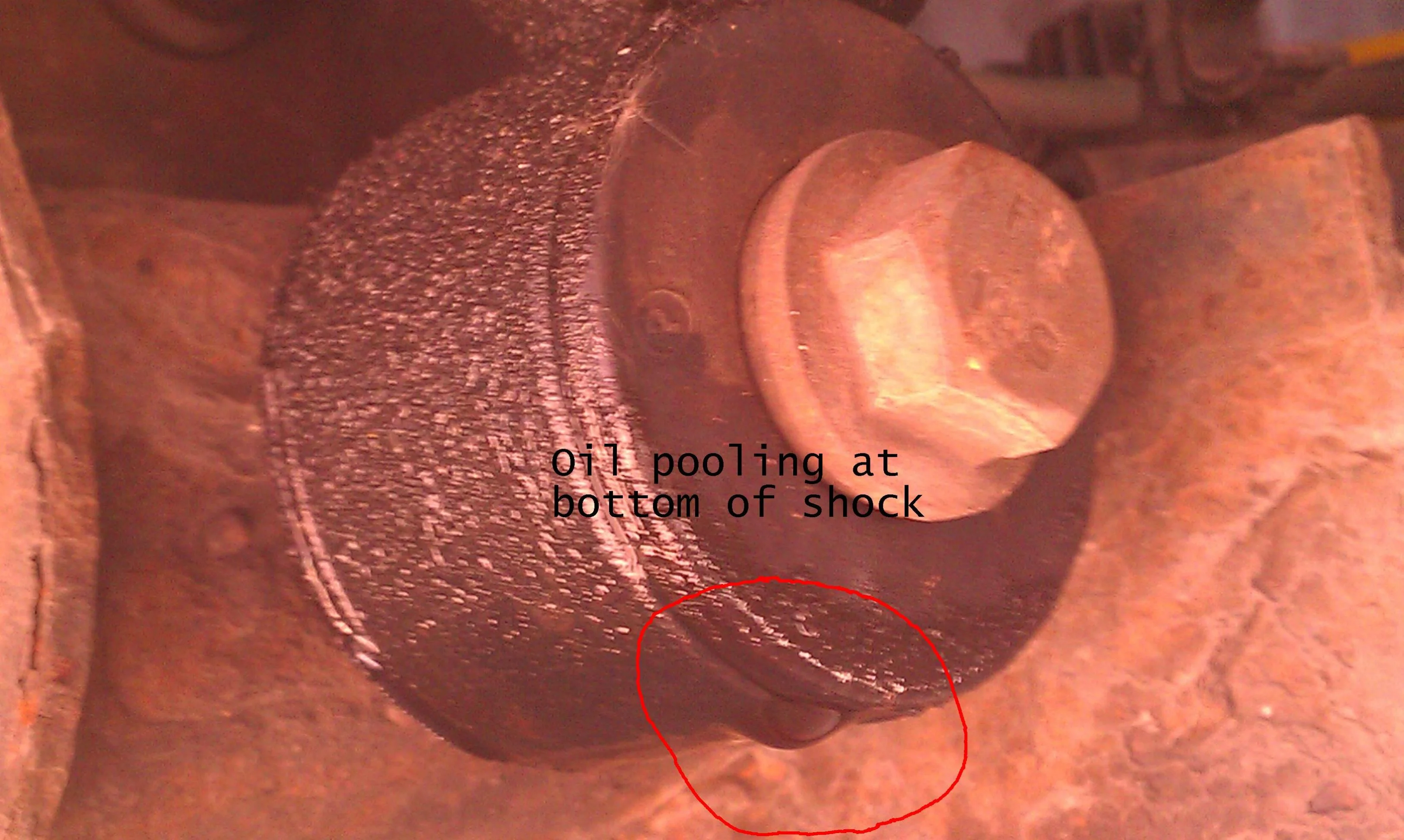

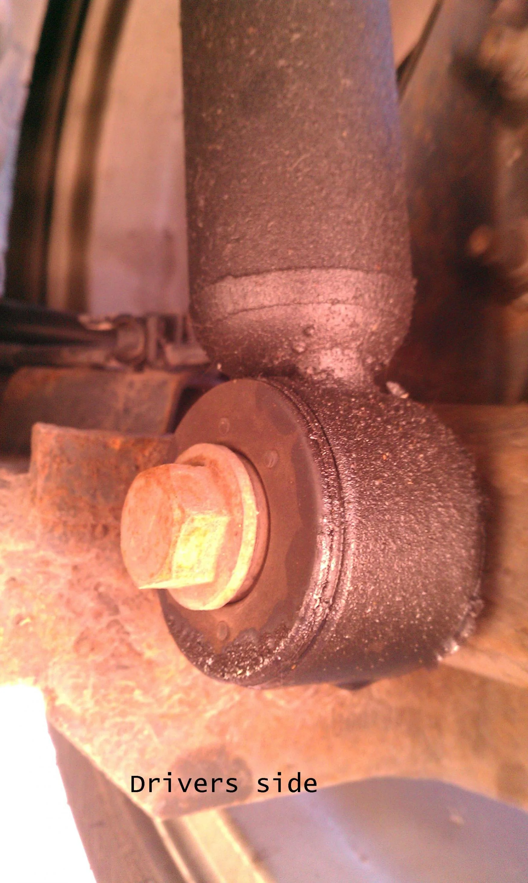

3 Pics below are the shocks I bought in Jan 2012, I took the pictures this time last week.
2 Pics below are the new shocks Renault Cardiff fitted for me on Wed this week

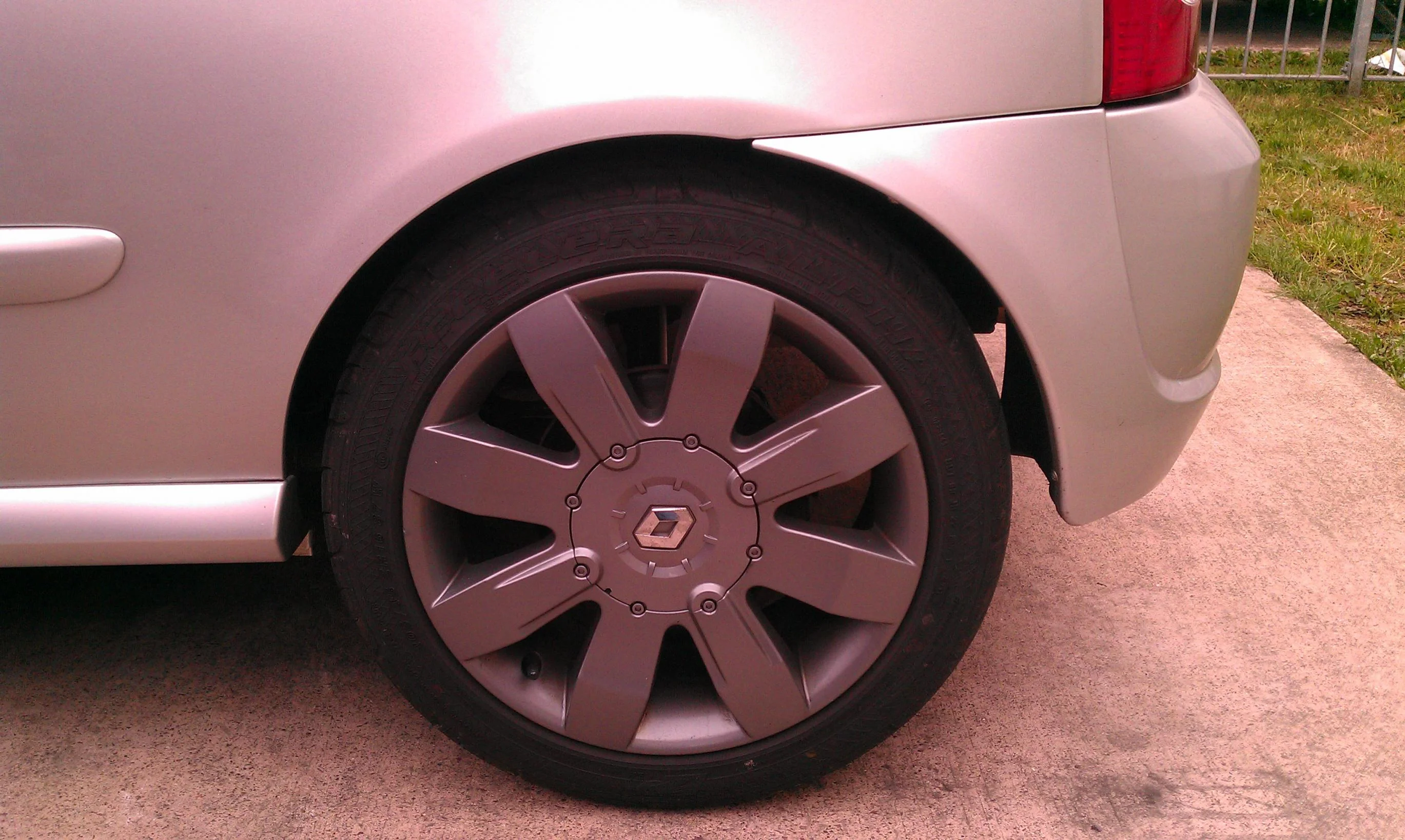

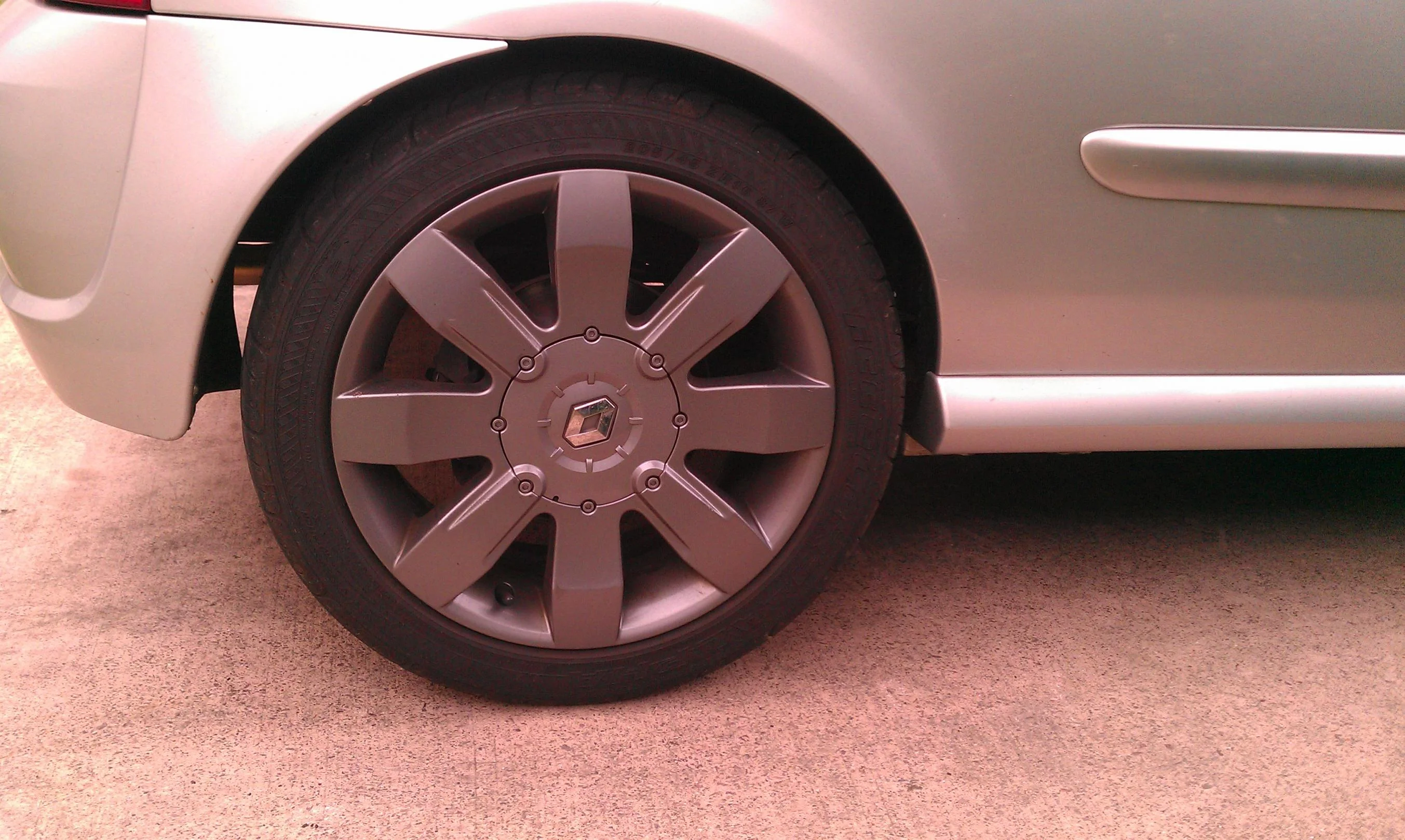

2 Pics below are my current rear ride height for you Clio experts to analyse if it could be the cause of the damper failure, personally I think it's not.
Thanks for all the input you have provided up to this point.
