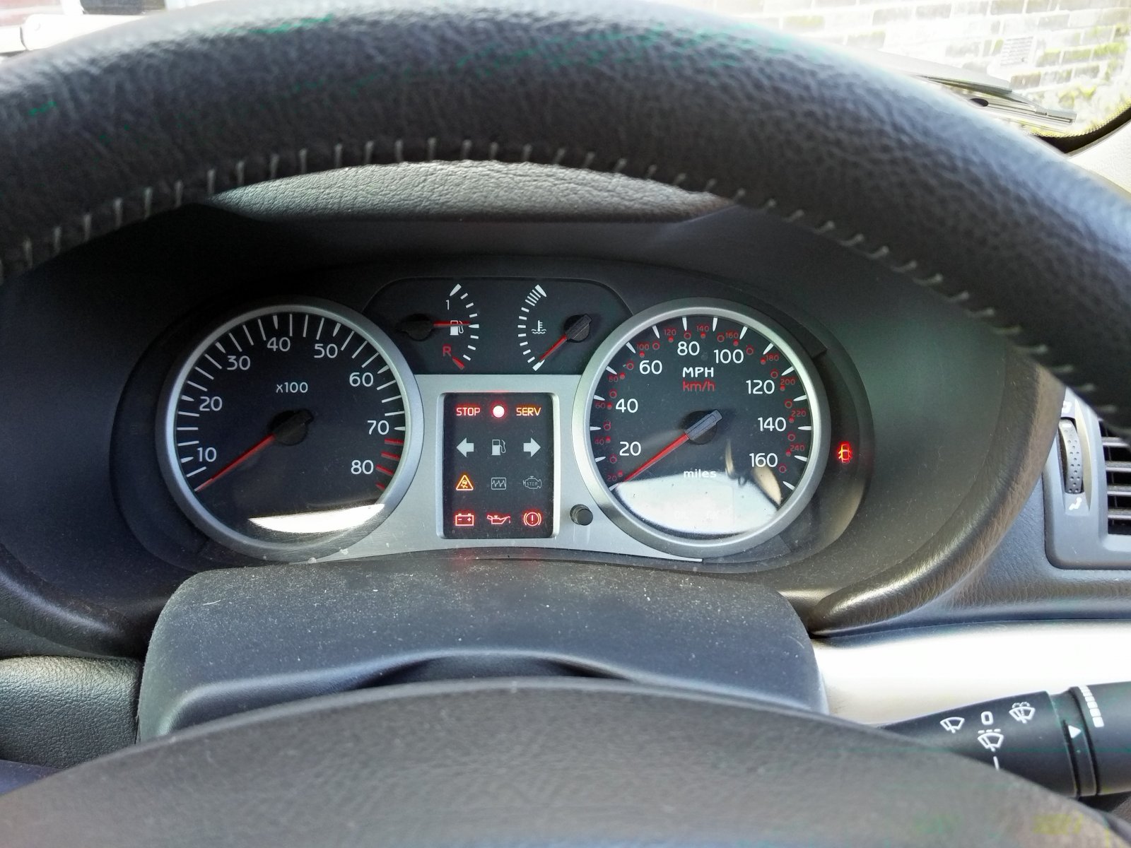

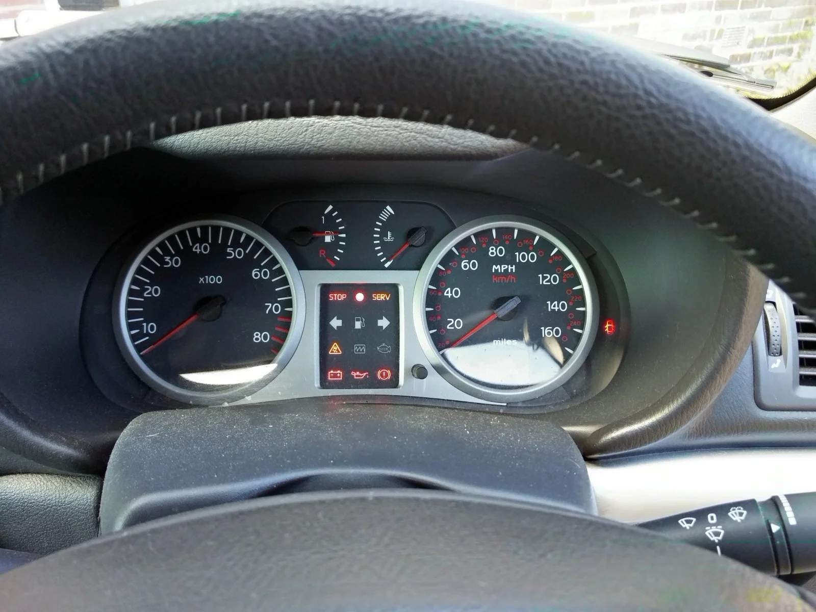

So went out to car again and I've noticed when I try to start the car the clock on the top display goes out. Also got the following lights on;
The rad immobiliser light is solid. Only got one key, so can't try a spare.
