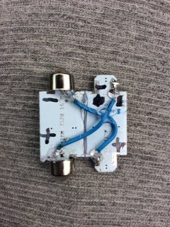

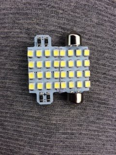

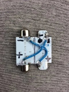

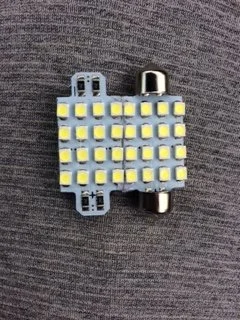

I know this is an old thread, was changing out my interior bulb today and had the exact same problem. I got a multi meter and measured the voltage and found that when switching from door mode to light on it switches the polarity.
My solution to this problem is to get two led lamps hot glue gun them together and solder them to each other in opposite polarity. So therefore when the light is in door open mode one of the led lamps light up then when you switch to light to always on the other led lamp lights up due to the polarity being different, hope that makes sense and it is an easy enough fix if you have basic soldering experience.
Image below of the final led lamp that works!!! :)
p.s on the image the polarities are labled on the leds just follow the wires and you can see what goes where.

Yeah, there's a few ways to skin the cat. You could do as above, or use a seperate bridge rectifier, or use the two bulbs in series with a diode across each!
Easiest option for those who aren't great with the soldering iron is to swap the unit out for one with a map light. You could then put an SMD panel in it as well for extra power (I did a thread a while back, called Joy of LED improve the interior light tenfold, or something along those lines.)
