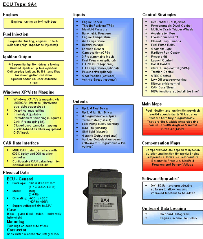

MBE is also well worth looking at. 992 or the upgraded version of it 94A will run a Clio no problem at all, has single CAN bus, simple VVT control, is fully weather sealed so can live in the engine bay etc. etc. It's what Caterham use to run the Cosworth Duratecs in the CSR 7's.
Available from SBDev for £560. I quite rate MBE to be honest - okay Easimap isn't exactly easy to map with but once you're used to it its okay and the ECU's are tought and accurate enough for sub 10,000RPM engines.
