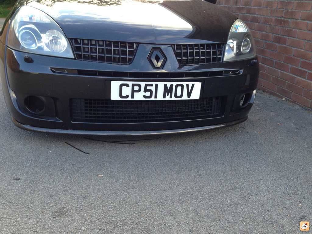

End product of my carbon splitter refurb :)
  clio 172 phase 2
Got given a ktec carbon splitter , needed a bit of work slight laquer peel few scratches ,
So wet and dry 600-1500
Then 5 coats of laquer its come up like new , probally not for long lol

When you say coats of laquer is that just from a spray can? Never used it before but mine needs refurbing!
  clio 172 phase 2
Cheers for the positive comments lads ,
As for laquer is used 2 pac laquer in a spray gun . Came out well considering its my first time using a spray gun .
In total the splitter only cost 17.50 haha ;)
