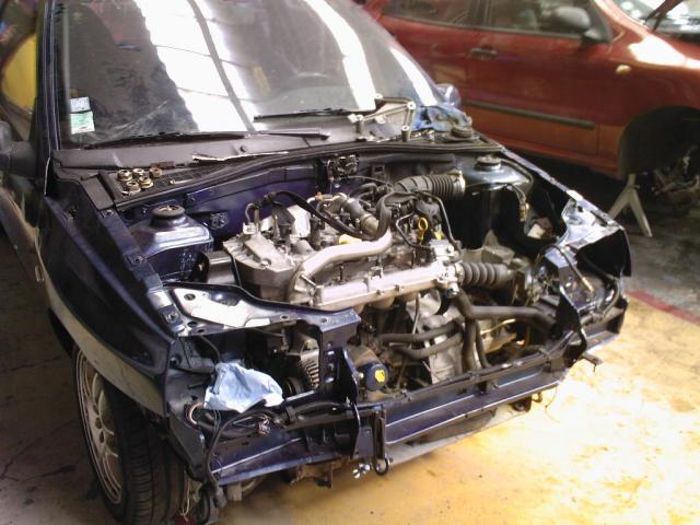

hi people
this is an interessting one
im not sure if this has been covered before as i am fairly new
but.....would i be able to fit a 225 megane engine into my 172
its been playin on my mind for a while
an i kno of an engine up for grabs
i kno its alot of work
but does anyone kno how hard this conversion will be
is it possible
only serious answers pls not jus erm maybe lol :D

Would be easier just to do a turbo conversion on your 172, dont thing there is a megane engined clio, due to the fact its a difficult conversion.
There is a Twingo somewhere with the 225 engine in though.

The Megane 225 gearbox is too long to fit inside the 1*2.
The 6 speed box doesn't mate to a 1*2 engine.
You'd only get about 220ish BHP from the engine if fitted. For the cost, time and effort, why not just buy the low boost kit from K-Tec and fit that to the 1*2 engine. Makes much more sense IMO, plus you've got scope to get more power in future by going for forged internals etc...

Knew, i'd read this. the box will fit but the mounts would need to be specially fabricated.
http://www.cliosport.net/forum/showthread.php?t=295834&highlight=gearbox+fits&page=2
Page two for the proof.
Look where the gear linkage is though all the 6 speed boxes have the linkage on top so you'd need that sorted aswell.
Also if you look further down the thread Fred was selling the 225 engine & box so I assume he gave the project a miss & if he dropped the idea it must be a bad idea. 197 box is probably the way to go if you can get one.
