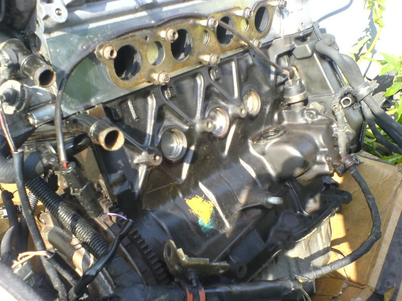

F7R has this:
(Bulge on bottom of B/E to alow crank movement, also the strengthening veins can be seen in this pic)
