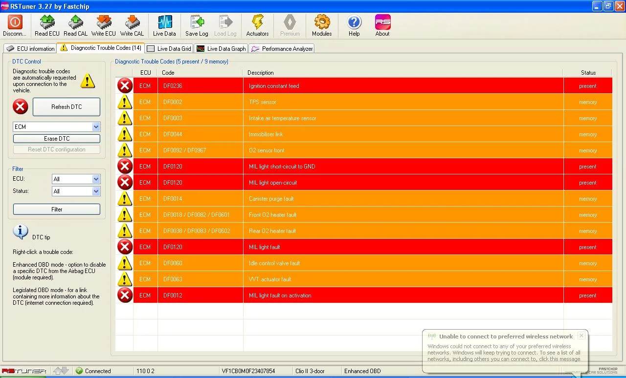

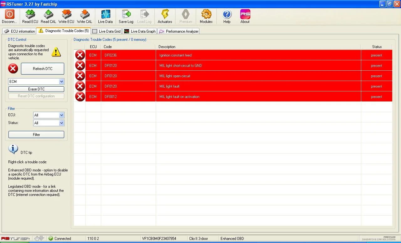

I've plugged Adam's old ECU into my car and got this
I cleared the faults to get this

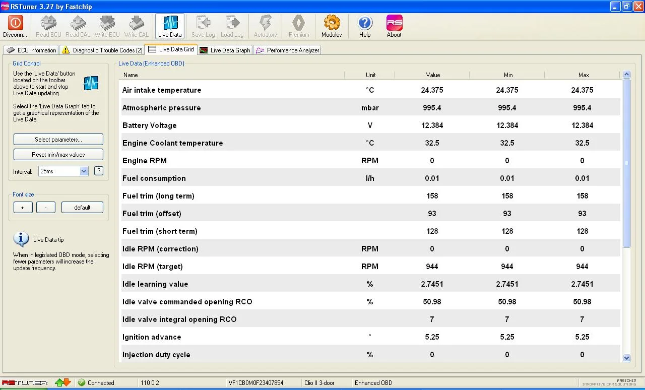

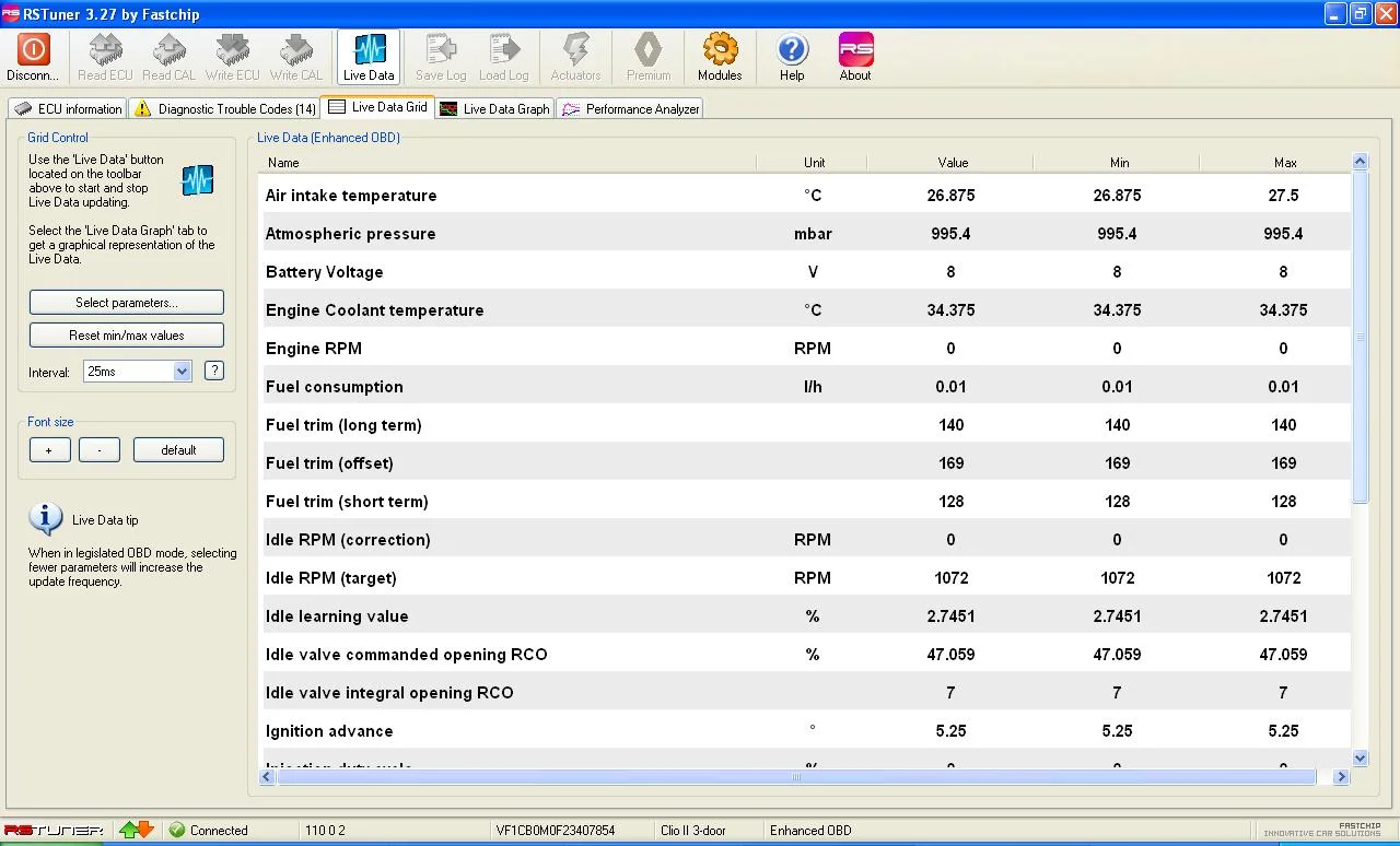

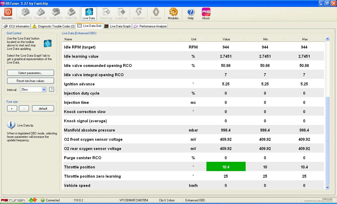

The sensor values were:
it won't start, and many of the actuators won't run - cam and fan, fuel pump seemed OK.

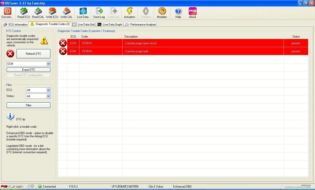

No idea what any of that means, so plugged mu ECU in to get a comparison
Very very interesting - the O2 sensor fault in the first picture will have been from when we went to the rolling road day. We had to unplug the lambda as if it was connected it would missfire under load, once it was unplugged it ran fine... which was weird. I wonder why those faults are stuck on too once cleared, maybe its completely f*cked?

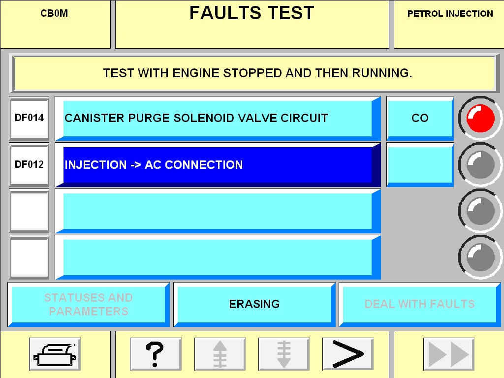

Right, plugged into RSTuner and Renault Clip this evening thanks to Jonny, although its not given us much more insight. This is all done on my ECU.
The RSTuner connected fine, could view all sensor data fine, no faults apart from the ones expected (Purge) either. Booted the Clip up and checked for faults, pretty similar result...

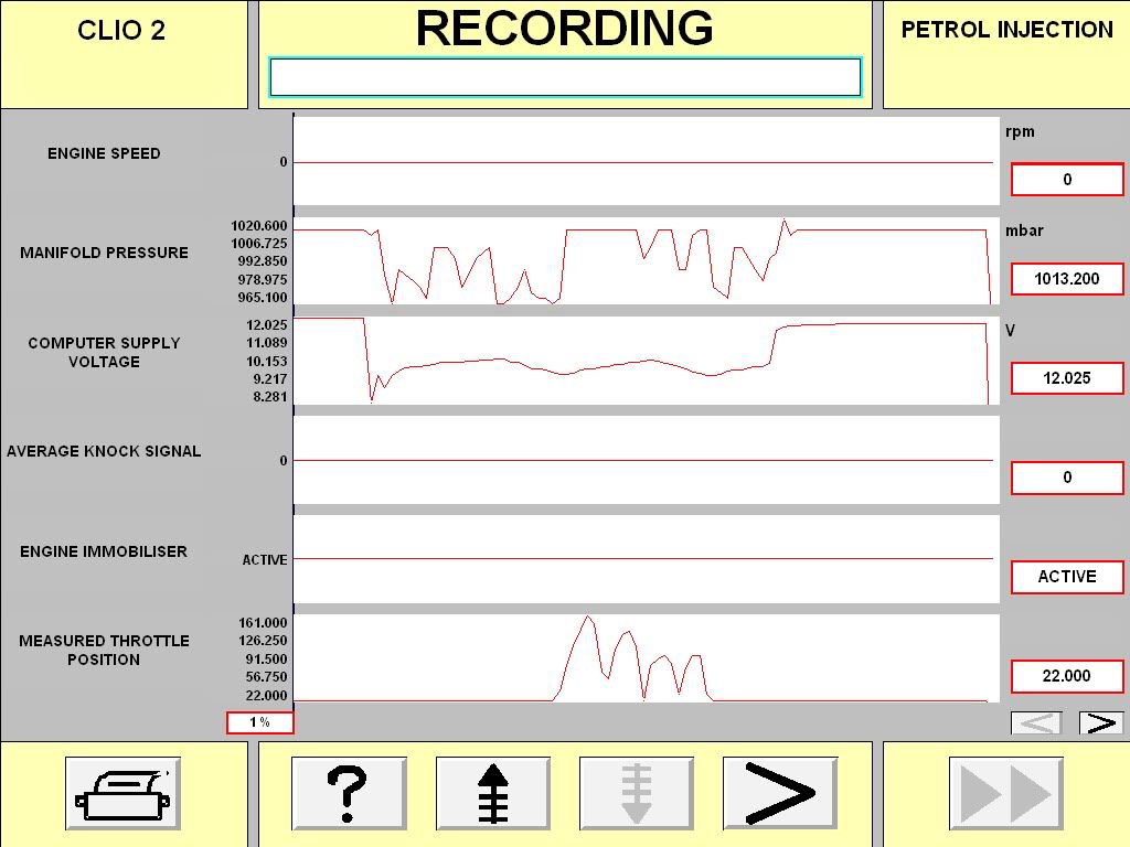

So next, viewed live data whilst cranking on Clip. The one issue I noticed was there is no flywheel signal being recieved (even though we know the loom is good, and the sensor is good as it runs another car)...

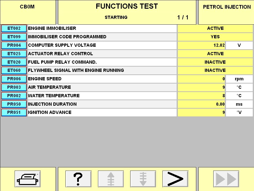

Then flicked through and view the sensor data labelled 'Petrol Injection' functions test. It states the Immobiliser is active, although this cant be true as my car starts fine with this ECU. So we cranked it to see if the 'Fuel Pump Relay Command' became active, which it did not. The engine speed remained at zero also..
Lastly, we thought there may have been an issue with Clip seeing the data. So we put the RSTuner back on, then onto live data, and watched while we cranked. There was still no flywheel signal/rpm being recieved, stayed firmly at zero. As said, this crank sensor starts and runs another car fine...
So basically lost for ideas now, as both diagnostic tools have given us no insight whatsoever (apart from the RPM). Maybe there is something wrong with the flywheel and its not being read correctly?
Also here is an RSTuner log of some sensor data, showing the null flywheel signal also (started cranking at around 420s).
