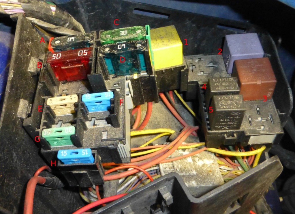

Engine fuses/relays
Which ones are for what? Thanks.

my relay box is identical to this one. 172 cup.
Just brought and had gremlins on day 5 :cry:, wouldn't start.. Thought it might be the TDC sensor which I'm planning on replacing although I cant seem to find a clear set of instructions on fitting the new blue topped sensor (will it actually work?, there are about 10 variants for sale?) just plan to cut wires on old senor and crimp on new ones?
Turns out it was the relays and after a clean and a swift wack the car starts again :blush:, I would really love to know what 1-5 are on the picture above so I can order new parts. Another thread has led me to this page for 4&5 although not sure if these are right either:

Please if someone can help tell me the part numbers or even better a link to confirm where to buy the right parts from I will be very grateful. Loved my first 5 days of 172 cup ownership.. Would like to see plenty more

On mine, there is an additional one next to number 4.
Number 5 is starter, 4 is engine management and the extra one was the engine fan. 100% this.
Either F, G or H is the throttle body one. I forget now.
