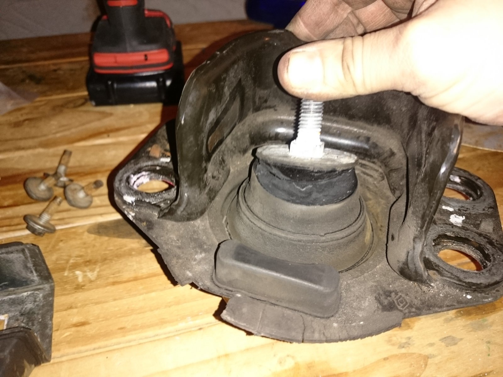

Looks a decent price tbf, i paid £70 each for mine, dont be put off by the looks of it, mine has gone like that.

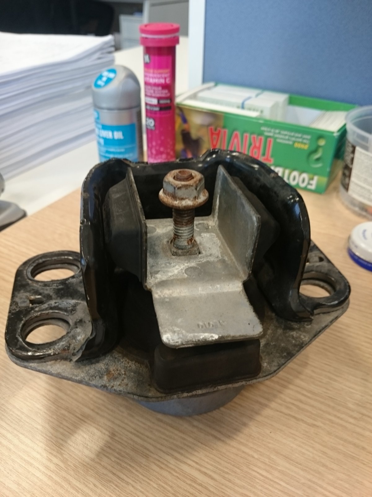

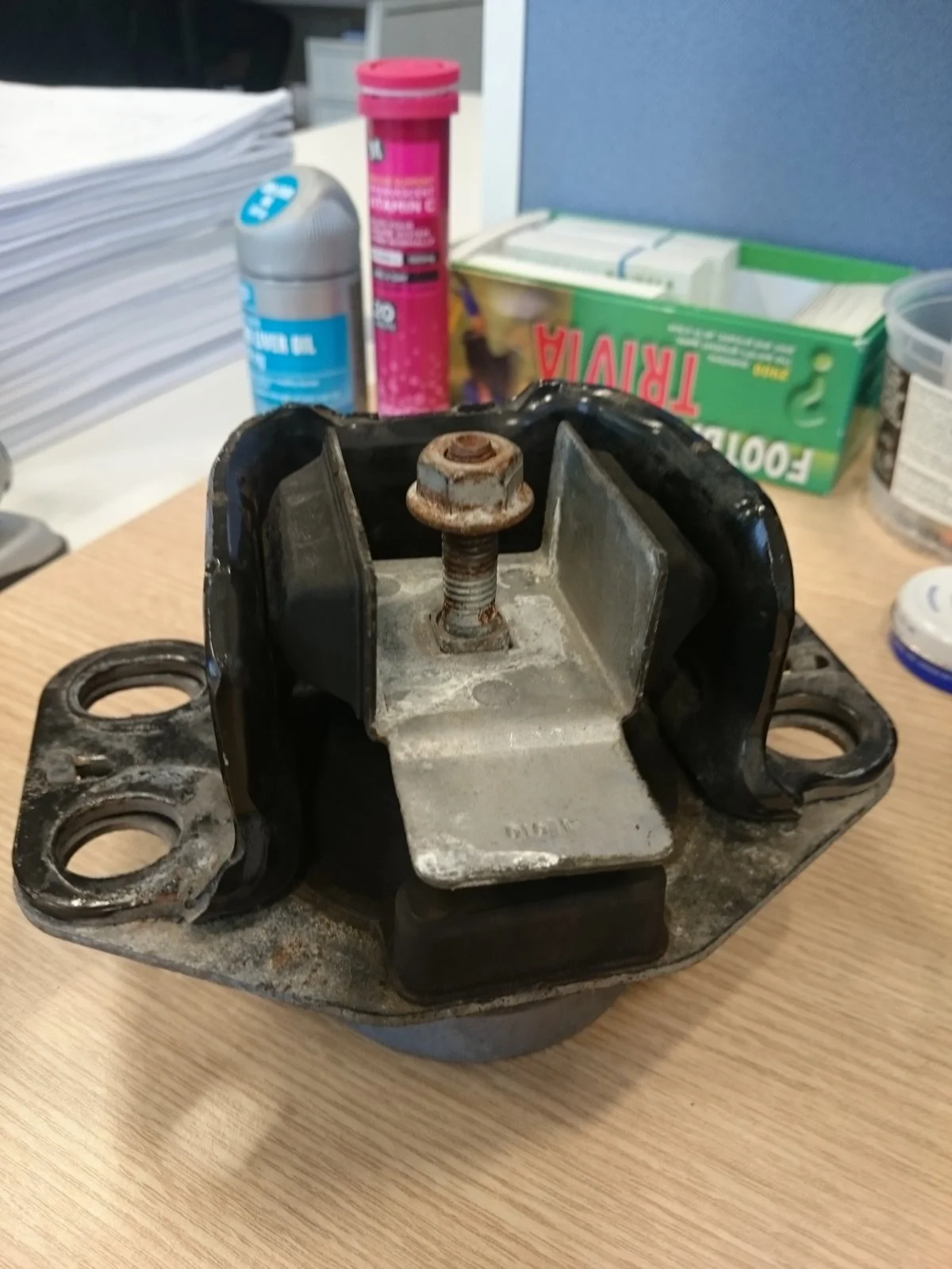

Managed to obtain a genuine top engine mount from a Twingo RS locally on Ebay which has covered around 8,000 miles, once I remove the old one will report back on the condition of old vs new. The kangoo Febi mount is actually the same part number as the one for the Twingo RS so hoping the genuine Renault item will last me a decent amount of years.
With this and the upper gearbox mount (Febi) and Race Evol dogbone I am hoping the front end will feel very much tighter and refreshed given mine has covered 129,000 on original mounts.

Old mount removed (after 129,000) and looks a little dead!
Yeah that's seen better days, I've got a race spec evol dog bone mount along with new standard engine/gearbox mounts. Made a huge difference to gear changes and very little engine movement now, only downside is the extra vibrations to begin with, mine settled down pretty quickly though
