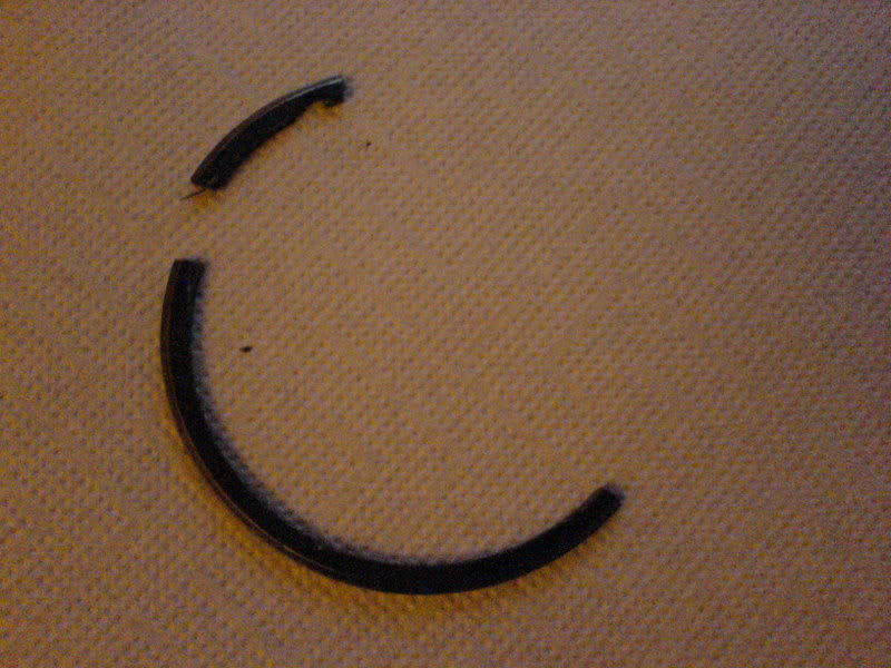

also when i withdrew the passanger driveshaft the thing the tripod sits in also came out (not good i am presuming) have it seated back again but found this, does anybody know what it is, what it does and if it is essential?

The cars now undrivable without that broken bearing bit there a common failure cheap from Renault but now that its not there the differential isn't held together you can put the car in gear etc and the speed will go u just the differential won't tur the wheels.
So this is the diff circlip? Where is the rest? thought the diff was on the other side (this was from passenger side) how much is this part and what do i ask for?

The rest in in the gearbox somwhere you've two options
1 strip the box down and find it
2 leave it and get as much fluid out as you can etc.
Its only a few pence under £5 I'm sure. 70p rings a bell.

Will this be the reason my car wont go?
I've been menaing to look at your thread about your car not going for ages if this was broken before ou took the shaft out them yep this would show why yor car not moving.

But the speedo never went up whilst it was running? could i have done it when removing the driveshaft?
Would i be best off putting a new box in or will it not matter as long as i replace this bit?

Just replace the bit and see might get lucky and the bit won't get into thr working just sit at the bottom of the box you might be unlucky and it get into and chi a tooth etc its a risk.
You could yep do it when removing the shaft.

Completly forgot to ask where the hell this goes and what it does...
Presum its the circlip to hold the washer with the tab on and the big cog thing in place...
You'd got a Halnes so the best idea is for me to tell you where it is its part 46 on the top drawing (9.1b) of page 7A-12 using that an the drawing at the front of that part will show you were it goes it goes up the place you pull the shaft from.
