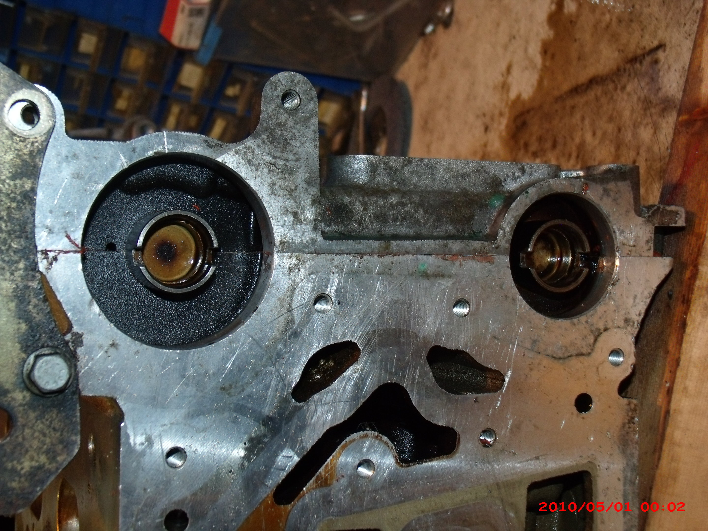

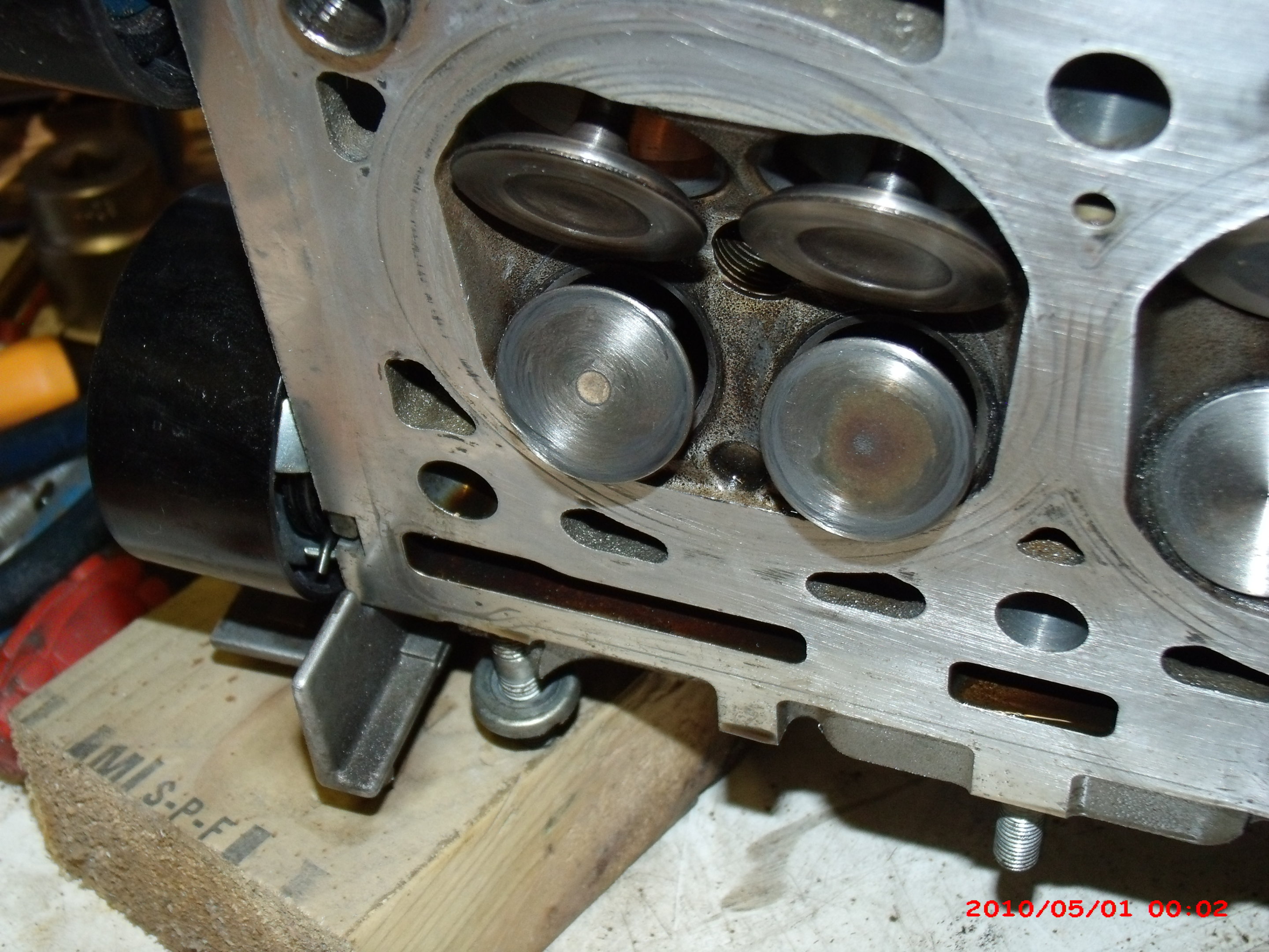

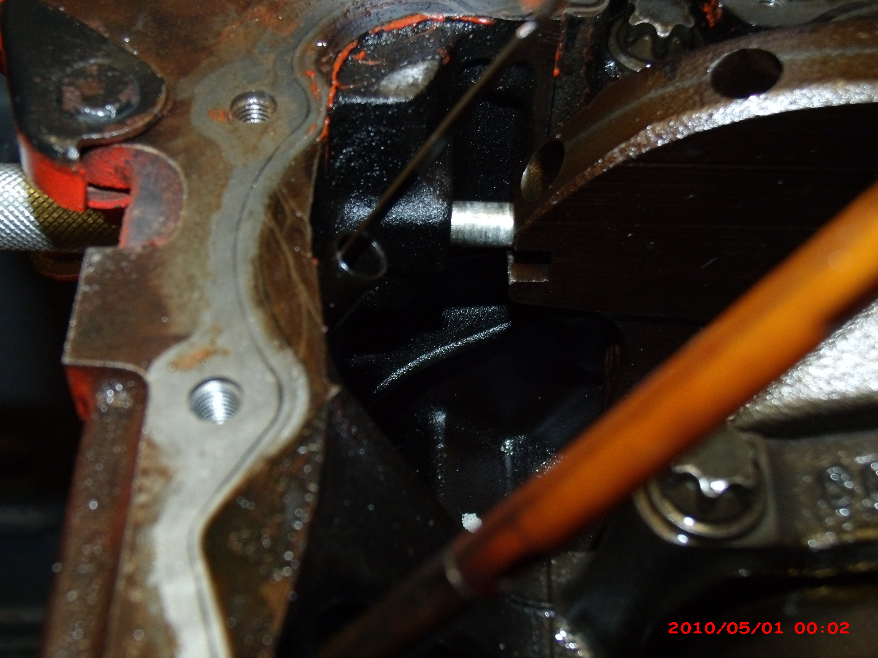

Morning, all good no nasty replies or messages. I've added some photos to show position of valves when set with special tool and position of crank when aligning pin positioned just in case i'm going mad, looking forward to your replies?
Am i doing something stupid??
Obviously if i were to fit the head the valves are going to clash with the piston at TDC, whats the magic solution?
Is it possible the previous owner fitted different Cams? that's the only thing i can think of.
Thank's in advance
dave
Thank's in advance
dave
Honestly mate, all I can think of is that one of the cams is 360 out as both lots of calves shouldn’t be open that much together.
Surely they can't be 360 out either? Only possible to be 180 out?
This is what I’m trying to get my head around mate as it doesn’t make any sense!
If it was 180 out, the slot for the cam tool would be incorrect.
Crank pins in the right place, slots for the cams is correct......but it doesn’t make sense!
