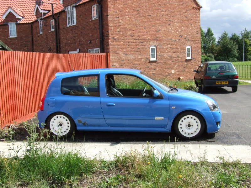

anyway heres a pic of mine on et36 15's

Nicely lowered. Which coilovers you using?
I found my FK's an improvement but that was probably also down to the original suspension being 7 years old when I fitted the coilovers.
